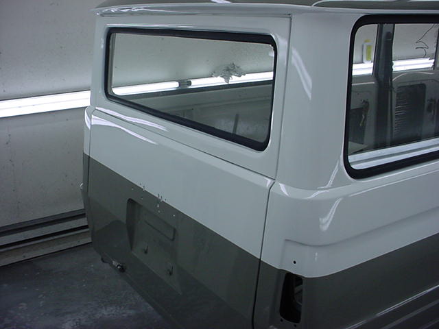

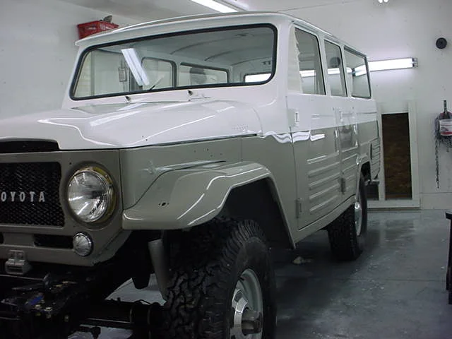

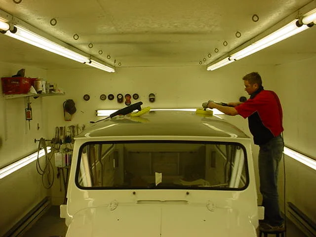

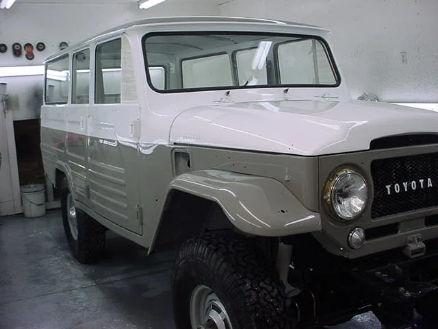

Well, a solid 4 hours on the lv tonight.....and that was between 2 guys so a total of 8 hours. Had another buddy of mine who is an ex-body guy, still does a few odd jobs on the side. Came over to give me a hand with buffing and check out the project..:)
All evening was spent buffing out what I had sanded with 1500 on Sunday, which was the entire vehicle.... Went pretty good with 2 guys, long process, but took our time and kept at it for 4 hours straight.
I used the Wizzard products that Darin had been using on his lwb...also a couple local body guys and the autoparts store reccomended it, so I thought I woudl give it a try. Worked really, really well. Started with the Turbo cut, then went to the finish cut and then washed it down with soap and water, dried it and wiped it down with the Wizzard's wipe down sauce.
Needless to say....I'm happy with the end product. Like anything in life you look back and say, maybe could have done that a tiny bit better...but the overall product I think speaks for itself.
