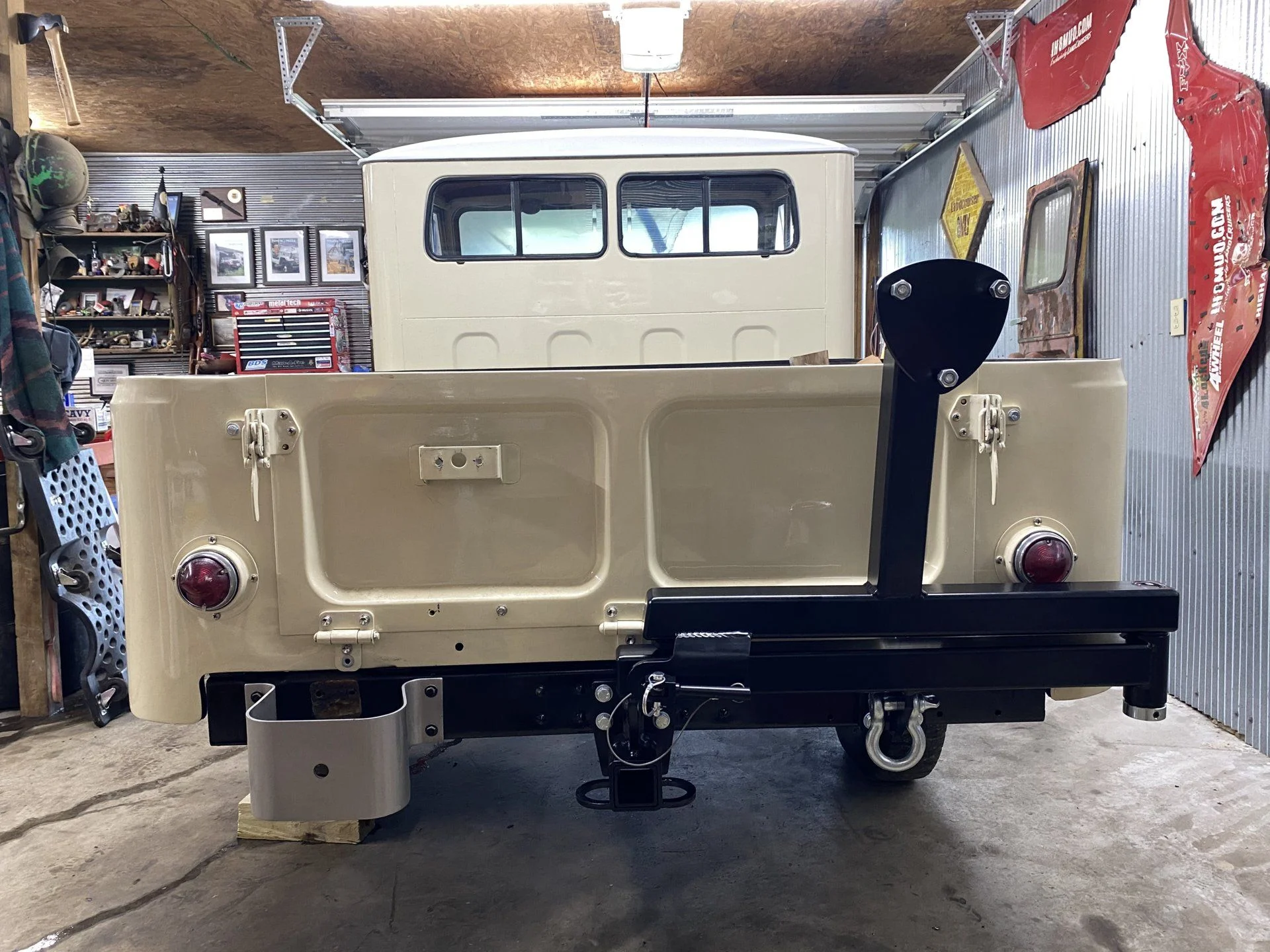

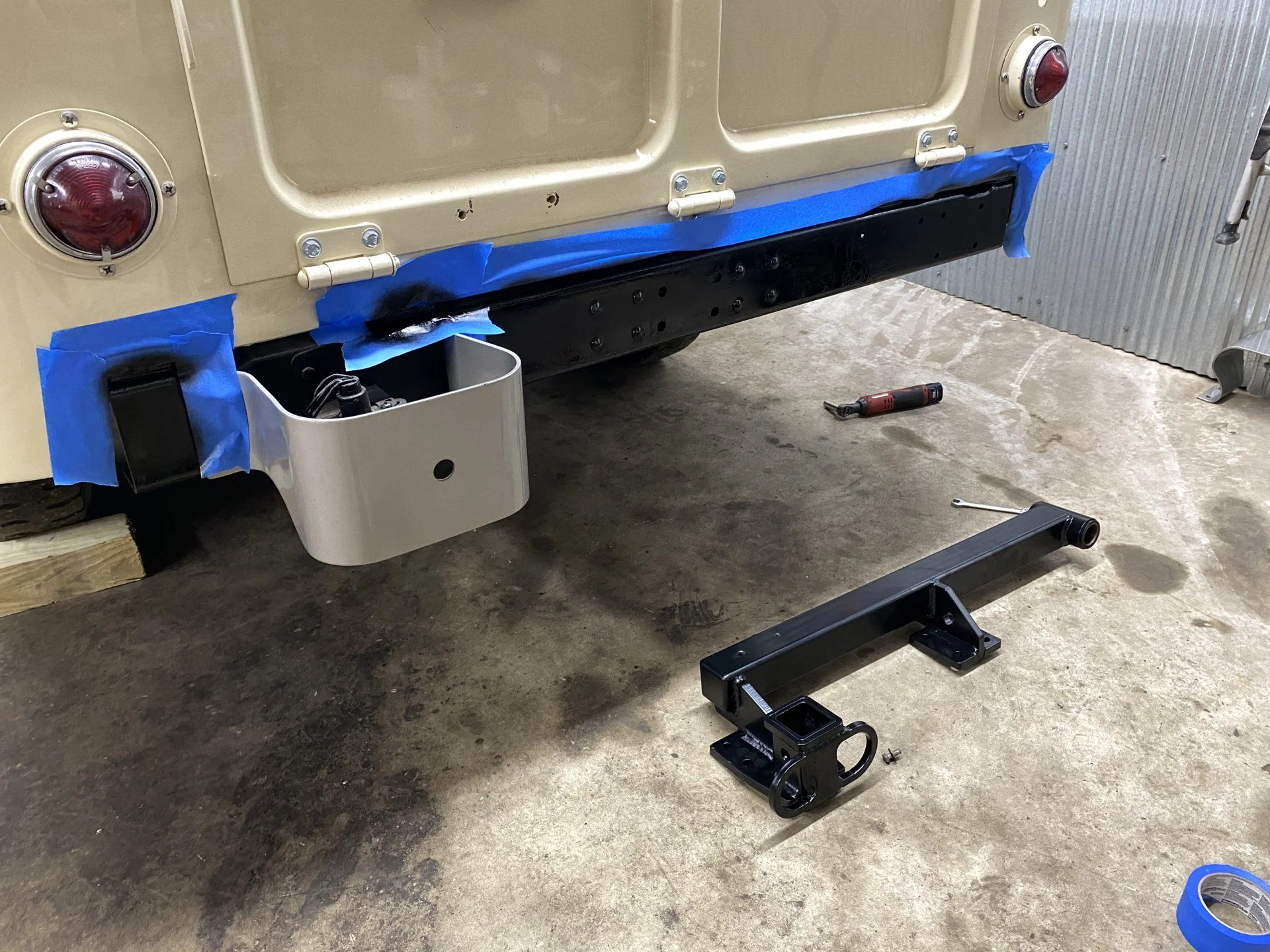

The cowl was still a bit sticky for coat #2 when I got back from Easter lunch with the family so I decided to dive into the @lcwizard 4Plus swing out.
This truck was one of the late models that had the spare tire mounted underneath like an LPB Long Bed and we both really like the looks of the spare mounted on the back like the other 45 SWBs.
Of course the answer is the 4 Plus swingout.

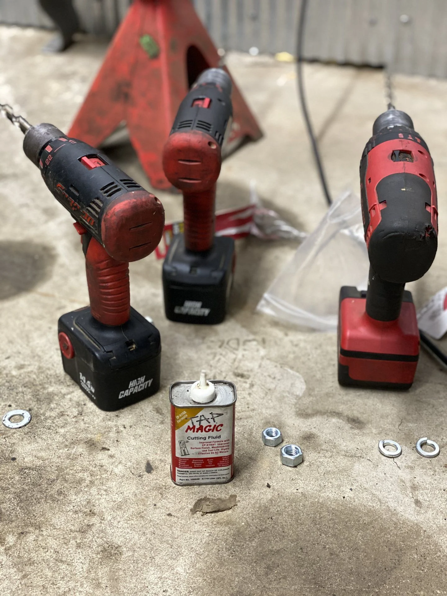

I’ve put 8 of these things on now and the vertical frame drilling still sucks. This time though I was armed with 3 drills and 3 new bits and some Tap Magic.
First though I had to grind out the drips and bondo in the rear crossmember and repaint.
Who puts bondo on the frame??

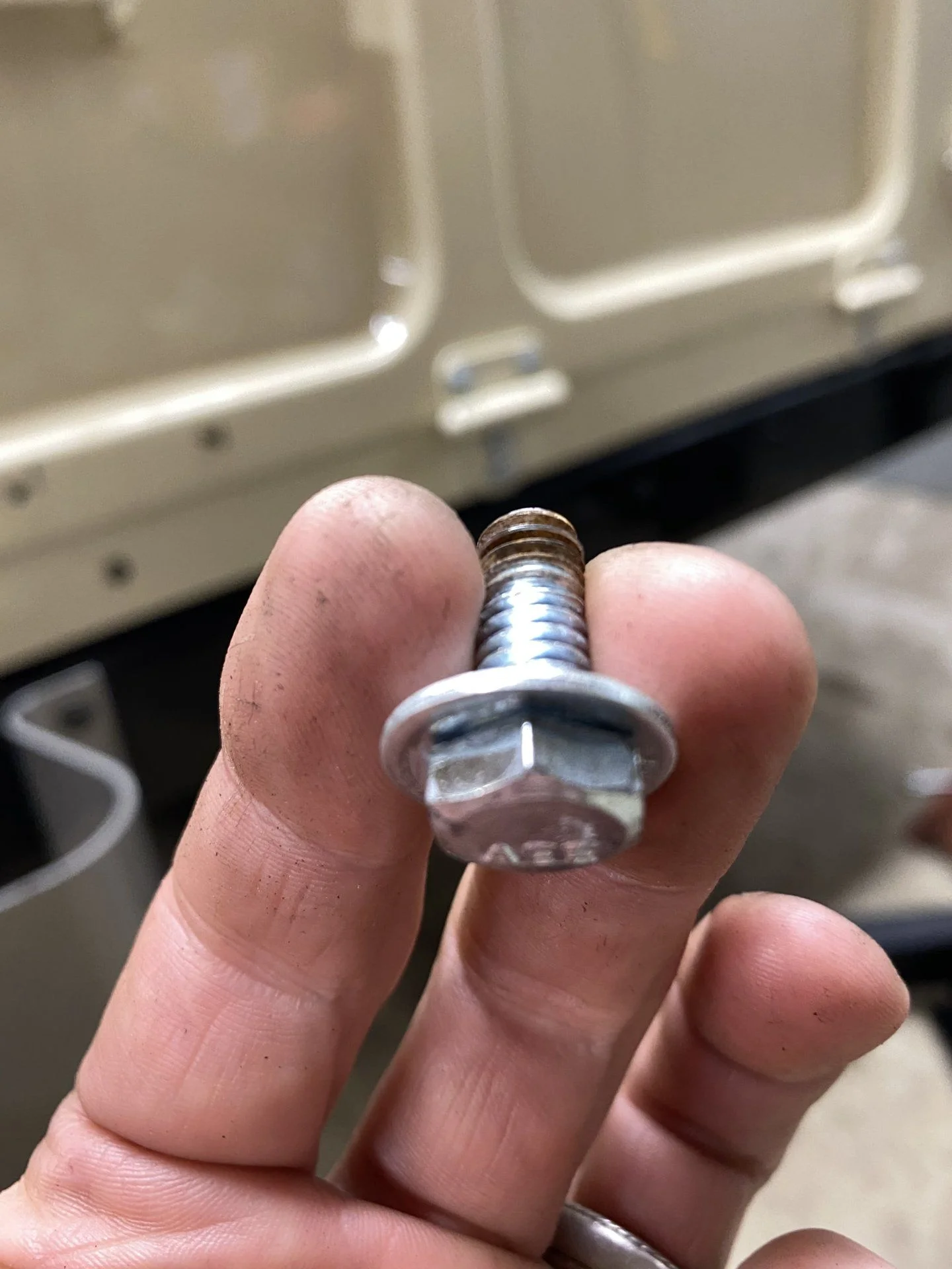

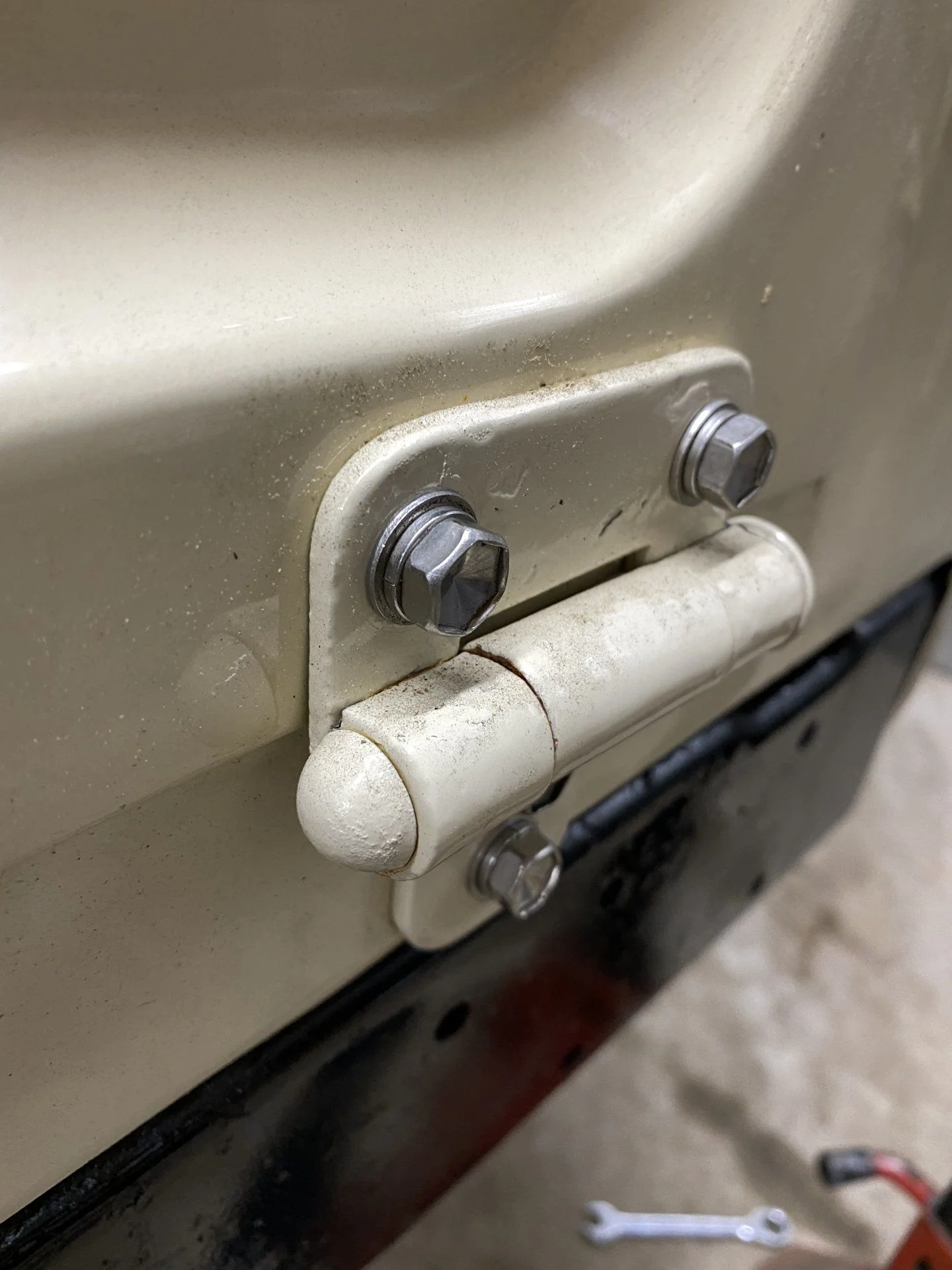

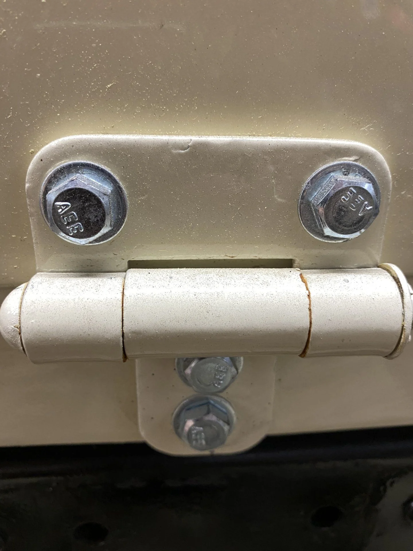

When I put the bumper up it was blocking the nasty Wal Mart bolts holding the tailgate I was planning on replacing with Metric Overland stainless. Well, I forgot that I had not ordered my bolts for this project yet so I had to scrounge up enough to do two of the hinges that will be blocked out.
I’ll replace the rest of this junk later. 13mm head to boot 🙄
Good Bolts.....

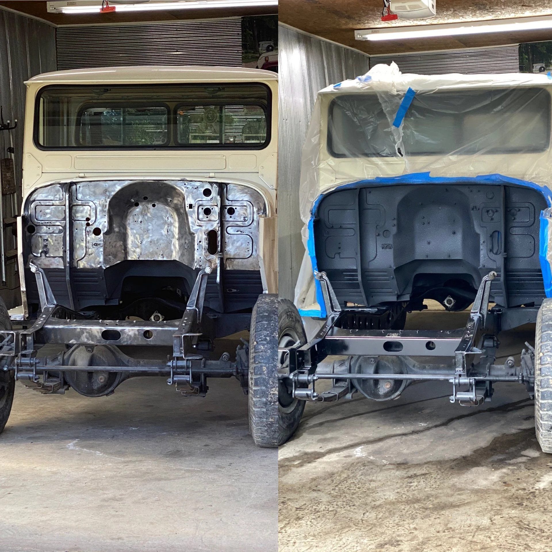

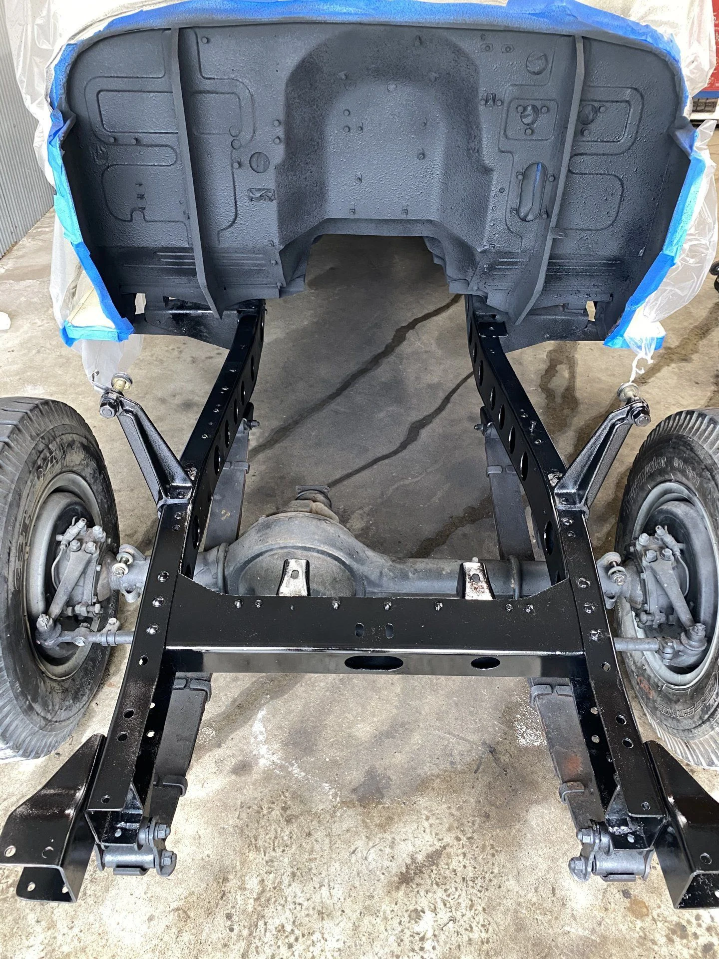

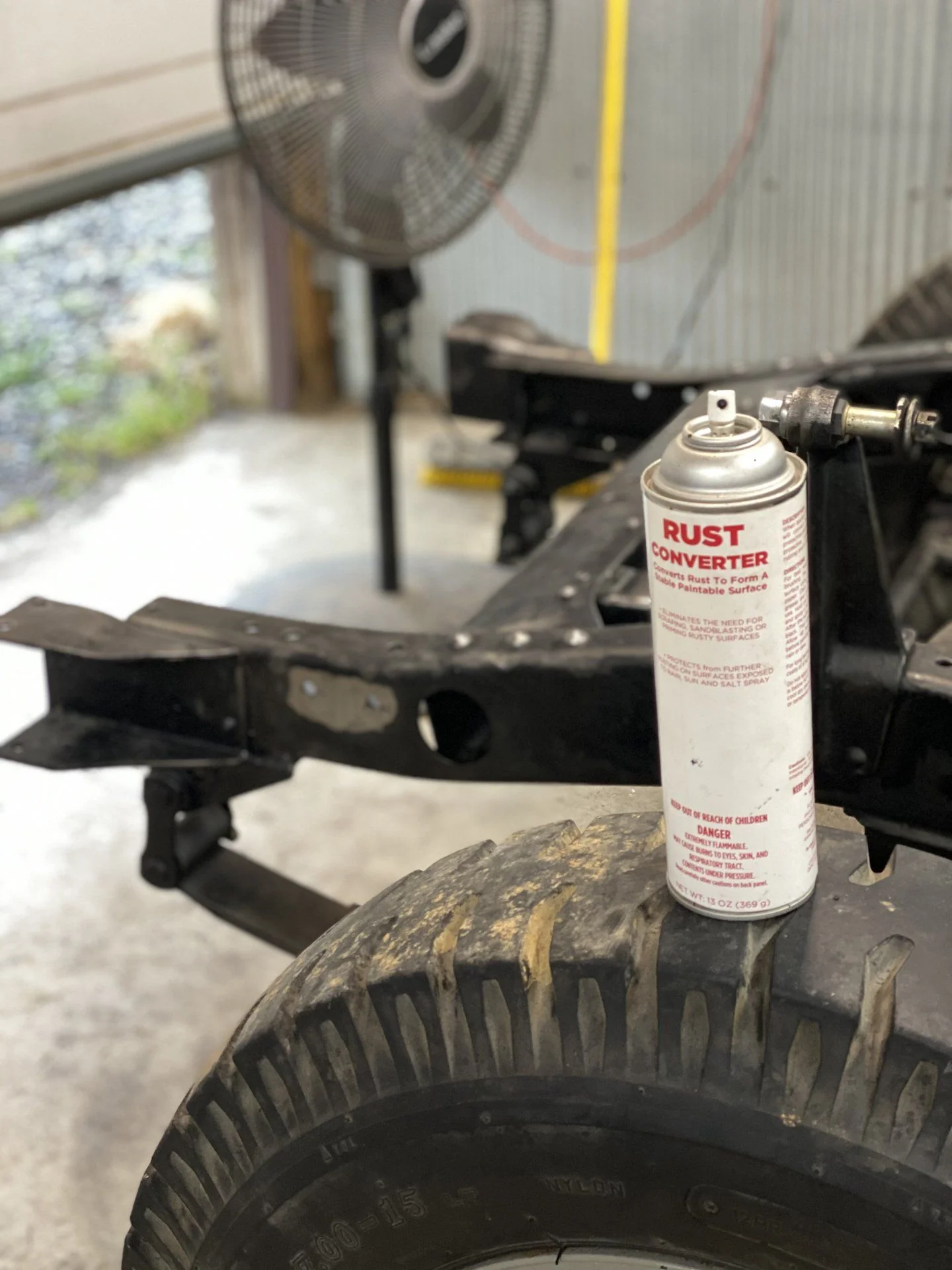

Oh, before I started on the swingout I worked rust converter into all the holes in the frame and behind the radiator crossmember.
By the time the rear was done I was able to get the second heavy coat of Lizard Skin applied to everything
Finally I added a nice coat of gloss to the frame. I’ll need to grind it back off in places for modifications but wanted to lay it on heavy before I have pretty new axles and springs under there
24 hours later. Lots accomplished.

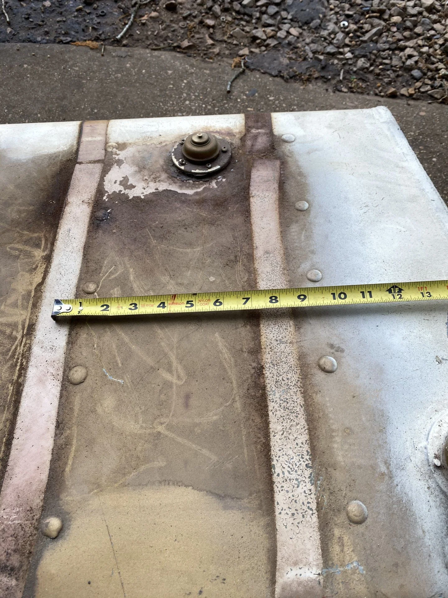

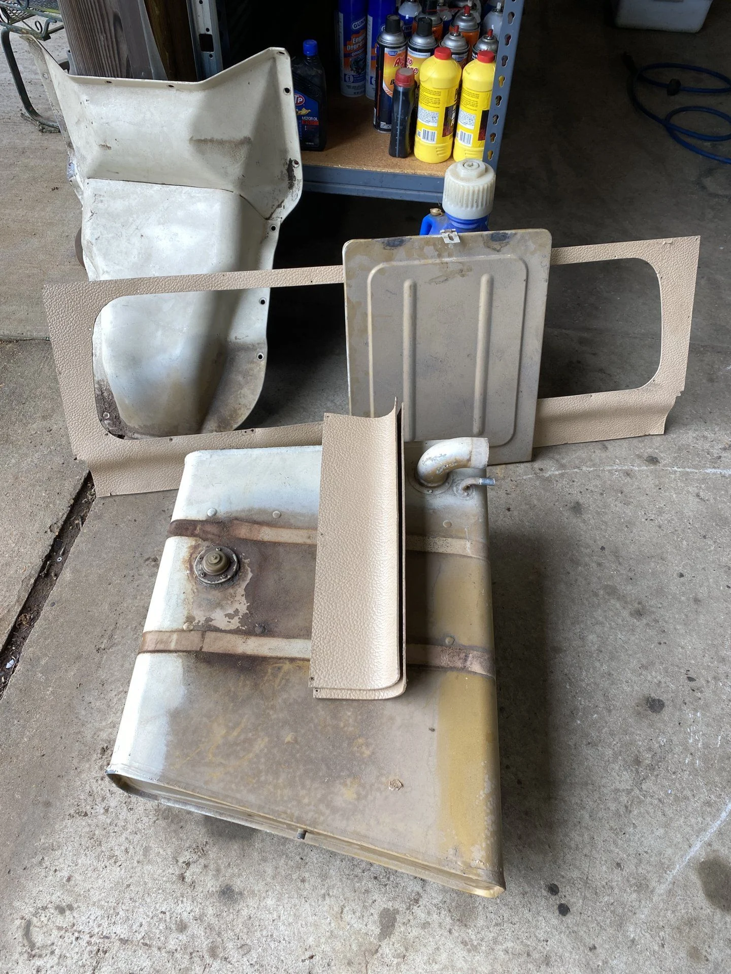

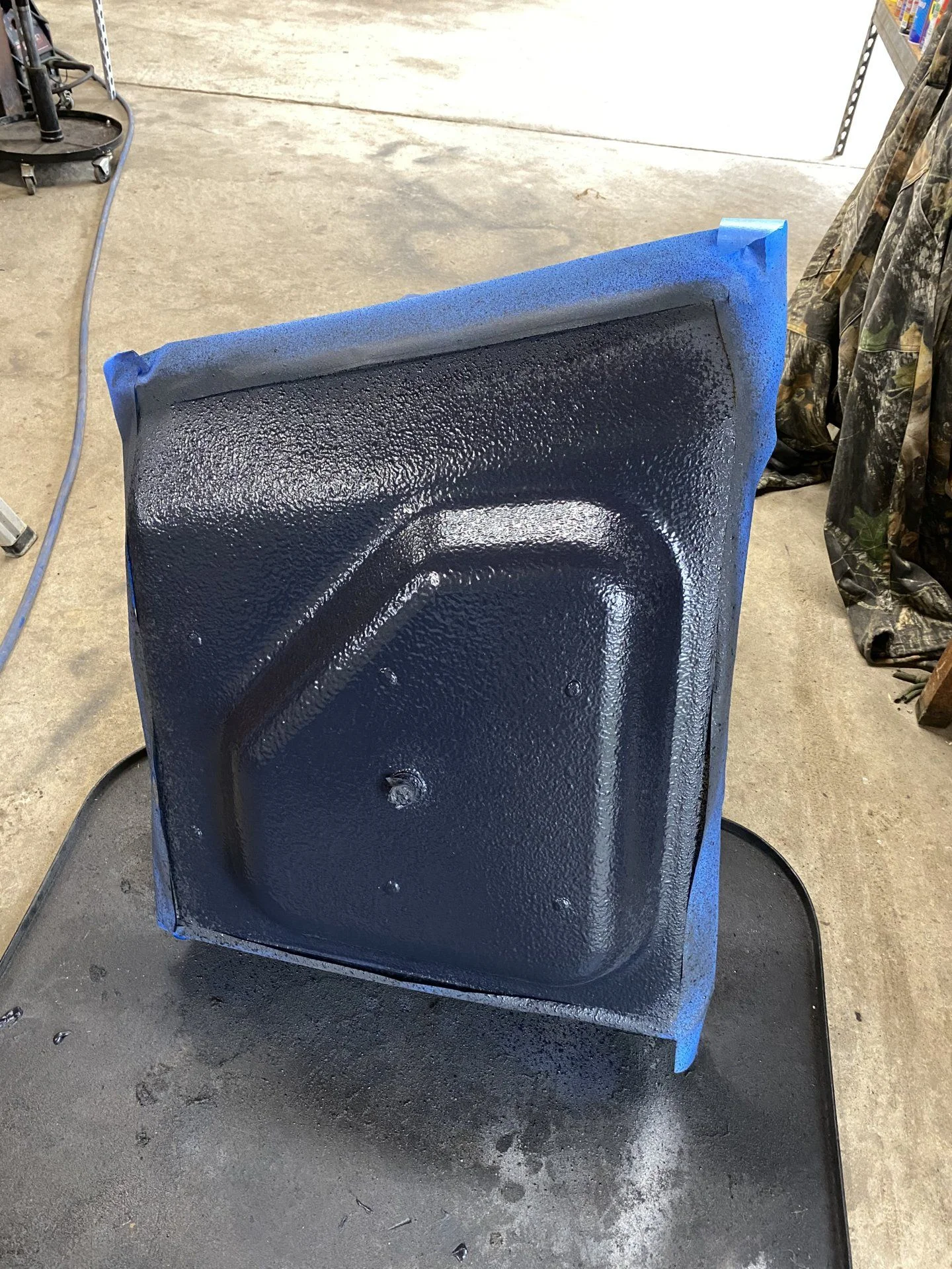

This one is in good shape, besides the fact that it is 3 colors. No tar on it.
I just like this stuff
Pretty much takes out the tin can resonance and really cuts the heat.
did you wire wheel all the factory tar off? I’ve got my original tank off my 73 that I’m cleaning up and I’m debating on trying to clean up the bottom. Of course it might be what allows the tank to hold gas still.

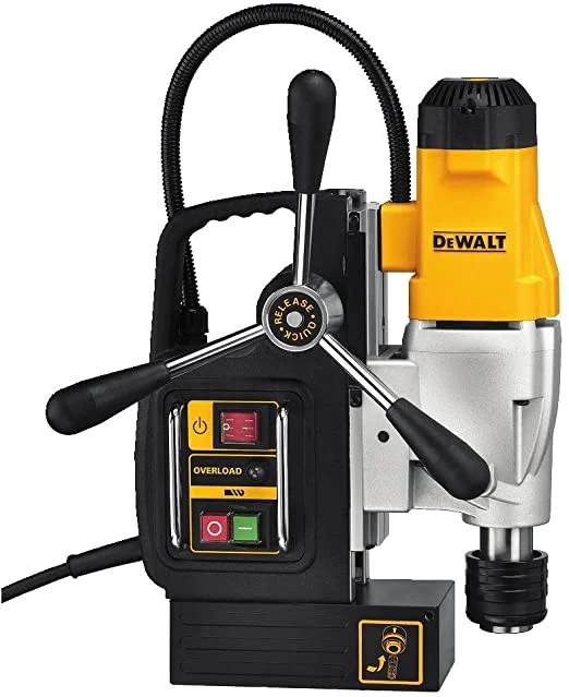

I got about halfway through the first hole for mine and called a cousin and borrowed this, it's the only way to fly.
I got about halfway through the first hole for mine and called a cousin and borrowed this, it's the only way to fly.View attachment 2271508
I actually searched for that and realized I was just being a pussy so I spit on my hands and grabbed a fresh holt
