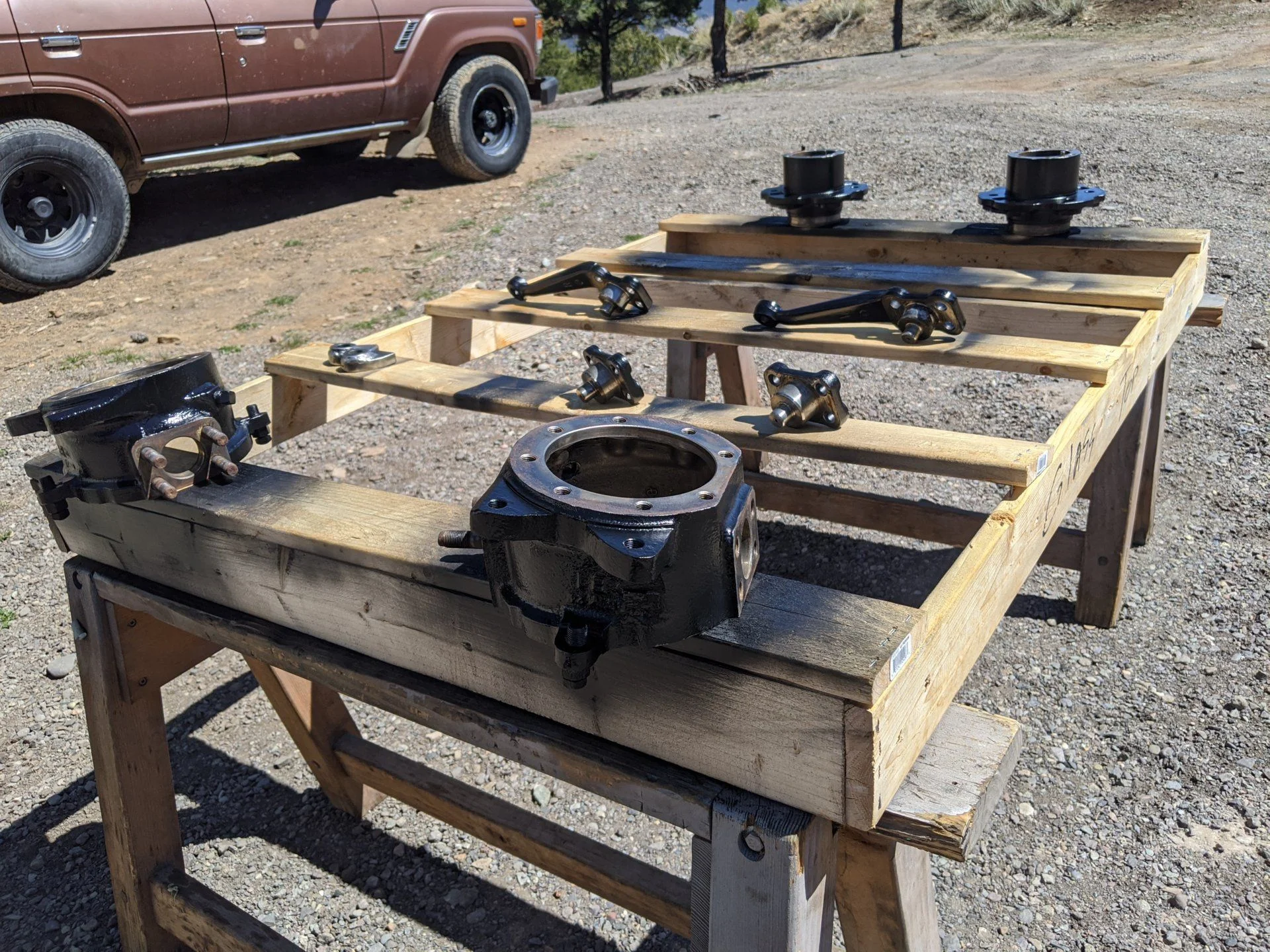

Progress on the front housing! It's been a bit of a challenge here because a ton of places are closed and there is quite a bit of the sickness going around Montrose county considering it's so small. Colorado is under a shutdown technical until the end of the month at least. But none the less all my shop time in the evenings is going to this and we are getting close to final assembly.

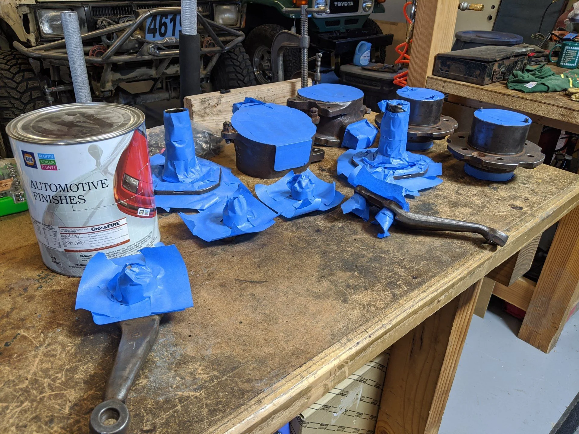

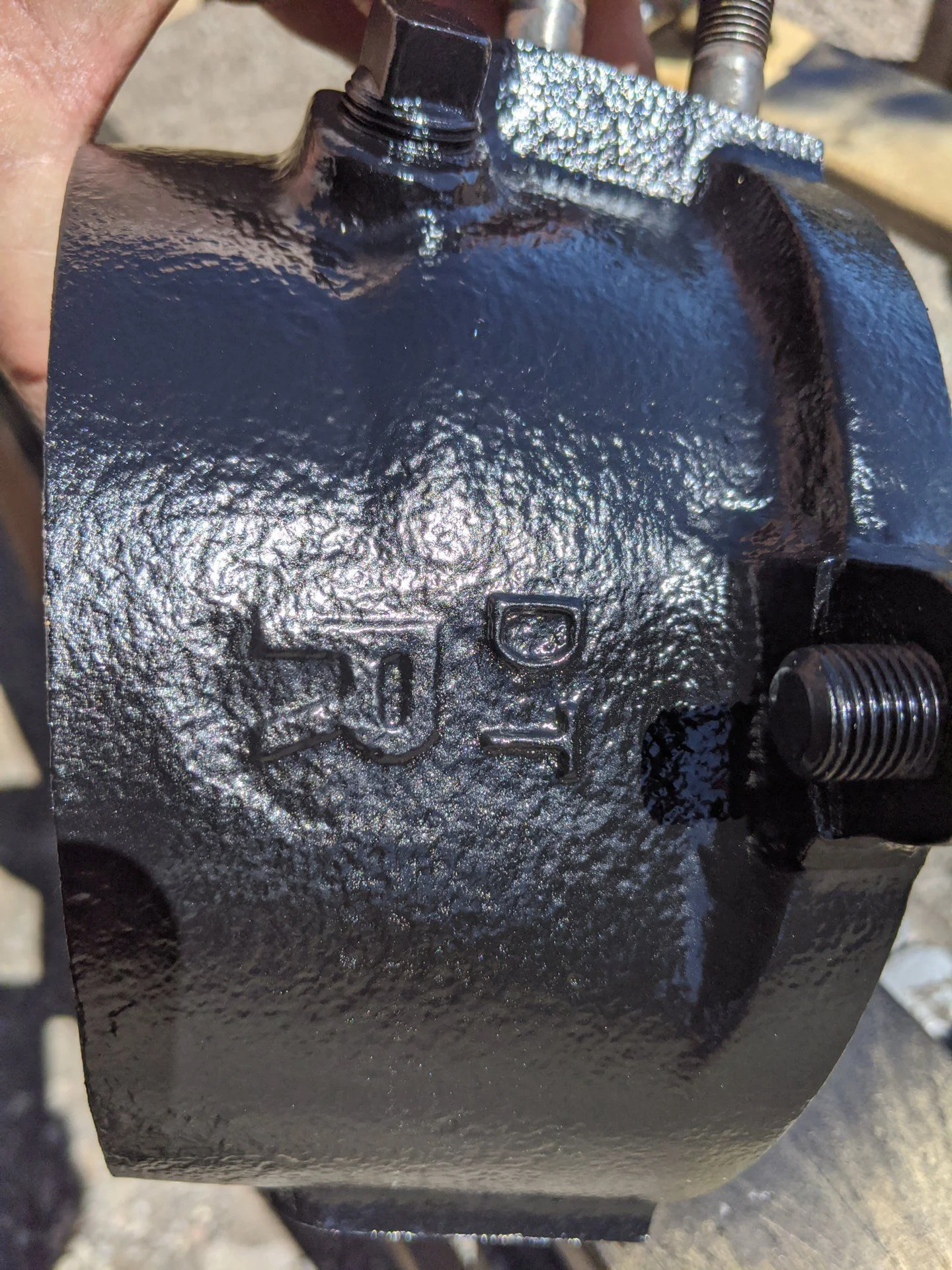

Getting something sand blasted or powercoated right now ain't going to happen. So after days of soaking the knuckle parts in purple power and wire wheeling them they were spotless clean. I used Napa Crossfire on one of my flat beds a few years ago and it has held up great so I tried it on the knuckle parts. It turned out great.

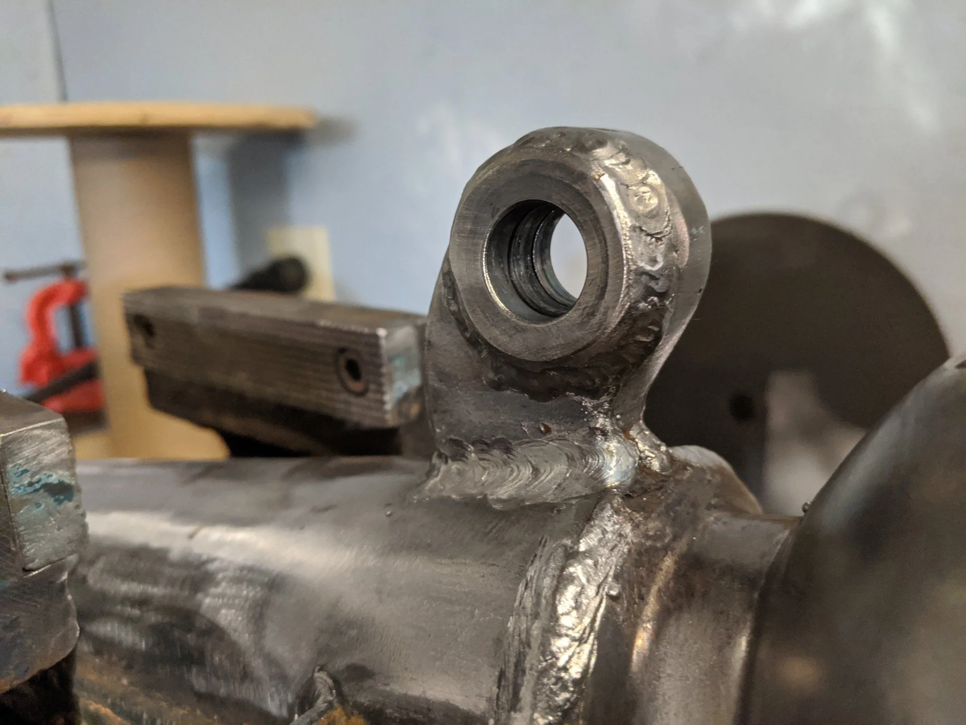

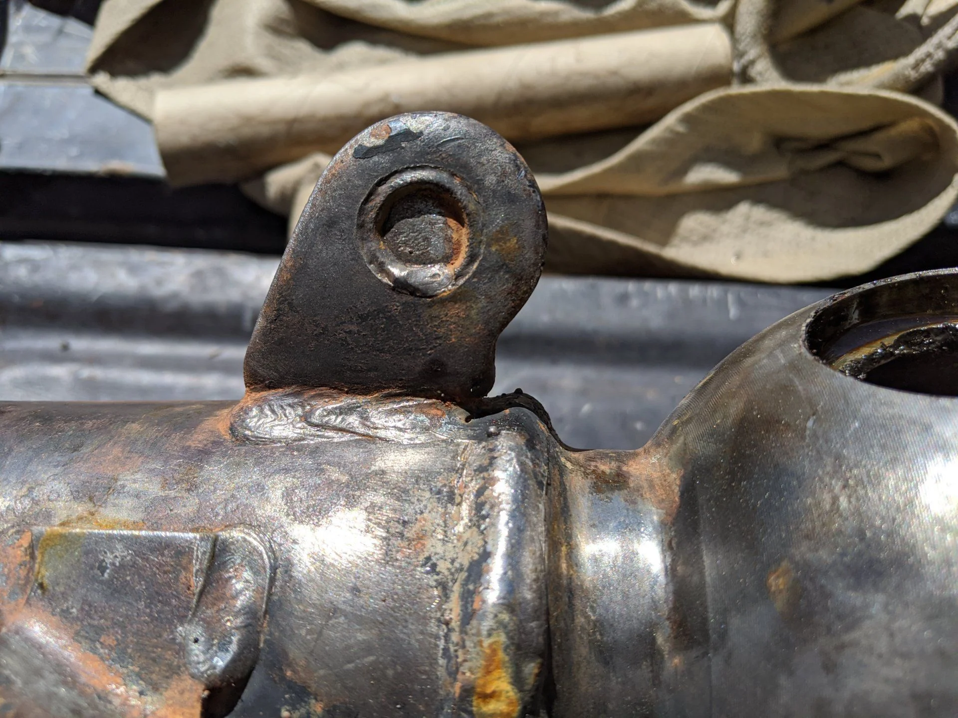

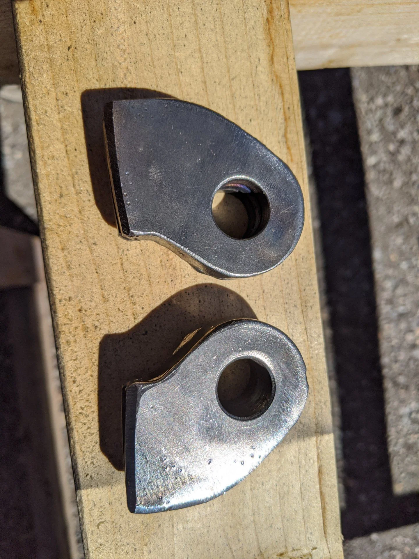

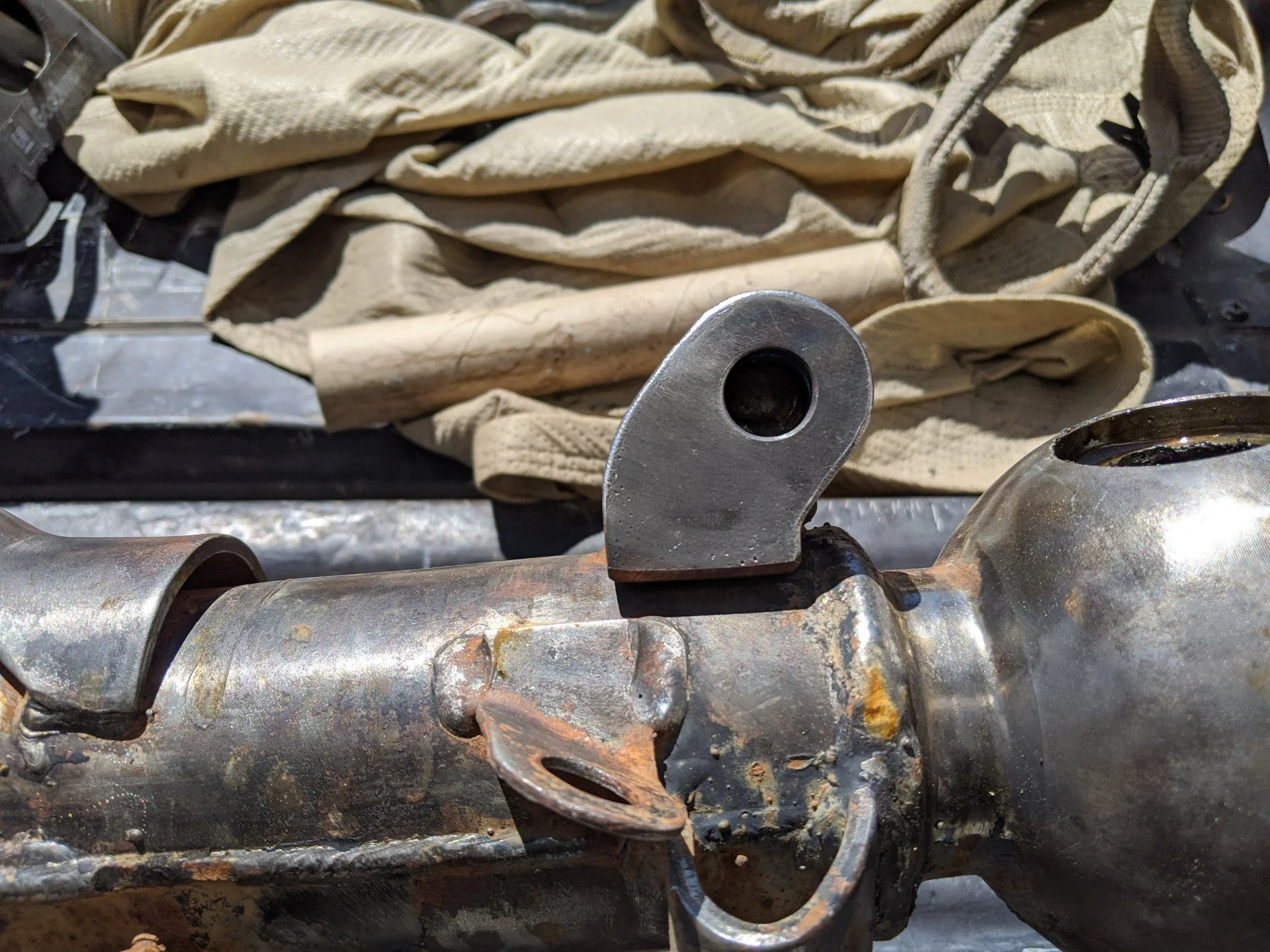

The front shock tabs are pretty jacked up so I decided to Fab up some new ones that are a bit thicker than stock and use a weld washer to stand the bushing directly off the tab. It mimics stock pretty close just a little more beef.
I just need to weld to the housing.
Excellent work. I can’t wait to see this little bugger as a roller.

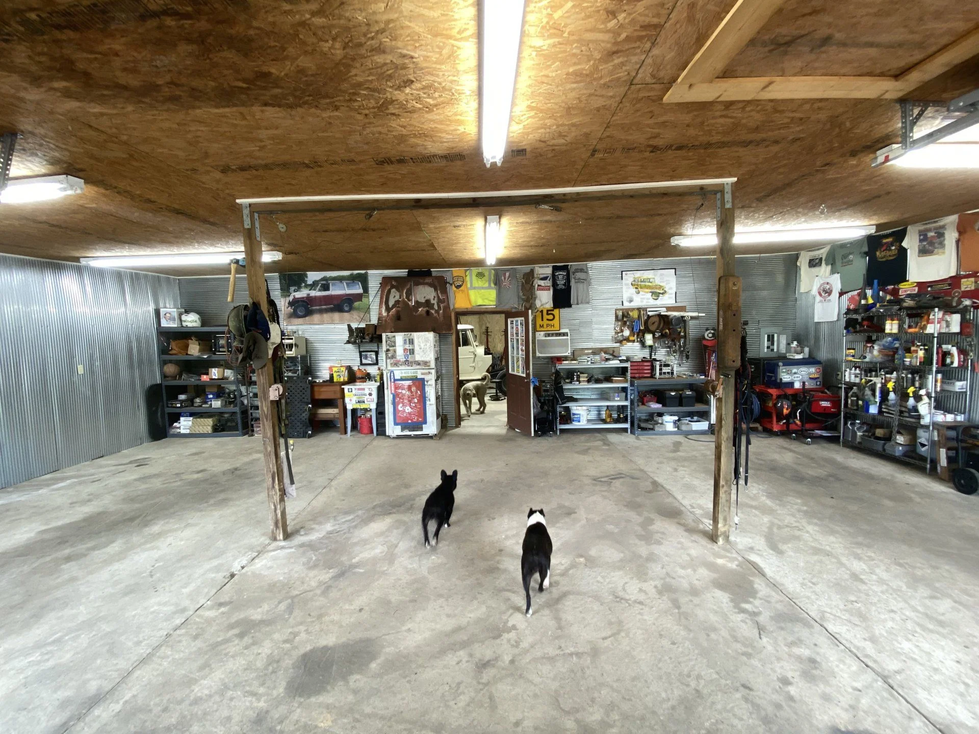

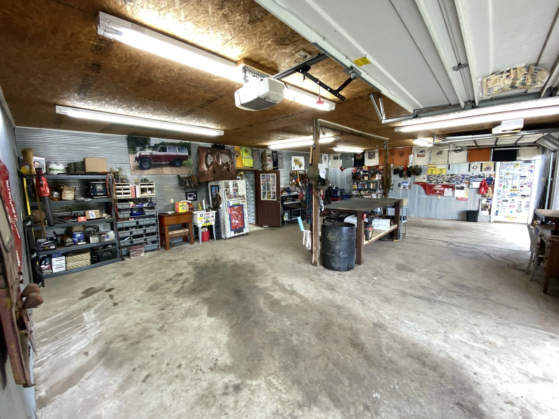

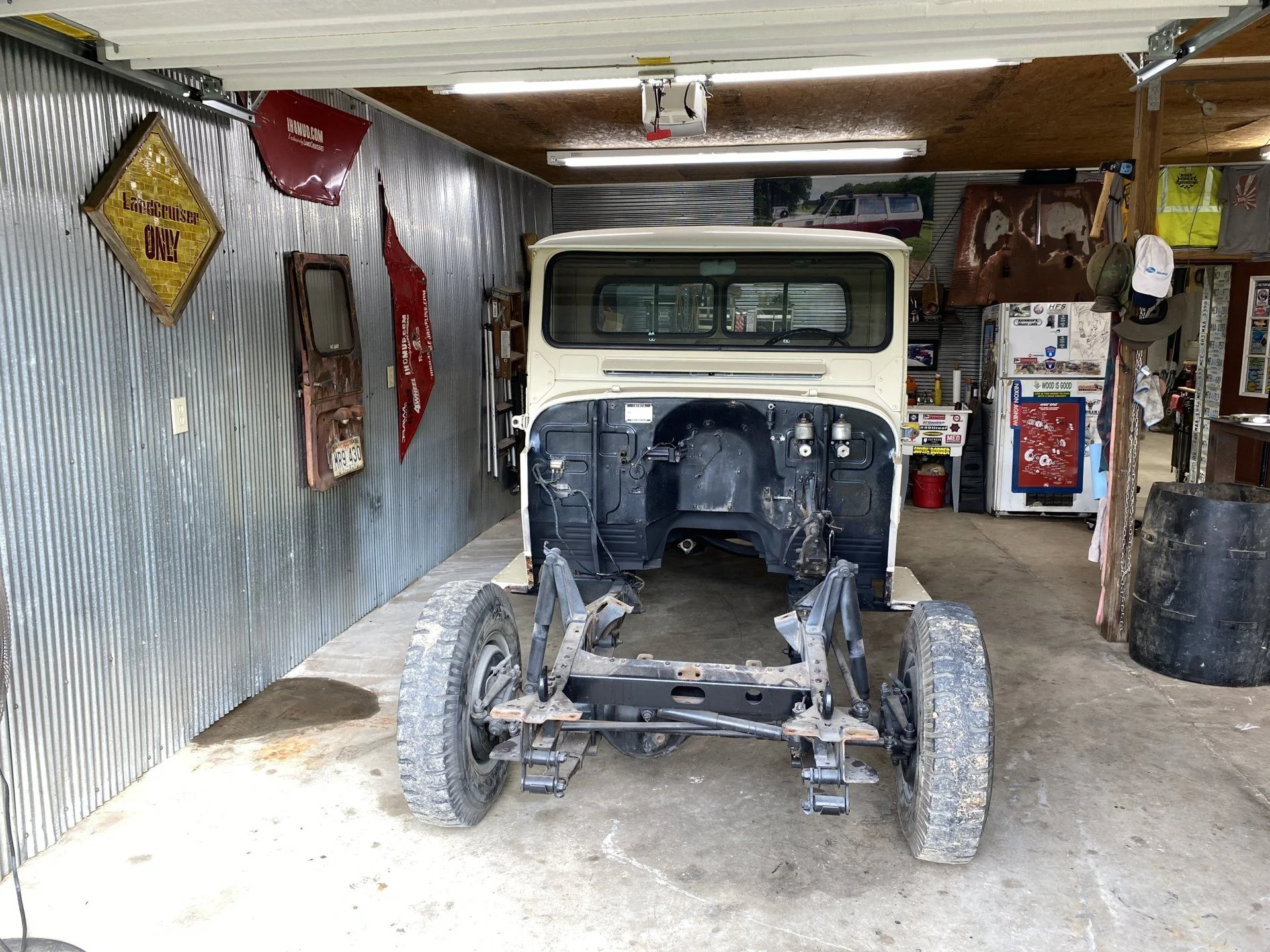

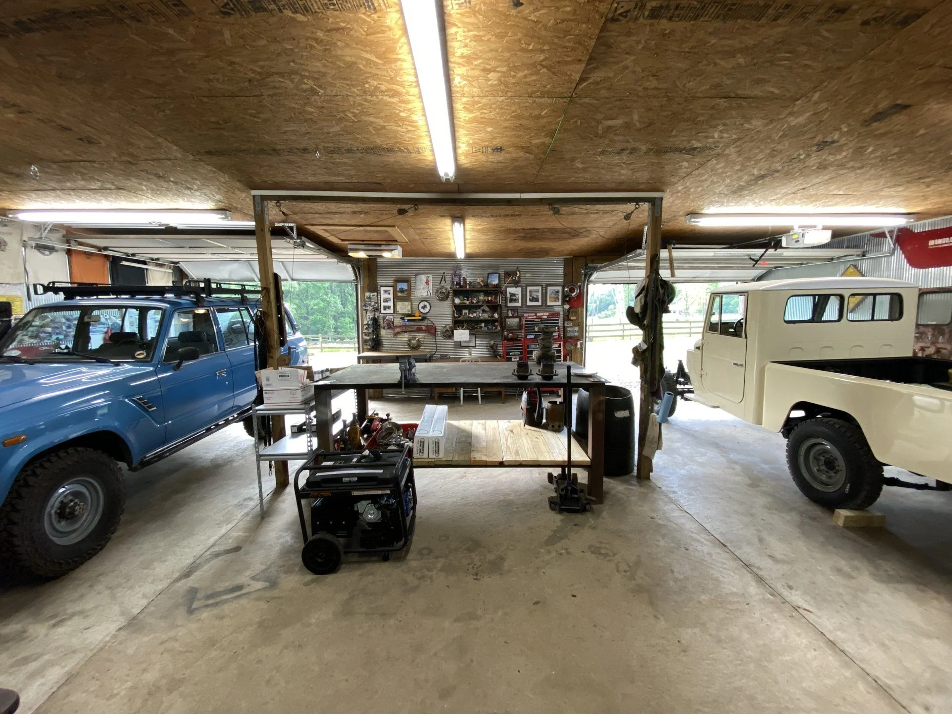

I’ve spent the last few days moving all my junk out of my old shop into the new storage area I built. This takes all the racks off the walls in the old shop to give lots of room to work.
Rotunda is headed to it’s spot as soon as I get someone more competent than my son to help me get it aligned and up on jackstands
Measure twice and cut once on those table legs, not the other way 😛
Hahahajaja I thought the same thing than was thinking his floor was a weee bit crooked.
The shop was a pole barn for 25 years and the center section was the deer skinning rack. The pad was only the center section and it was sloped so you could easily was deer guts and such off. Unfortunately when I closed in the shop I made the decision to match the slope when I paved the other two sections versus bringing it all level. That was 15 years ago and I’ve learned to live with it but it damn sure drives me crazy.
Rotunda is in its final resting place until new steering and axles are in place.
That is a nice work space you have there.
It’s a cool old shop. Building the new one attached to it really opened it up. Thanks Tank

Good morning from RustyNailRacing HQ
I got up early and did more cleaning on the housing and welded the new shock tabs on before work. Living at 8K has it's advantages, buy not in the winter. The weather is amazing this time of year.

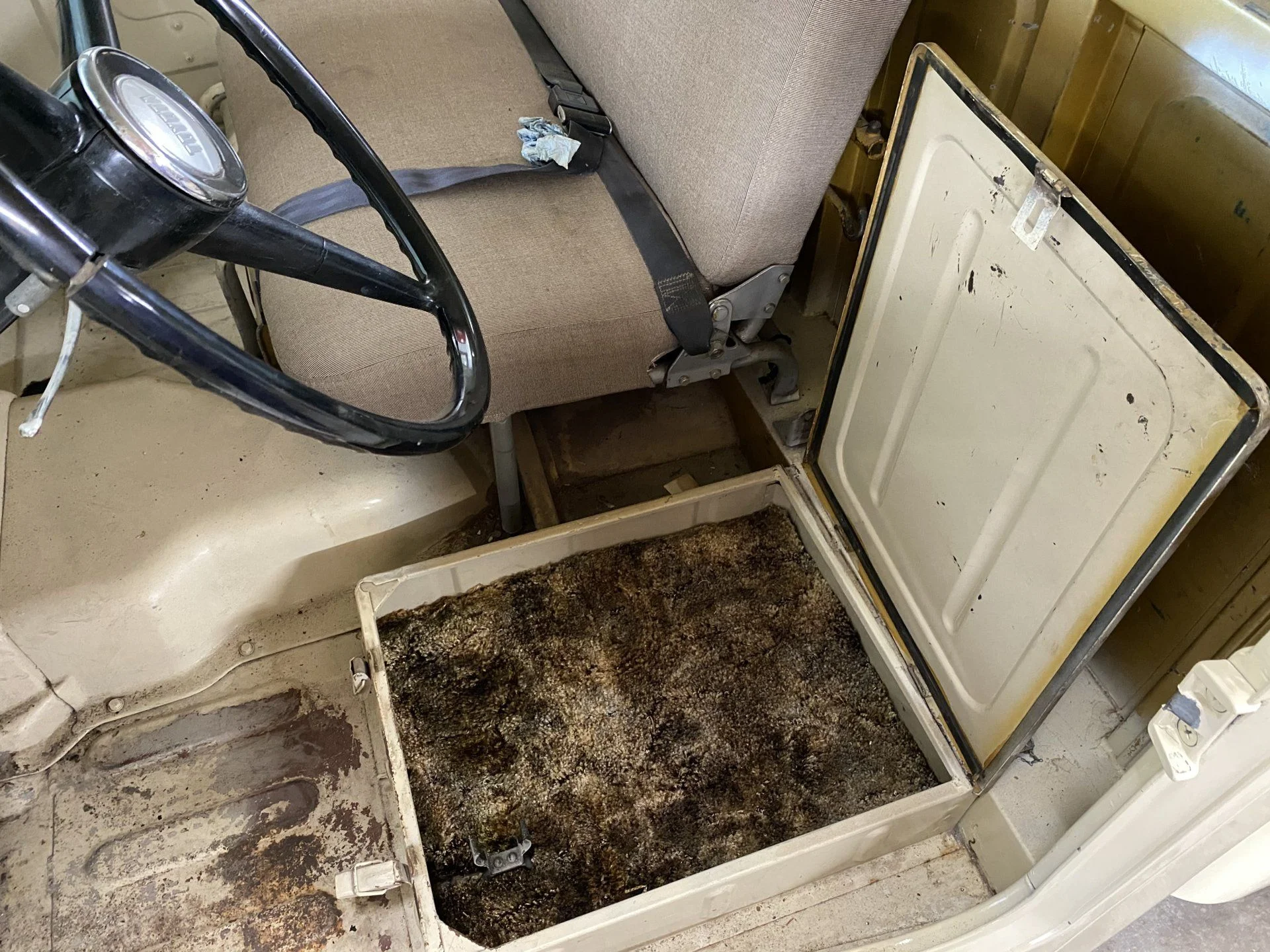

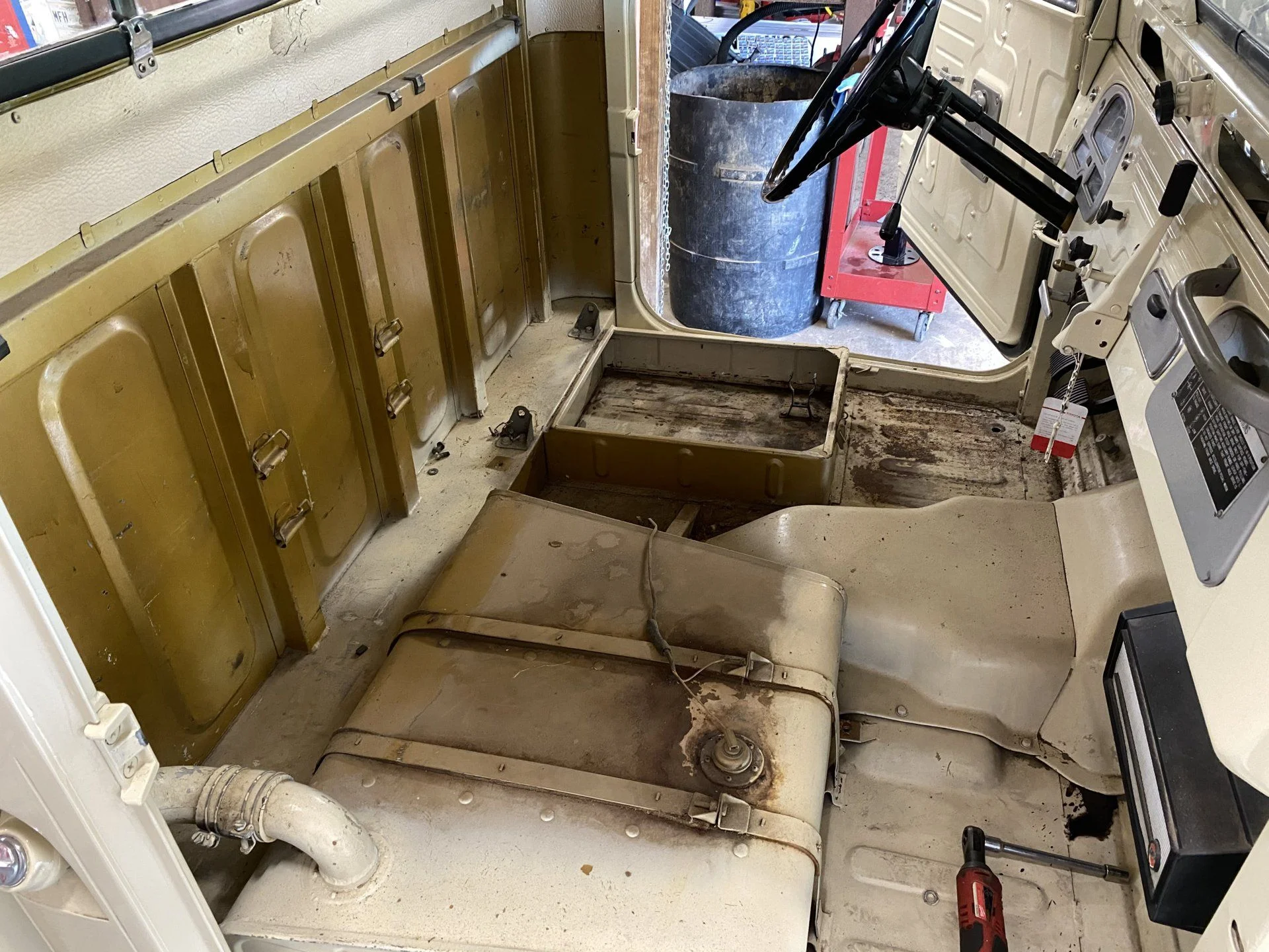

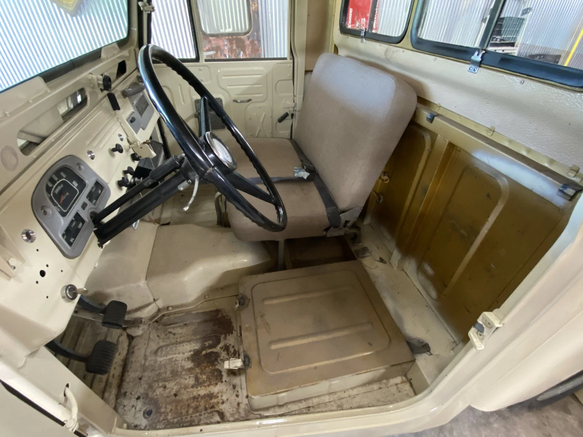

Anyone have a nice set of seat backs? These are MIA as are the ones on the 💩45
Original color, some non-OEM gold and shag carpet and the final random coating of Dune Beige
I got this though.
That is disappointing.
When that 45 left my place, what I suspected was the origial black license plate was inside the back of the driver seat. Was that still there?
