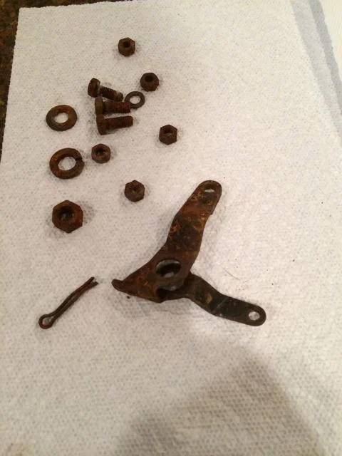

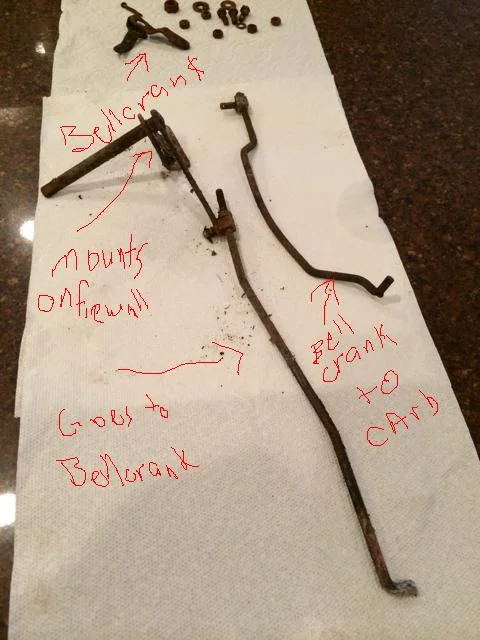

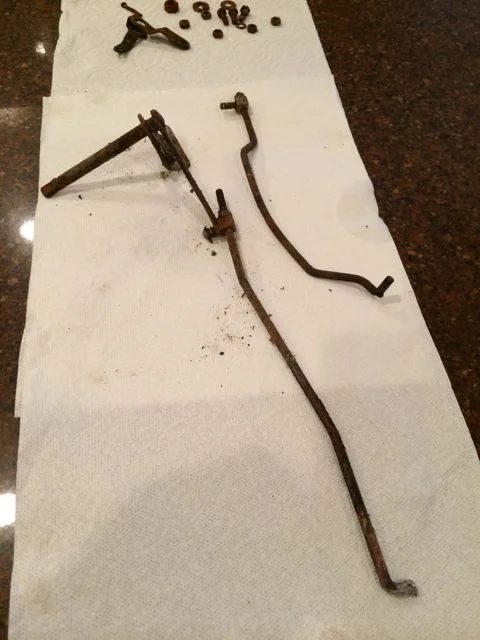

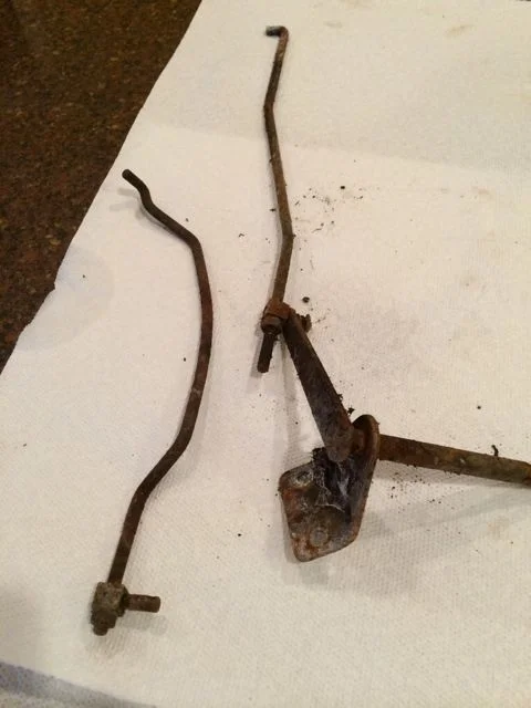

Need some help identifying these parts...
Accelerator Linkage?

I'm missing some bracket that goes on firewall, I think.
I bought a '65 parts truck and that's where the linkage comes from. I'll have to look closer. Maybe it's there somewhere, the rest of it was in the toolbox under the seat.

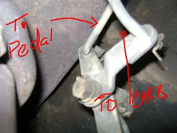

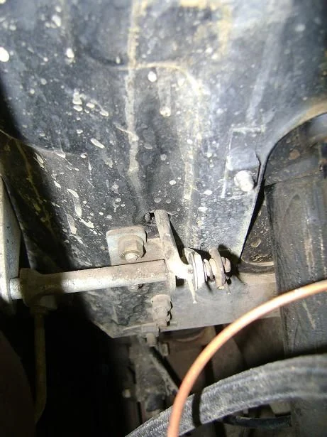

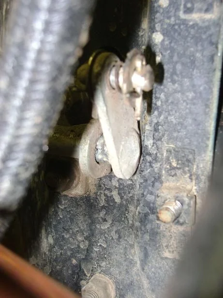

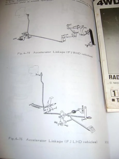

i think your firewall bracket and rod need to be flipped around (like looking at mirror image) and i think there should be a bracket toward the cowl that that rod would go into and would have the piece for the pedal. i get the feeling that yours is like mine, which is a bit of a bastard as yours appears to be a shade different and doesn't quite match the parts pics (like mine didn't). you'll get a better idea by looking at my pics hopefully
Yes I'm missing the bracket closest to the steering column.
Thx for all the pics!
Maybe somebody on here has one lying around.
Otherwise I could fabricate something ...
