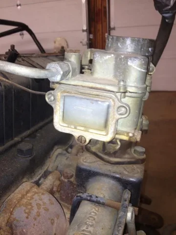

So the correct motor for a 1962 FJ40 would not have an serial # stamped on it?
The motor shown has F203012 stamped on it. I believe it is out of a 69/70 FJ40.
But like you said the valve cover and oil fill neck threw me off.

Hmm. F203012 = ????
Why would you say 69/70???
F-290409 is dated to 08/69, and then one year later F-325624 is dated as 09/70...neither of these is close to your F203012.
I am going to say yours is probably a late '66 or '67 F 135, as the closest engine number I have listed in my junk, is '65 with a F196XXX.
So I've re read your post and went and took pictured of #s cast into the side of block under manifold.
I think the block in the truck starts with a 2 and the "new" block a 4...
The block on the pallet has 41029 stamped under manifold (1964 Oct 29)
The block that came in the truck when I bought it is hard to read, but it looks like 20903
That might mean the block that came in the truck original to it? 1962 Sept 03.
So is this a correct F135 with wrong valve cover, manifold, carb etc?
