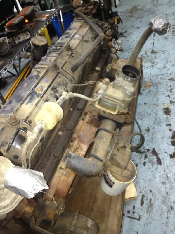

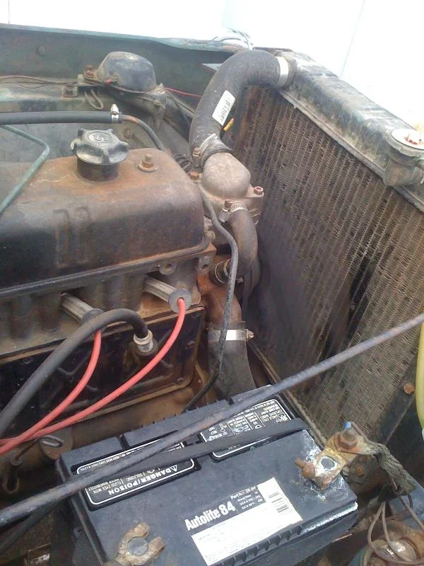

While looking at your first bunch of pics (which I copied and posted as the first picture below) then yes, just by looking at the valve cover and lack of oil intake tube on the right of the engine, that engine looks like an F155...and I say looks like, because often people swap parts from one block to another, but the lack of oil fill tube is a pretty big give away. EDIT: So you state that the Vin number on the engine in your 40 is F 407242. Well, according this this chart (http://www.sor.com/fengine.html) ...well, that puts it in 1972, between August and December. So I was correct...it is an F155

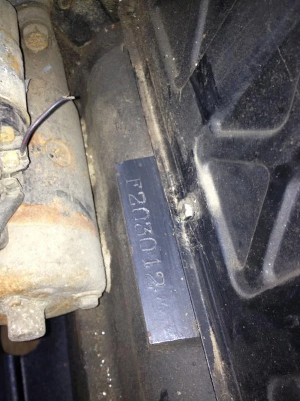

So, the second image I posted below (F203012) is not the engine in your 40. Is this the same engine as in the third picture I posted below??? This motor is not from a '69/'70 FJ40...at least not originally, as I have already outlined that engine F-290409 is dated to 08/69, and then one year later F-325624 is dated as 09/70...neither of these is close to your F203012.
Then there is a third engine picture that you posted, which is the third picture I posted below. This is an F 135, or at least it looks to have all that an F135 should have, What is the F serial number on that engine? Is this F203012?? Then this engine would be circa 1966 :cheers:

The truck itself has a VIN# F16520. The motor in it F407242. Cast # 20903
The motor on crate F203012. Cast # 41029 (this motor was pulled from a 69/70 FJ40).

Really, not trying to give you a hard time, just trying to help you. You noted that on page 1, that I mentioned it was an F155, and here in post #179 you are still thinking that it might be original to the truck...which I just outlined by your info in post #181 above, that it is in fact an F155 from 1972.
So far I have been pretty consistent, and ended up being correct on this engine.

The 1962 FJ40 that you purchased, has had its engined changed at some point in its life, and the engine in it now (F407242) is an F 155 from 1972. So not correct.
The engine you purchased/acquired recently (F203012), is an F135, so the correct model engine for your 1962 FJ40. The serial number on that engine puts it around a 1966 model.

Aha! JohnnyC was right the casting on block starts with a 2. I assumed 62, but you've solved the mystery, it's a 72.
The new to me motor sitting on the crate is indeed correct F135, albeit out of a 66. However, the number cast into engine block under manifold starts with a 4.

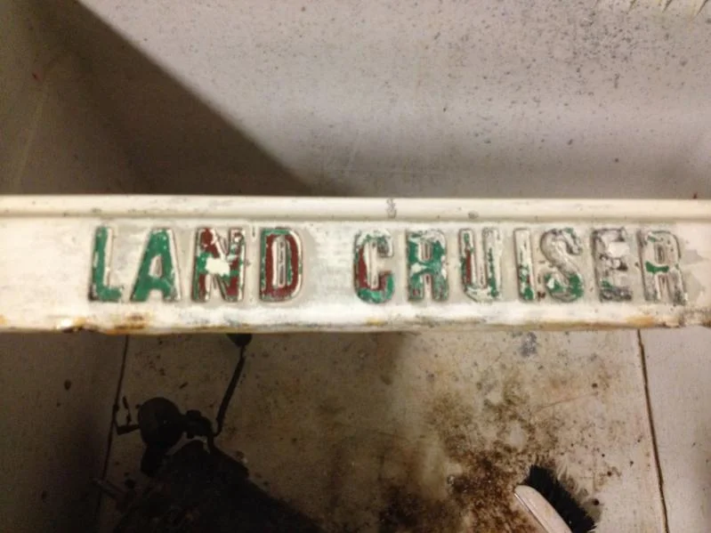

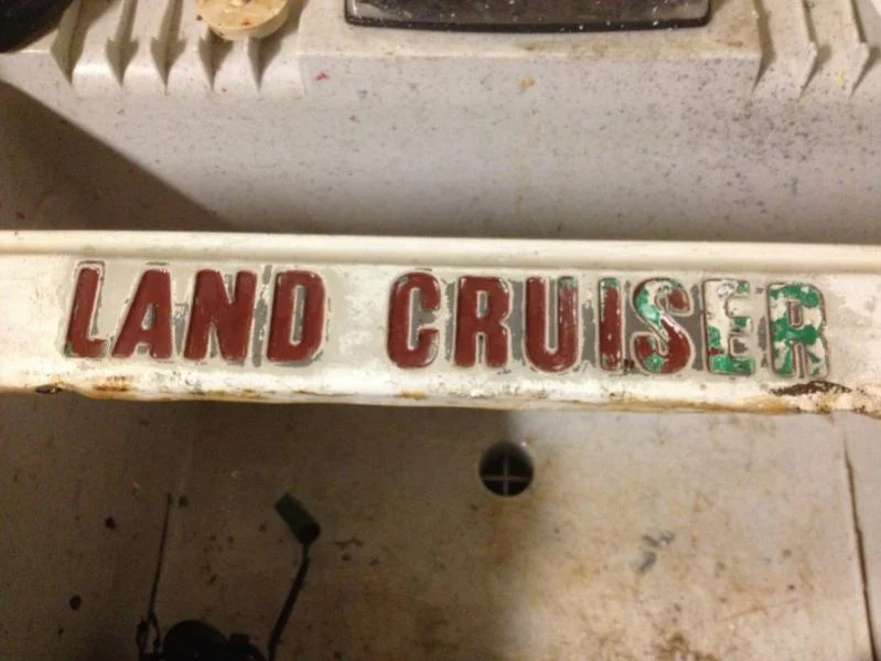

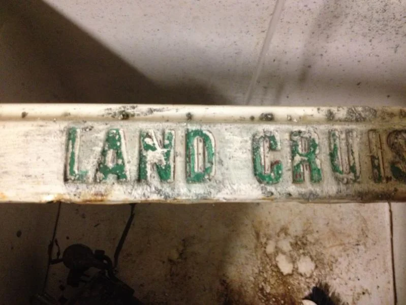

The green was close to what appears to be the original color. But of course I've read where the maroon color is correct.

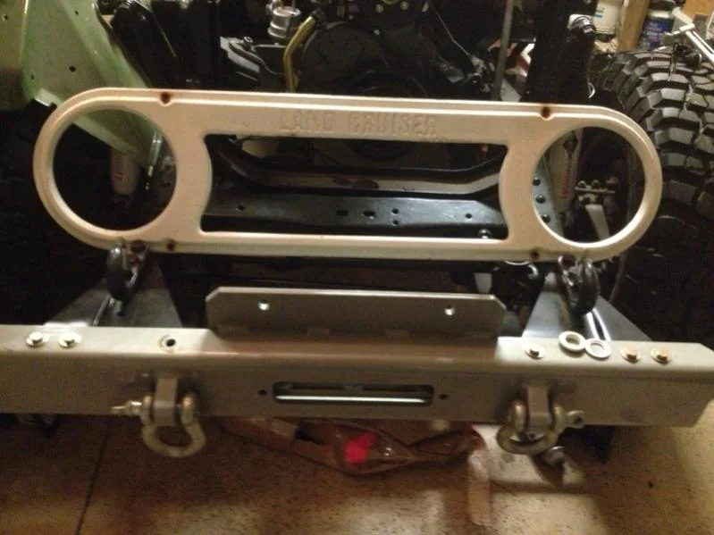

Funny thing the "white" part of bezel appears more gray than I would have guessed.

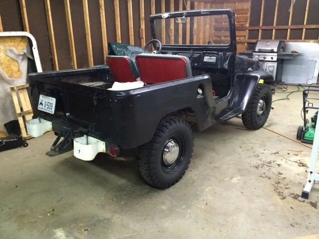

The body of truck is black, blue, green and red (oh yeah and rust too ; )
This is a popular misconception. Older bezels, and older tops are not a pure white at all...but yet people go for a white-white when restoring, so the truth gets lost after many years of people using personal choices, over researched fact, when restoring.

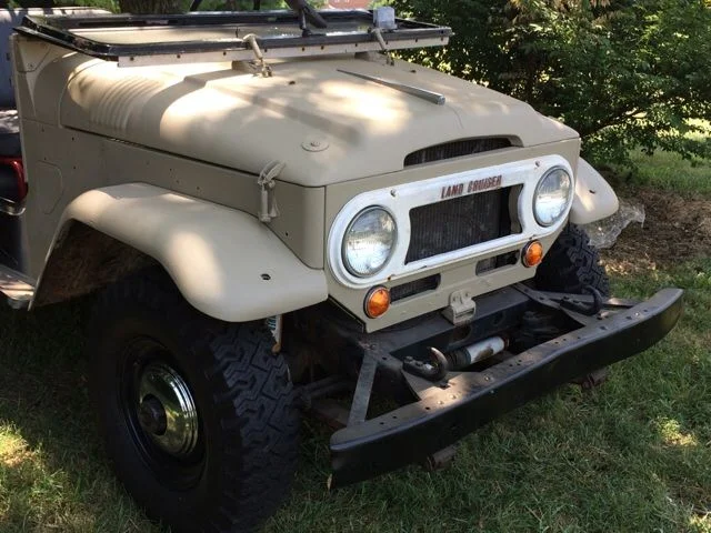

I don't have the OEM front indicators. I know I can still get the one-sided turn signals or hold out for someone with a decent set for sale
Good luck finding a decent set of early two sided turn signals. It's not the housing as much as the lenses. If you look at the thread on the lenses I was the first one to sign up and still haven't got any. Probably run the single sided ones since I have a few sets. One new and the other like new and good it good.
For the lenses you can try the company streetlens in Australia. Sean tried to have the lenses made there but for some reason they didn't come to business. I don't know why. I think he has put a lot of time in it. Too bad it didn't turn out.
They did make a test run though and they sold a couple on eBay. I have a set. Not an exact match because the front and rear lens are identical only the color is different. The original lenses are different front and rear I read somewhere.
Iirc they had about 8 sets, don't know if they sold them all. And they should have the moldings.
Anyway now I have a set of lenses but no housings.
