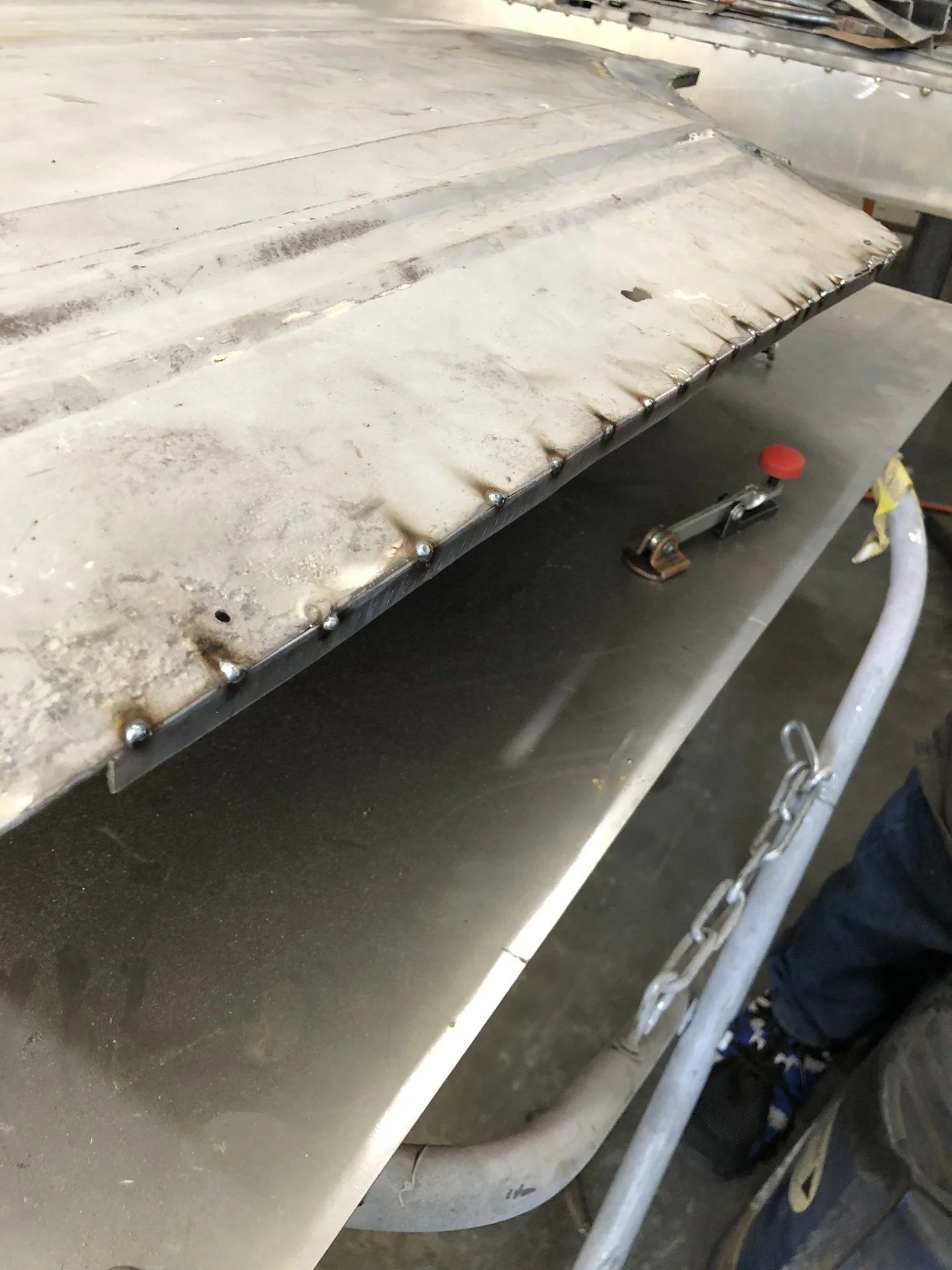

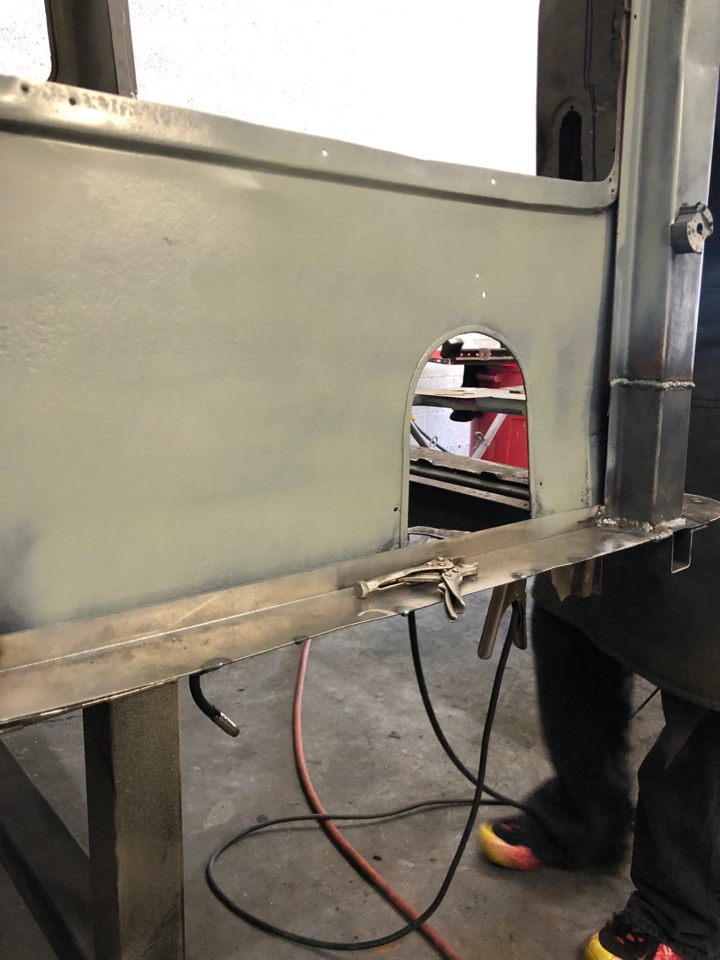

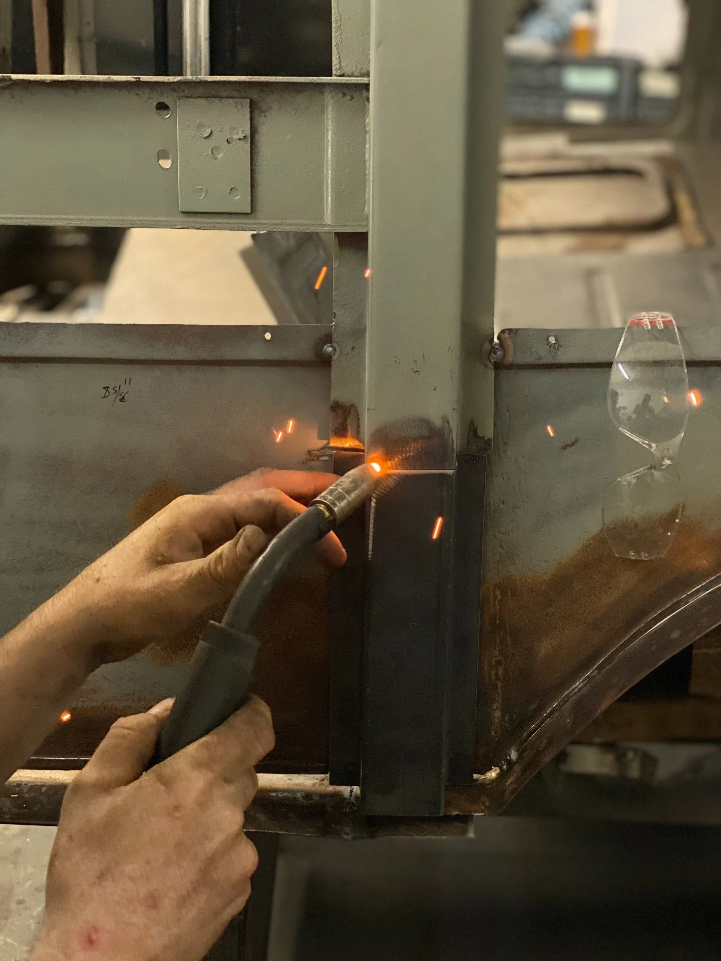

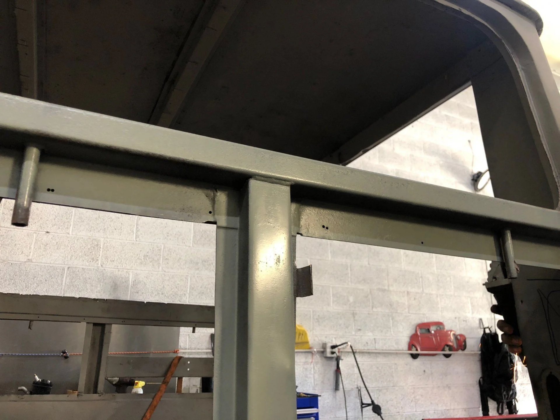

On to Lara... body guy has still been at work but moving a little slowly lately due to being shorthanded (understandable) but I did get some updates today. They've removed both quarter panels now and pounding them out to remove all the bumps and bruises, as well as filling in some of the holes the PO drilled for whatever reason. They've also started adding the bracing that we had made to replace all the bad body braces, still a TON of cleaning up to do but getting there... the body braces will certainly be better than new so I'm happy we took everything apart to get at all the cancer.

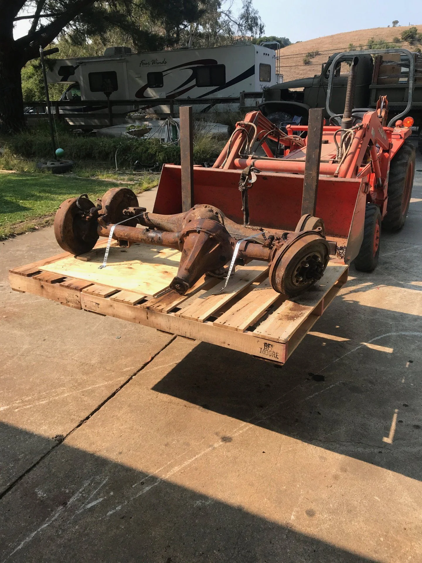

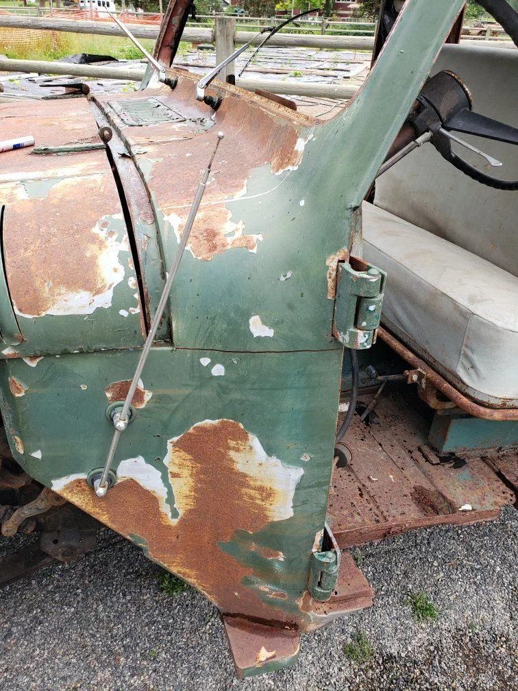

Also infinite thanks to @whitey45 for these 25 axles which should hopefully be at the shop middle of next week sometime, shortly before I get back to start working on them. And to @crawlin cruiser for this LV cowl piece that will hopefully arrive soon too to replace the beat-up driver side piece on Lara. Will have to patch in the kick vent - isn't it odd that the 28L had a kick vent but the 45LV did not? Wonder what the board room story was there. Like I said before this restoration wouldn't be possible without the mud community. Thank you all for both your knowledge and your rusty gold!

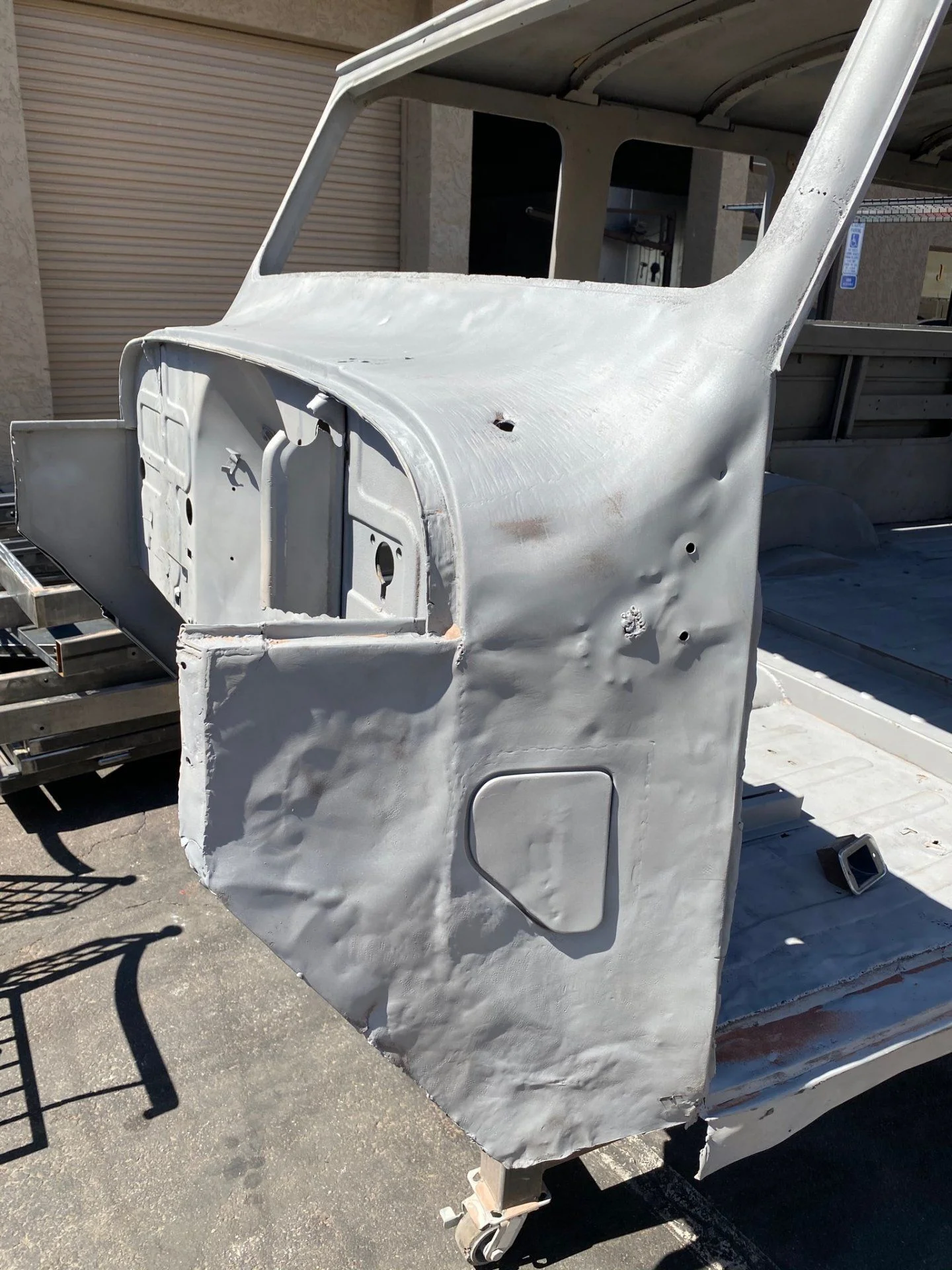

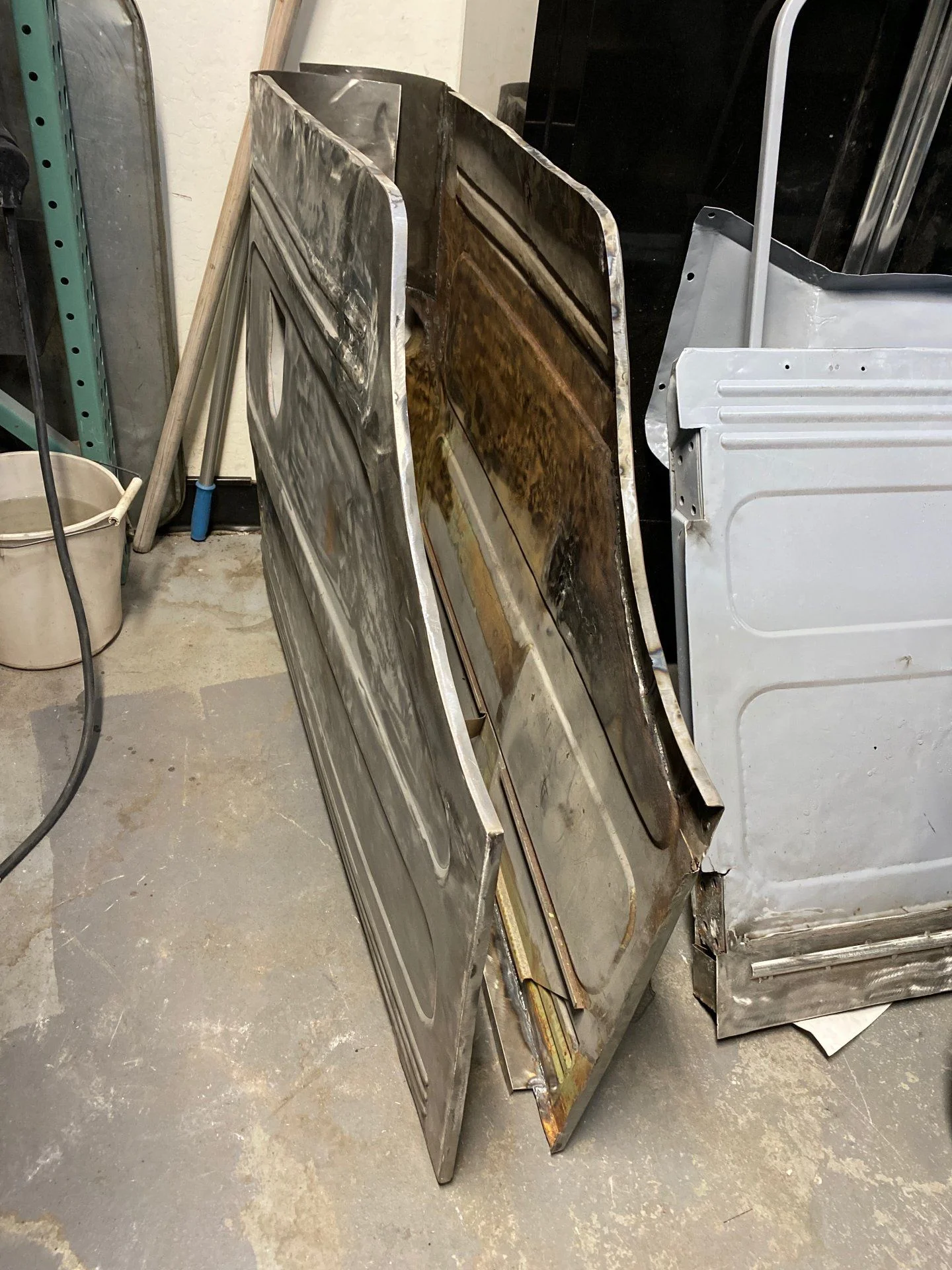

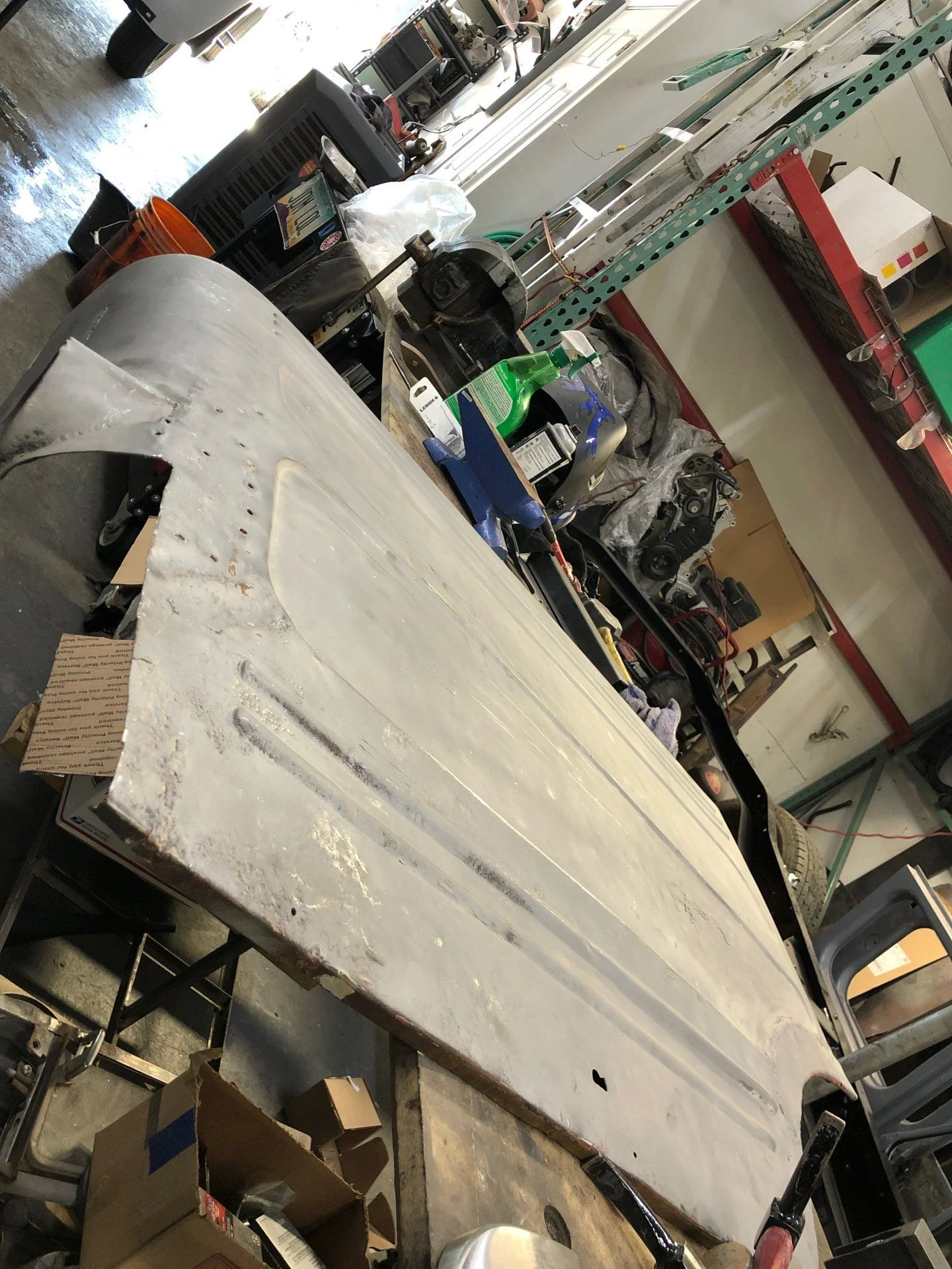

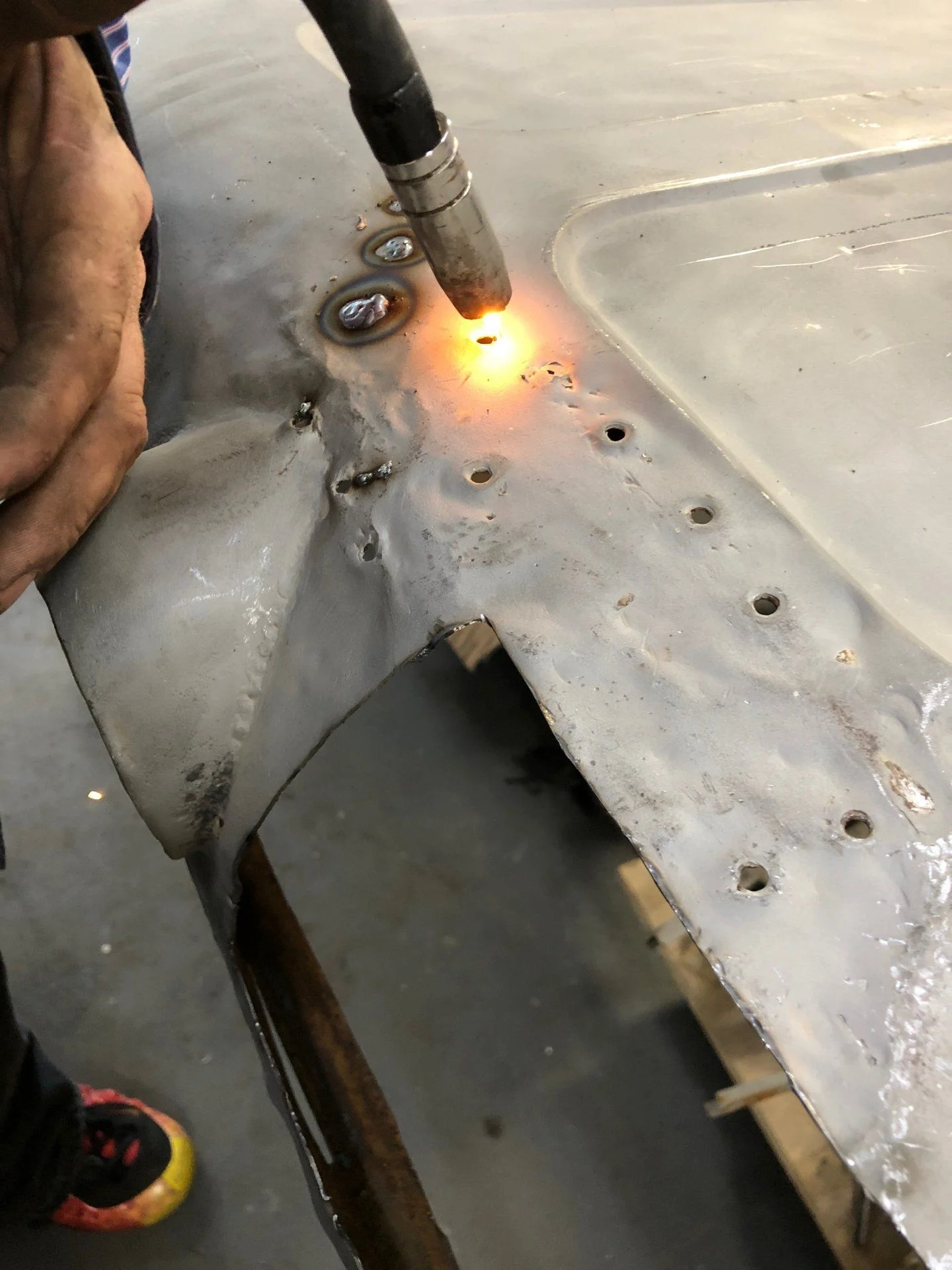

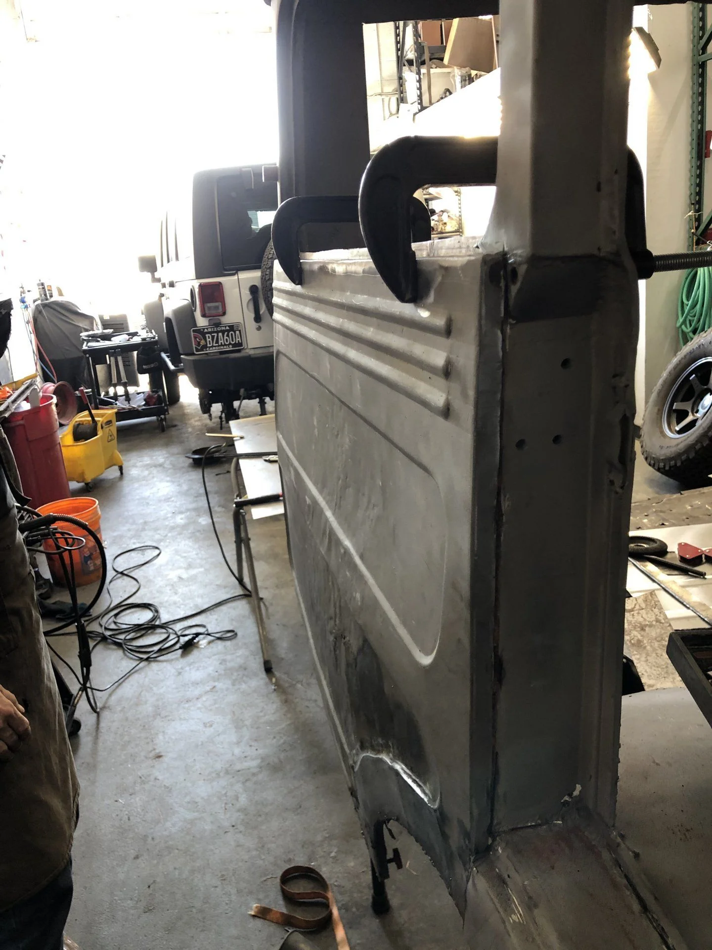

Finally back home and was able to stop by the shop this morning to check on the progress. One quarter panel down, still a little clean-up to do on it but all the metal is solid now and it looks pretty great! The window sill lip on this one was awful as was the lip on the bottom, looks really good now. Cut out the terrible patch job in the rear quarter and replaced with new, filled all the holes, prepped and ready to go.

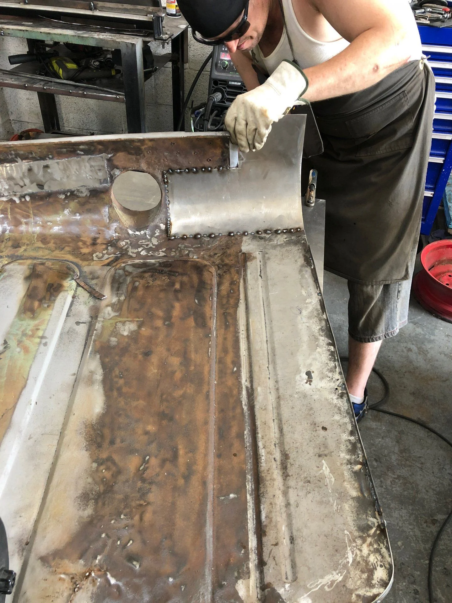

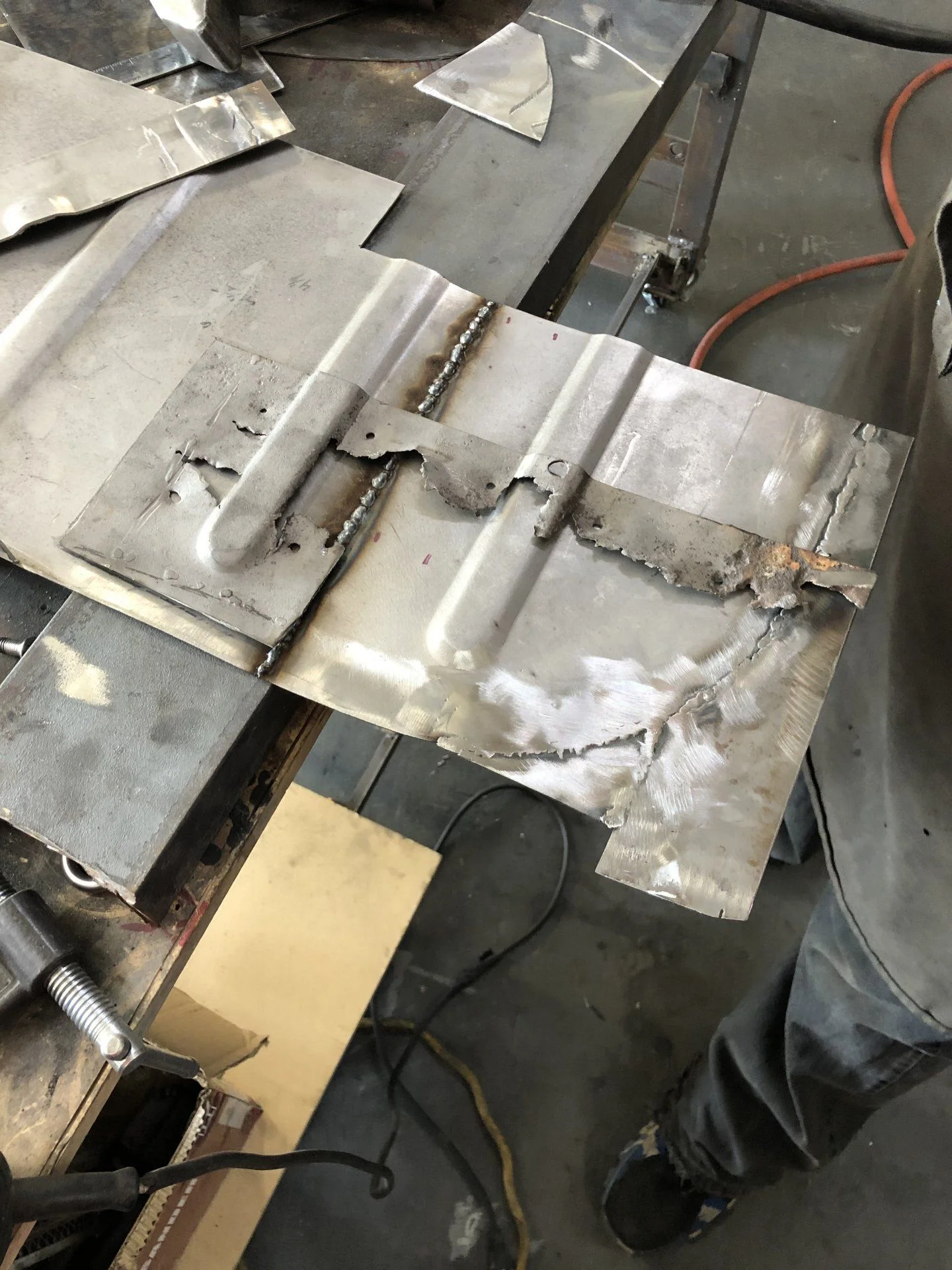

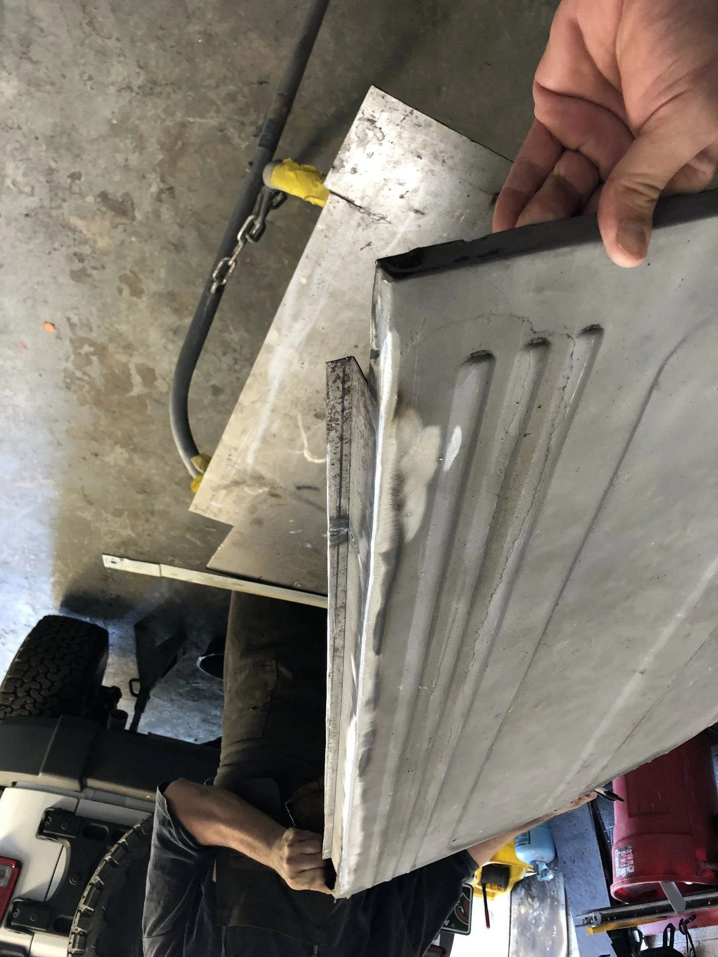

So we're now done with the 4 main doors, and one rear quarter panel. Still have to do the other quarter panel (slightly better shape than the one finished), ambulance doors, the floors and that awful front driver side cowl. I feel like we've been working on this like crazy but then when I stop and think about it I realize how far we still have left to go. Got patch panels for the front floors so we should be ok there, the rear floors I ordered a couple of patch panels from the FJ40 wheel wells, as it looks like the closest match to the "ribs" on the floor of the 28 so I'm waiting for those to arrive and crossing my fingers that it's a good match. We need about a 2ft x 4ft section but the 28 has a floor that's not like any other cruiser I've seen so hopefully that will work.
Going to start digging into the axles hopefully first part of next week if I can get some time in the shop!

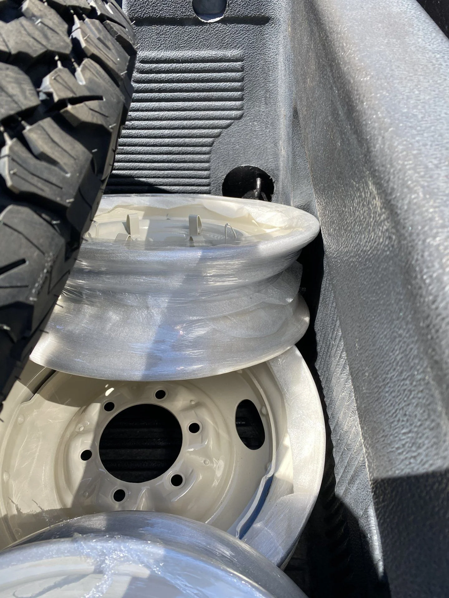

Teaser photos, got the 25 wheels back from powdercoat... one of the two body colors is going to be very close to the cygnus white. Dropping them off to get mounted to some Coker STA Super Traxion 6.5-16's now.

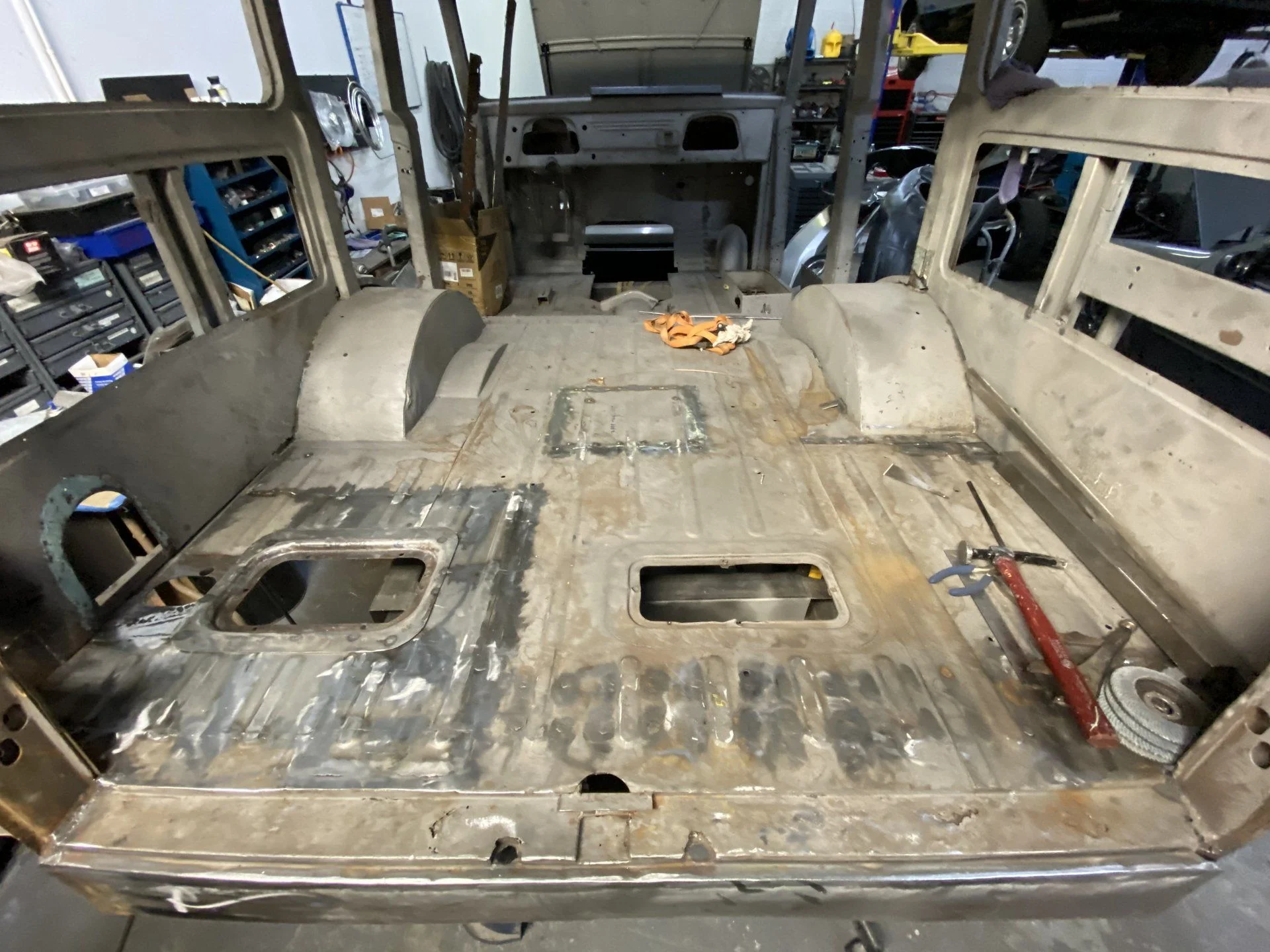

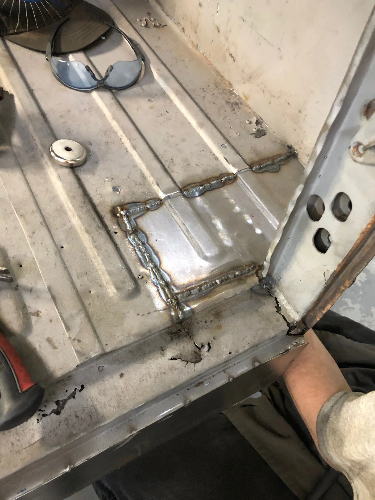

While I'm still not getting any work done personally on this project this summer due to the heat and ongoing school shutdowns, we did get some patch panels in that I was I guess hopeful but not optimistic would work for the rear floors. They are actually wheel well patches I got from CCOT, they passed the eye test to match the floor ribs so I figured it was worth the risk and ordered some - voila, perfect match! Nice to catch a break now and then.
also finished all the new body braces that needed to be cut in. Quarter panels are done and the body is going to start coming together now (finally)

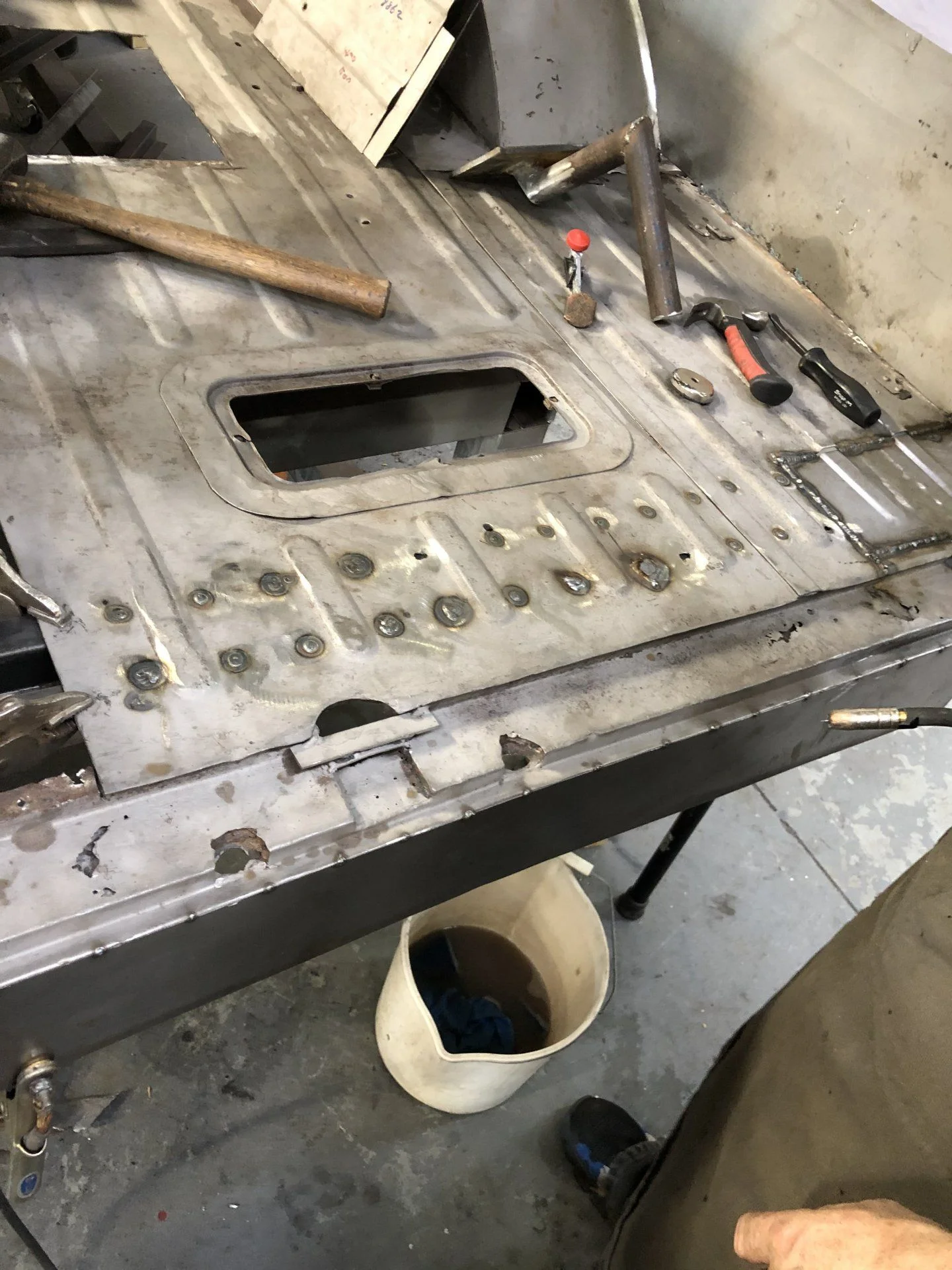

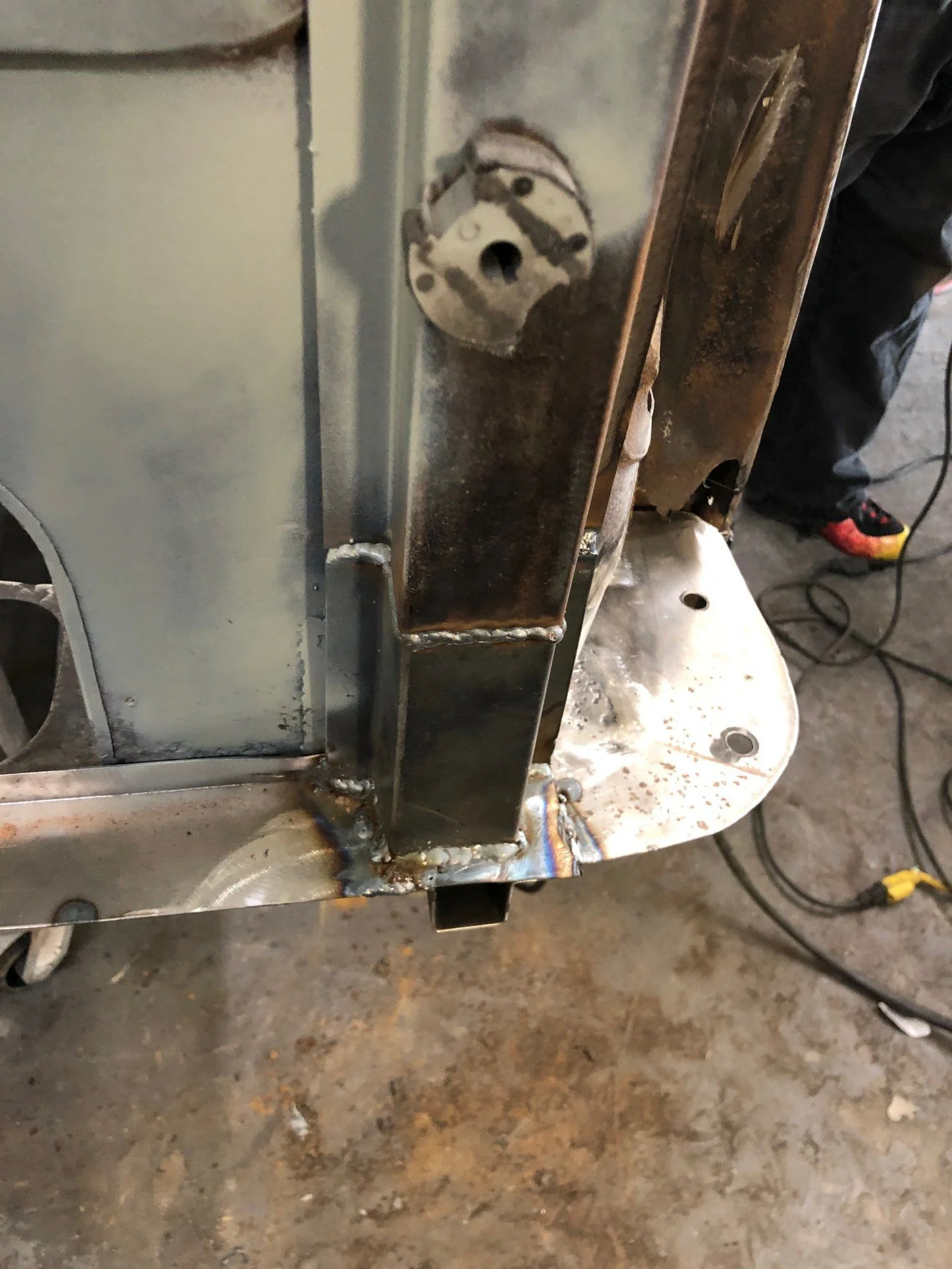

A few updates from the body shop. The rear floor is finally coming together. Had to replace almost all of the body braces beneath the rear and quite a bit of the ones behind the quarter panels too. Decided to keep both access doors in the rear floor (only the one over the fuel sending unit was original) and just clean up the homemade one. I’m not thrilled about the speed at times but the work is all quality. Plenty of cleaning up to do certainly but we are getting back to solid metal everywhere now.

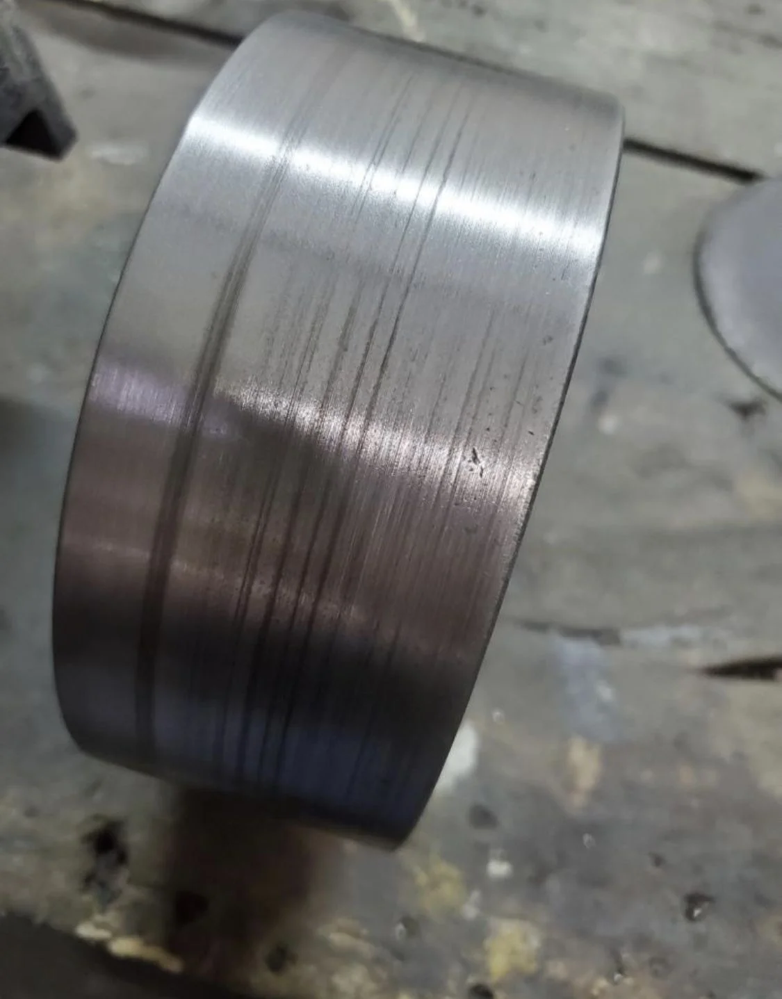

Good info on wheel cylinders and master cylinders
