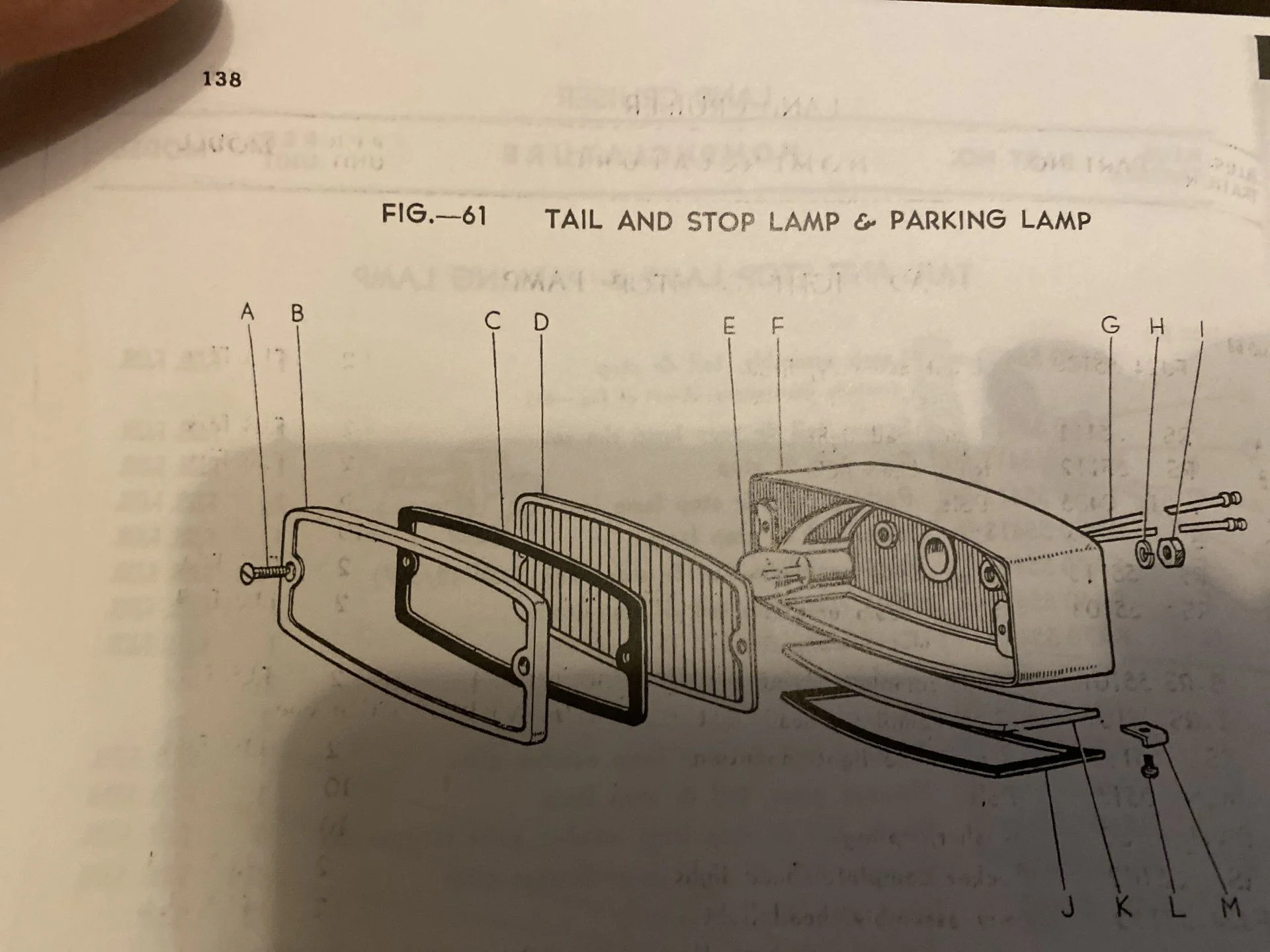

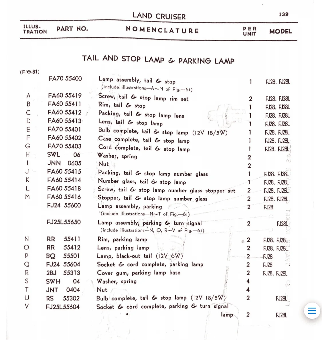

While i am waiting to get the body work moving again, here’s a happier little update. I Found this in Japan recently - a NOS tail light / license plate light for the 28! Lara had her original one surprisingly but it’s a little bit mangled and the lens has been replaced. Could have restored it certainly (and probably still will) but what are the odds of something like this popping up? Pretty amazing, couldn’t pass it up!
Beautiful lamp--great find ! Was it ever used on any other vehicles?
Not completely sure but the 28 parts manual just shows it as a 28 part number.
Edit: thanks Bear, I was only paying attention to the far right column but looks like this is shared with the FA trucks too, based on the PN.

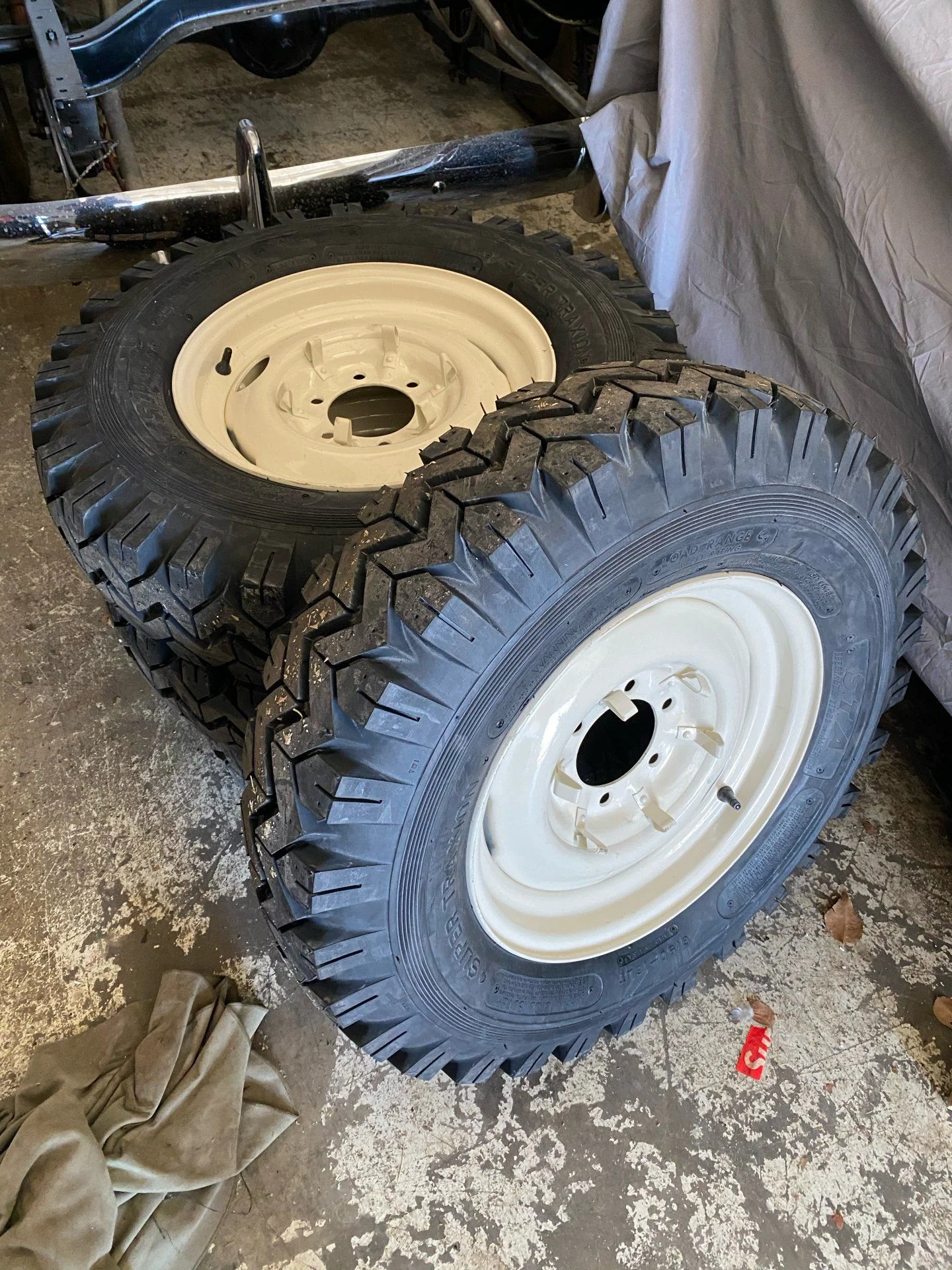

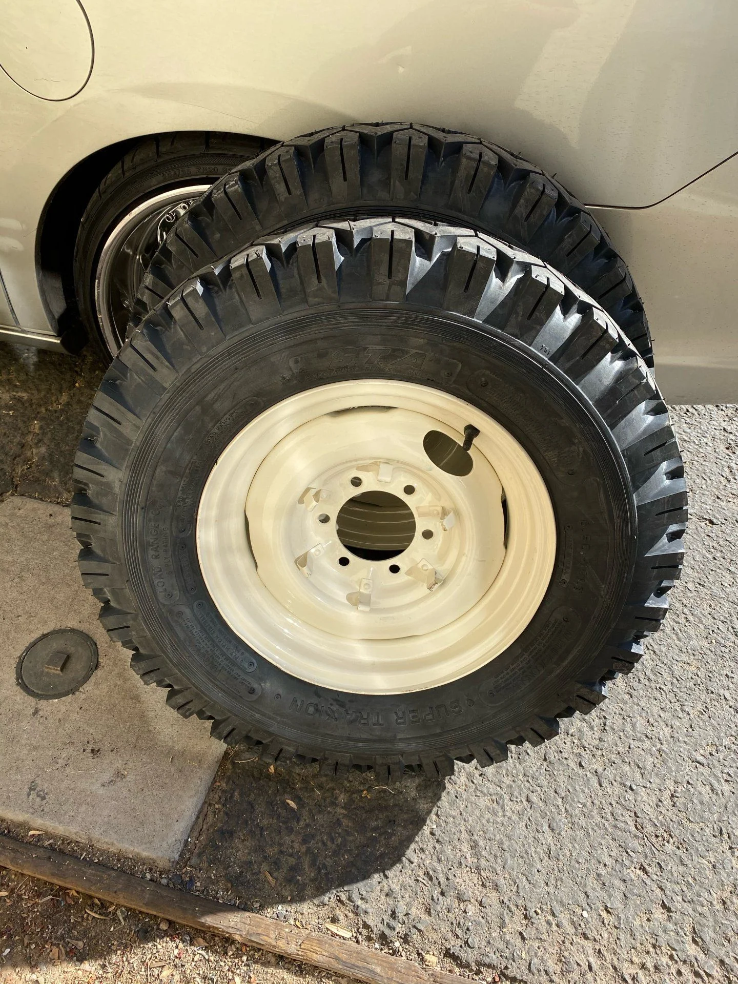

Did you ever get the new Cocker Super Traxion tires mounted? If so, do you have a photo? I have been trying to decide what to go with on the 1958 FJ25 and I think those might be the ones I want.
I did. I really like the look but it’s of course personal preference...
