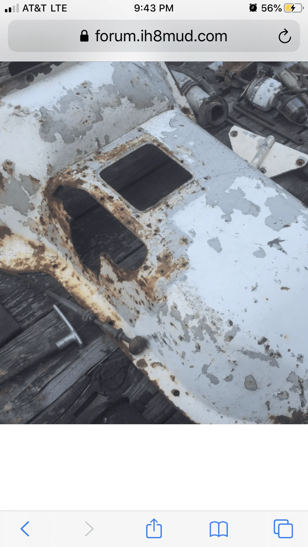

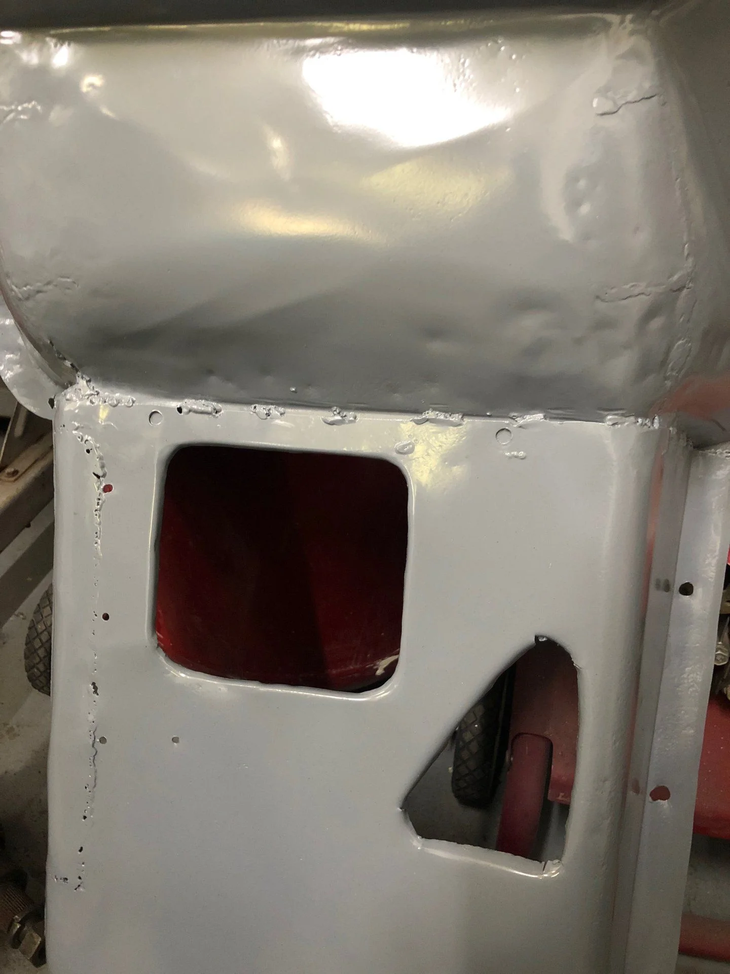

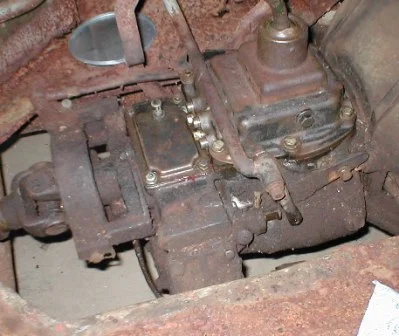

I did just post a wanted ad for an FJ25 transmission. I see what they did to it now. For some reason they removed the linkage that moves the transfer shift lever over to a long oval hole on the left side (that you can see they welded shut), and the lever is now on the right side (and they cut that triangular hole in the bump). I'm guessing at the same time they removed the ebrake assembly as well, who knows why. At any rate, I'm not optimistic I'll ever find just that setup, and only slightly less optimistic that I'll find a transmission but if anybody has a lead please let me know. Makes me a little sick to think about finishing this thing with that stuff missing.
They also obviously hacked this hump up over the years and we will need to get it cleaned up.

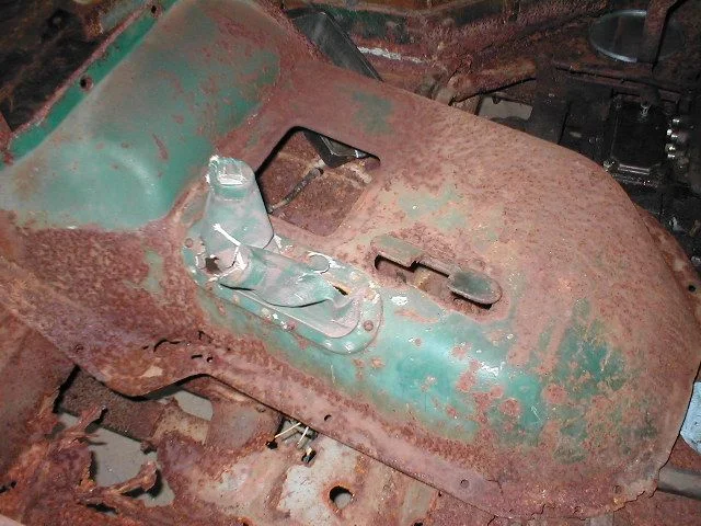

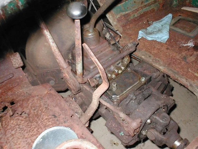

That hump used to have the operating lever and brake on the left like the US model, so I would guess the right side setup is a hack. Someone might have a hump and transfer lever setup for the left side, and maybe even some of the brake hardware.;) Attached are a couple photos so you know what you're looking for, ingore the flat bar and oval shift door, that's a PTO and you aren't finding one of those.
I was suspicious of the smooth (not ribbed) transfer case cover, more so now that I realize the fill plug is on the top not bottom, you don't want that much oil in your transfer.

Great photos thank you. You can see in your photo how there’s an arm that takes the transfer case lever to the driver side, as well as all of the ebrake assembly that I’m missing.
Yeah they hacked this trans hump up. I’m sure the farmer that had this thing didn’t think anything other than he was just keeping it on the road.
Nothing is really wrong with the transmission itself, I just don’t know if I’ll find the missing pieces without finding an entire transmission/tcase setup. It drove before we disassembled so it’s functional, but i don’t want to go halfway with it - getting the ebrake and transfer case the way it’s supposed to be is a priority. I’m not sure about fabricating those missing pieces without having some to template from. But you never know. I’m hoping someone has some laying around. We have lots of time, right now this is the only thing that’s got me kind of stuck. Everything else we are doing pretty good on.

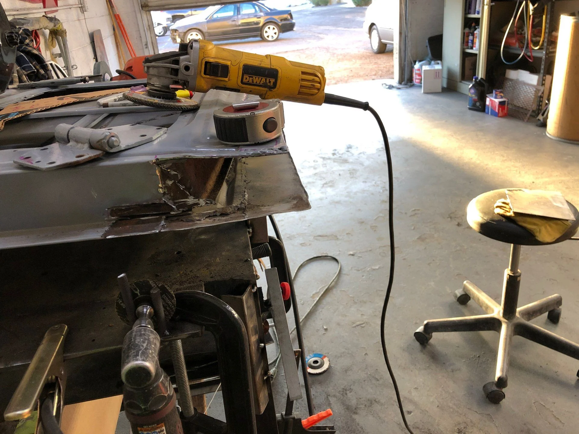

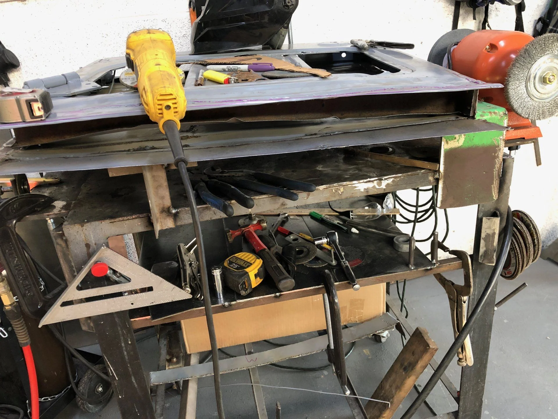

Second door should be finished this week. Seems like we're averaging about a door per week, these were the worst pieces on the truck though so I'm feeling good about the progress. The worst one is done, this one was the second worst. So the remaining 4 maybe won't take too long, though some of the bracing on the front passenger door was cut out for some reason and will need to be fixed.
Getting them to sit right on the body will be a challenge too, the lines are anything but straight right now on the exterior.

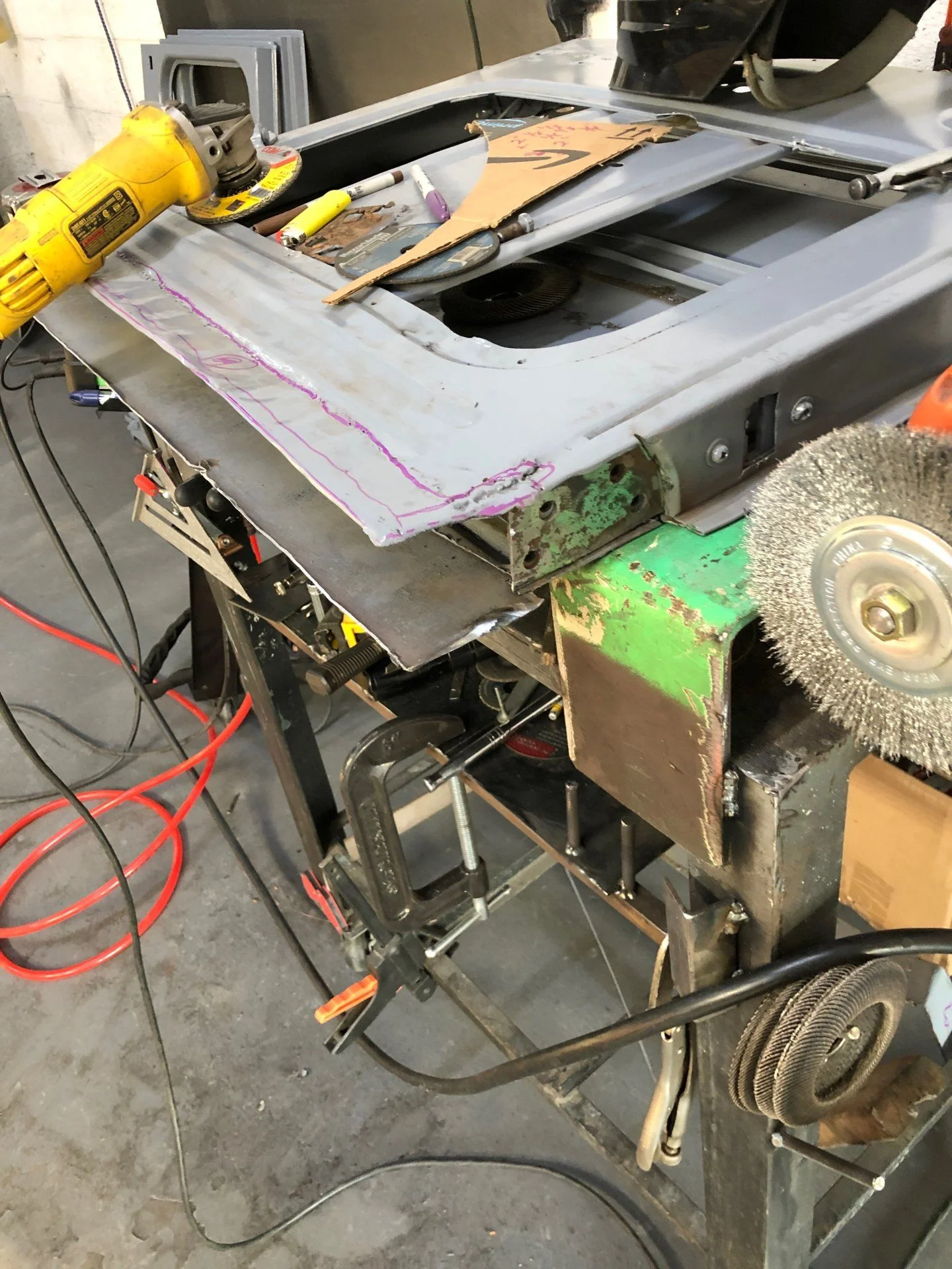

working on the 3rd door now. This one had to cut the entire bottom out, but I think will be simpler to repair than the first two. Progress progress!
Here is an old pic, ebrake hole needs a little work, otherwise pretty darn solid( just have to make sure I have it still’View attachment 2224000

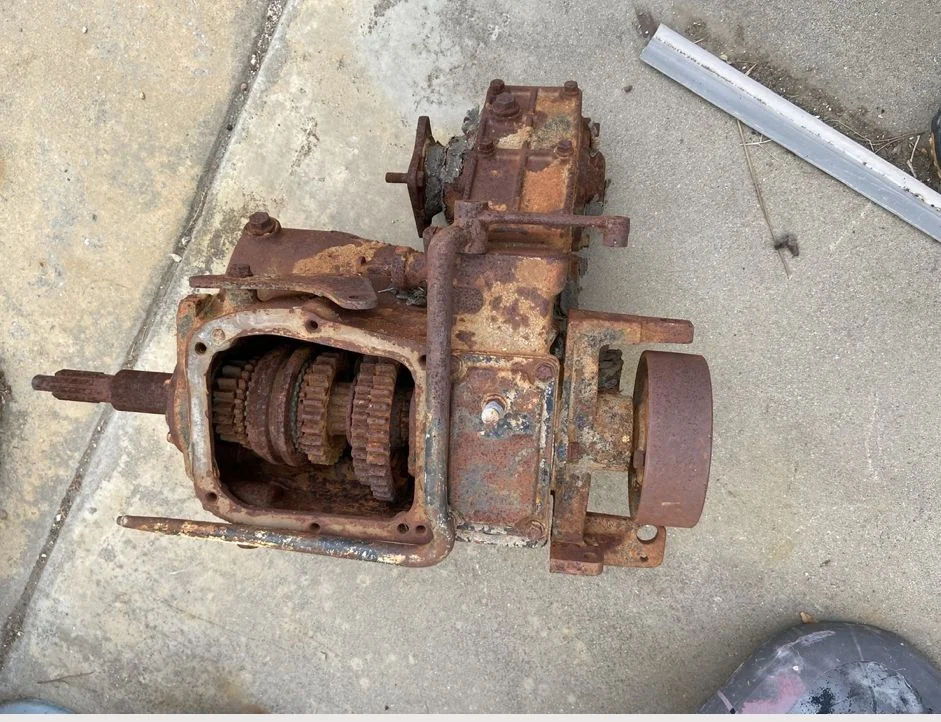

So I’ve got this trans hump on the way, thank you @whitey45 ! And a rusted out trans from @65swb45 that should provide some of my missing transfer/ebrake pieces. Just have to figure out how to get it to Phoenix from Burbank if any mudders have any ideas. Slowly but surely my parts list is shrinking, but I’m not so foolish as to think it won’t start growing again at some point! I think the biggest piece left to get right now is a 1960 F135, but I do have a few leads. Just being patient for now.

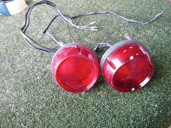

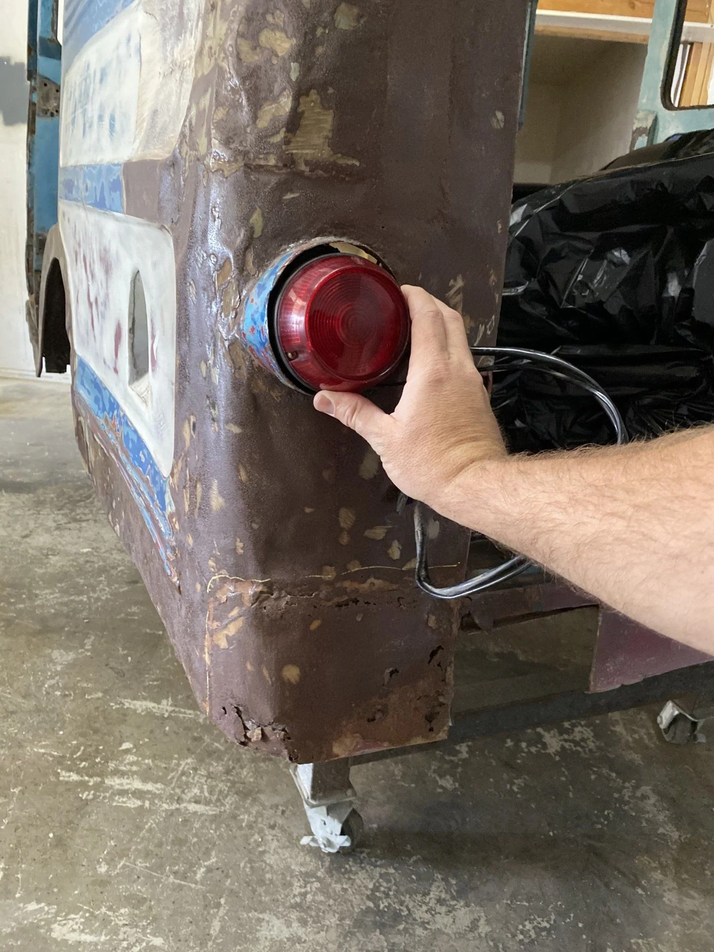

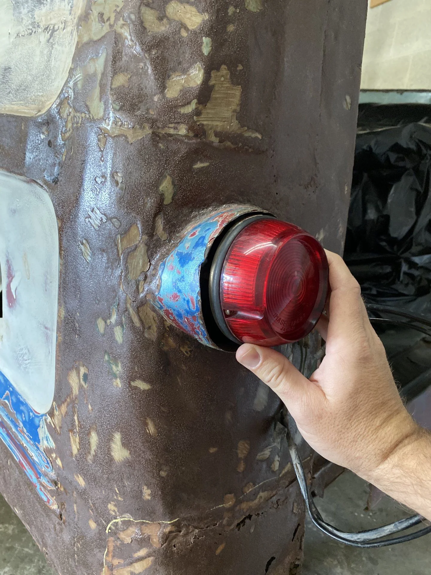

Tried out the new tail lights this morning, they're too small but I really like the look they're a pretty close match to what Toyota had on the pink 28VA so I think we will try to make it work. The opening in the body is about 105mm, the light is about 98mm so its close enough that we should be able to fill it by building some kind of a bezel I think. Such a long ways to go from being ready to mount these, but its nice to cross a part off the list... these came from a Yahoo Japan auction, and I believe are from an old Mitsubishi J24 jeep.
Other nice thing is these are combination lamps, so they'll be able to function as run/brake/turn signals.
