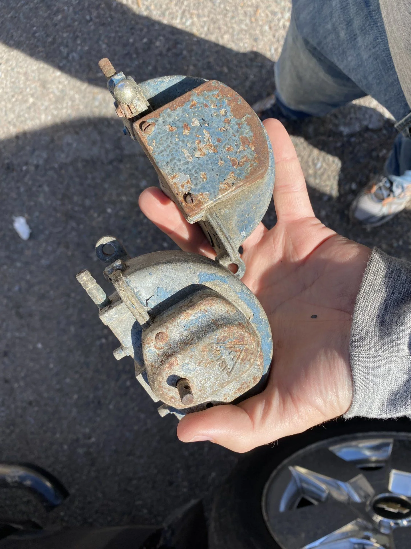

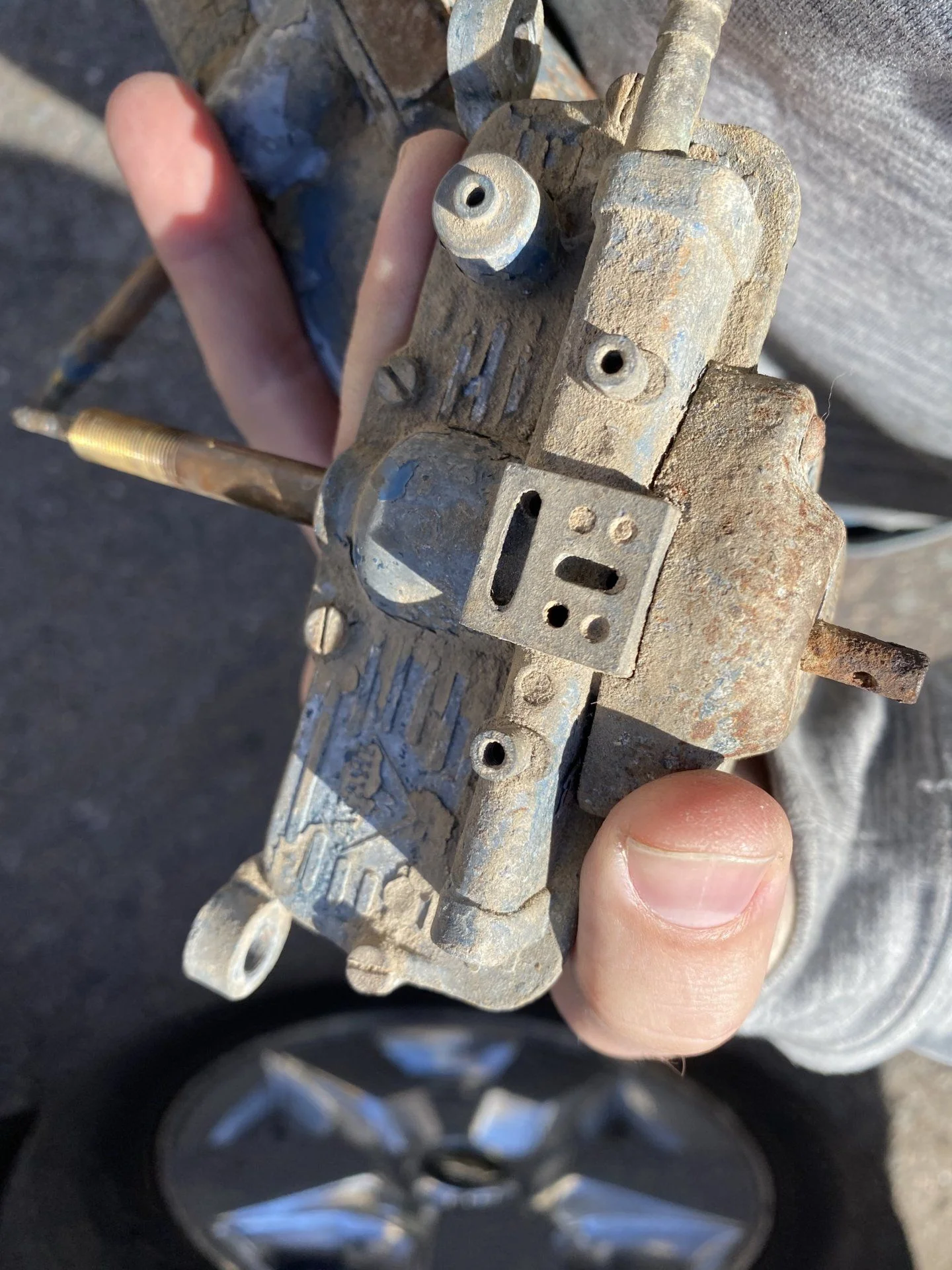

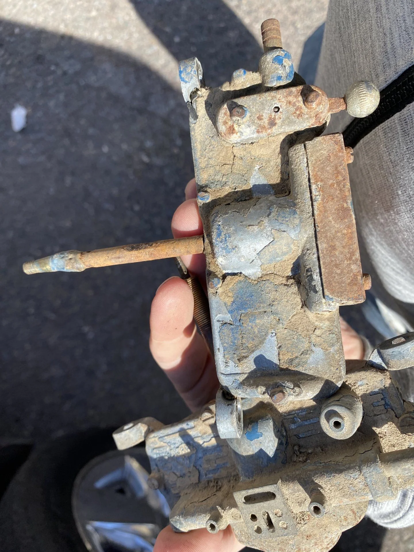

I noticed the lever to turn them on and off is different. The shaft the wiper arm attaches to seems a lot shorter. Seen some early photos or possibly art work with wipers on the bottom. Possibly from some other version or some other vehicle completely.
Good eye! It is a little different. I have a feeling this is a part I won’t have when the rest of this build is finished, and I’ll just somehow stumble across a second one a decade from now. Hopefully by then I won’t have misplaced the other one.
Think that little different would prevent it from working unless the FJ28 windshield frame is thinner that a FJ25. You would probably need to make a custom shaft to work. The spring loaded wiper arm needs to extend away from the windshield frame to work correctly. Not a Fan of FB either. I clicked on the link but didn't see any pricing. What was his fake price he was using to lure people in? Do you know what they sold for?

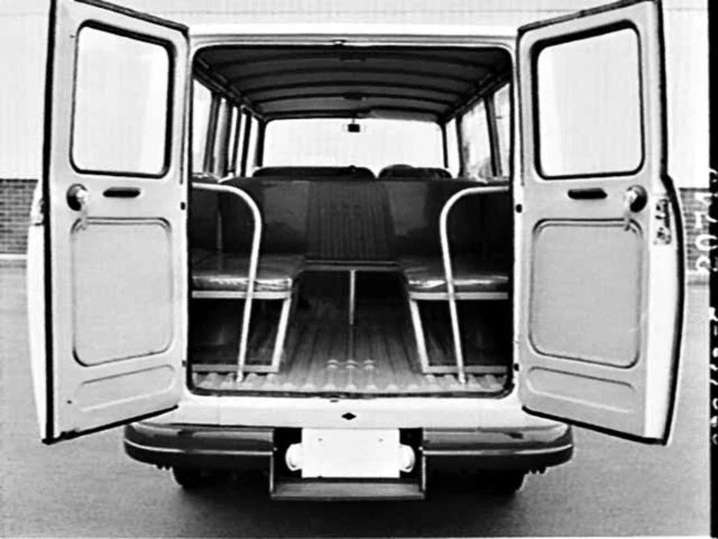

  • Awesome photos of the jail bars in the back, but those "handle bars" just inside the doors are just weird - I can't imagine that was how it came from the factory, but we will look for mounting holes. I also think the jail bar mounting hardware looks very similar to the VW Bus hardware which is readily available.

Looks like the pass seat tilts forward for rear access, makes sense being a 2 door. 4 door would not have that funky lower mounting, but still pretty cool to see these pics. @JohnnyC has been unearthing cruiser pics here for years!

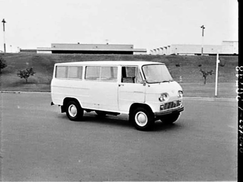

I found a vehicle that shared components... early 60’s Toyopet Dyna
