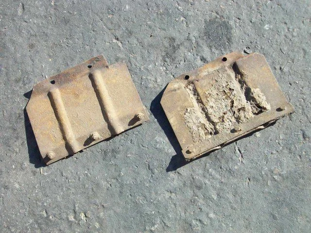

Found this last night( edit: found this photo, not the brackets). Stock FJ45LV mud flap brackets.
Found this last night. Stock FJ45LV mud flap brackets.View attachment 2196485
Antony if you’re willing to part with that set I can promise I’ll make sure to see what it would take to reproduce them for other owners. If you want to hold onto them certainly understand! I’ll PM you.
Whoops I misunderstood this - he was posting a picture of the stock brackets, he doesn't physically have them. I will most likely just replicate what we did on my LV.

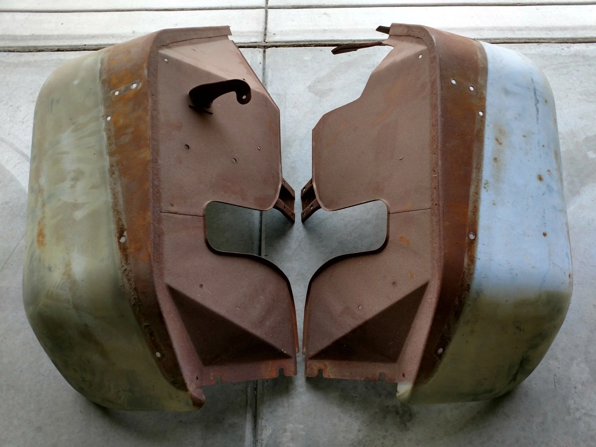

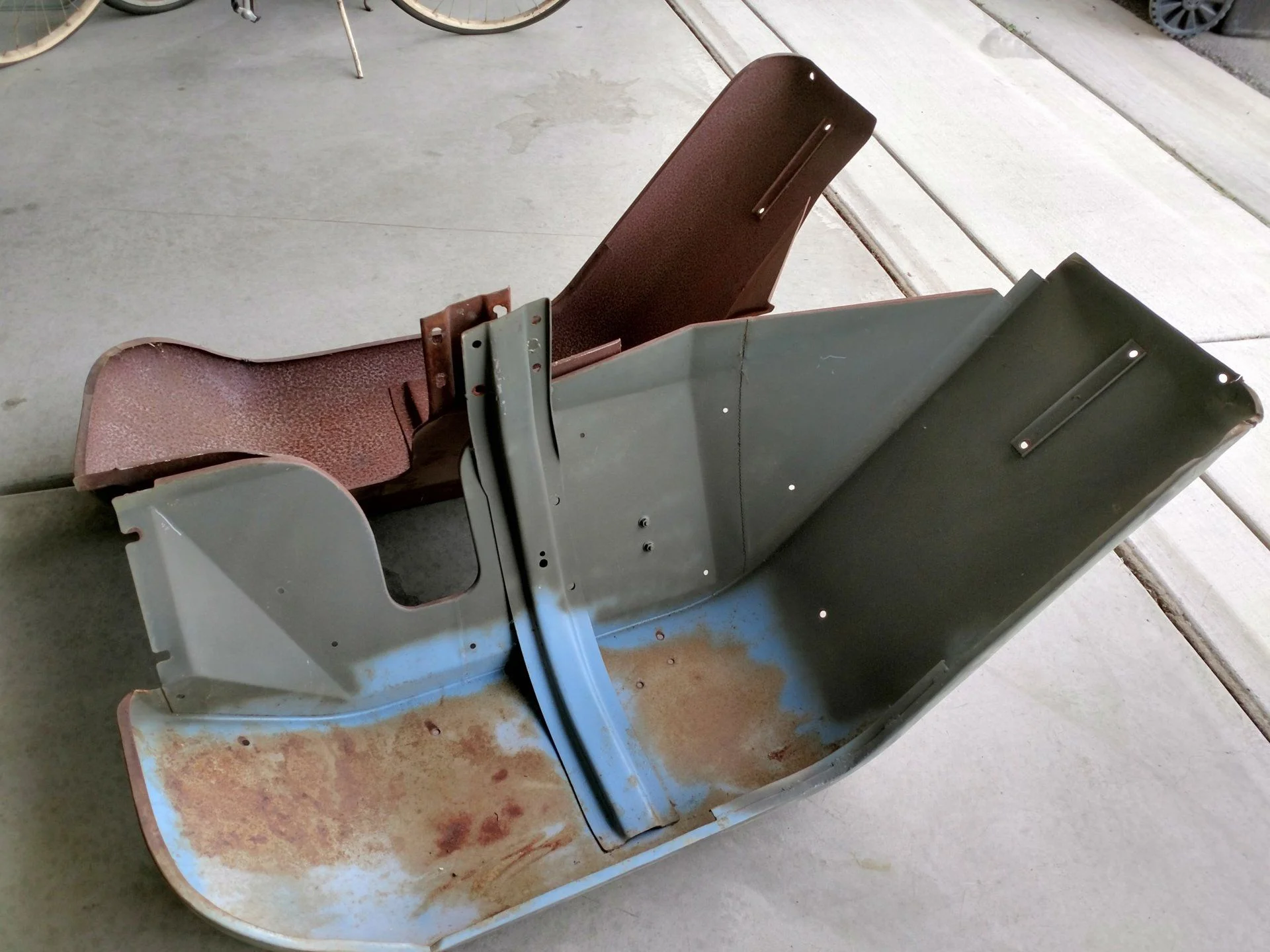

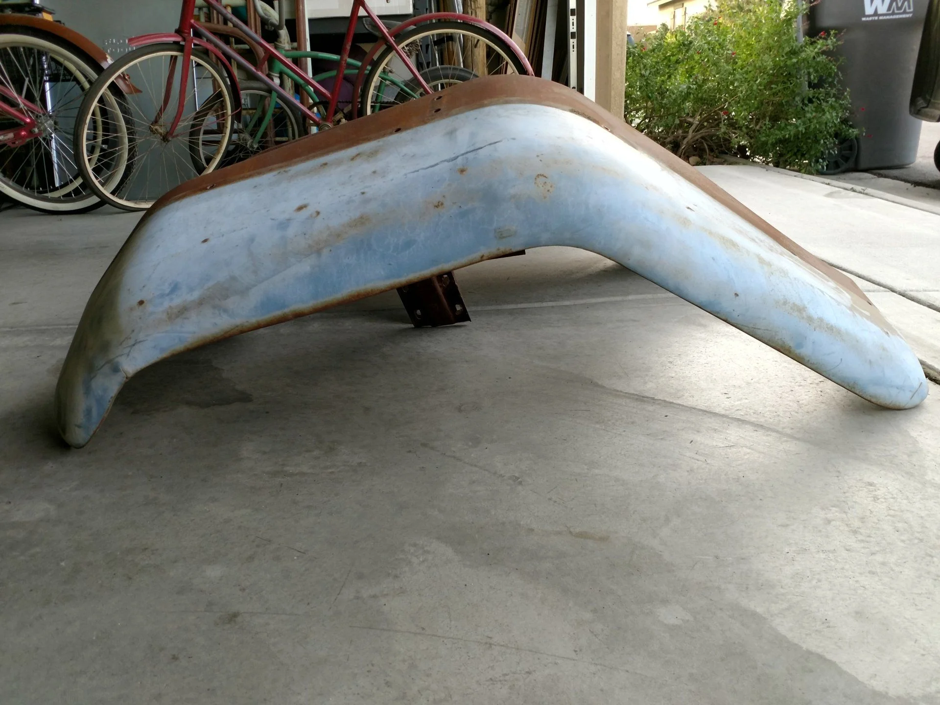

Pulled the 1960 FJ25 fenders down. They really are in great shape. No Bondo, surface rust only. There is a cut out on the driver fender at the steering box, but you can cut that part out of yours and weld it in.
