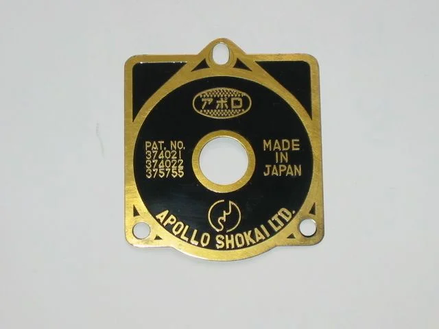

You may be interested in this ... I just found this recently... the Apollo winker switch plate (I do not own... just have the picture)
This could be reproduced

that switch sticker is too cool - @JohnnyC i agree would be neat to get that reproduced.

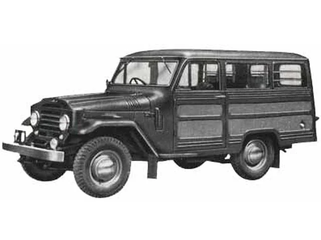

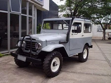

Thought about a scheme more like your lv? The one illustration of the 2 door seems to show that type of scheme.....or maybe skip the white and go with color on color or maybe even a grey with a darker color. Some of the actual pictures seem like the inset panels May have been White or cream and others seem darker than a white https://forum.ih8mud.com/attachments/3-jpg.2185773/

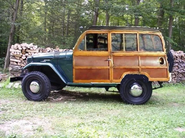

Who needs color when you can just go all out woody
@Cruiser_Nerd ‘s .... ummm photochop dare I say almost as good as some stuff I had seen from toyota lol
And BTW if you wondered why toyota made a body like the 28 wagon ... here is its predecessor Toyopet
Late 40’s-52’ Toyopet SB wagon Truck
