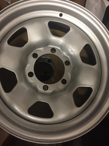

Try 4wheelparts.com. I bought black steel 17" Pro Comp wheels with BFG MT's for a decent price. They knew the correct backspacing for Cruisers.
