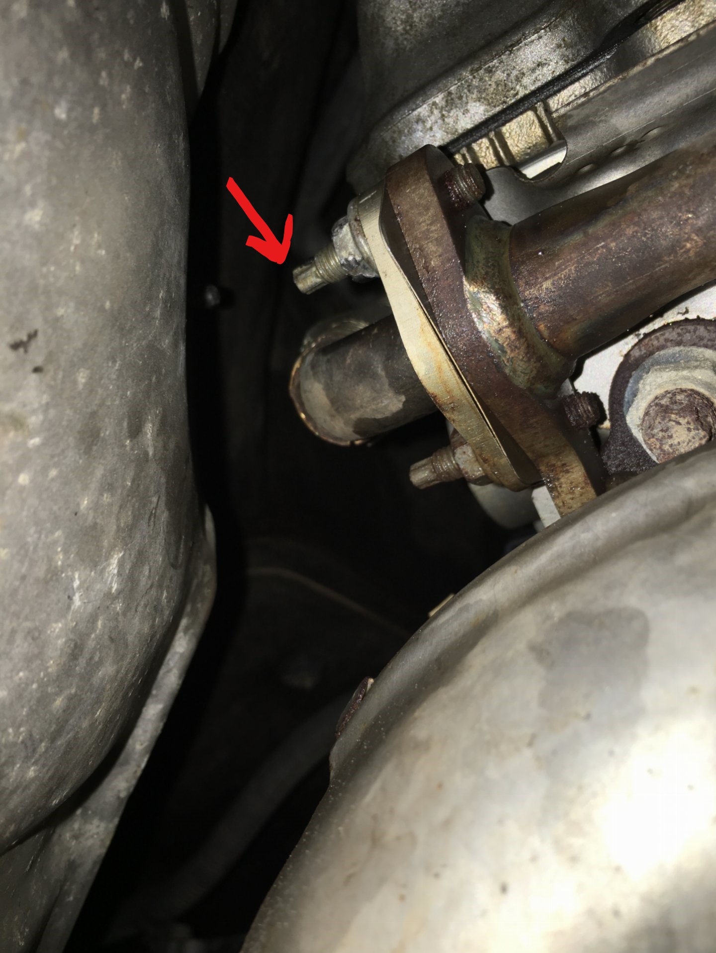

I've had my kit for a few months now and am just getting around to installing it. The control box went in well but needed extra washers in between it and the bracket to keep the pigtails off the bracket edge. I also put some plastic wire loom protector tube on the two plug pigtail to keep them from wearing through on the bracket too.

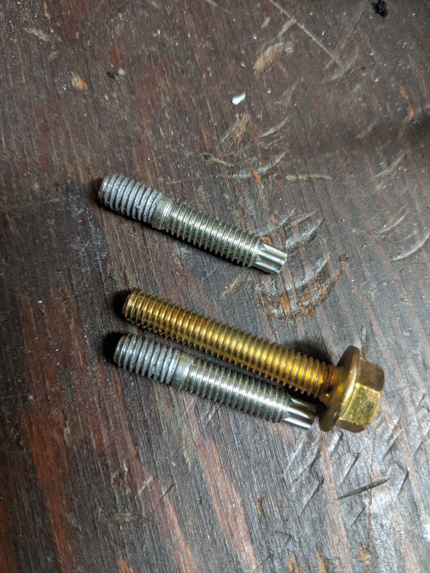

I had the same problem with the nut as @M3gilly did. The passenger side, outside nut rounded, an Irwin Ez Out nut extractor didn't work to remove the rounded nut. There is no room in there to work. I ended removing the firewall downpipe's heat shield for a little more room.
It looks like @jerryb posted up its an M6x1.0 stud. However, his pic looks like the two ends of the stud are of a different thread pitch. Maybe its the anti seize that makes it look that way.
Even if they are the same pitch though, it looks like that collar on the stud is going to make me have to remove the whole passenger side air pipe just to remove the stud in order to replace. I don't see how a bolt of the 30-35mm length will be able to feed in from the back.
What a stupid design. It should have been a through bolt from the front with a nut on the back. That way the hardware could just be cut off and replaced if it seized up.
Anyway,I looked up part numbers for the studs and nuts on Toyota Parts deal, they are show the stud as "Stud, Hex LOBULAR 90126-08002" and two separate nuts, not sure which is for the lower stud but they are; "Nut 90080-17242" & "Nut, Wire Adjusting 90178-A0023".
To any reading this, just go ahead and have these studs & nuts hardware on hand before you start to install the block-off plates, just in case.
a bolt for sure threads through the back, or the front.
the bore on the 2 hole air pipe flange is greater than the width of an m6 stud or bolt with or without threads.
So if you do nothing but put the right socket on the same side that the nut spins on (facing the rear of the car) then it would just spin out all the way out if it was loose.
Likewise you could thread a bolt from the front as long as you also add a nut for a lock against the air pipe flange to drive the gap closed against the plate if you had too long of a stud and got two blocked.

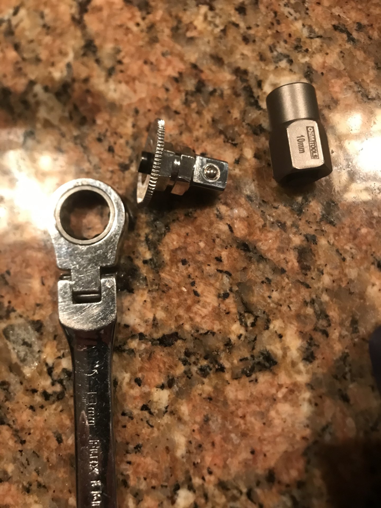

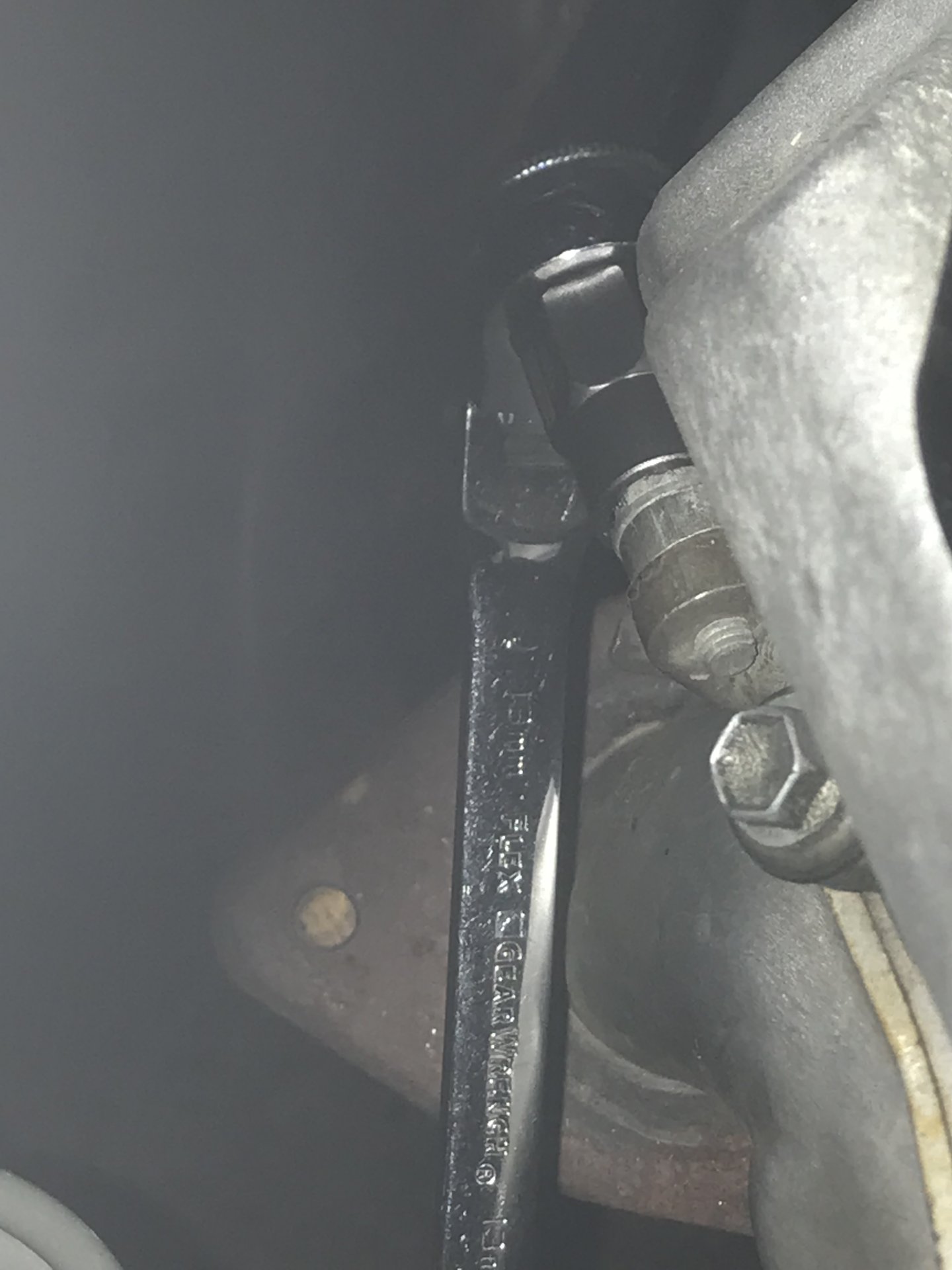

I ended up getting the nut off using the 10mm bolt extractor from AutoZone along with a GearWrench 3/8" adapter and flexible, ratcheting wrench.
The stud stayed put and the threads are still good for reuse.
Conveniently the Autozone kit fills the empty spots in my Irwin Extractor Kit.
Hope this helps someone in the future.
