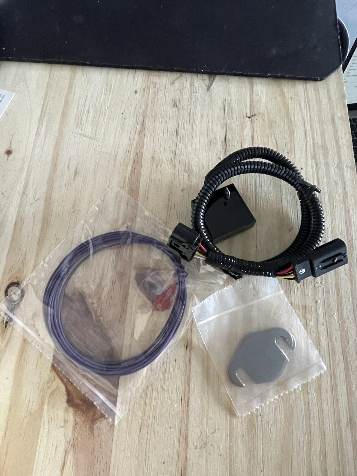

I got my kit today:

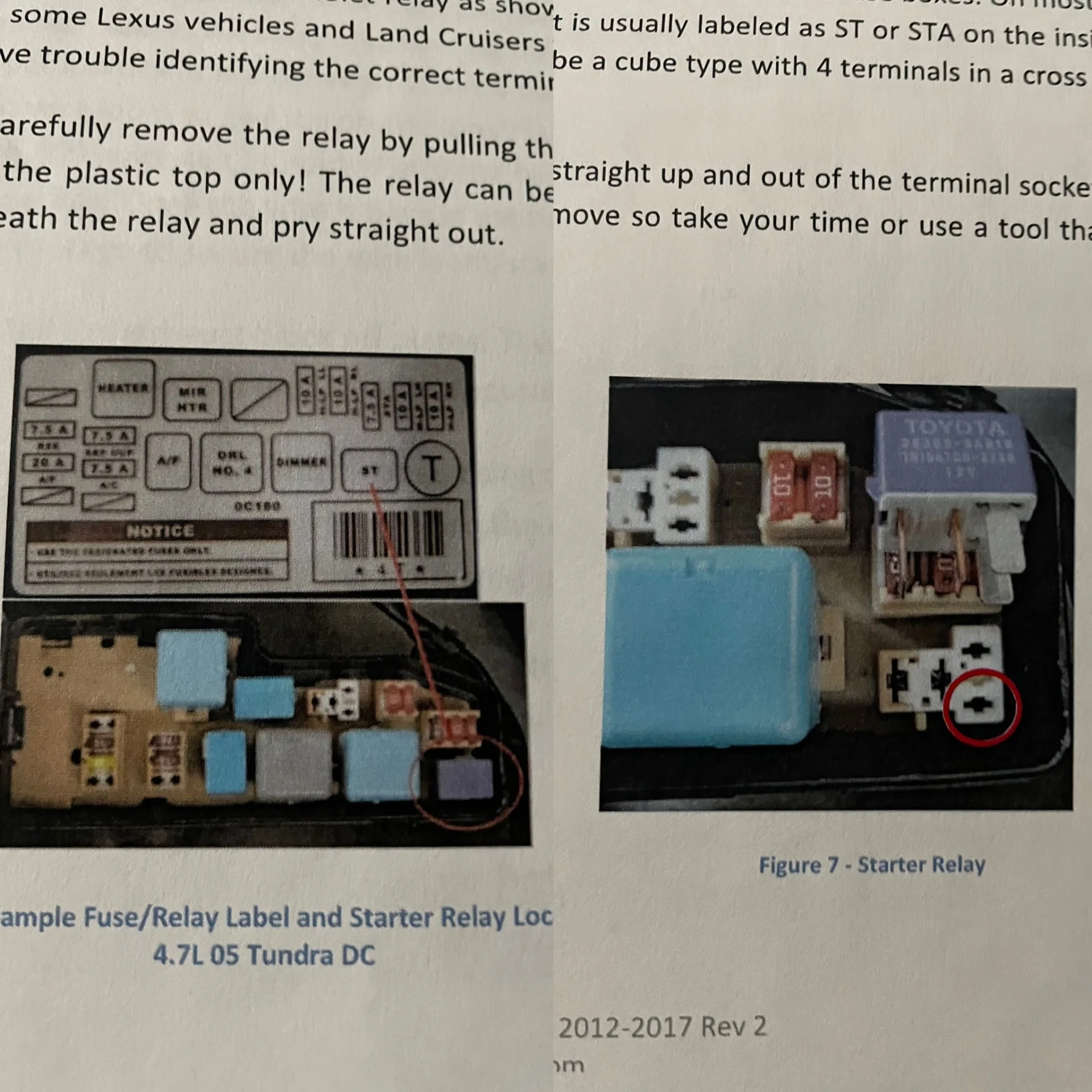

The installation instructions print out say to tap the wire on the “ST” or “STA” or a violet/purple relay, but I don’t see that on my relay box? 🤔
V3647H Kit, I have a 2006 LX
I'm not sure why they just didn't write starter relay in the instructions.

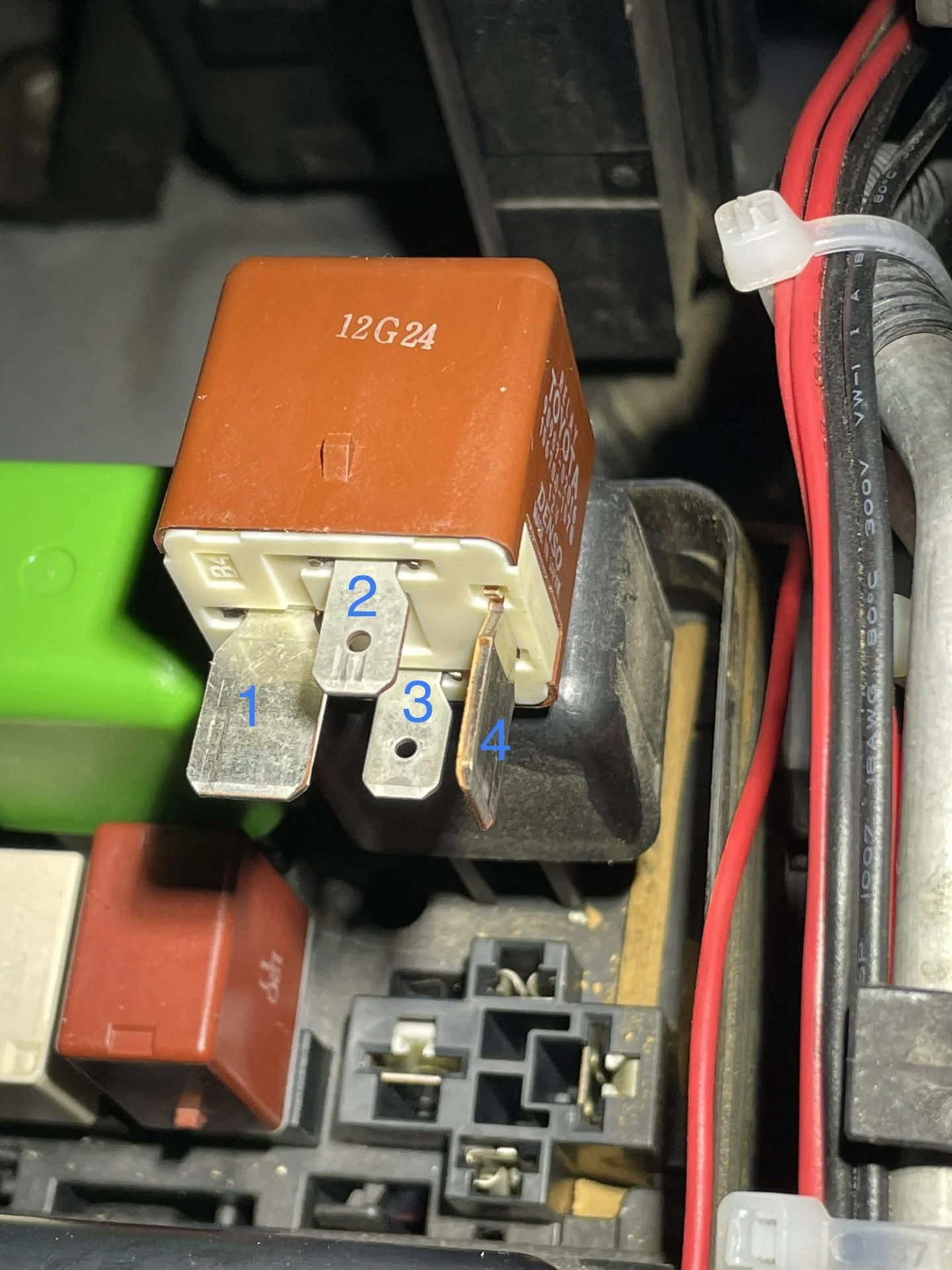

Thanks @jerryb ! So it looks like the correct terminal to use is terminal 2 on this photo? (which is on the 9-o’clock position from @Smobien ‘s picture).
@hewitttech
Your relay is backwards. In the pic I mean. Its 3 in your pic.
edit, but now after looking I don't know if matters, 2 or 3. regular relay or not idk
I finally got a reply email from Paul Hewitt, and he confirmed that I need to use any of the smaller pins on the 06-07 starter relay (pin #2 or pin #3 on the photo below).

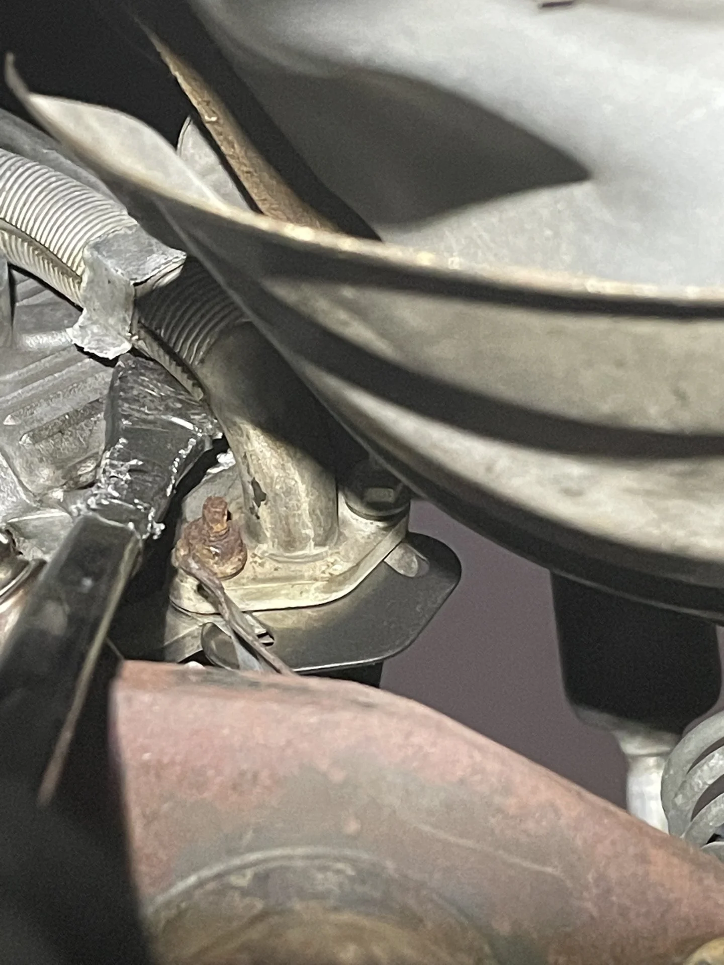

Yes that block plate is interesting to install (add lots of cussing and what a better way to do when the AHC is on Low :censor:)
Block off plate on point using a pry bar. (this is on passenger side but same thing I did on the driver side)
