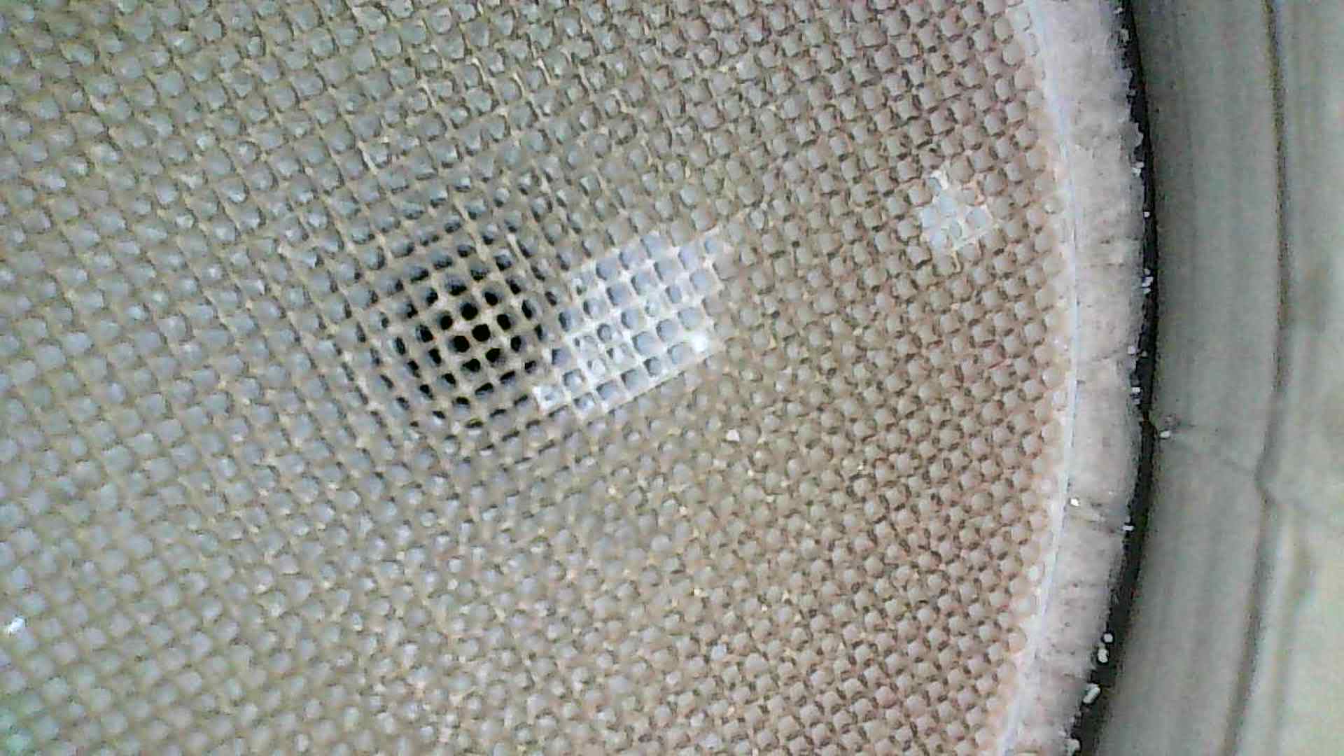

Paul, (the colorado Paul) I think I told you my filter was gone but I didn't take the cover apart.

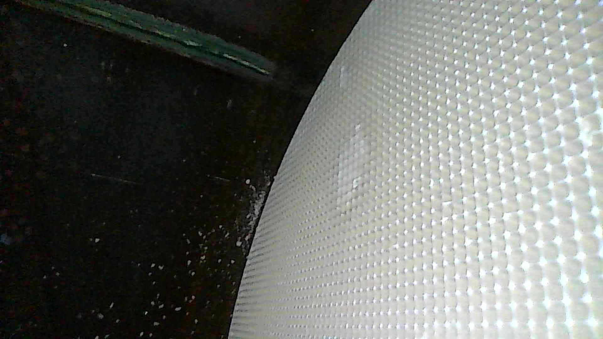

I also took pictures of all cat faces on both sides. They are unremarkable. Except for one whiter patch on the drivers side front of the number 1 cat.

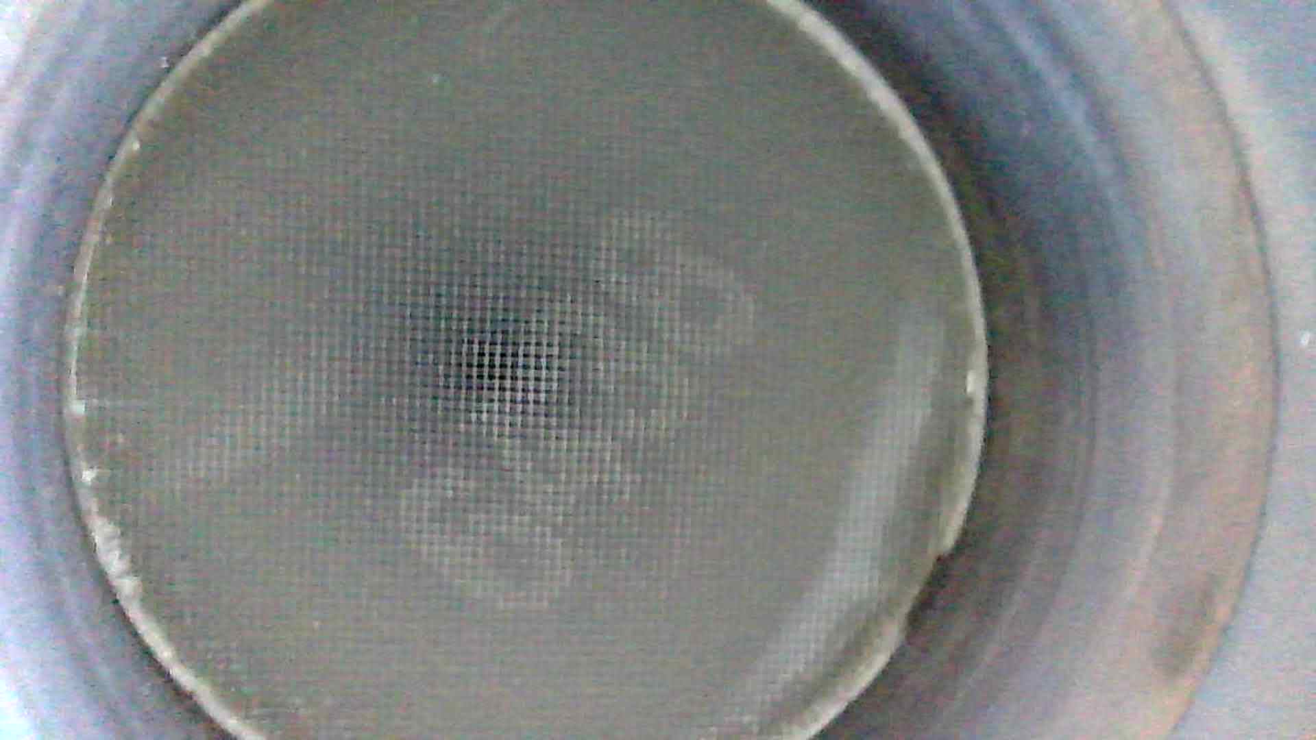

Have you seen these numbers on the back face of both number 2 cats?

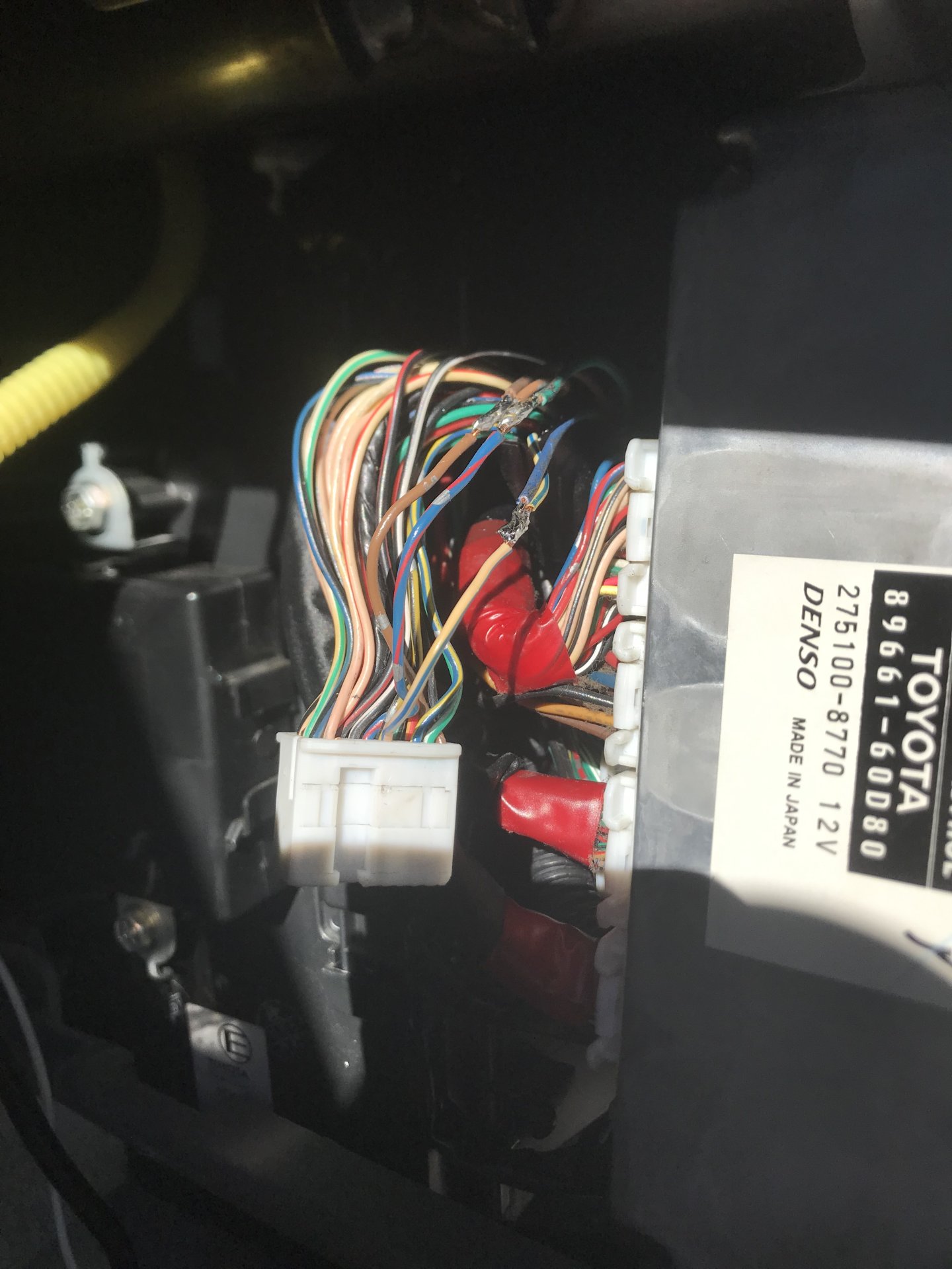

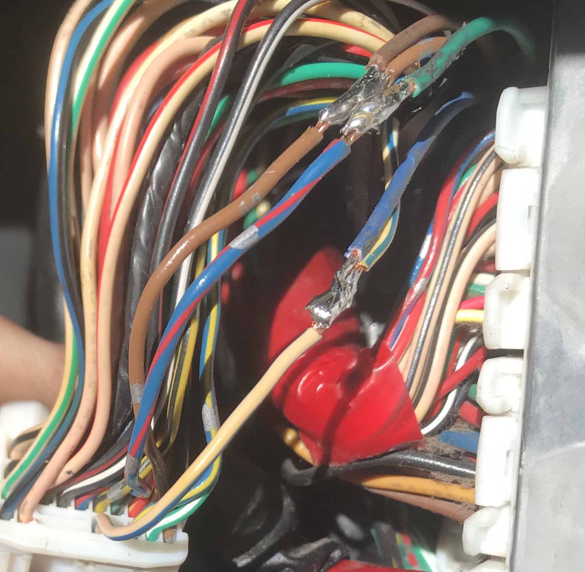

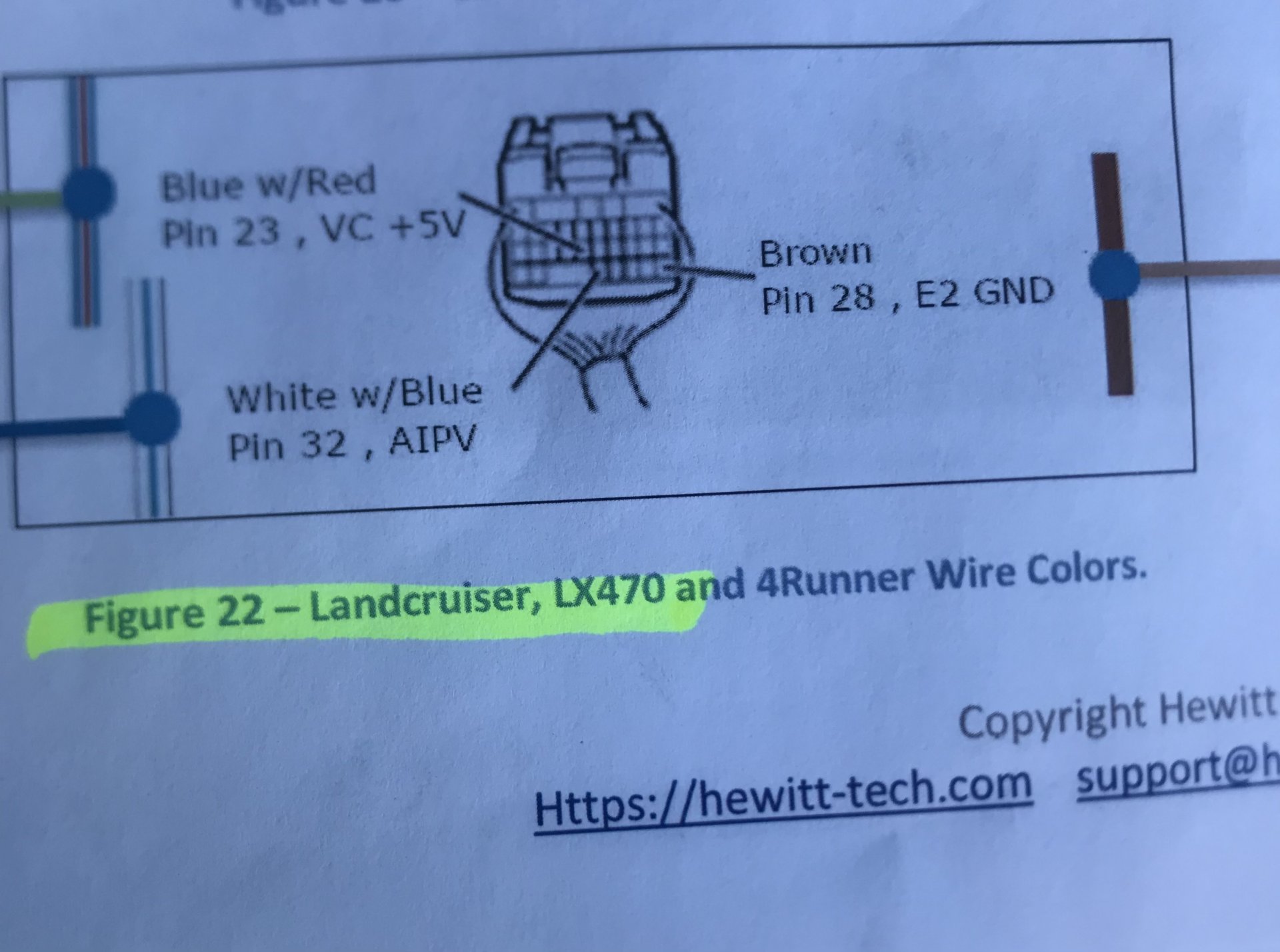

After a few drives, I had time to de-crimp and solder the connections.
I verified they are the same wires as in the instruction sheet.
Green to pin# 23, Blue/Red
Brown to pin #28, Brown
Blue to pin#32, Blue/White
They are all wrapped up with quality electrical tape up and awaiting a +7 hour idle time and OAT 41F and greater.
The codes of course cleared with the - battery terminal unhooked.
Fingers crossed it was just a faulty connection from the scotchlocks.
I just now looked at a video I did just after pulling DS CAT. Yes! I do see the numbers. But either you've a much better camera or my number are very faded on rear of aft CAT. I barley see the 3 and the 8, and I can partially make-out the 4. The six is just to obscure to make-out anything of. But I'd bet they are the same "6438".
I also notice between forward & aft CAT. I've about a table spoon of white granular materiel.
My guess, is the white patch in face of your forward cat. Is where foam or plastic hit and melted.

Thanks for your reply. I did use the crimp connectors to expedite the install as I had a big delay with the block off plate nut rounding .
I will check the connections and solder them in place this time.

A pending P1442 came back today along with a P1445.

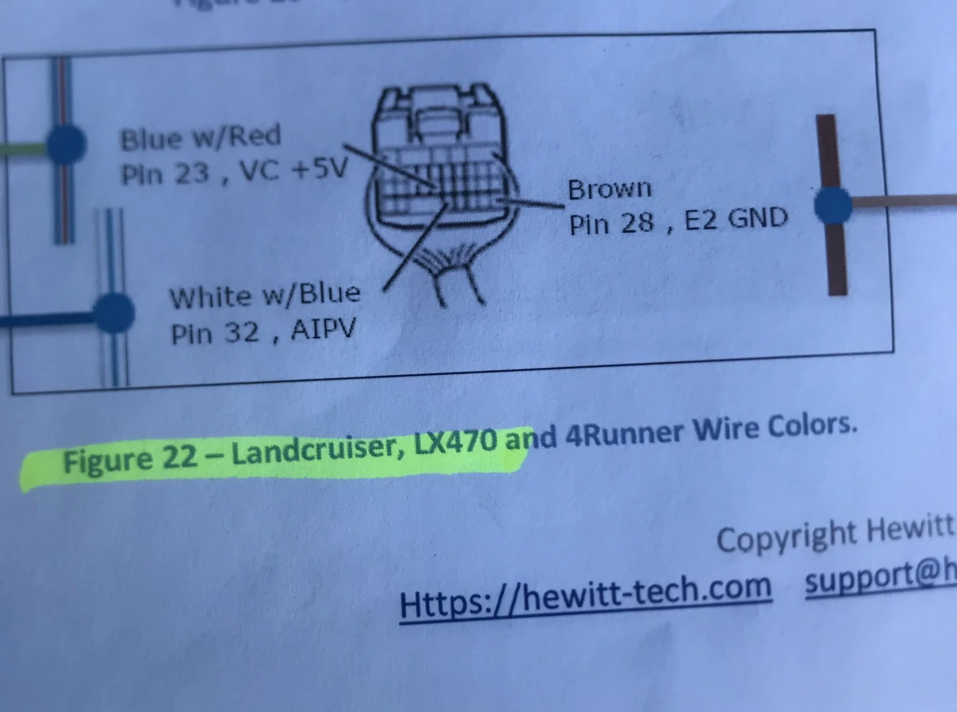

View attachment 2886189View attachment 2886190

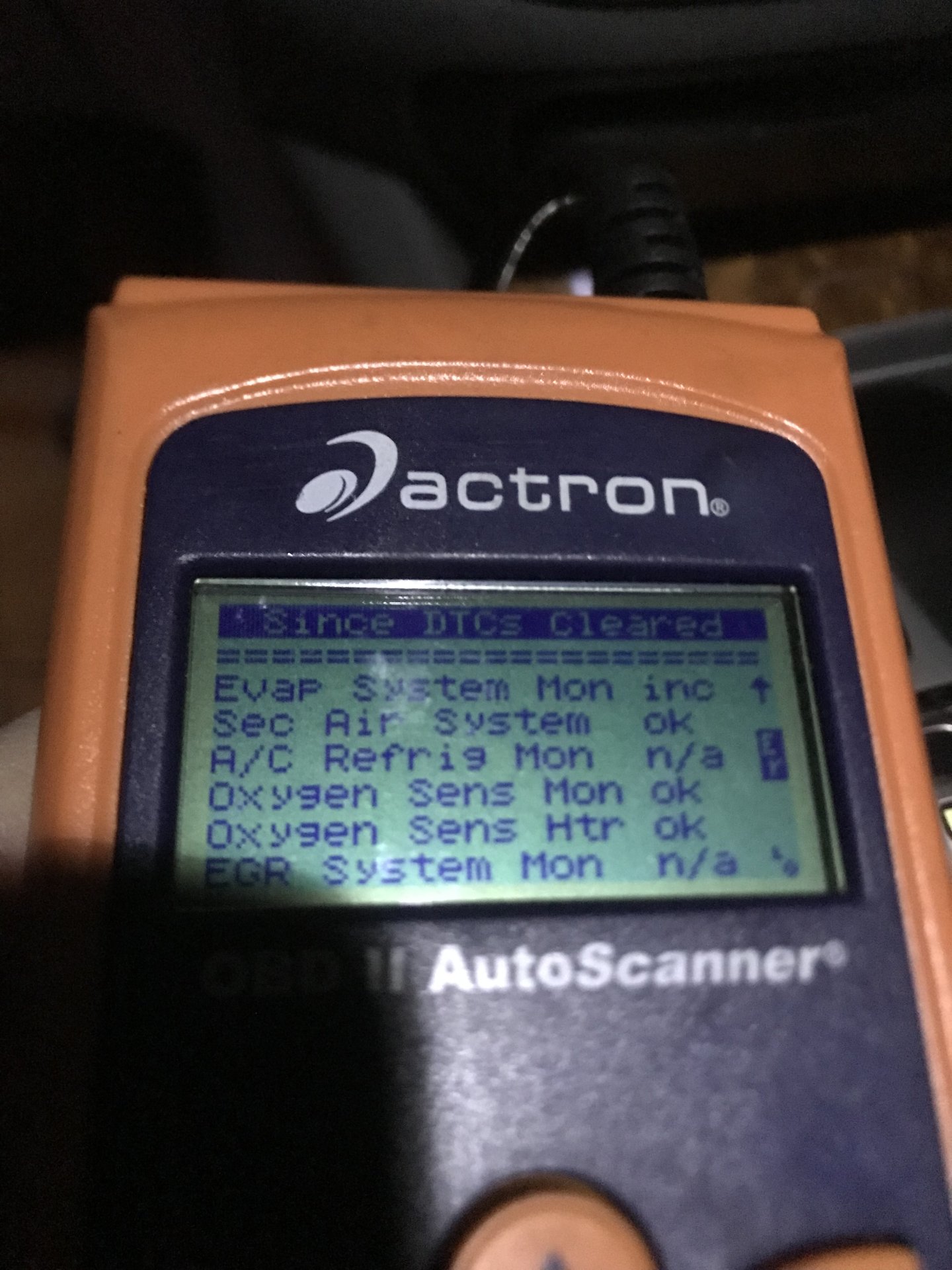

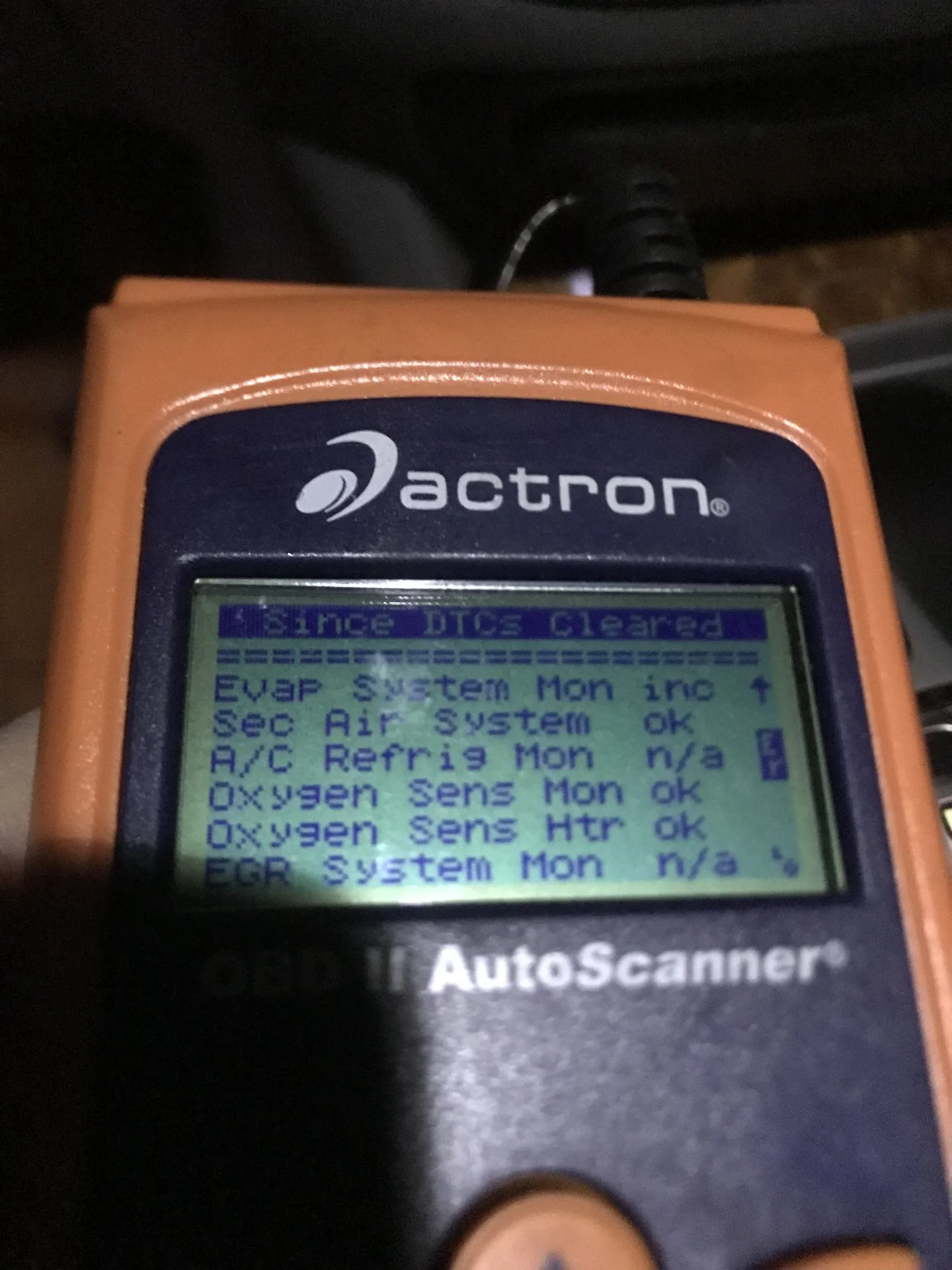

Thanks @hewitttech
I appreciate the detailed response. I am no longer getting any AIP related codes or any other codes, since my last post.
It shows "not ready" with "no pending codes" every time I drive.
Perhaps it just needs some more driving cycles in order to show "ready". The FSM shows a series of times at various speeds to be driven after a battery replacement. Maybe all of the repeated clearing of codes and battery disconnects are requiring the ECU to go through these?
I will try a different code reader to see if it can yield some additional info over the ScanGaugeII. Unfortunately, I don't have TechStream yet but it would definitely be worthwhile right now.

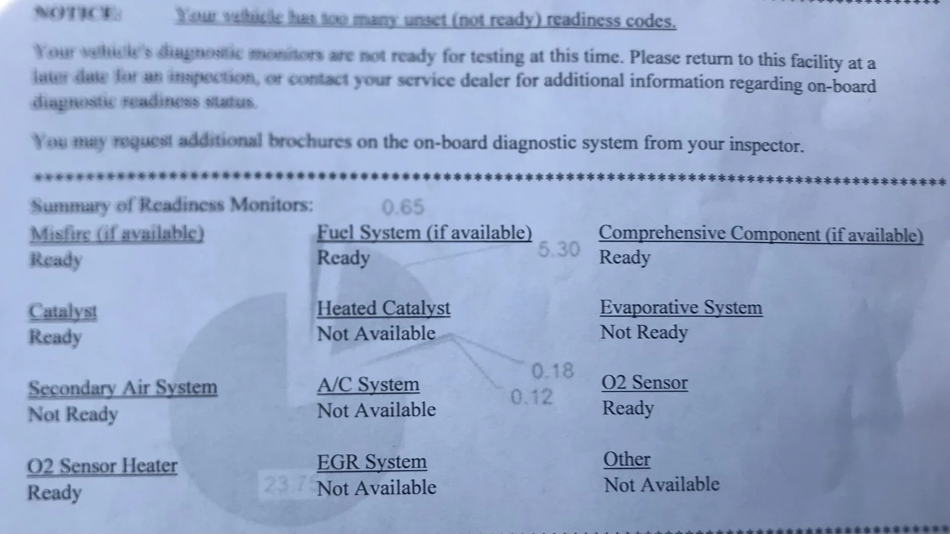

I attached a pic of the "not ready" scan from the smog station from right after initial install with the ScotchLocks. This was right after battery reconnection so some of the "not ready" codes maybe be attributed to that. Perhaps this info will clue you into something that I'm not privy to.

Looks like the "Not Ready" now is only from the EVAP System Monitor.
The rest of the monitors are showing ready.
I guess your system did clear out the P1442 & P1445.
I did swap in a new gas cap when I installed the HewittTech system.
Thinking that might be a contributing factor. So I put the old one back on.
Fingers crossed it shows ready after some more driving.
Glad to hear that and it sounds like you have it now. There are certainly a couple of things going on to consider why.
First, going back and soldering the connections is the first thing we recommend. Soldering during the installation vs using the Scotchloks is highly recommended for this reason. Even though I thoroughly tested these particular connectors and couldn't see a difference between them and soldering, they do have room to not be perfect depending on the installer. These tiny differences matter a lot for some of the small signals we are dealing with. Properly soldering the connections is always the best options and your did a lot better job than many that we see. The solder should always look nice and wet/shiny, not balled up and wicked into the copper where it looks like it is a good wet coating on all the copper strands. That will yield the lowest resistance connections which is the important part.
The Gas cap should not have been a contributing factor. However, I have seen some people believe that the gas cap is what has caused their secondary air valve code(s) and even their catalyst inefficiency codes. I believe most of that to be coincidental at best but there still may be some aspect of it that contributed. I just don't think there is a direct correlation there but still within the realm of possibilities.

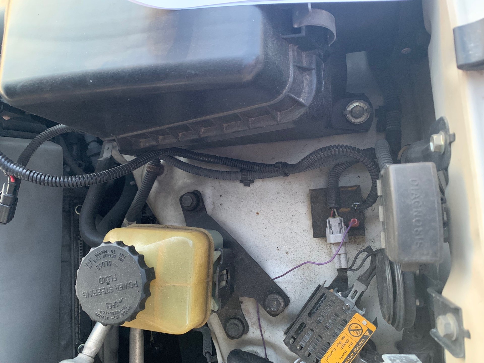

I went to install my kit today and (unfortunately, after opening) it looks like there is already one installed?
I have gotten code P2445 twice. What could be causing the code if the kit (if this is yours) is already installed? It is a purple wire in the pic.
ETA: don't know about the block off plates, the vehicle would need a foot more ground clearance and I would need a S-64 Skycrane. 🤣
When is the p2445 code and check engine light coming on? At startup or while driving. Take a look at the p2445 explanation on our codes page and see if it might be the freezing temperature glitch that is explained there.
At startup you might not have the starter relay wire connected to the correct terminal and it isn't getting triggered correctly if you wait in the on position before starting.
First time the CEL kicked on was after about 20 minutes of freeway driving. This took a Toyota dealership 3 days to diagnose, no kidding.
Second time was right after a start (car had been driven approx 3 hours earlier). I had a code reader with me and zapped it in the parking lot once I confirmed it was the same P2445 code. Several cold weather starts since then, no problem - we'll see as tomorrow and Friday are cold here.
I checked out the info. I guess it's something to live with, of course they would stop offering the reflash...
