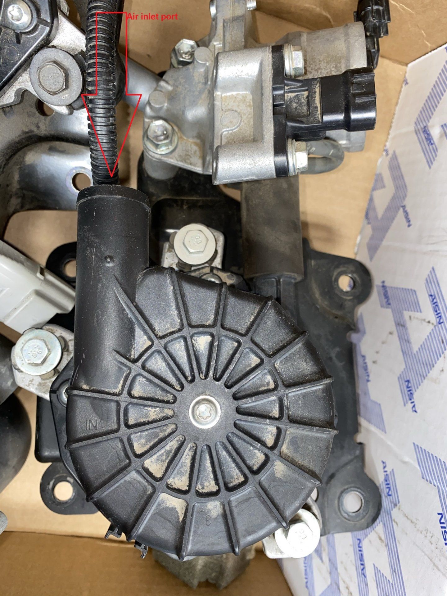

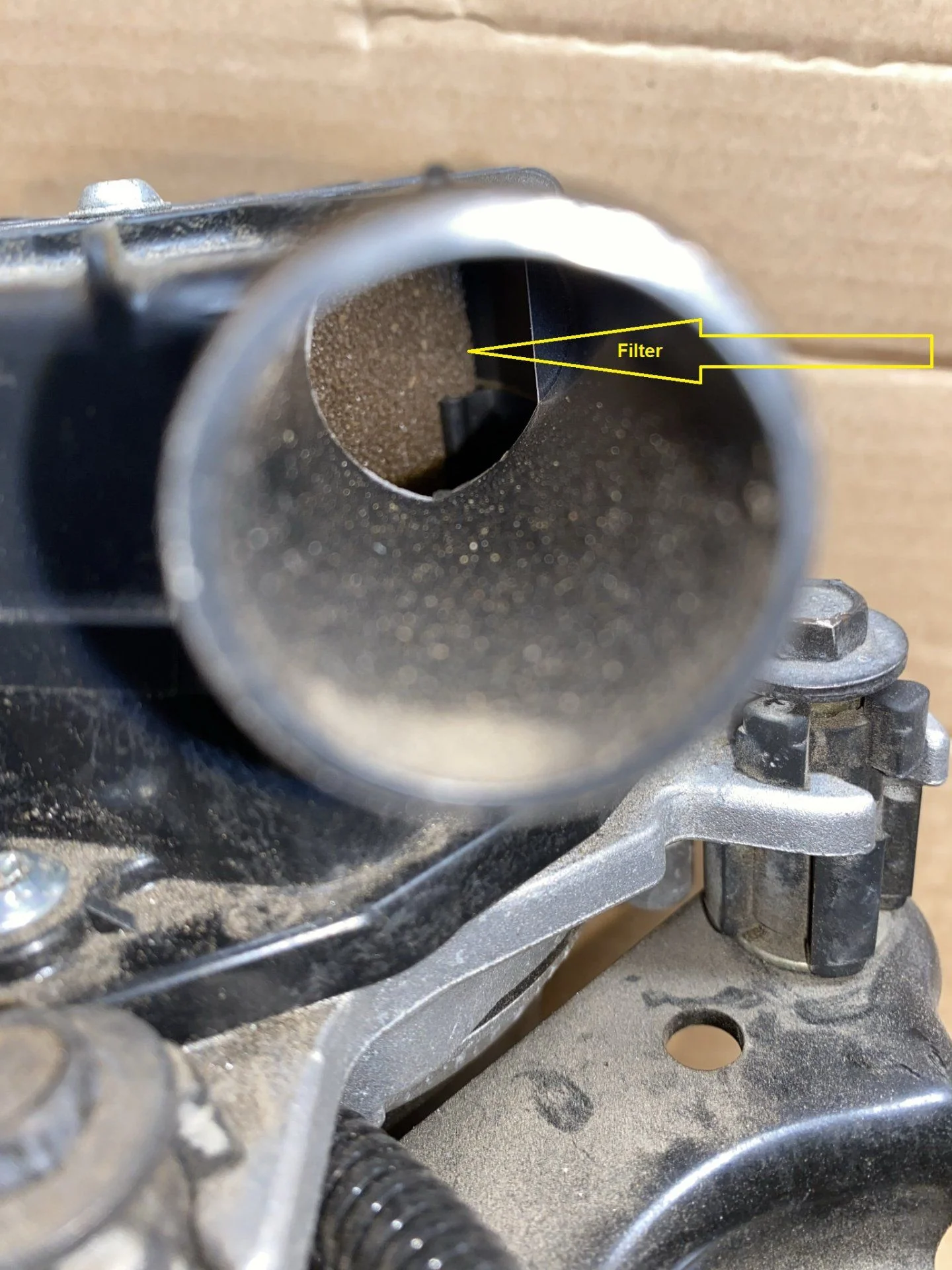

I am super interested in condition of air filter within the A.I pump:hmm:.
Please, anyone removing intake manifold. Please please take a picture inside the 1" Air Inlet Port on A.I.pump, of the Filter and post here?. THX!

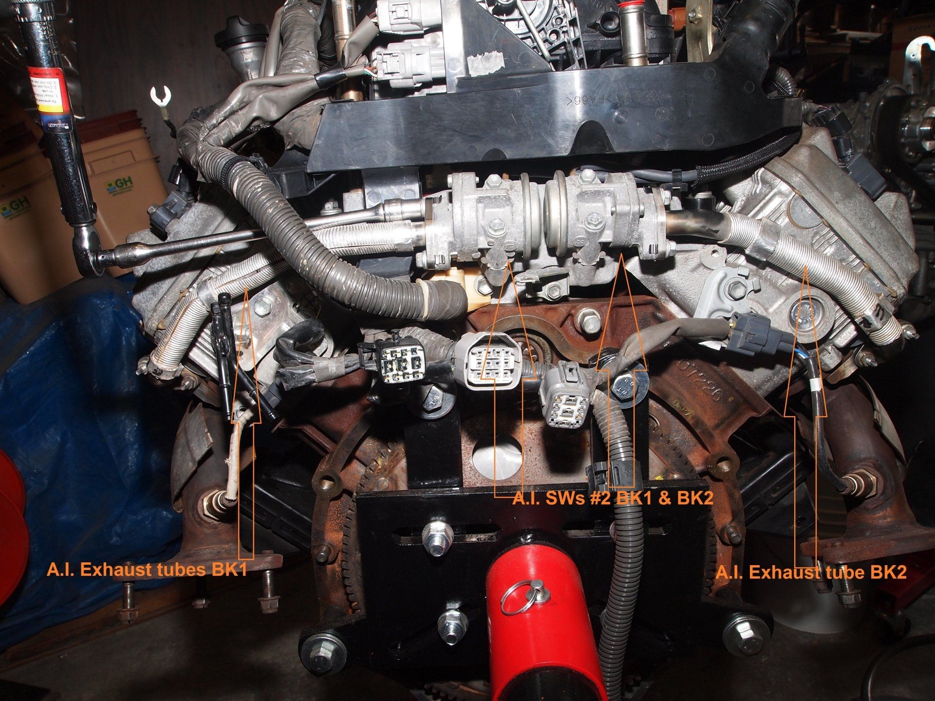

Diver side is BK 1. Passenger is BK 2. Valves 2, are the two in back of intake manifold on water bypass joint rear.
BK 1 is driver side yes. P1442 is a bk 1 code. which is the PN# 25720-50020 VALVE ASSY, AIR SWITCHING, NO.2. But run through the diagnostics before just replacing the SW. Also checking to see if a P1445 is pending or current. If so, you've more going on than failed SW's. Keep driving and checking codes, for now.
Don't forget the gaskets if you replace.
Any other codes now or in the past?
