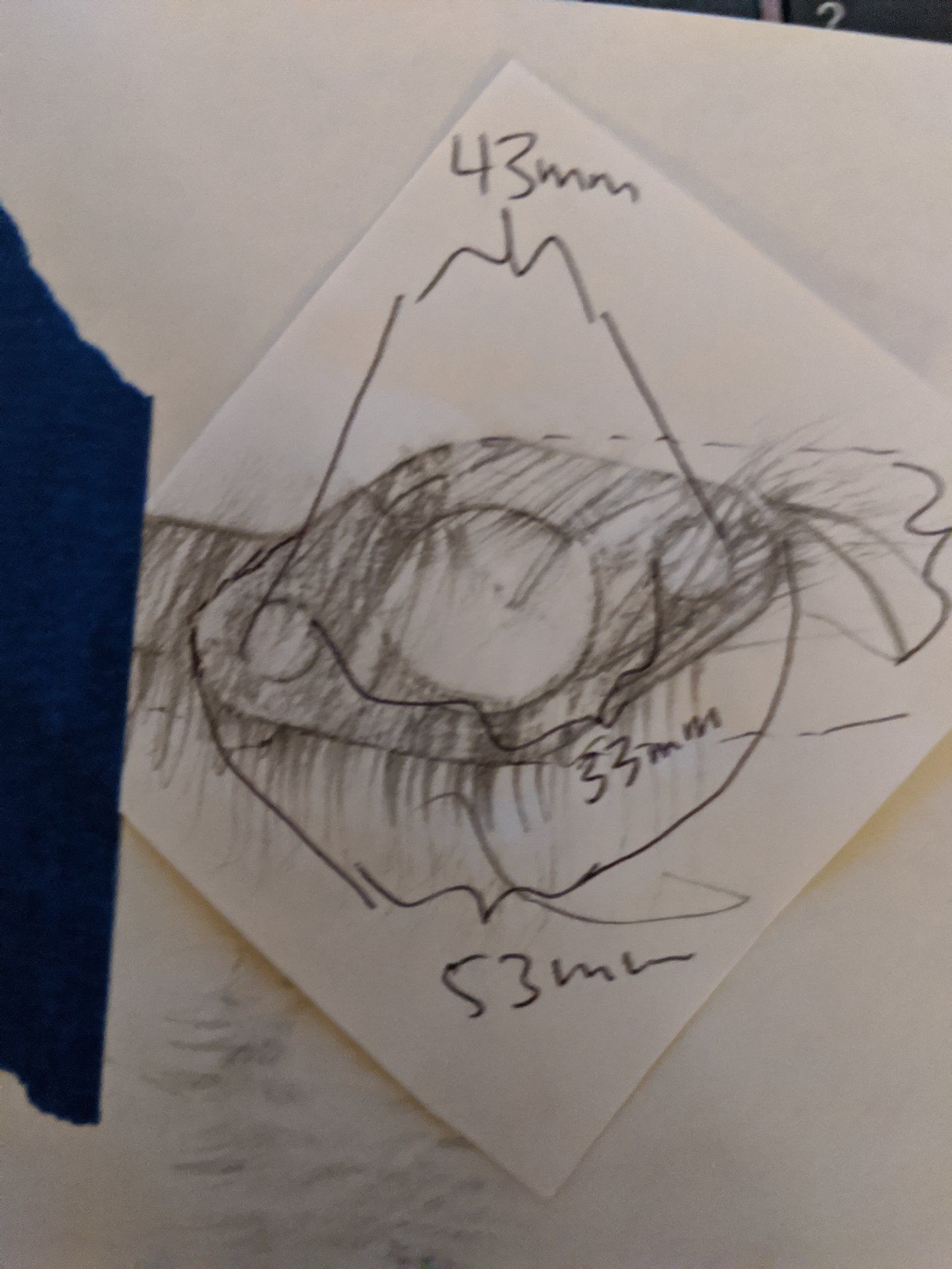

On the block off plates on a stock manifold.
I realize welding them (manifold side) closed is an easy option, but not in place.
I realize using your plates as a block off without the upper tube attached might make a good seal, except it has pass through slots and it's pretty slim.
There isn't a compatible size air injection, or egr plate out there that I can find. Everything out there is slightly bigger, but does have the same general shape.
Would it be possible for you guys to make a steel or aluminum end to cover the stock hole. I was going to make some today, but also order some BMW or VAG group oversized and re drill. Probably both. ($15)
But if you made them I'd buy from you if under 30$

As I'm digging in to this I have another question.
Anything is possible. We can have our machinist, that used to make them for us, water-jet them out of whatever thickness and material you want. However, for a one off set they won't be anywhere near your price-point. Honestly though, just bolt the plate on the end of the tube with the gasket between them and use some stainless washers if you think it needs them. The plates are 16 gauge 304 stainless which is much stronger than mild steel or aluminum, especially in the high temp range. The plate also cover the entire surface area between the bolt slots so I guess I don't really see what problem you are trying to address. These aren't top fuel dragster, they aren't going to blow off or anything like that. Besides, the reason aluminum and steel EGR plates are much thicker isn't for strength, they are thicker because aluminum and steel will burn and corrode through. Where these plates install exhaust gases don't even strike it directly like they do in an EGR. I have seen our plates after being in service for 8 years and other than exhaust staining, the surface is as good as new.
thank you.
No problem I was addressing. Just a better looking option, and I didn't know if they would hold air on their own with the gasket. That isn't a place I want to mess with more than twice.

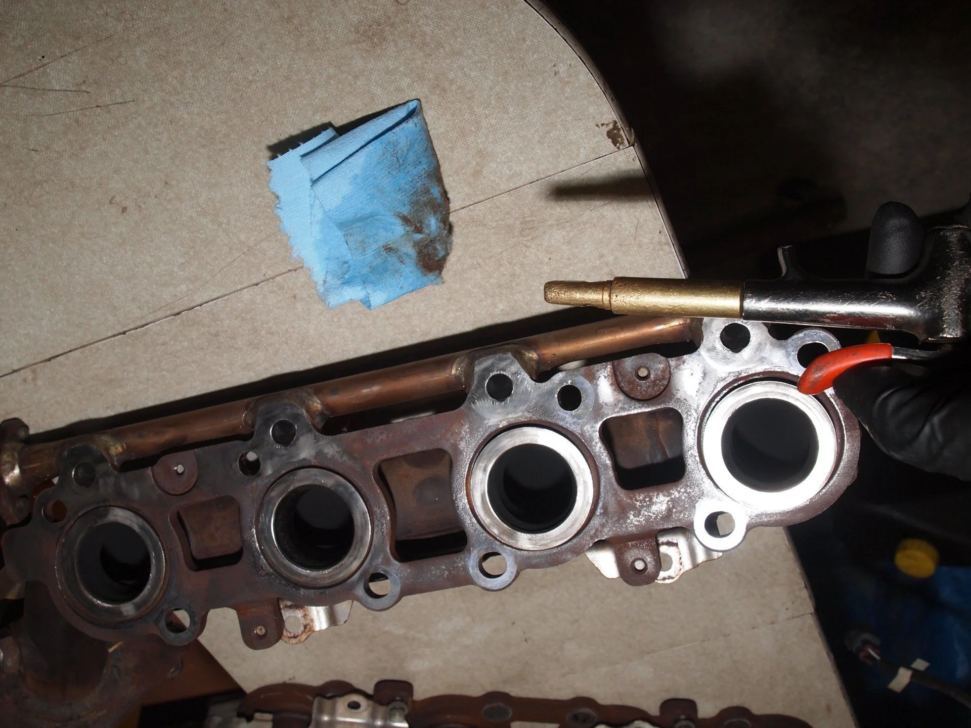

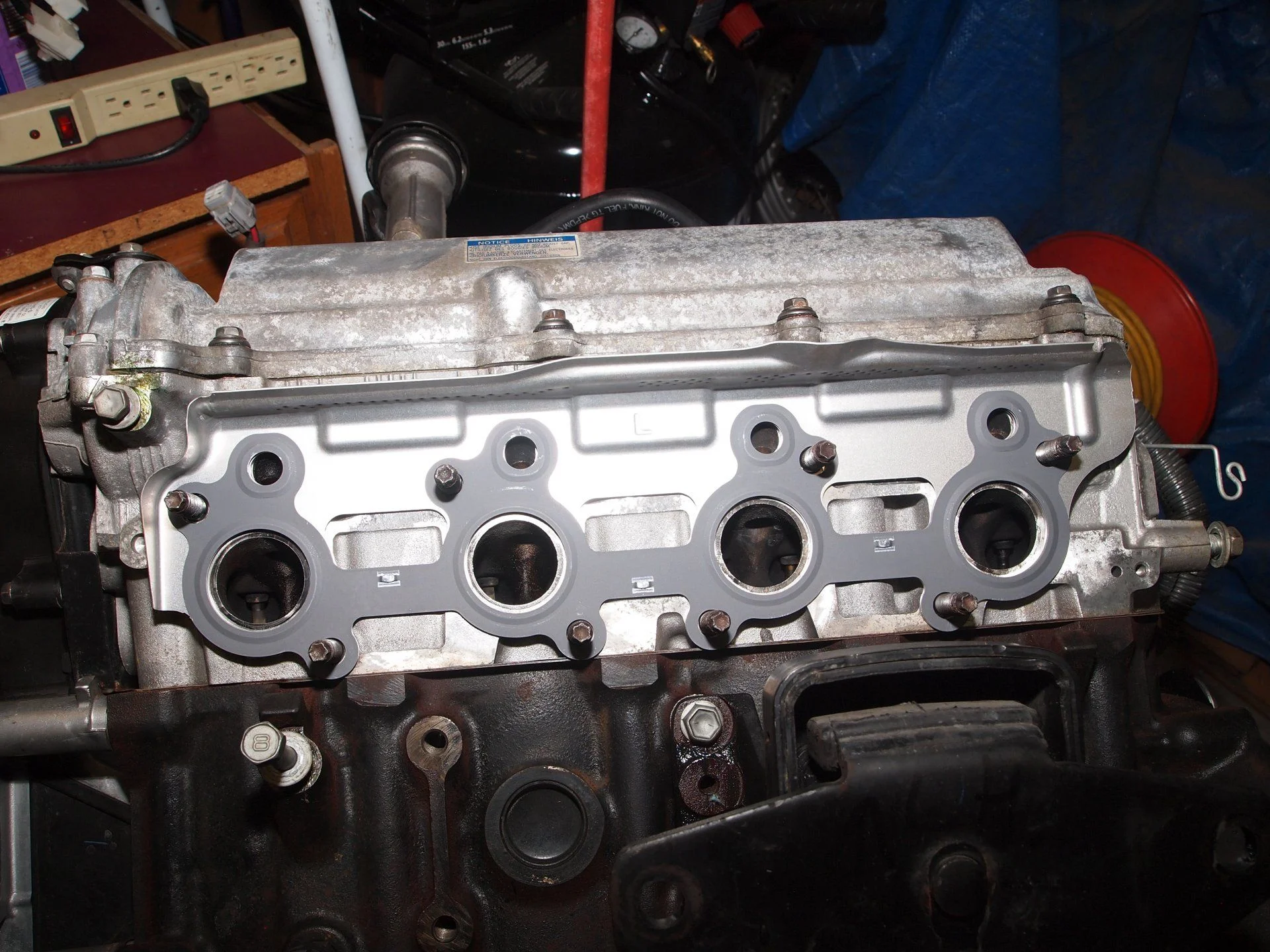

VVT heads & Exhaust manifold.
Note the smaller exhaust port above the larger. A.I. pumps air through those smaller holes, into exhaust manifold and on through CAT(S). Those smaller ports are not in non VVT head or exhaust manifold. So pre 06 (VVT) exhaust manifold would not cover the small exhaust ports/holes. You'd then have massive exhaust leak.
