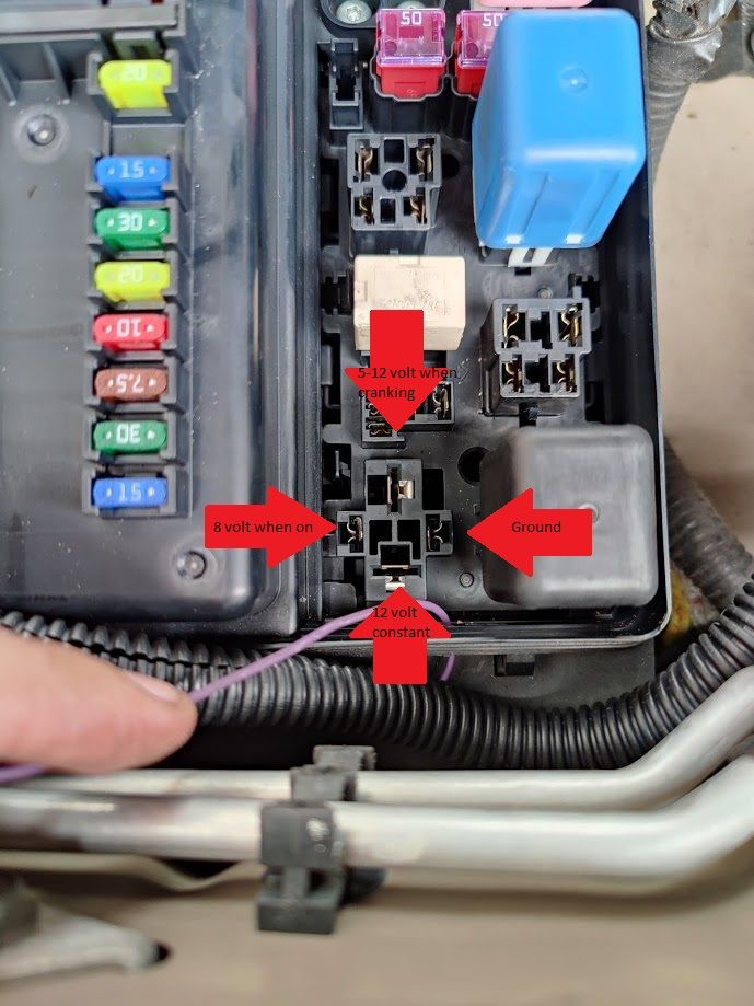

Just did this on a 2007 Land Cruiser after a SAIS bank two valve stuck closed CEL.
Block of plates were a pain, no real way around that. Passenger side can be accessed from the top, although tight, it’s doable. The driver side I accessed from underneath the vehicle with a really long extension.
When it came to wiring the starter relay the instructions included were catered more towards a Tundra or Sequoia. I know there are slight variations between the Land Cruiser, Tundra, Sequoia and 4Runner models with the 4.7. Some have VVTi others do not, some have a starting system that I can only describe as you don’t need to hold the key in the start position to start the vehicle. Just turn they key to start and release the vehicle will start itself. My 06 4Runner had the same system.

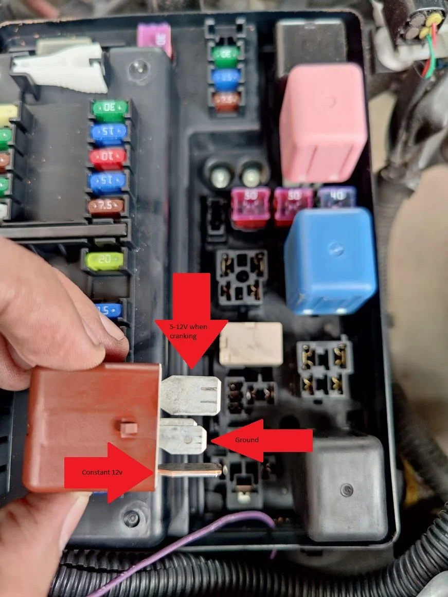

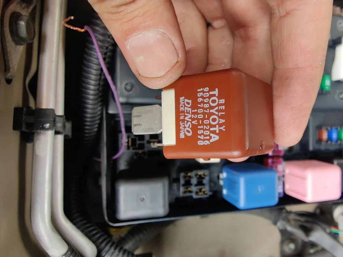

The relay is brown, not purple like in the instructions provided. It has 4 spades on the bottom all of which are silver. Two large and two small with holes.

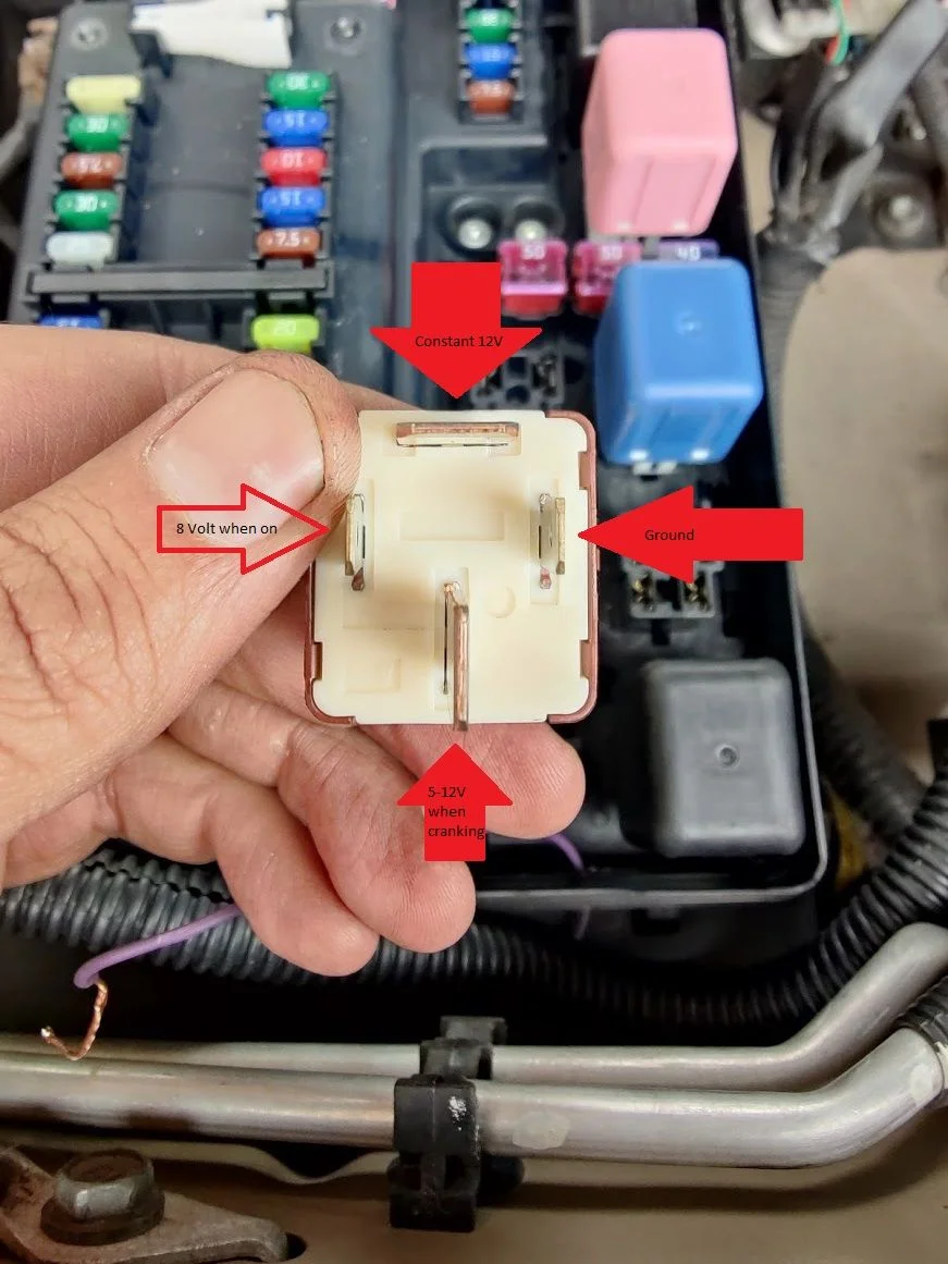

All of the photos I took are standing at the driver fender looking down at the fuse block. The pole closest to the engine (12 o’clock on the fuse block) only gets 5-12v on crank. This is the pole you connect the bypass wire to. The pole at 9 o’clock gets 8v when the ignition is switched on. The pole at 3 o’clock gets nothing (I assume its ground). The pole at 6 o’clock is constant 12v (assuming this is battery).
I called Hewitt-Tech and spoke to them. They told my wiring assessment was correct and I provided them with photos to maybe update their instructions for late model Land Cruisers.

I actually have my starter relay wire connected to 9 o clock on your diagram. This is based on a post earlier in the thread where Hewitt said that was the correct one.
I believe you want the bypass to activate as soon as you turn the key (not necessarily crank) and it activates as soon as it reads between 5v and 12v.
This may not matter. Either placement may be fine. Just pointing this out to make sure we all have our starter relay wire in the right place.
