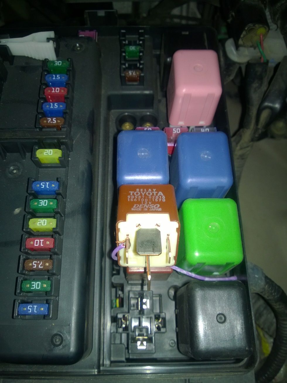

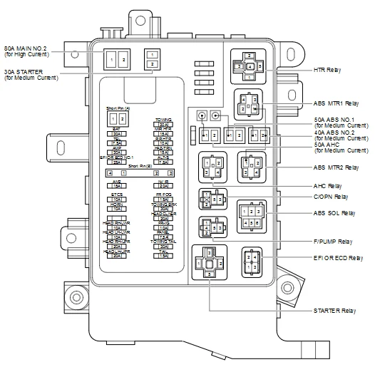

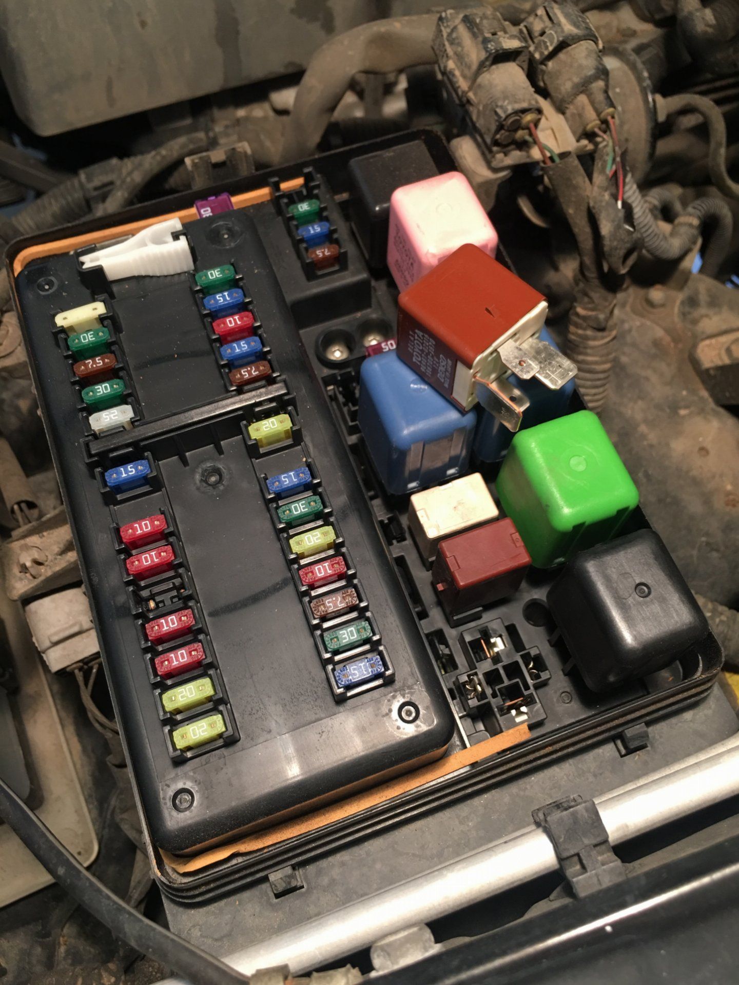

My 06 100 threw the P1442 code a few months ago, at ~170k miles, but didn't experience the limp mode. I am proceeding with the bypass install today, but am having trouble determining which terminal to attach the relay wire to as my relay doesn't have the copper terminals that the instructions say to stay away from (as those are the solenoid terminals). Anyone have any advice on which terminal to secure the wire to? I don't want to blow the solenoids or the bypass, which the Hewitt instructions said are likely to happen if the wire is improperly attached. Thx in advance!
This is my '06. Attach here and you will be good to go.
Excellent, that's great thanks!
