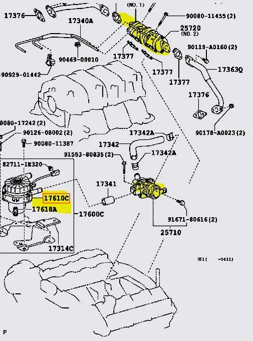

Guys I feel like an idiot but can someone take a pic of where each of these plates are to be installed. Just received the Hewitt kit and the installation instructions for the plates does not look at all like our 2006 100 Series.

Two pipes on either side of highlighted valves, that's a r runner I think. Same place for LC Lx
