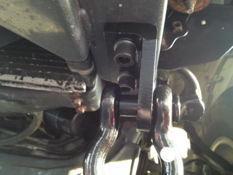

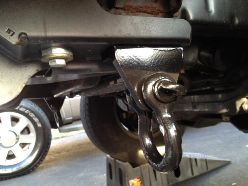

Spressofab recovery points installed!
Those Spressofab brackets are stout! I don't know how I ever managed without them. One of the mods mentioned something about running large washers on the clevis pins to keep the shackle centered thus not compromising any of it's strength.

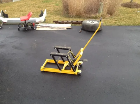

Putting the rear ARB on this morning.
Broke one of the tack welded nuts off in the frame rail. Other than that didn't have any issues.
But thanks to my motorcycle jack and my ih8mud mobile mechanic / all around good guy Ryan (belowdeckfab) we got it muscled up and on the back and into place.
