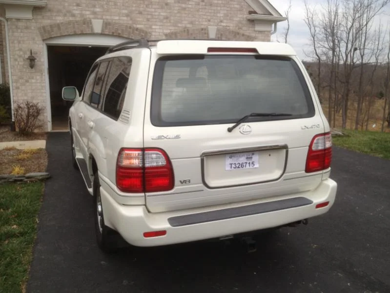

Here she is after purchase and cleanup

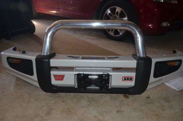

I picked up some 03+ ARB front and back bumpers, for a good price I think ($1700 for both already painted)
After Christmas these are going on:

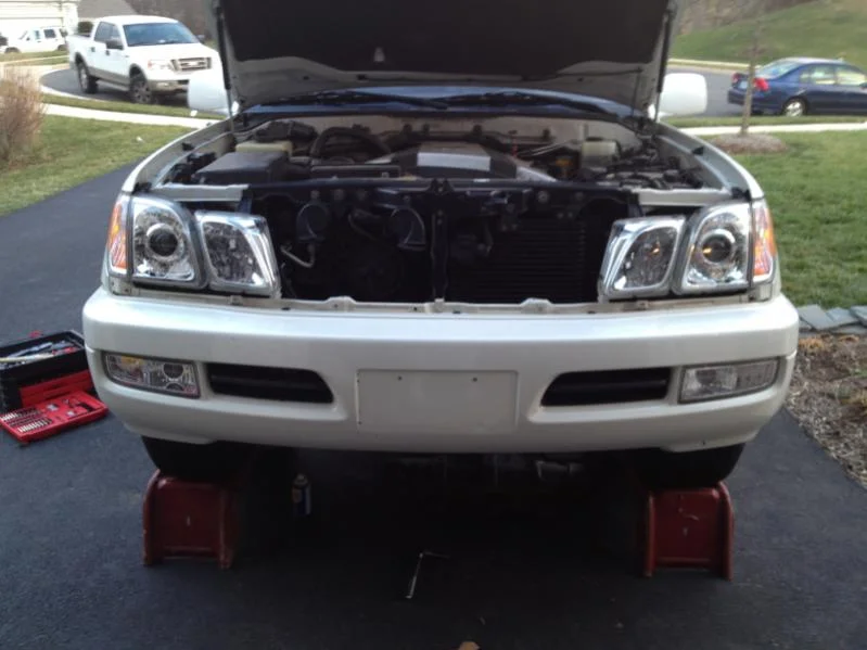

I started taking off the stock bumper and got to the last four 14mm bolts that hold the steel piece to the frame. After chiseling road grim off the bolt heads I got three of the four off without issue. The last bolt I round the head so it's stuck holding the bumper on.

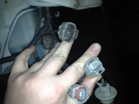

Any thoughts on how to get a bolt like that off when it's somewhat hard to get to through the recessed hole?
And what are all these extra plugs for on the driver's side?
Damn $1700 for front and rear bumpers! Not a bad deal! Goodjob! Subscribed
Nate, if you want to improve your turn signals look at vleds.com for LED turn signals/brake lights. Also, HIR for high beams if you do not have a bi-xenon projector are a excellent choice. If you cannot get a dremel in there to notch the bolt head (for a flat head) I would get a nut welded to the bolt head and extract it that way. I would not drill the bolt out until last resort.
