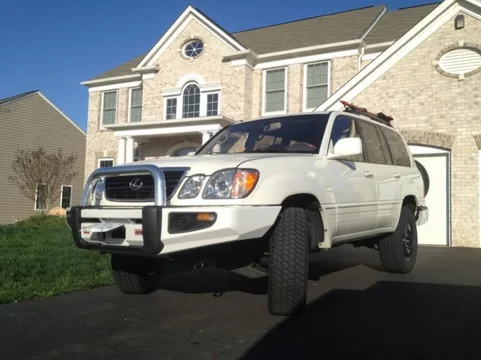

I have ordered the Sahara bar, which will be coming soon I hope.

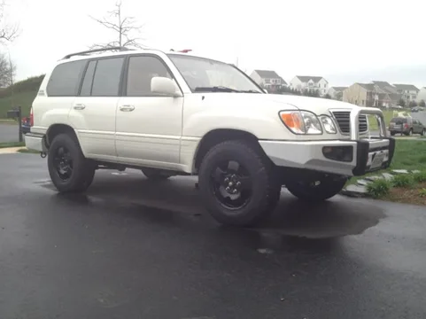

Put the black power coated Tundra 07+ TRD wheels on this morning. Settled on Goodyear Silent Armor 275/70/18's after reading the big tire article in last month's FourWheeler Magazine.

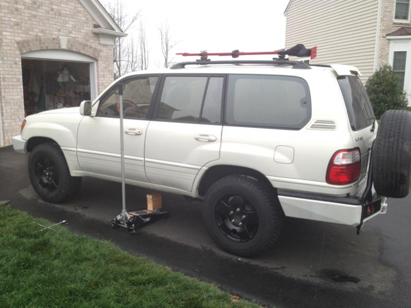

Figuring out how to jack up one side with a floor jack was the hardest part.

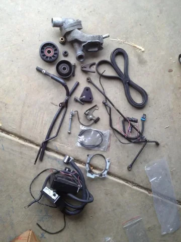

Just ordered a supercharger and doug thorley headers, once they get in I'll have the exhaust fully done too.

Very nice ride. Where did you get the sc from?
Nvm. Found the other thread.

If you set a alert on ebay for 4.7 trd supercharger and you'll get emailed when they come up, that's what I did. I've seen 3 in the last couple weeks.

Love that wheel/tire combo! Nice rig!
Is it just me or does a nice smooth sidewall look so much better than huge side chunks and silly sidewall designs.
That looks kind of dangerous. How did the jack work out?
No problem at all, I just made sure to jack up the side under the Driver's handle on the frame, make sure that if there is any tipping of the blocks you let the jack down immediately and move it accordingly, also use jack stands once the truck is lifted.
Behold... Black swing outs.
I like the look, I think eventually I'll go all black bumpers.

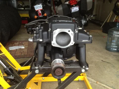

Got the supercharger, contemplating getting it thermo coated before installing it.
Got it rebuilt by magnacharger.com who replaced all the bearings and some other internals.
Waiting for the Doug Thorley headers before installing it all.
