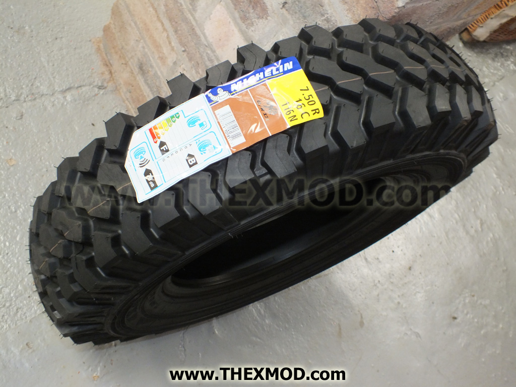

So... tires.
Part of me wants so very much to go full idiot with some STA Traxions in 700-15. It'd definitely be the ballsy move.
But then I remember that for highway work, radials are a good thing, and am looking at some less expensive 235/75-15R options. Forceum 08 Plus looks like a good cheap mud tire, and they allegedly measure out to 29".
These would be pretty cool but I recall reading somewhere that they are not DOT compliant. I haven't tried to verify.
Right now I'm sticking with the 15s, due to my basic schema of economy. I'd love to find some 16 inch wheels that looked stock and were affordable, as they open up a universe of tire choices.
