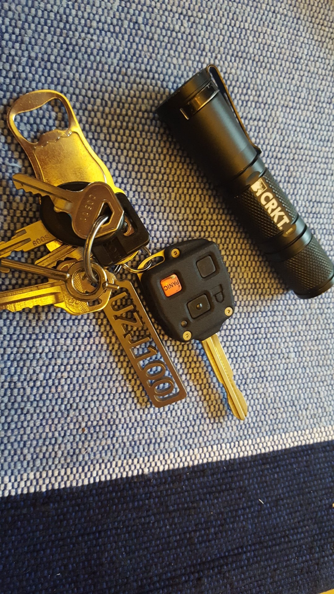

Tada....
I noted the installation video omitted the placement of the inside nut and the little metal posts however, I consider myself a bit of a puzzle solver so it was clear how those fit into the solution.
Thanks for a useful, well built item :cheers:

Tada....
