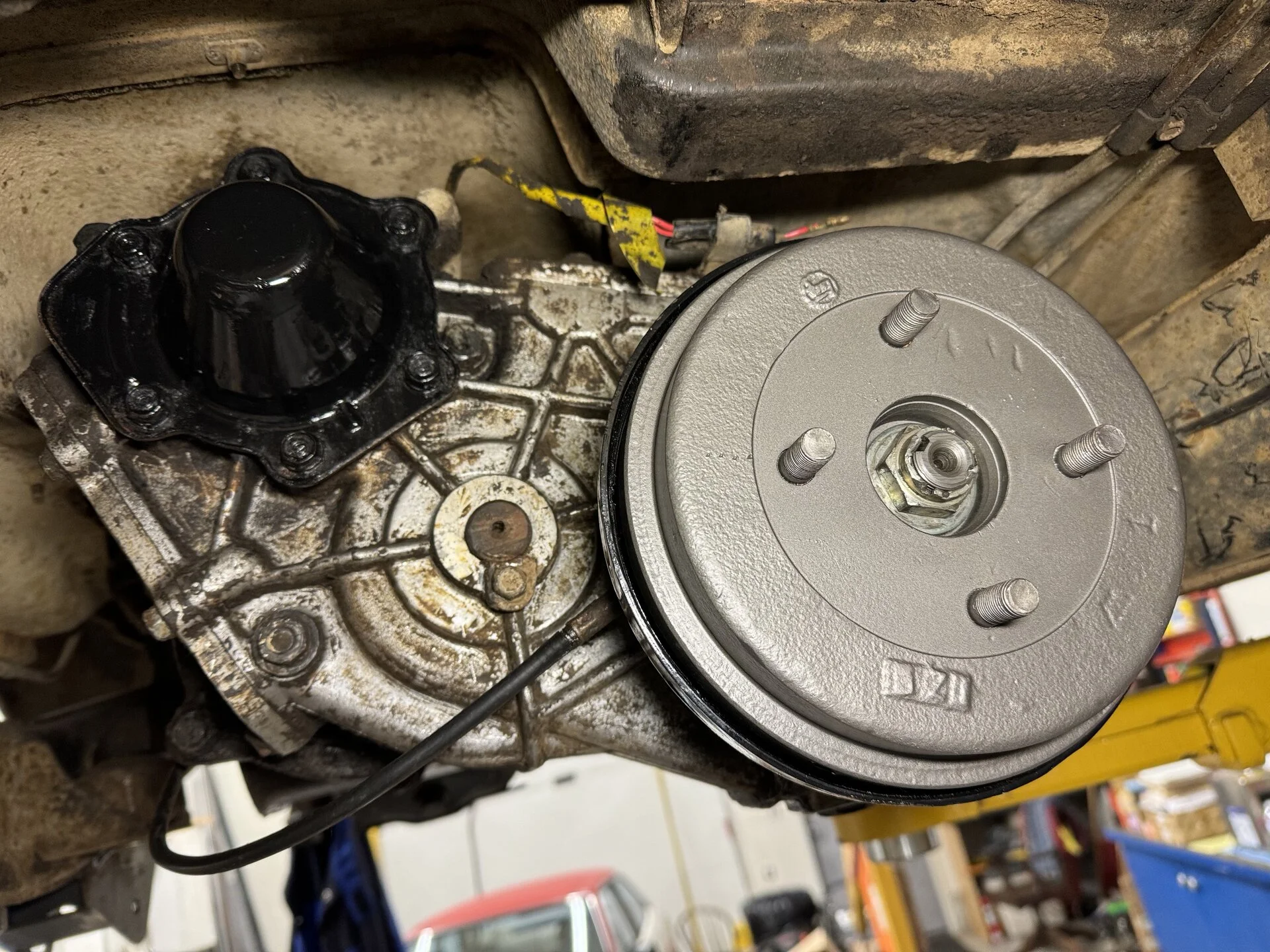

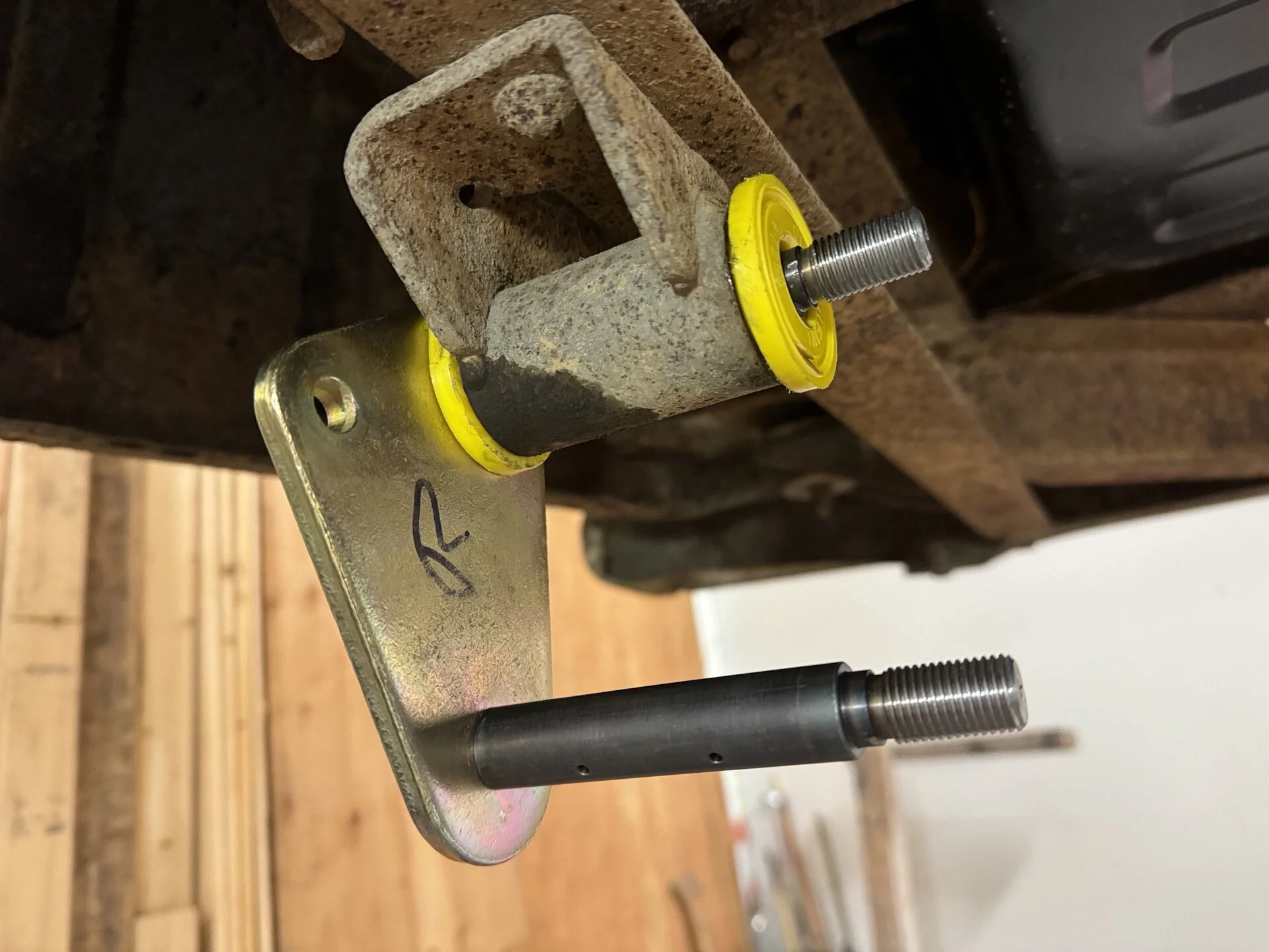

Apparently the “friction fit” on the bushings isn’t much, I had to redo all the OD to get them in, frustrating doing stuff twice.
But progress was made and torqued the park drum too, staked the nut.

Yeah I didn’t want them loose, had to smack them in and then took forever to remove once I realized the pins wouldnt fit :slap:

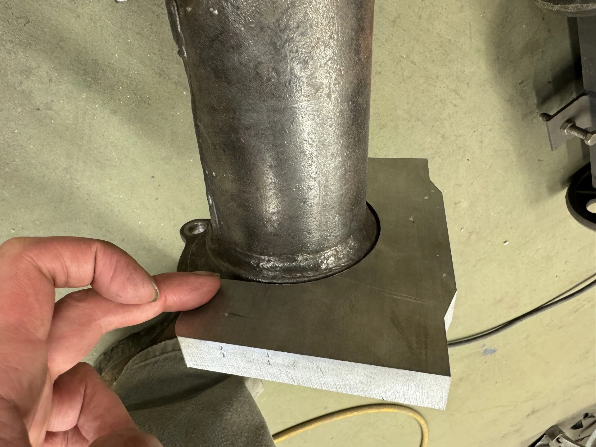

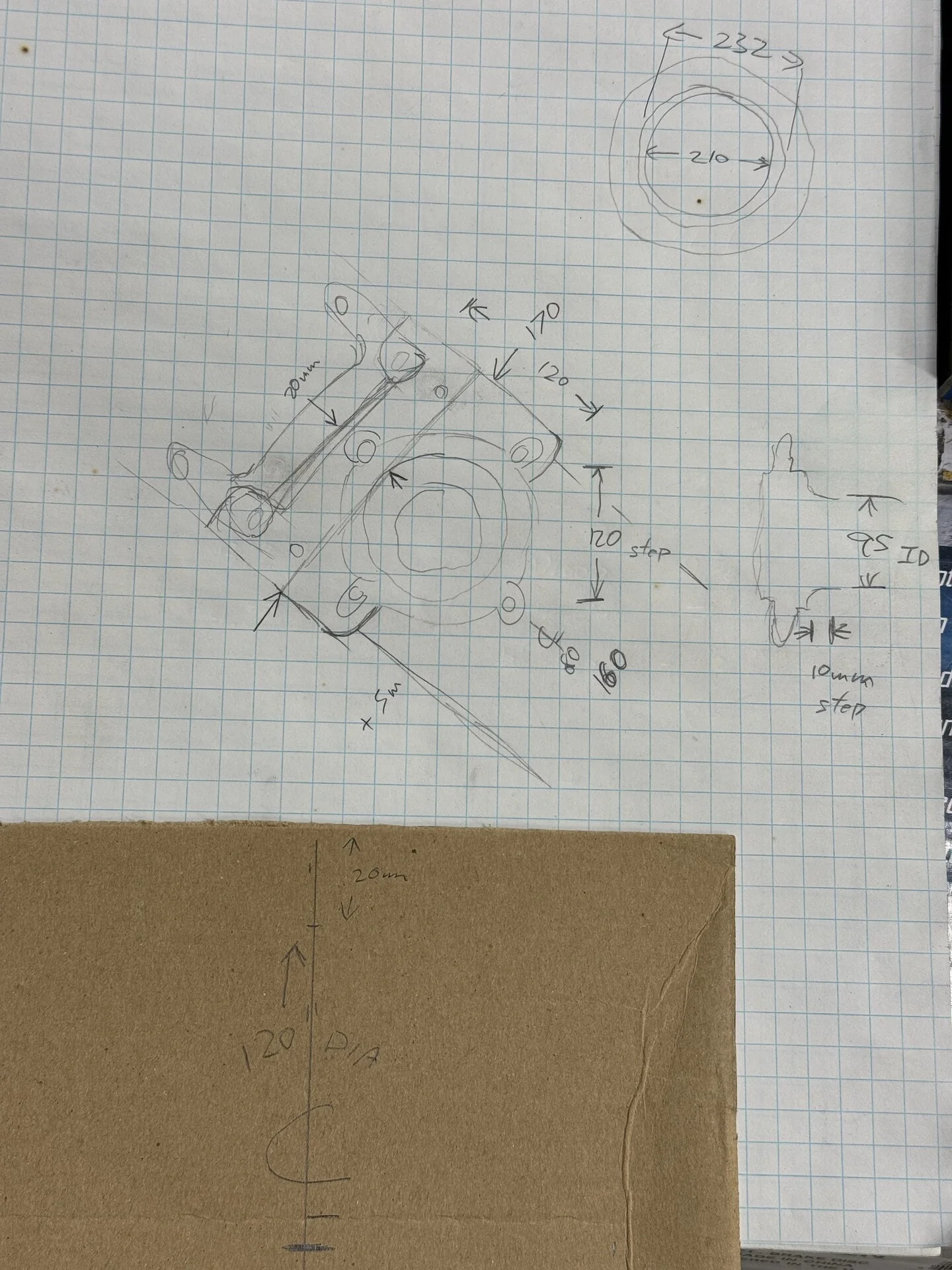

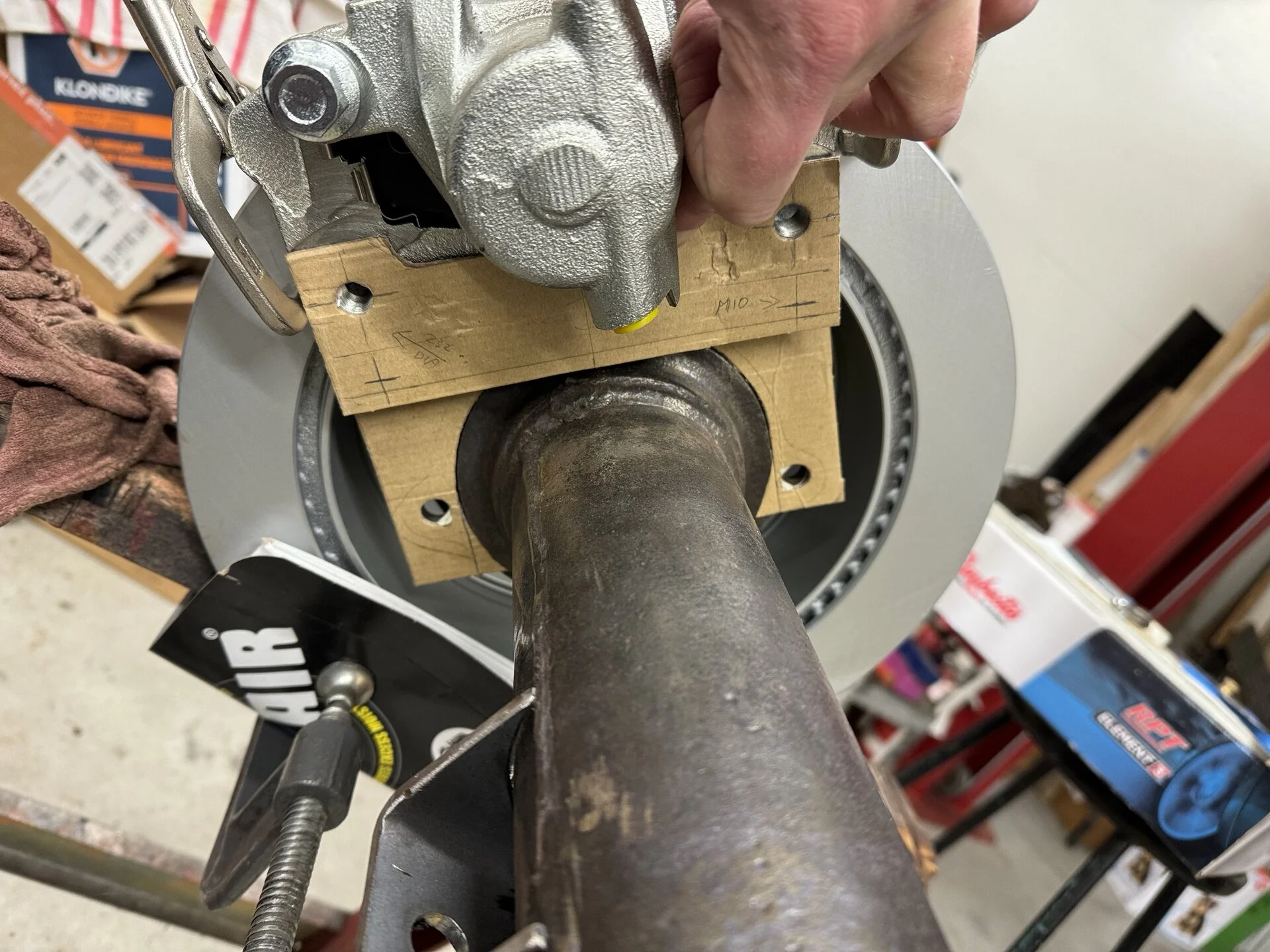

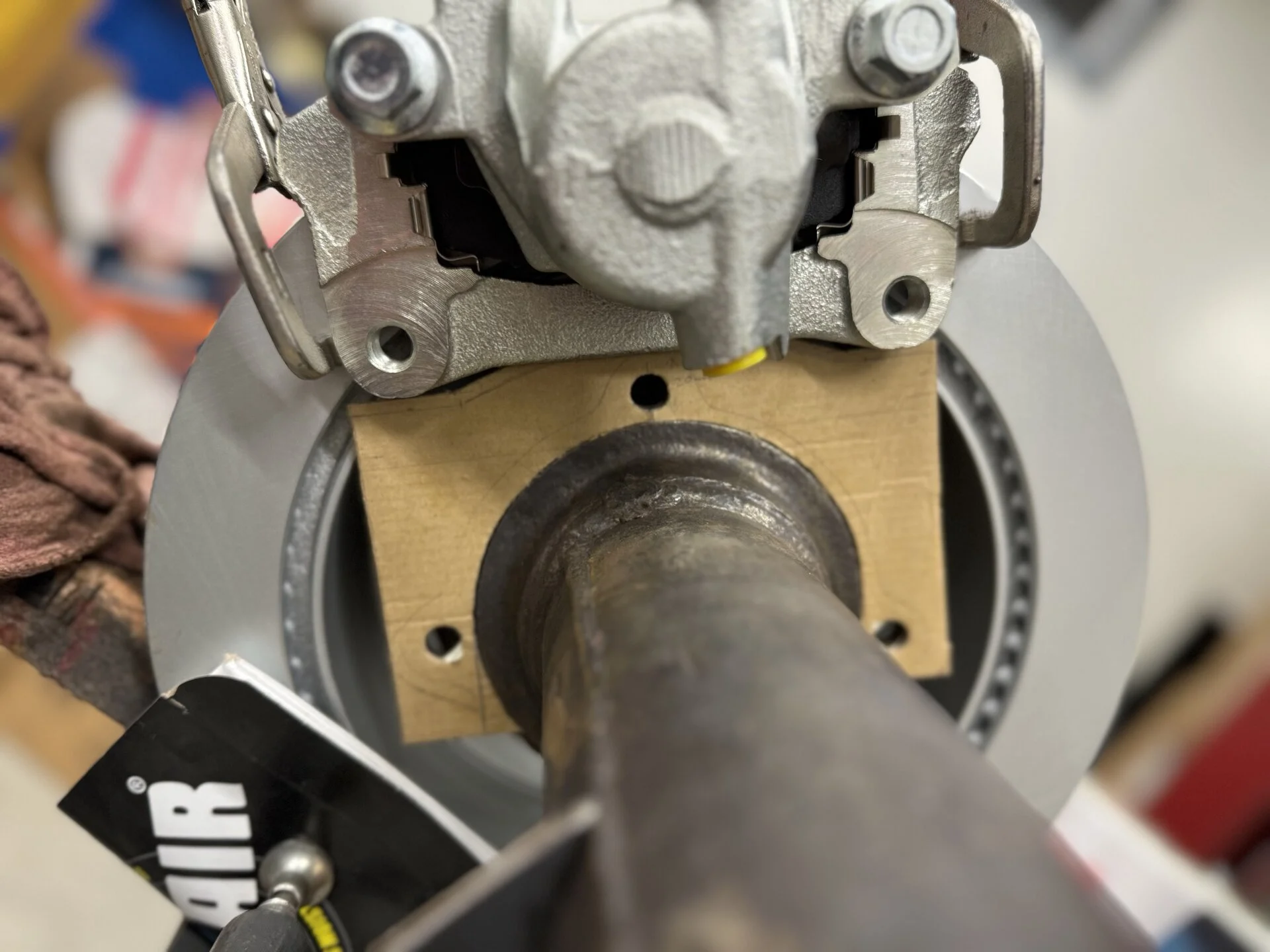

Almost done the CAD on the caliper mounts, want to sleep on it before buying steel…a couple details floating still.
Will be a 2pc mount, 3/4” thick mounted to the housing to get the offset I need and then smaller 1/2” thick for the caliper ears. Nice little project that will get me some lathe time again.

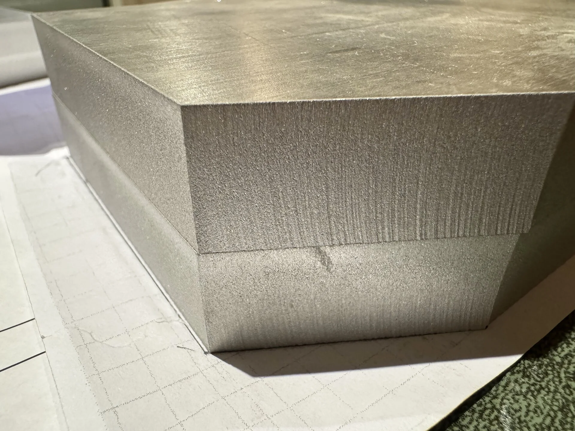

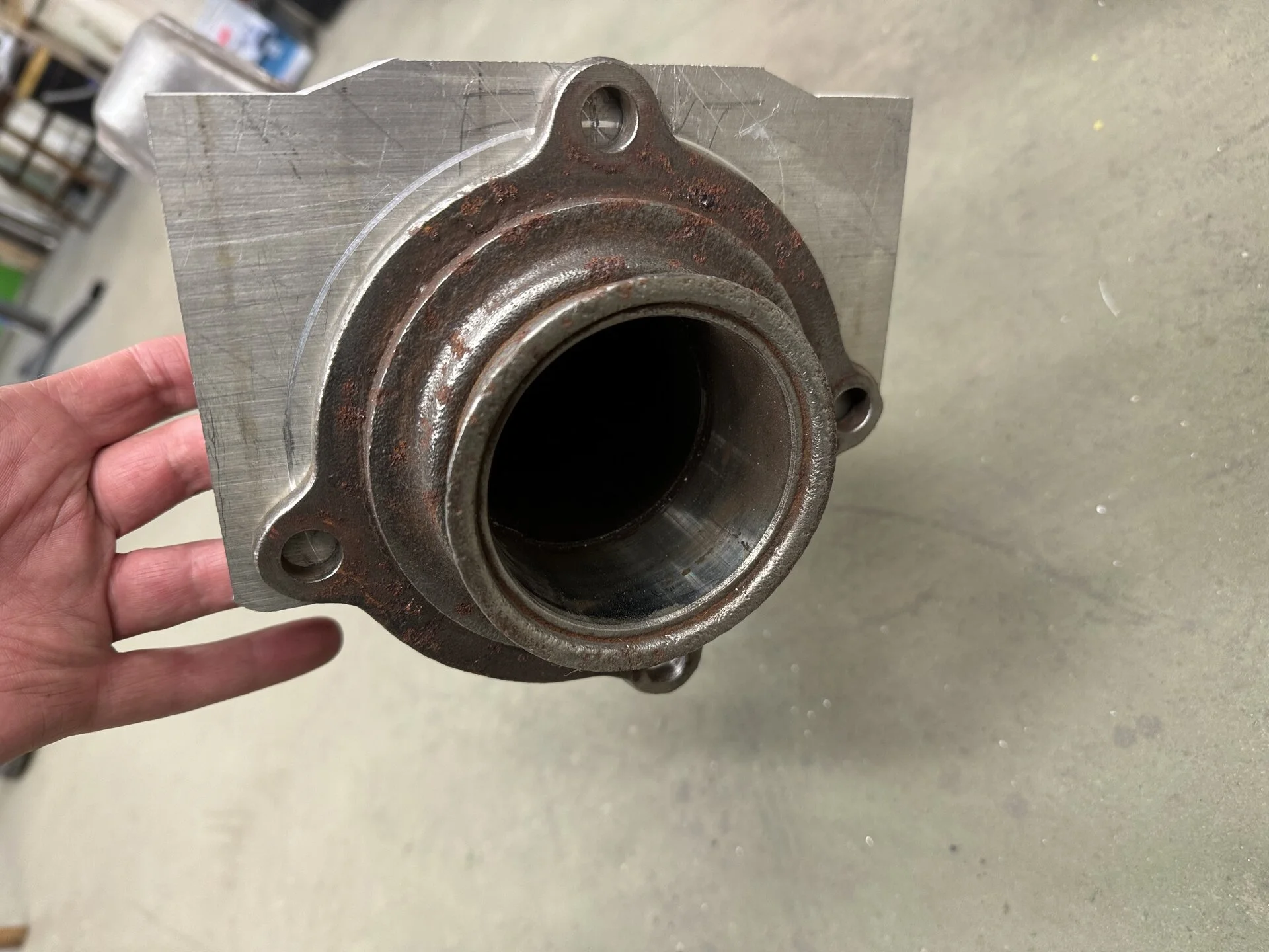

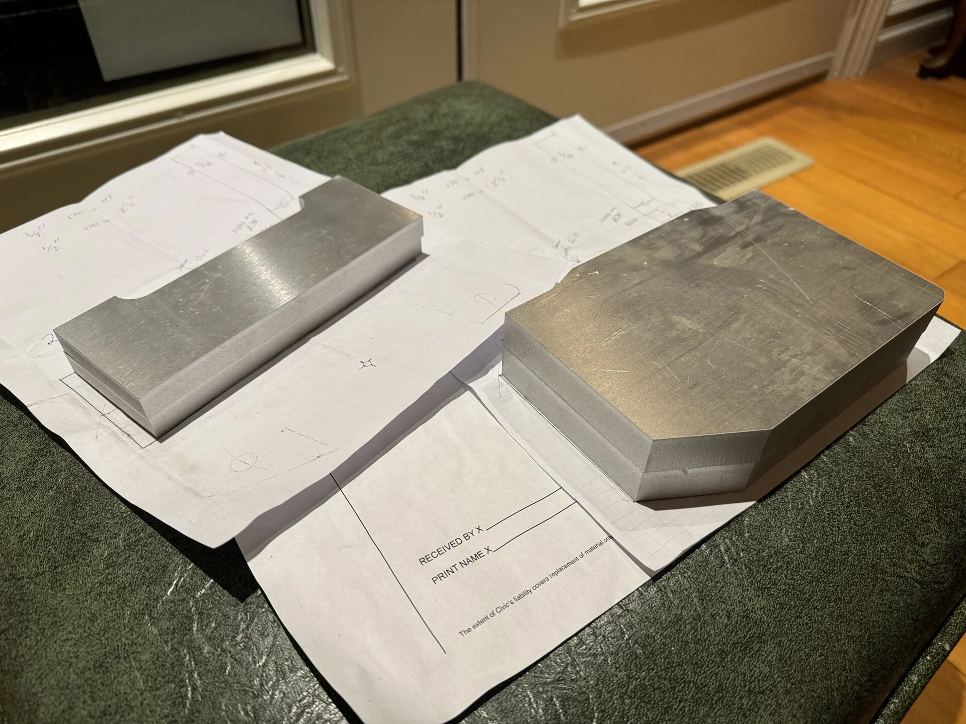

I stopped at the metal supply / water jet place to get a quote on my caliper brackets, to my shock it was 25% cheaper to get the 4 pieces in T6061 than mild steel…how can that be?
If these were racecar parts I would have planned on alum rather than steel, oh well I’ll have them for the weekend 🙌🏻
**I did ask about CRS or oiled but he said special order sheets only. The alum will be a nice square surface at least.
First time Waterjet project, it‘s pretty tidy.
Was shocked how cheap the Aluminum was, most of the invoice was cutting.

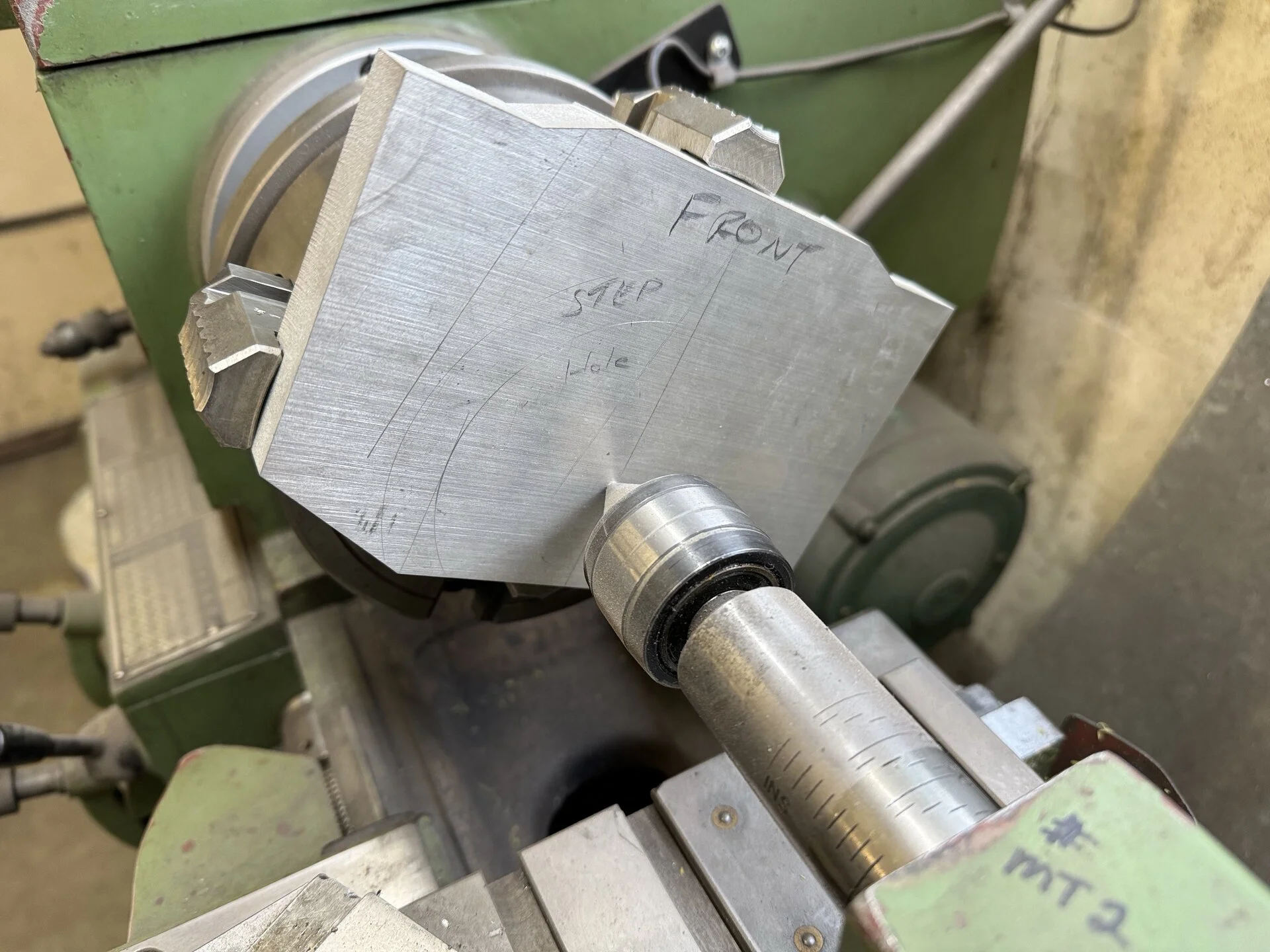

Try for lathe time this weekend.

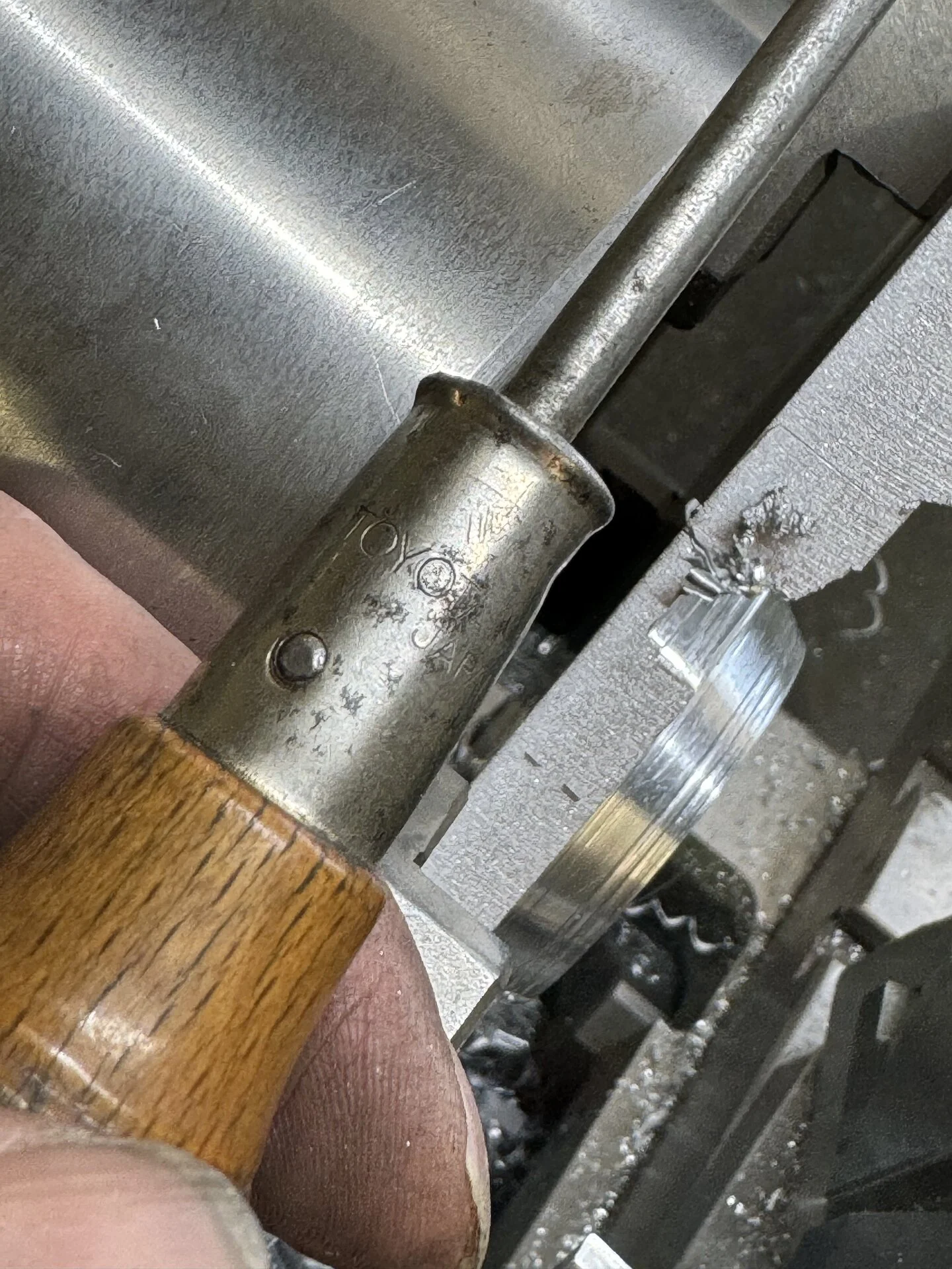

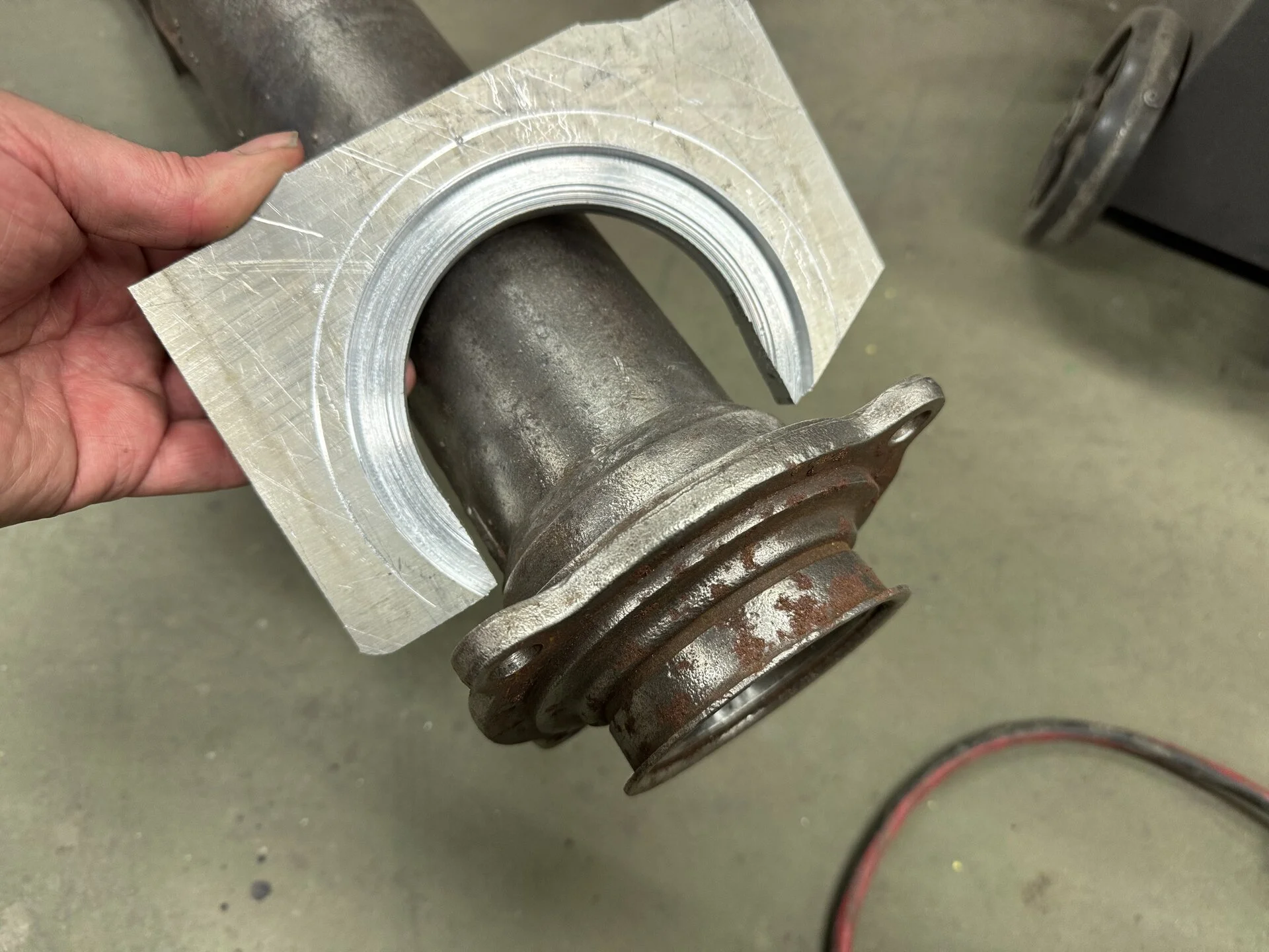

Had a great day over in the shop with dad, figured out the 4 jaw and didn’t ruin any tooling, win!
I had to laugh, this is the screwdriver he has next the lathe for changing carbides…he still has the original tool roll from the green pig somewhere.
