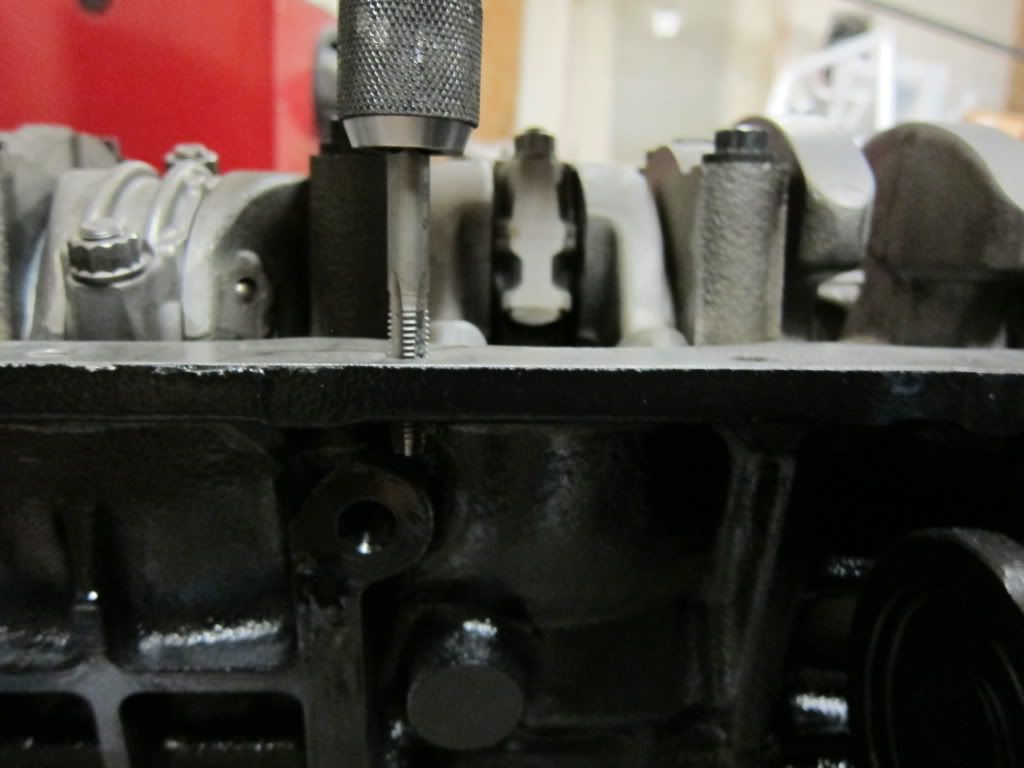

Thanks. The only part of the block that was blasted was in the crank case, with all the oil ports taped off. I have some wire long wire brushes that I used to clean the passageways and I also had had the block cleaned by the machine shop.

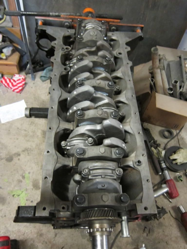

I forgot to mention that when my block was decked they found that it was bowed like a smile. Anyone else heard of this before?

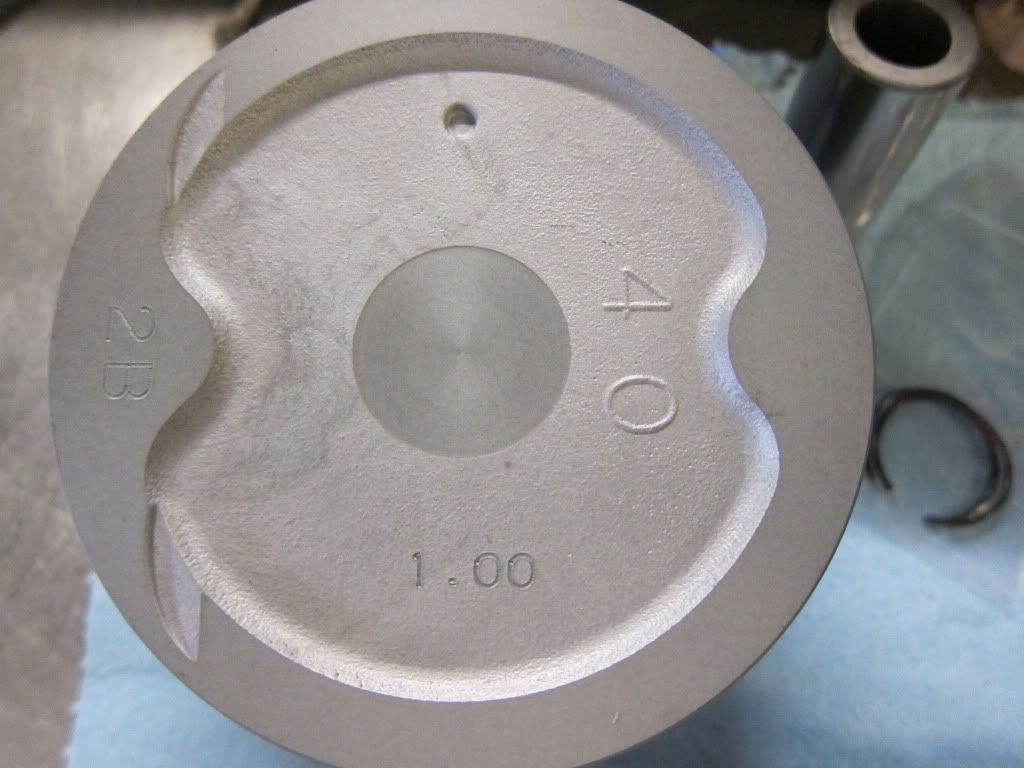

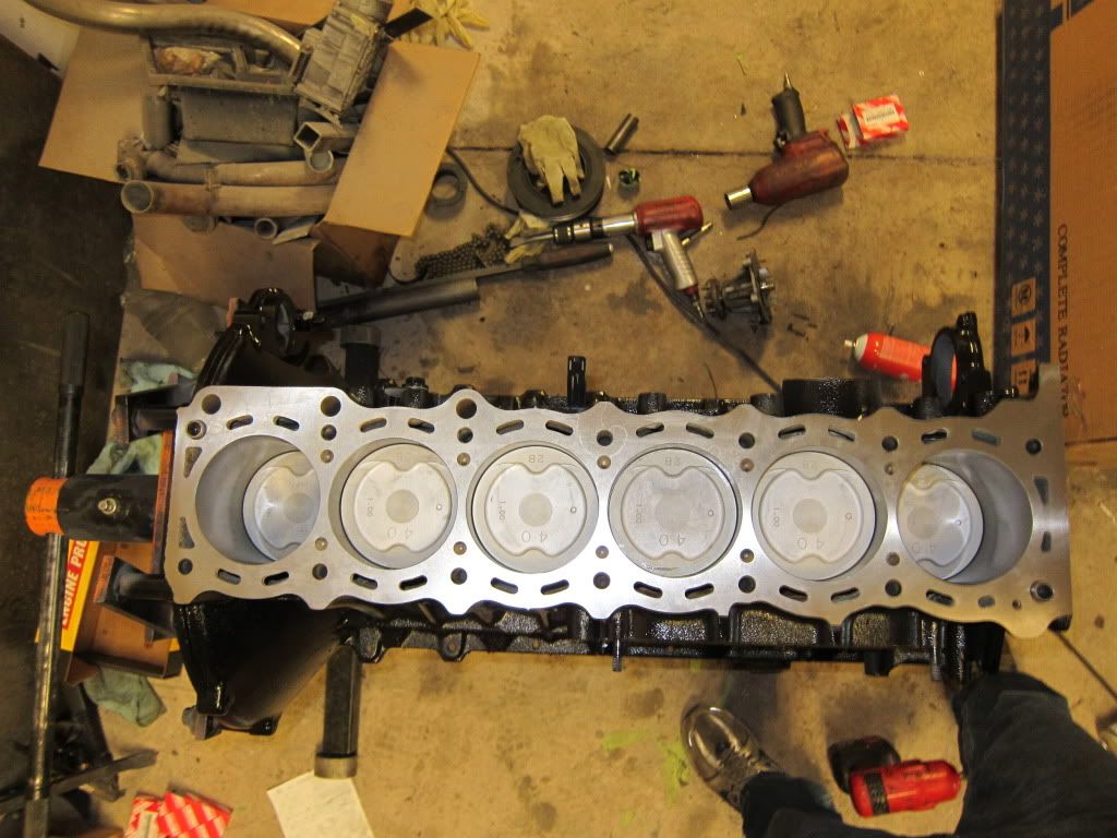

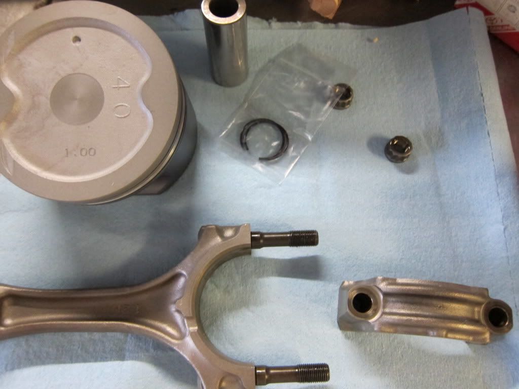

Toyota 1mm over sized pistons

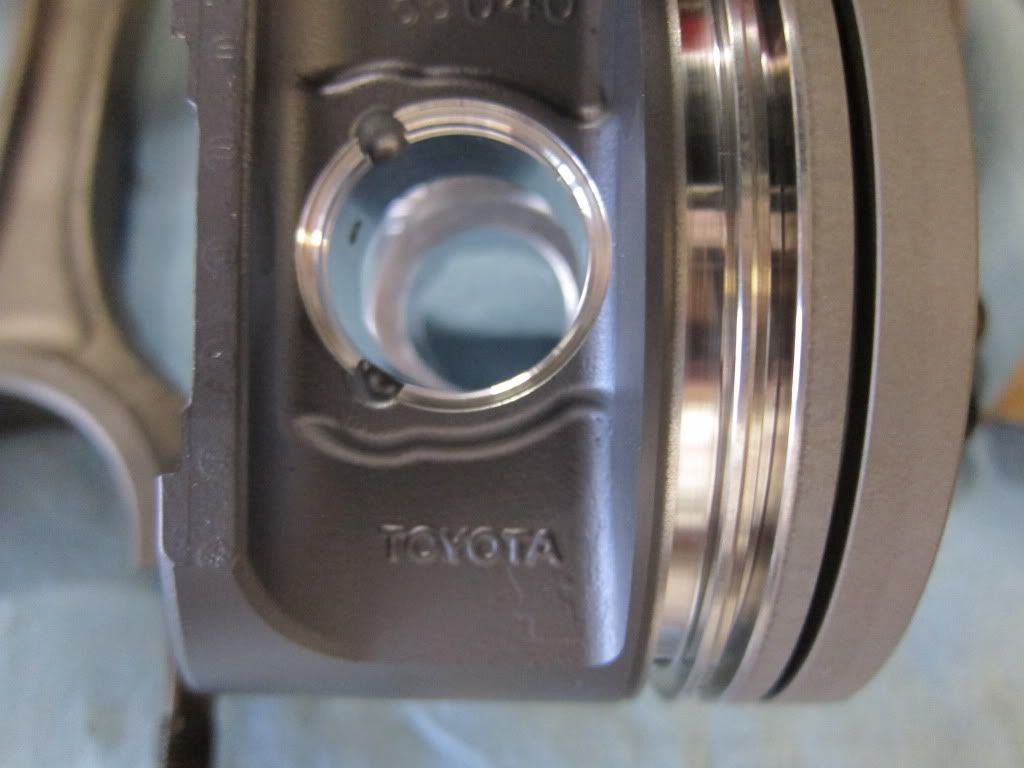

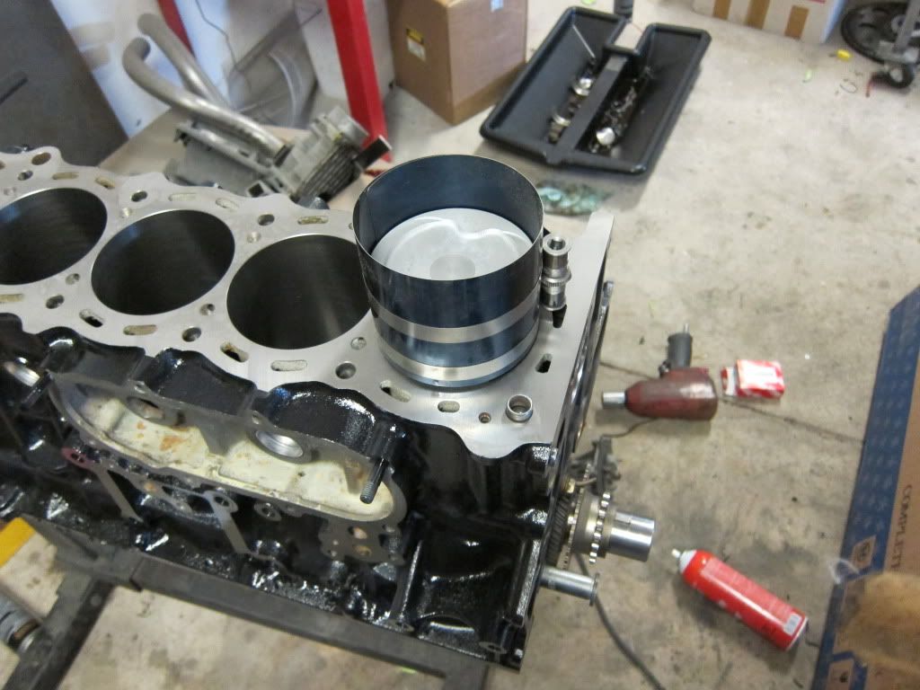

Toyota rings are stamped making installation easy

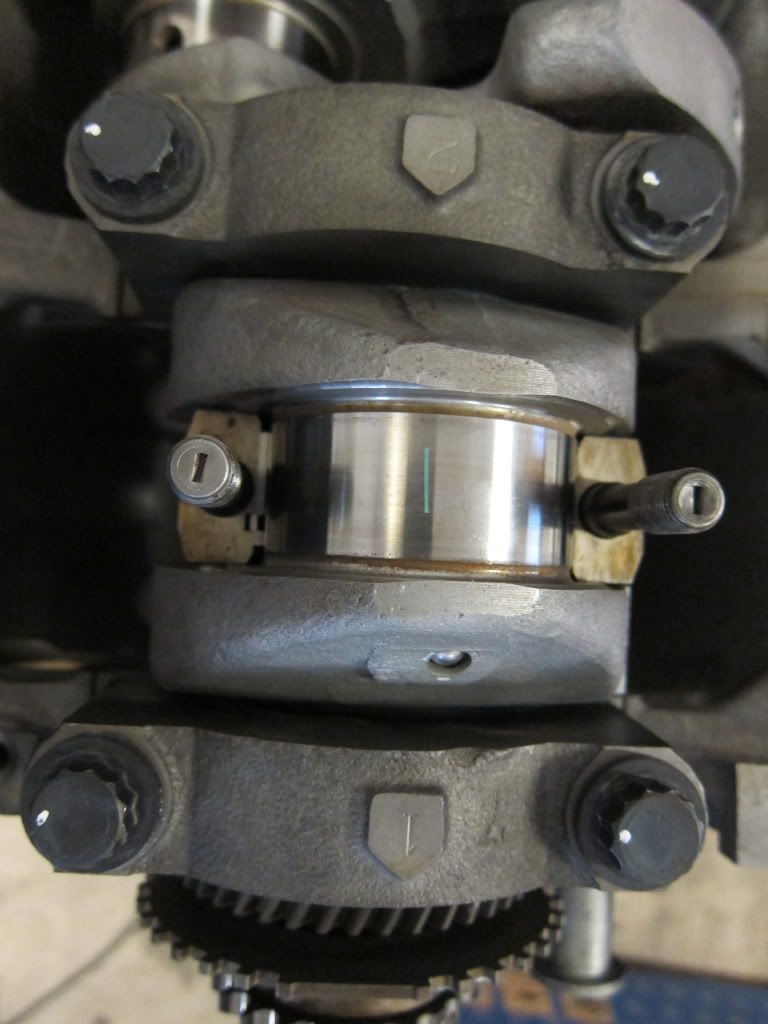

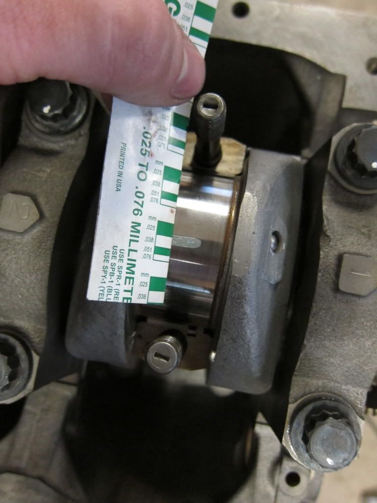

plastigage before checking clearance
after, all the rod bearings were in spec.

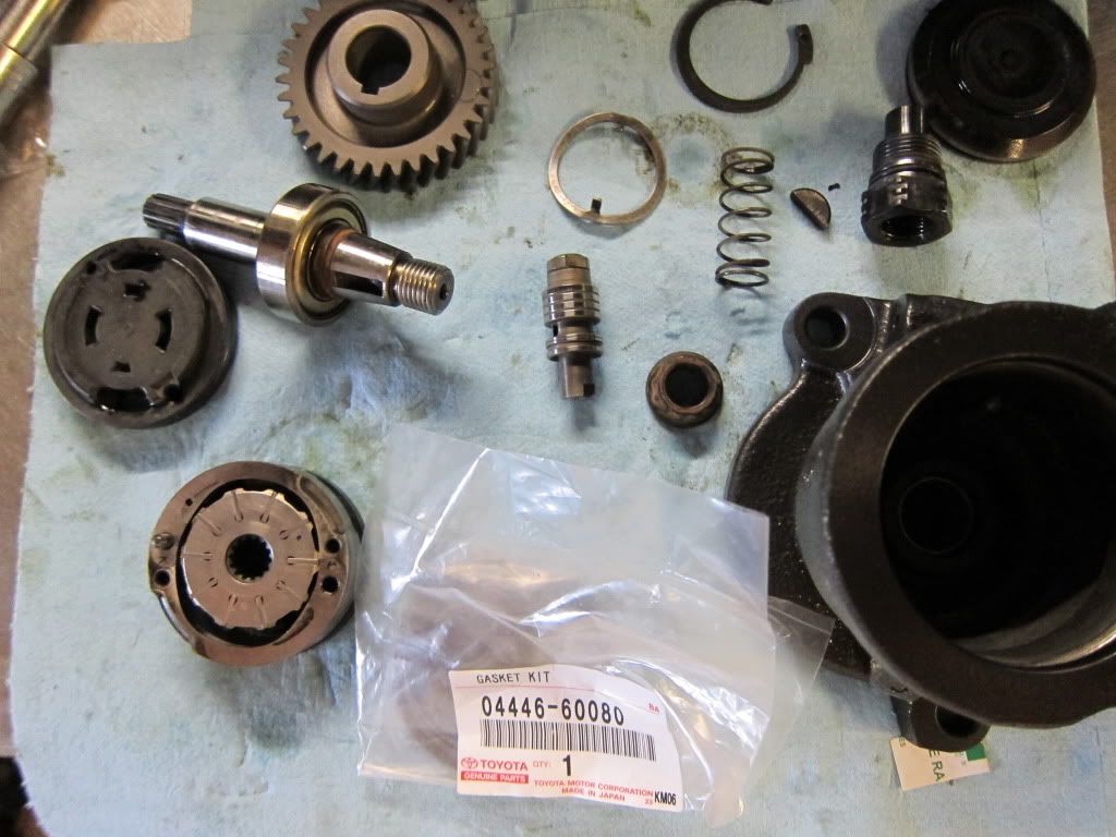

Rebuilt the power steering pump, FAQ made this super easy.

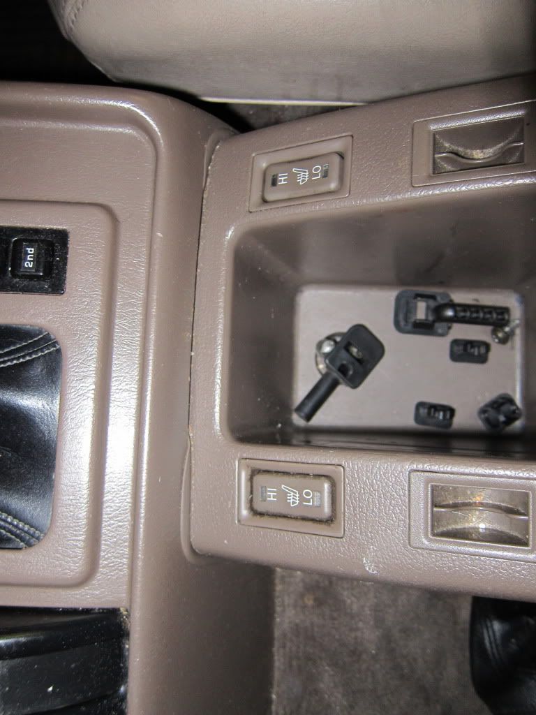

More of what is to come, seat heater switches from a 95-2000 Lexus ES300. Color is perfect.

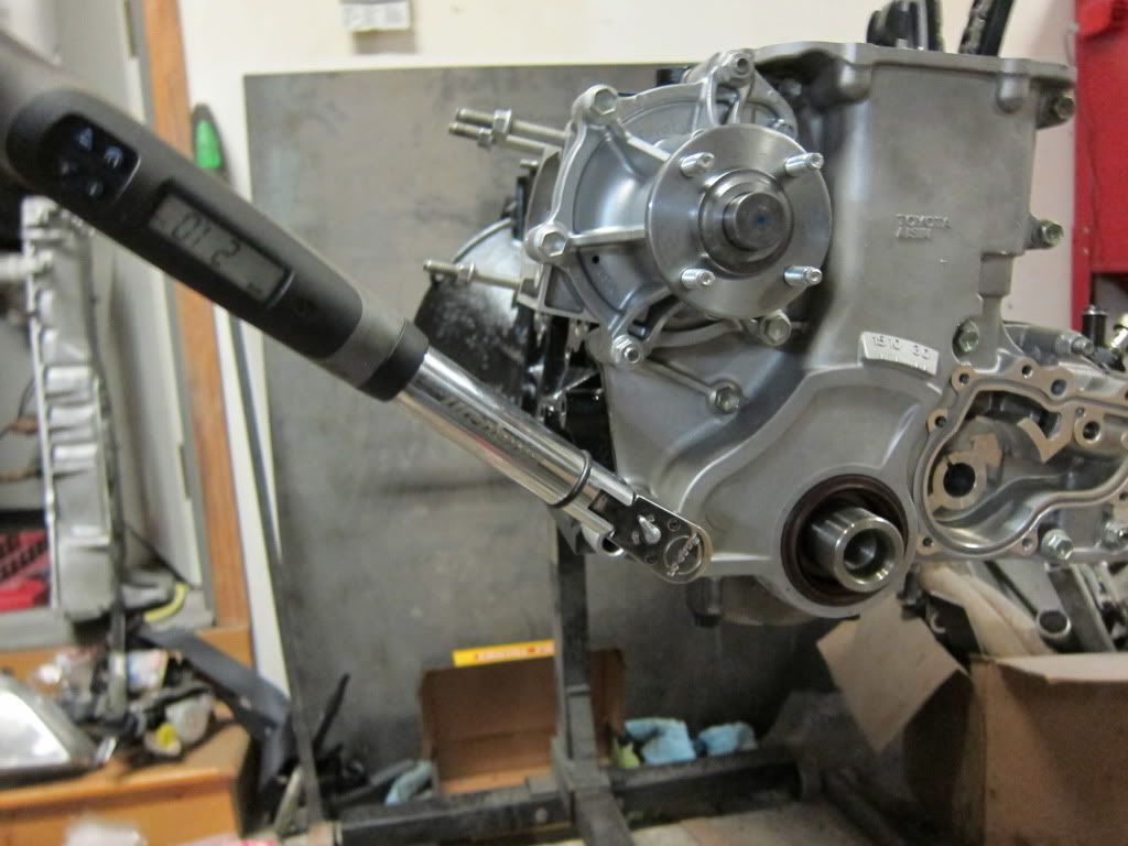

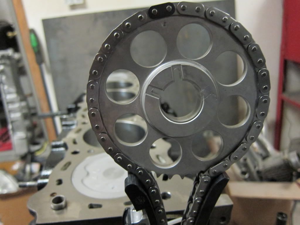

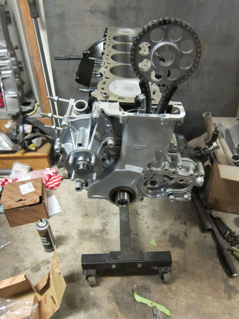

timing cover and chain

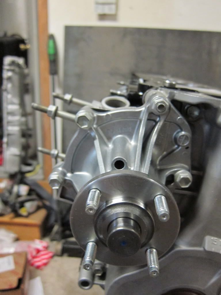

installed with FIPG and a new water pump
trying to be good about torquing everything to spec

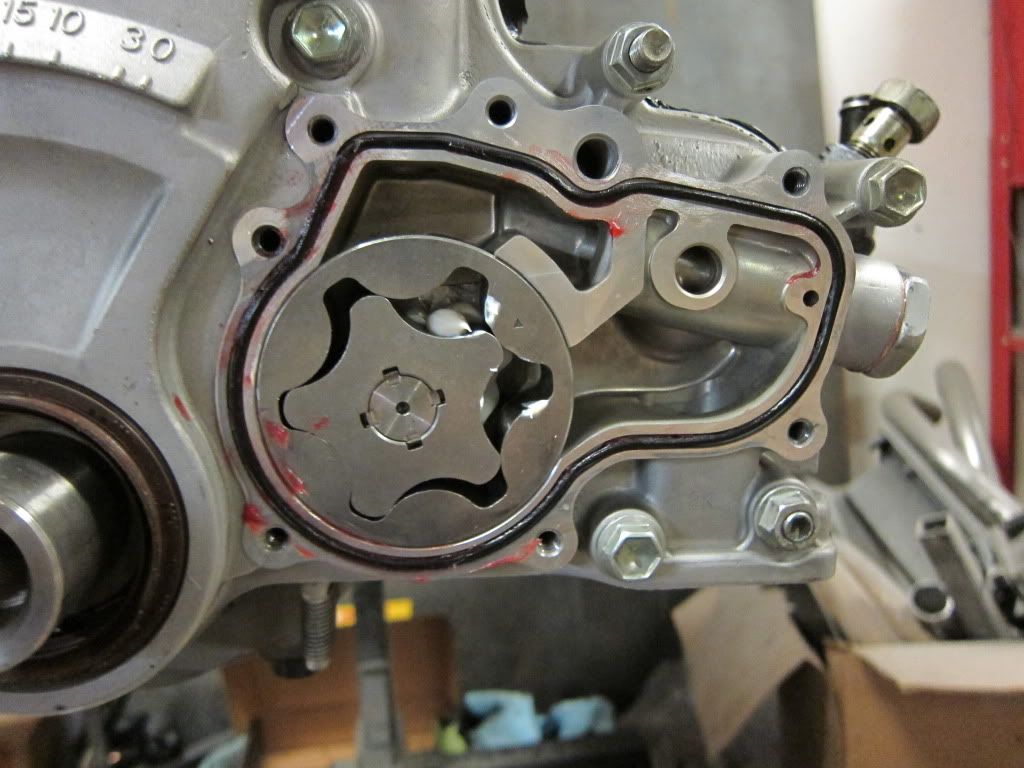

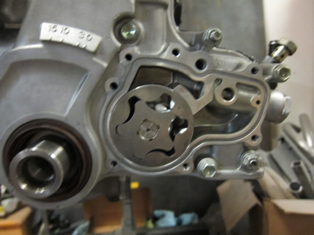

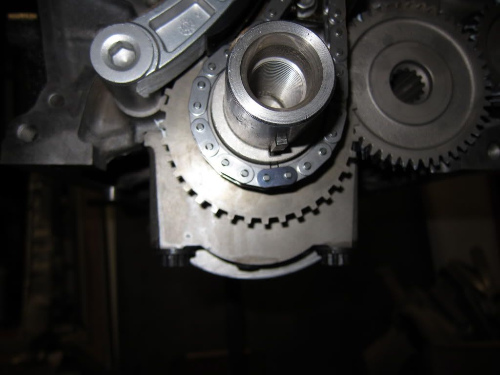

new oil pump rotor
red grease helps keep these types of o-ring in place
cleaning out the old gasket material

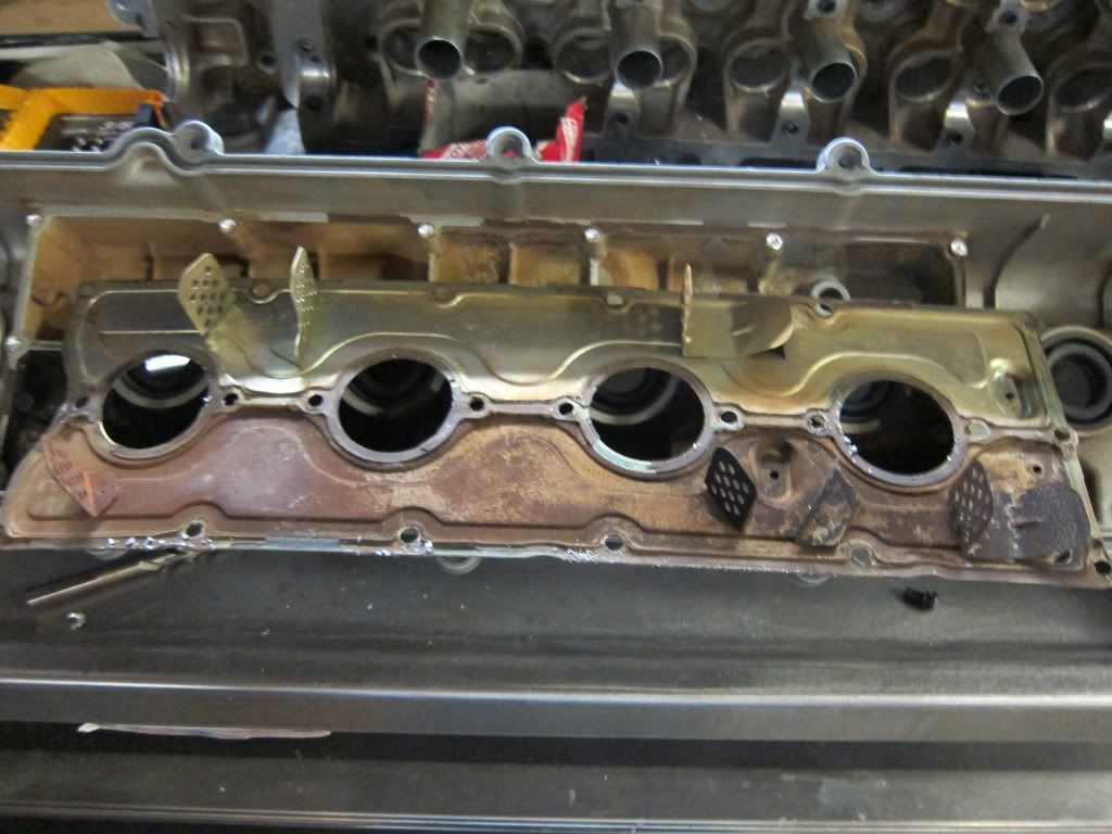

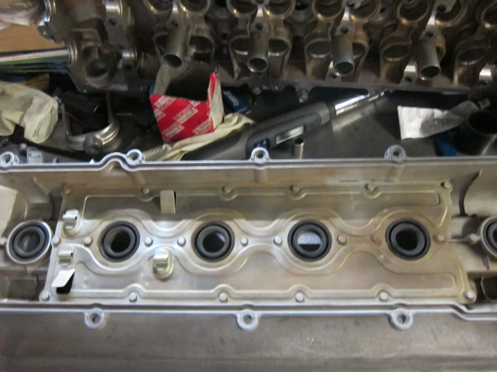

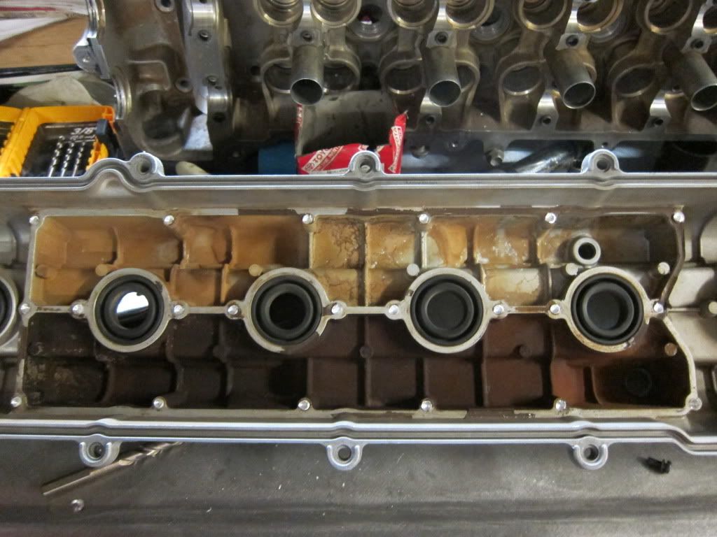

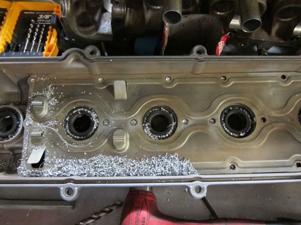

Finally for today I took off the baffle on the valve cover because I was really worried that glass beads were trapped in there.
I drilled of the heads of the aluminum coming through the baffle. My plan is to drill holes and use rivets or tap them and use machine screws to hold it back in place.
Needless to say it was free of glass beads but I found it very interesting how one side was more dirty than the other.

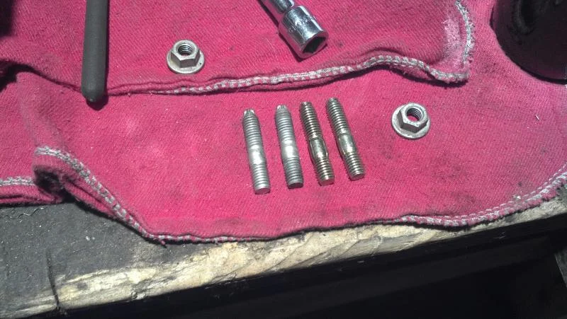

Just an FYI, I found a pretty elegant solution to those two stupid front timing cover studs that go through the upper oil pan and into the lower timing cover (which basically prohibits one's ability to take the timing cover off with the engine in the truck and necessitates jacking the engine up off the mounts to remove the upper pan and cover).
The two studs do not have Torx heads while most of the other studs on the 1FZ do.
The two EGR studs are exactly the same size, thread and pitch, as well as length. The shank in the middle is the same as well.
So, I decided to use those studs on my customer's engine. Worked perfectly.
Here's the two side-by-side and also a nicely cleaned head. God, I love beautiful clean Aichi aluminum.....
