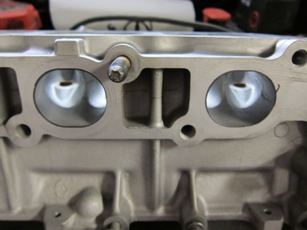

Just an FYI, I found a pretty elegant solution to those two stupid front timing cover studs that go through the upper oil pan and into the lower timing cover (which basically prohibits one's ability to take the timing cover off with the engine in the truck and necessitates jacking the engine up off the mounts to remove the upper pan and cover).
The two studs do not have Torx heads while most of the other studs on the 1FZ do.
The two EGR studs are exactly the same size, thread and pitch, as well as length. The shank in the middle is the same as well.
So, I decided to use those studs on my customer's engine. Worked perfectly.
Here's the two side-by-side and also a nicely cleaned head. God, I love beautiful clean Aichi aluminum.....
So Beno, while one has their engine out, this seems it would be a good thing to change out to the Torx studs and would allow one to remove their timing cover if need be in the future without jacking up the engine? Did I understand that correctly?
In theory, yes. Whether it can work, would have to be seen at some future date.

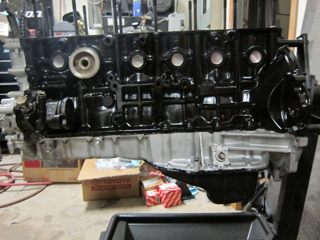

I've been on my back in dirt installing upper oil pan/lower pan/timing cover/water pump, etc/crankshaft pulley/head tonight...
I wish I had a real shop. :frown:
At least I have the correct tools! :grinpimp: [thanks CDan and Mrs. CDan for the ultimate Xmas gift!]
Thanks for looking, everyone on this site have been so great and helpful so far.

Got the oil pans on

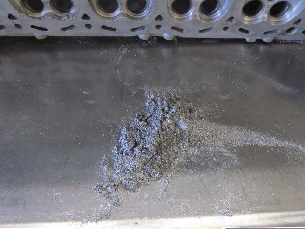

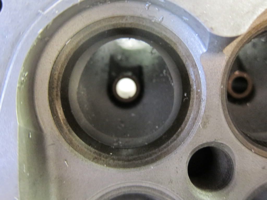

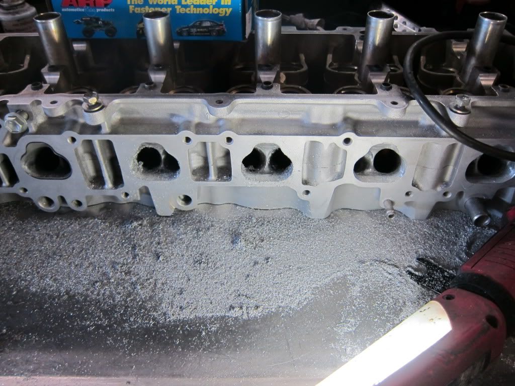

More port and polishing, really not my favorite thing, but I am almost done. Intake before any work.

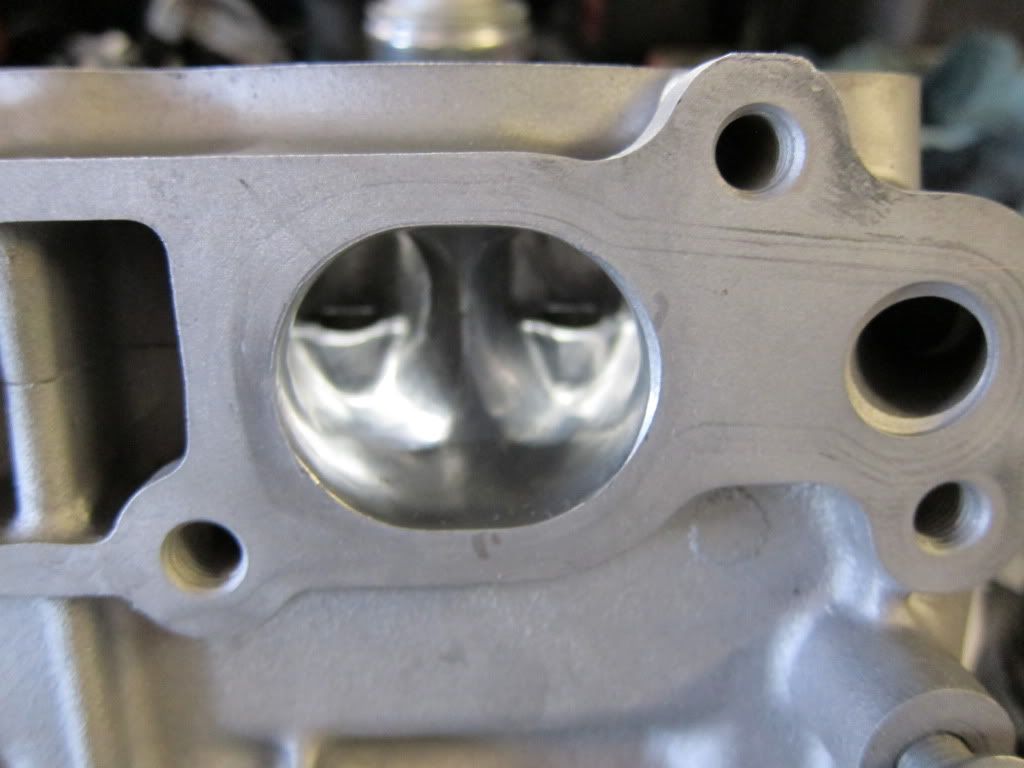

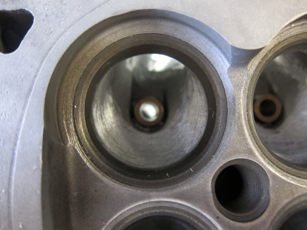

And after, not polished yet though
Removed a lot of material on the intake side trying to match the gasket
