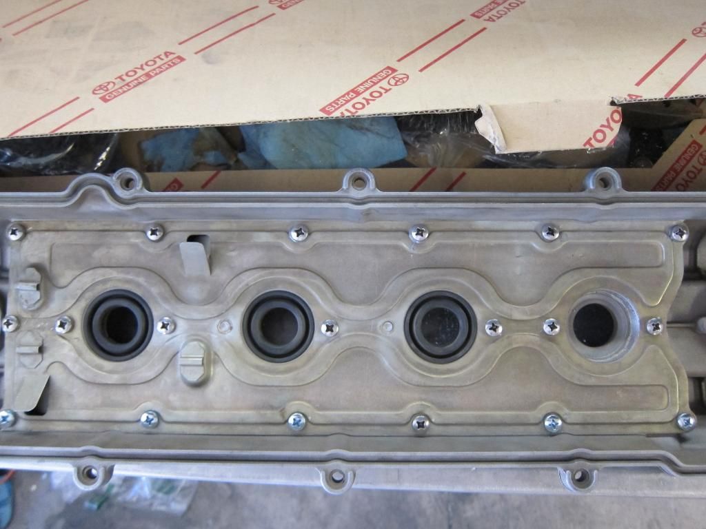

I installed the baffle on the valve cover. I used JB weld on the treads to make sure the screws do not come loose and cause problems.
Do you have any more details on this mod for the baffle? What did you use to drill the heads of the aluminum rivets? What size did you tap for the screws?
Thanks in advance!
Thanks in advance!
I don’t recall off hand. I think I used M6s
Nothing else to it.
