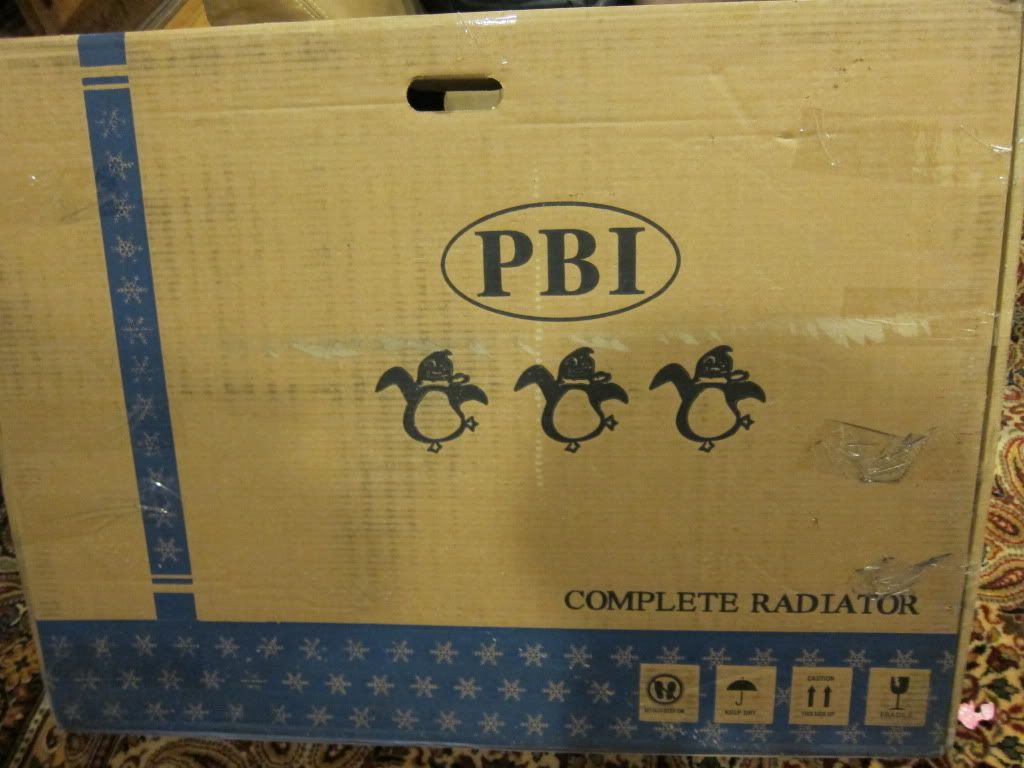

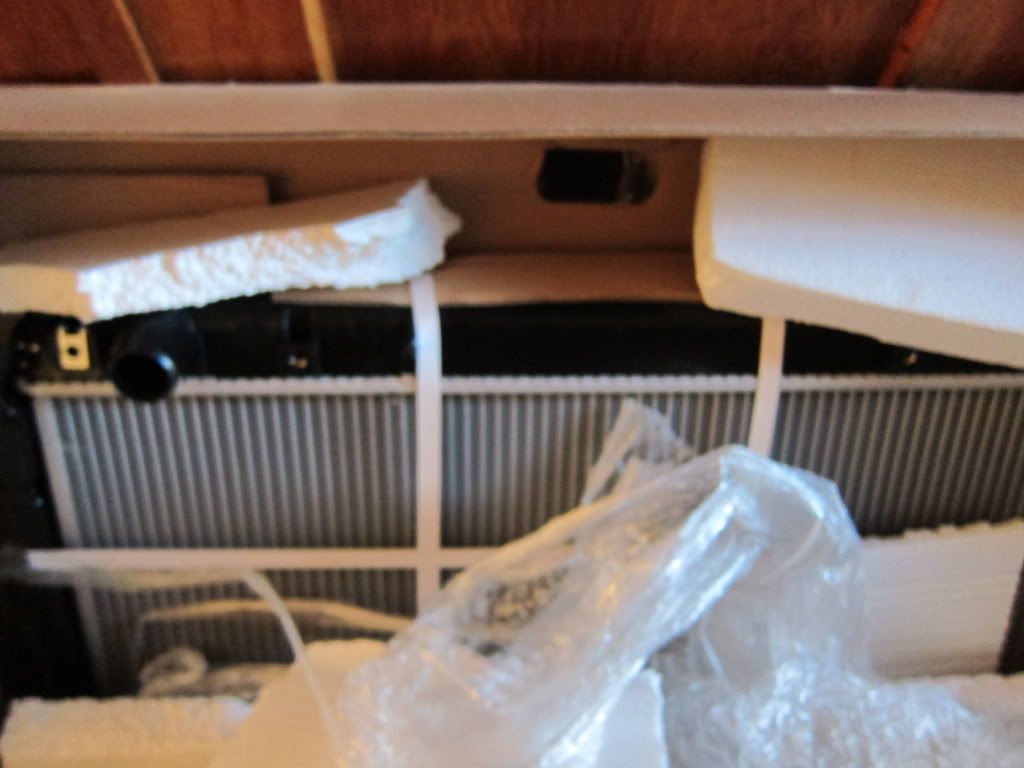

The C1917 still has plastic tanks but has a 3 core Copper (93-94 style) looks like you got a 2 core aluminium (95-97) style non Koyo. In my searching for a replacement rad I read on here about some one else having that issue and then finding out from koyo that Go-part is not a Koyo dealer and they (koyo) have had complaints about them before or something along those lines.
I ended up getting a OEM Toyota 93-94 copper 3 core, it hurt ($500) but the quality and knowing it was going to be right off set that a bit.
Man I hope this is not the case... I paid for Koyo and thats what I better get.
Here is the box, does not look koyo.
That is defiantly not a Koyo, I would be calling then right away to get a correct replacement or your money back.

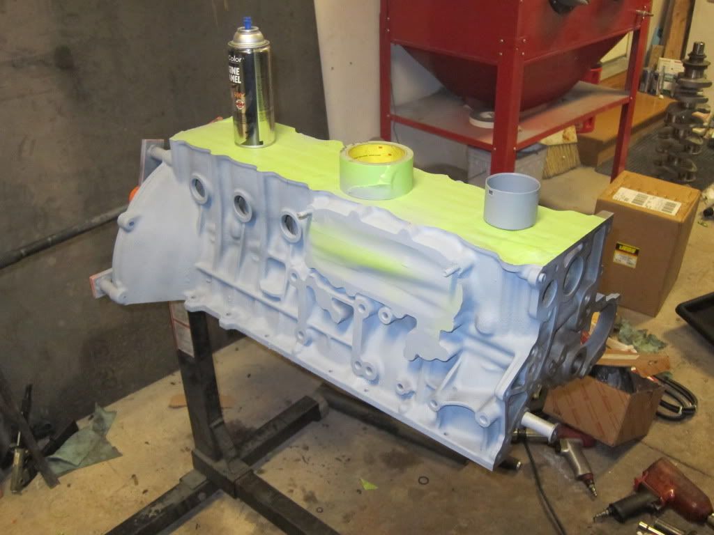

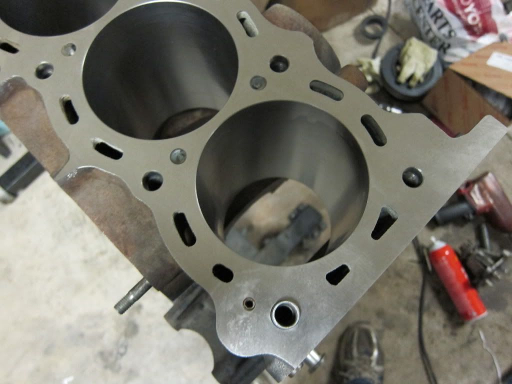

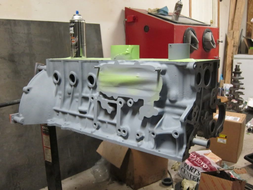

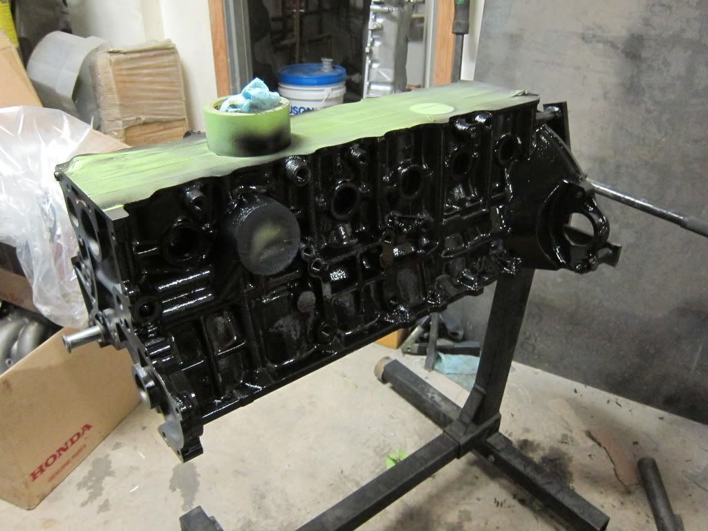

Looks great so far! Did you blast the block? What did you do to clean out all the passageways?

FWIW, I ordered a Koyo C-1917 radiator from Go-part on July 14th of 2011 ($264.00 including shipping), and that's exactly what I received. Sounds like they got your order mixed up, as mine has all metal tanks and a brass 3-core center.
