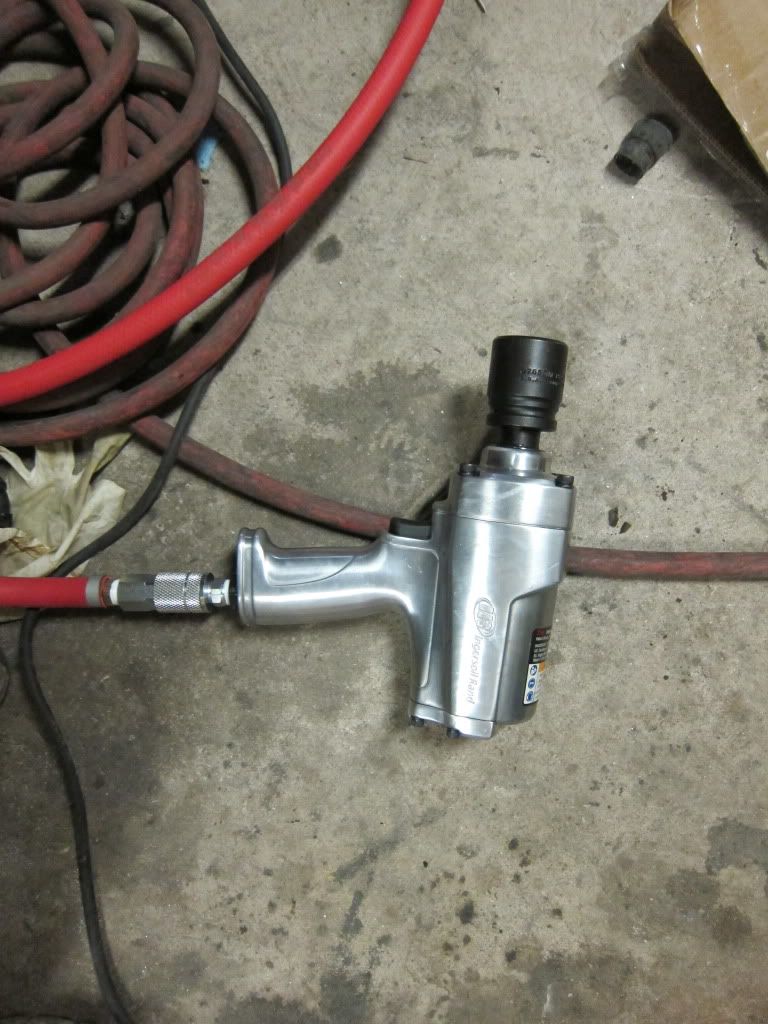

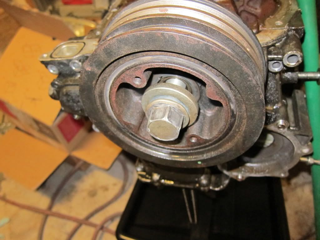

finally got the crank bolt off... had to buy a 3/4 impact, oh well I like tools
http://i582.photobucket.com/albums/ss270/yotakrawler/IMG_2244.jpg
http://i582.photobucket.com/albums/ss270/yotakrawler/IMG_2243.jpg

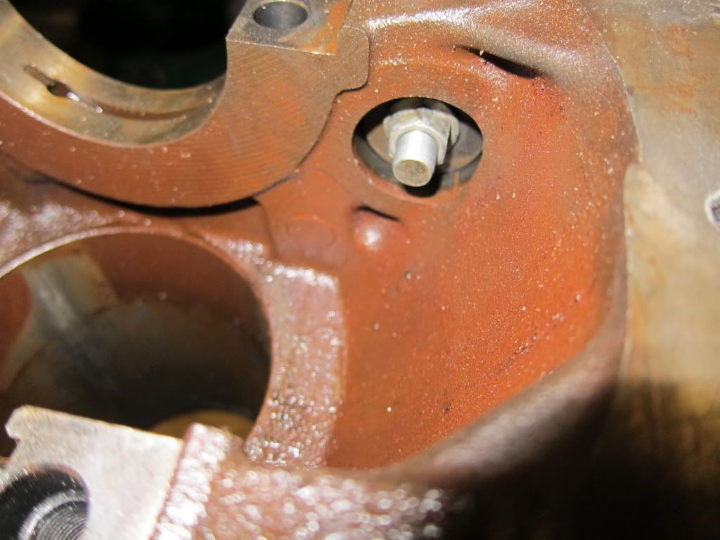

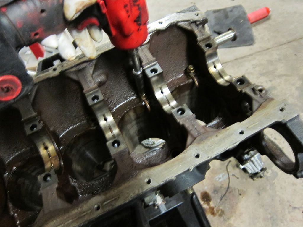

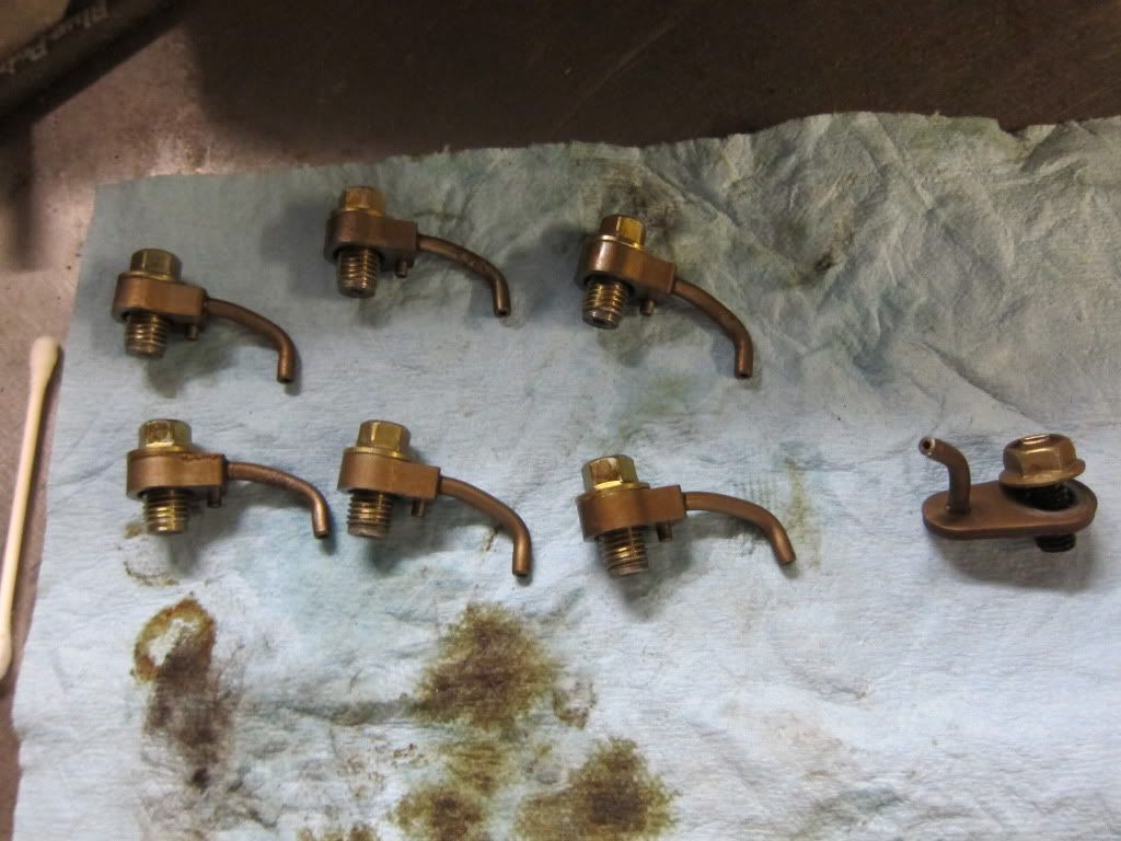

pulled out the oil squirters
http://i582.photobucket.com/albums/ss270/yotakrawler/IMG_2247.jpg
popped out the machine plugs
http://i582.photobucket.com/albums/ss270/yotakrawler/IMG_2248.jpg

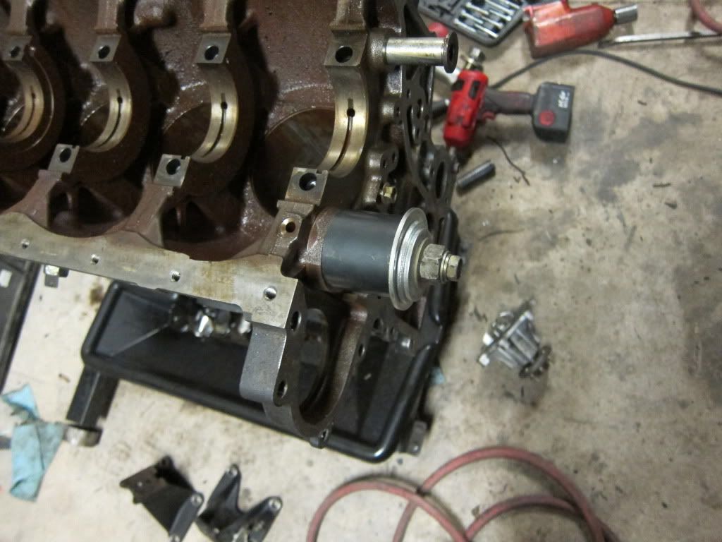

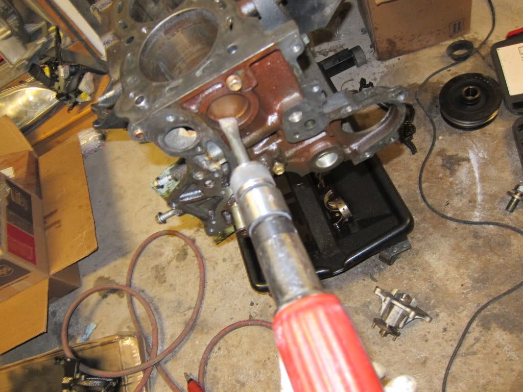

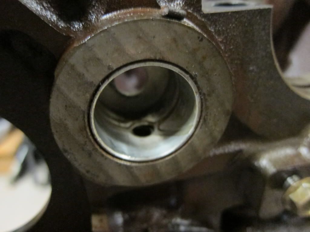

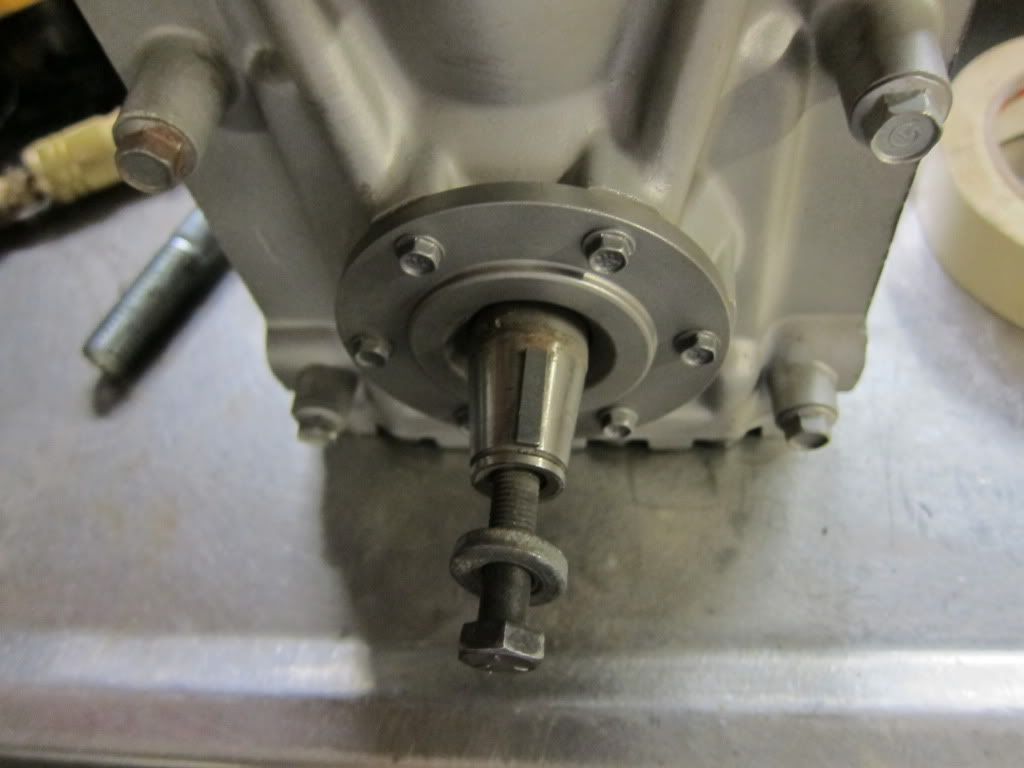

pulled out this stupid bushing. I am getting ready to get the block tanked
http://i582.photobucket.com/albums/ss270/yotakrawler/IMG_2245.jpg
I used a sleeve from my ball joint service kit some washers and a long bolt... it worked great
http://i582.photobucket.com/albums/ss270/yotakrawler/IMG_2251.jpg
http://i582.photobucket.com/albums/ss270/yotakrawler/IMG_2252.jpg

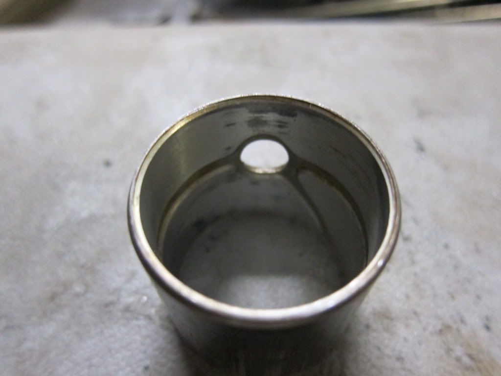

I saw that one of the vendors on here was selling this bushing, you guys think I should replace it?
http://i582.photobucket.com/albums/ss270/yotakrawler/IMG_2254.jpg
If you have it torn down this far, then it probably isn't a bad idea to replace it.

I've had a few bushings that needed to be replaced. I clean the shaft on the oil pump gear with 400 grit emery soaked in Isopropyl alcohol to remove any bearing material that might have transferred to it. I then place the shaft into the bushing and check of play. If you can any play between the shaft and bushing I would replace the bushing.
The bushing needs to be pressed into the block for this as the ID will shrink slightly when pressed in.

Thanks guys, I decided to order a new one. I figure this far in I might as well

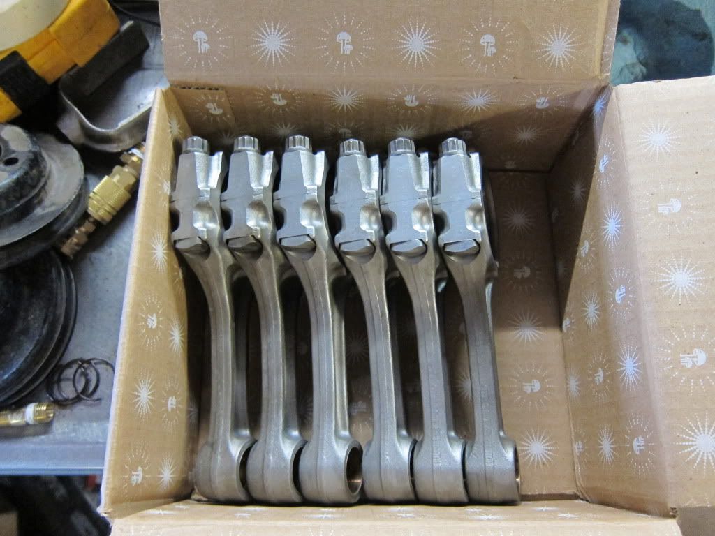

I got some parts in from Cdan, including pistons, so I took the block down to the machinist to work his magic.

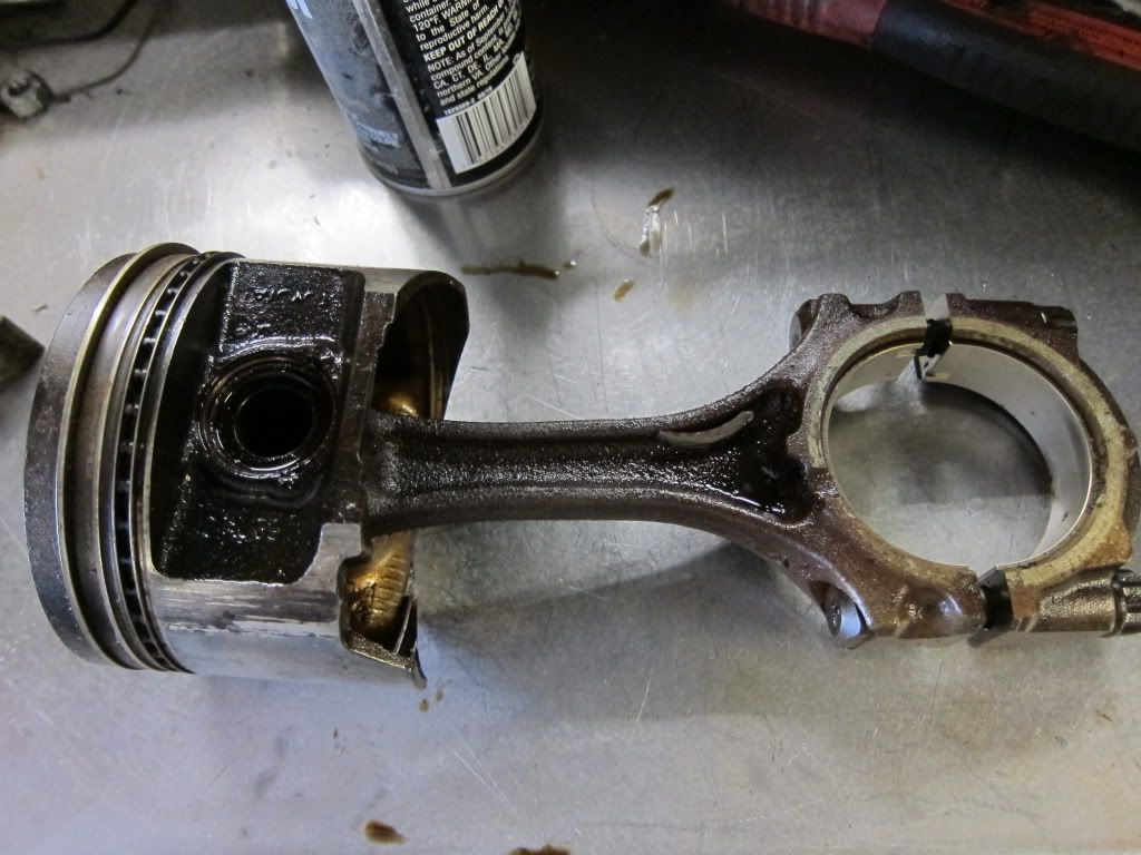

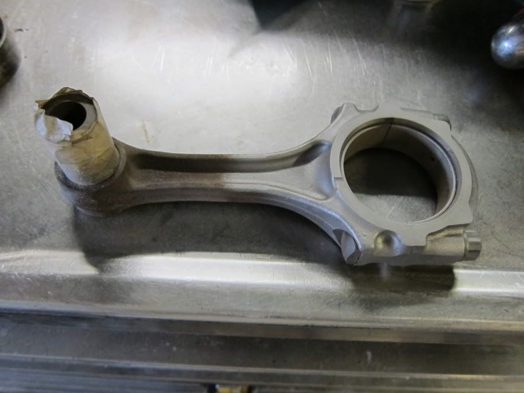

Removed the pistons and cleaned the rods
http://i582.photobucket.com/albums/ss270/yotakrawler/Landcruiser/IMG_2255.jpg
http://i582.photobucket.com/albums/ss270/yotakrawler/Landcruiser/IMG_2256.jpg
http://i582.photobucket.com/albums/ss270/yotakrawler/Landcruiser/IMG_2257.jpg

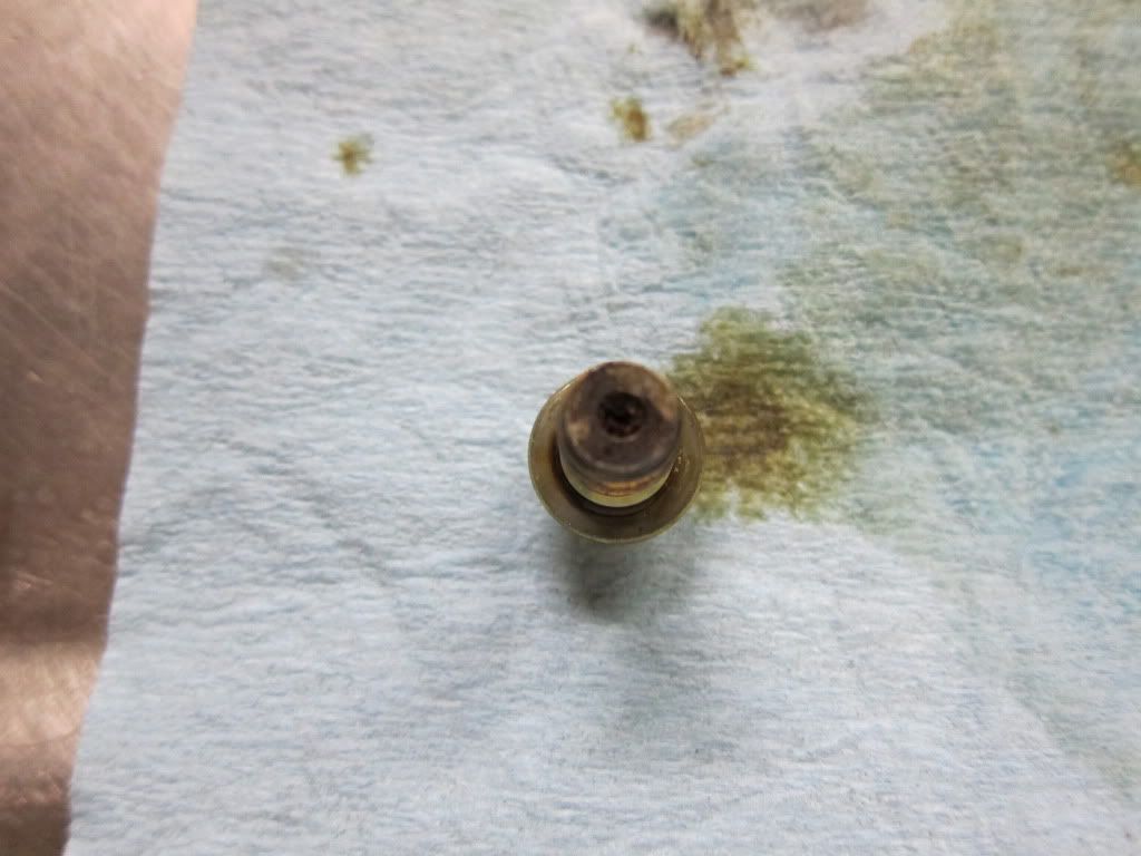

Oil squirters looked clogged... cleaned with break cleaner and compressed air
http://i582.photobucket.com/albums/ss270/yotakrawler/Landcruiser/IMG_2262.jpg
http://i582.photobucket.com/albums/ss270/yotakrawler/Landcruiser/IMG_2263.jpg

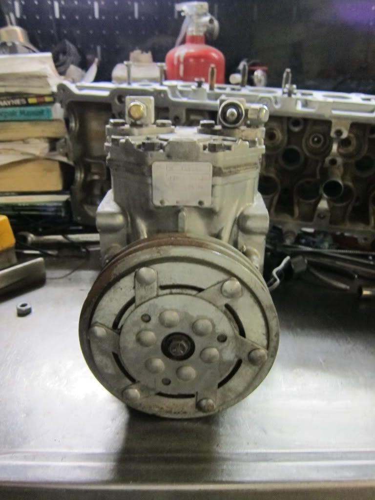

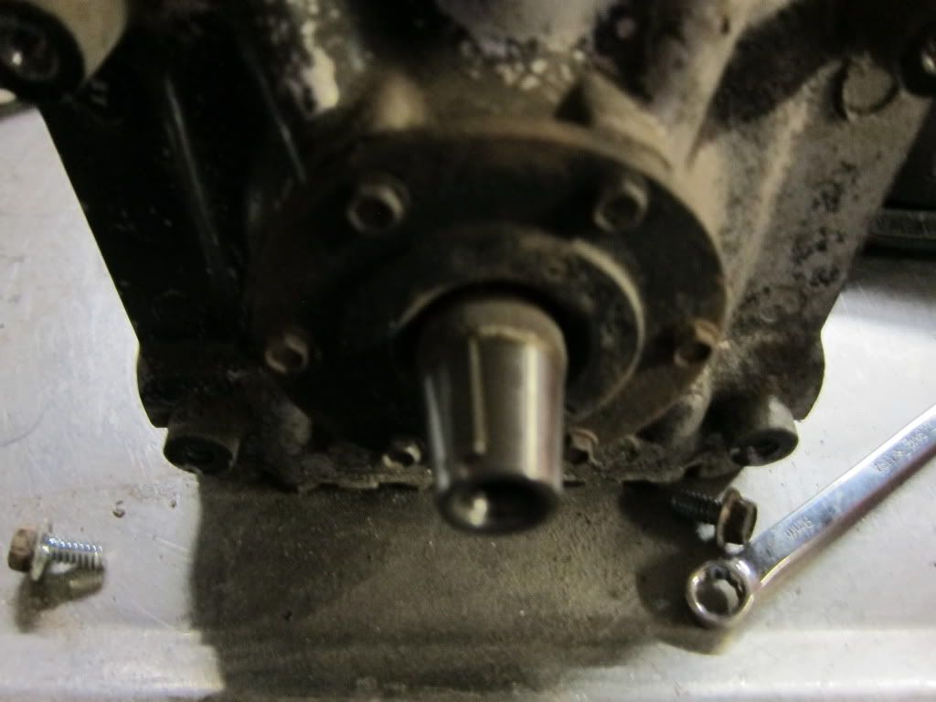

A little taste of what is to come... York 210
http://i582.photobucket.com/albums/ss270/yotakrawler/Landcruiser/IMG_2260.jpg
http://i582.photobucket.com/albums/ss270/yotakrawler/Landcruiser/IMG_2261.jpg

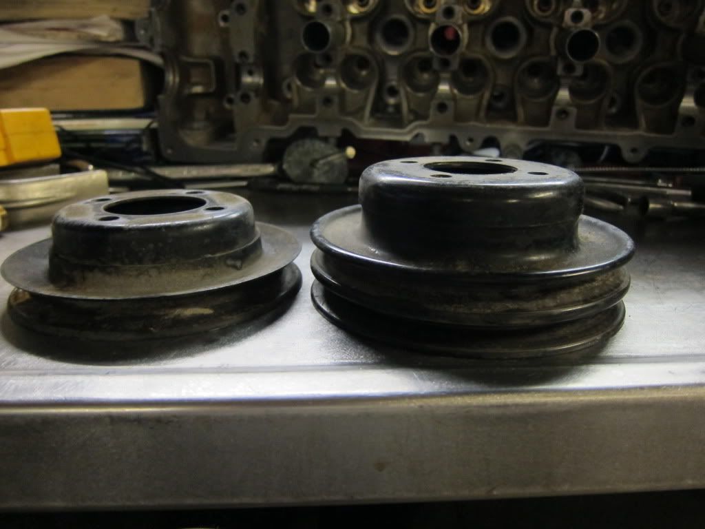

I plan to combine the 80 series pulley (right) with an extra 22re pulley (left) for the new belt to drive the york. We will see.
http://i582.photobucket.com/albums/ss270/yotakrawler/Landcruiser/IMG_2259.jpg
http://i582.photobucket.com/albums/ss270/yotakrawler/Landcruiser/IMG_2258.jpg

Looks like you've actually got a 209 York, not a 210.
You can identify the crank of the different models by the geometry at the end of the crank. Check out page 17 of the York manual and you'll see what I mean.
Not a big deal, unless you end up ordering parts.
Thanks I totally forgot that I had two yorks and only one was a 210.. here is my other one.
