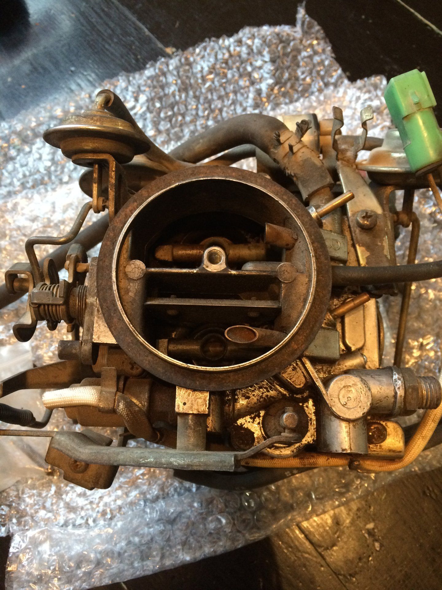

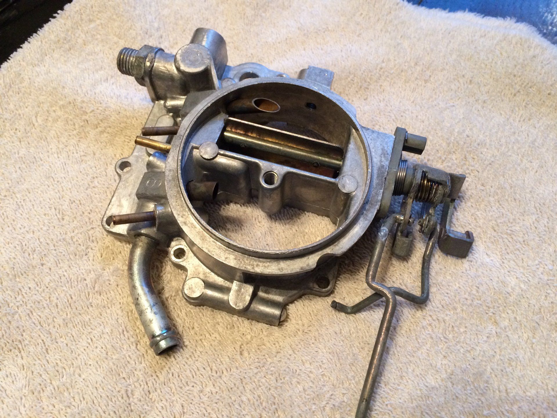

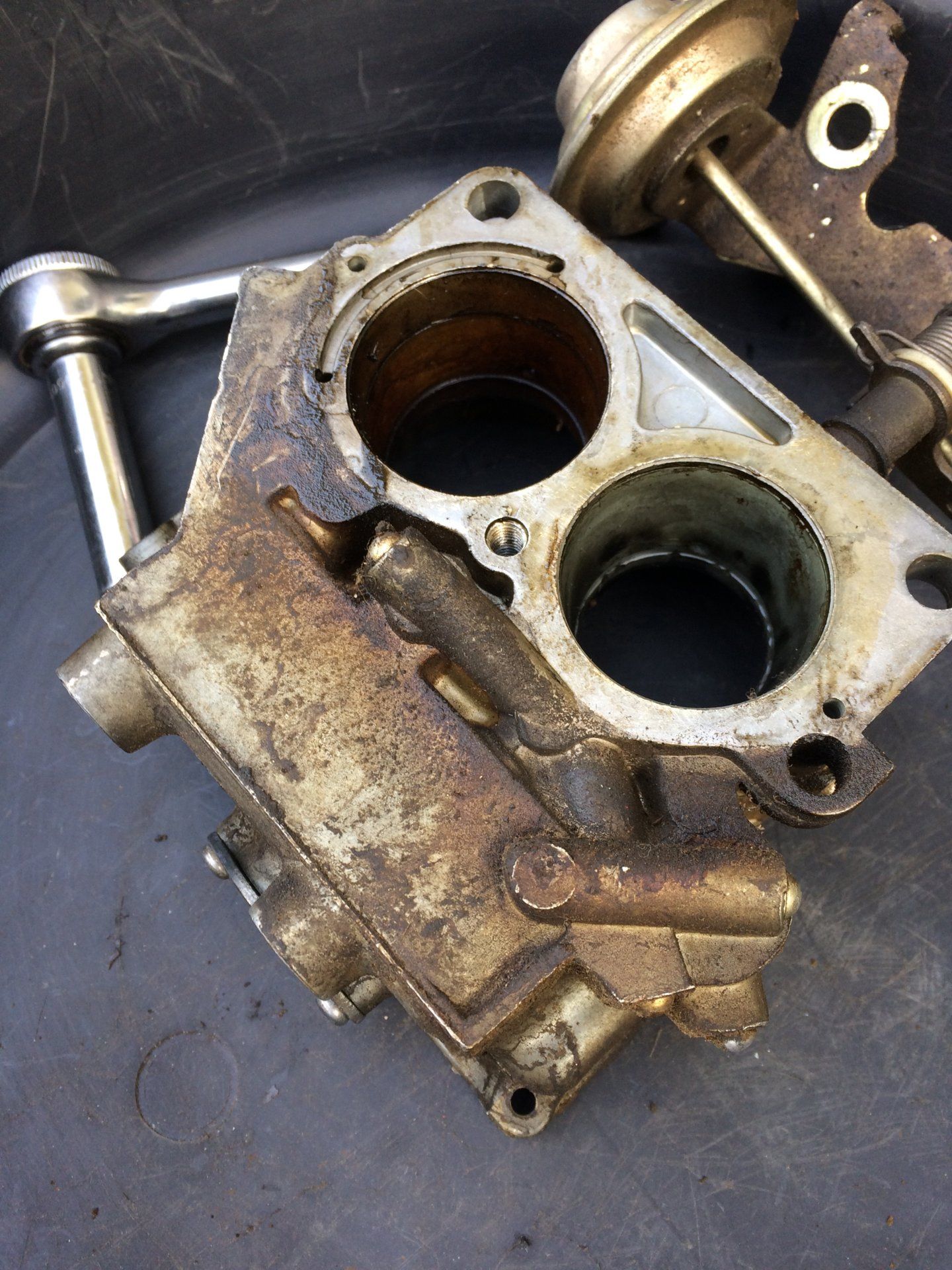

Number two Carb Rebuild of a carb core I picked up from @4Cruisers a few days ago. Okay so I’ll be way forward here and say.... I spent about 10 mins pondering how I could use one of two vibrators to make a ultrasonic cleaner this AM. Unfortunately both were too old and the batteries had corroded the innards. Apparently batteries should be removed when tools like that are given a rest. Insert smirk here, ;) Then I decided to try the cheap palm sander route. 1.3A, metal stock pot, blue simple green cleaner and gorilla tape. It was fairly noisy until the handle vibrated right off the lid then it was much better. Absolutely worked better than just dipping.
My before pix is simply a shot straight down (gasket still in place) right after removing from the shipping box.
Last three are after only 30 mins.
The middle section of the carb where both check valves reside I chose to drop right side up into the chem dip and added the sander on top. Both valves are semi glued down from old solidified fuel. And in the bowl is a fuel puddle that is rock hard.
I turned the sander on for about 15 mins then decided to let it rest. I worked last night and wasn’t asleep till 1 then I woke wired at 6 so it was time for me to head inside, take a hot shower and eat. Luckily the temps were pretty mild today, about 48.
The next few pixs are before any dip or buzzing.

now what, you tape the sander to the stock pot and it all stays together? Do you have pics of the carb body after 15 minutes in your shaker? I need to do that trick.

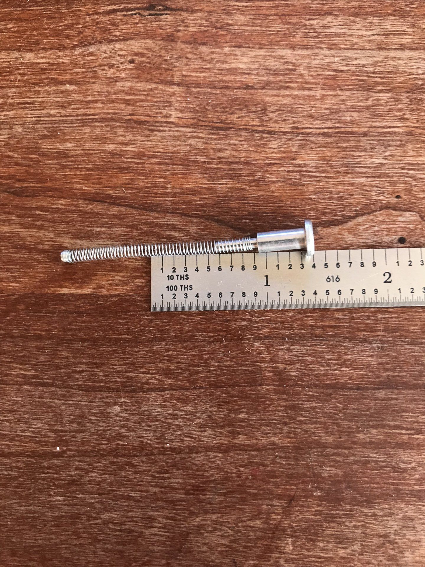

The aluminum discharge weight from this carb and it’s spring shown below. The spring is thin and soft very similar to some pens. I have an extra from the double pen I hijacked months ago. Did you find an equivalent or are you hijacking another from a different area of the carb?
And I posted a before photo of the air horn from this carb (granted not the best photo) and after above.

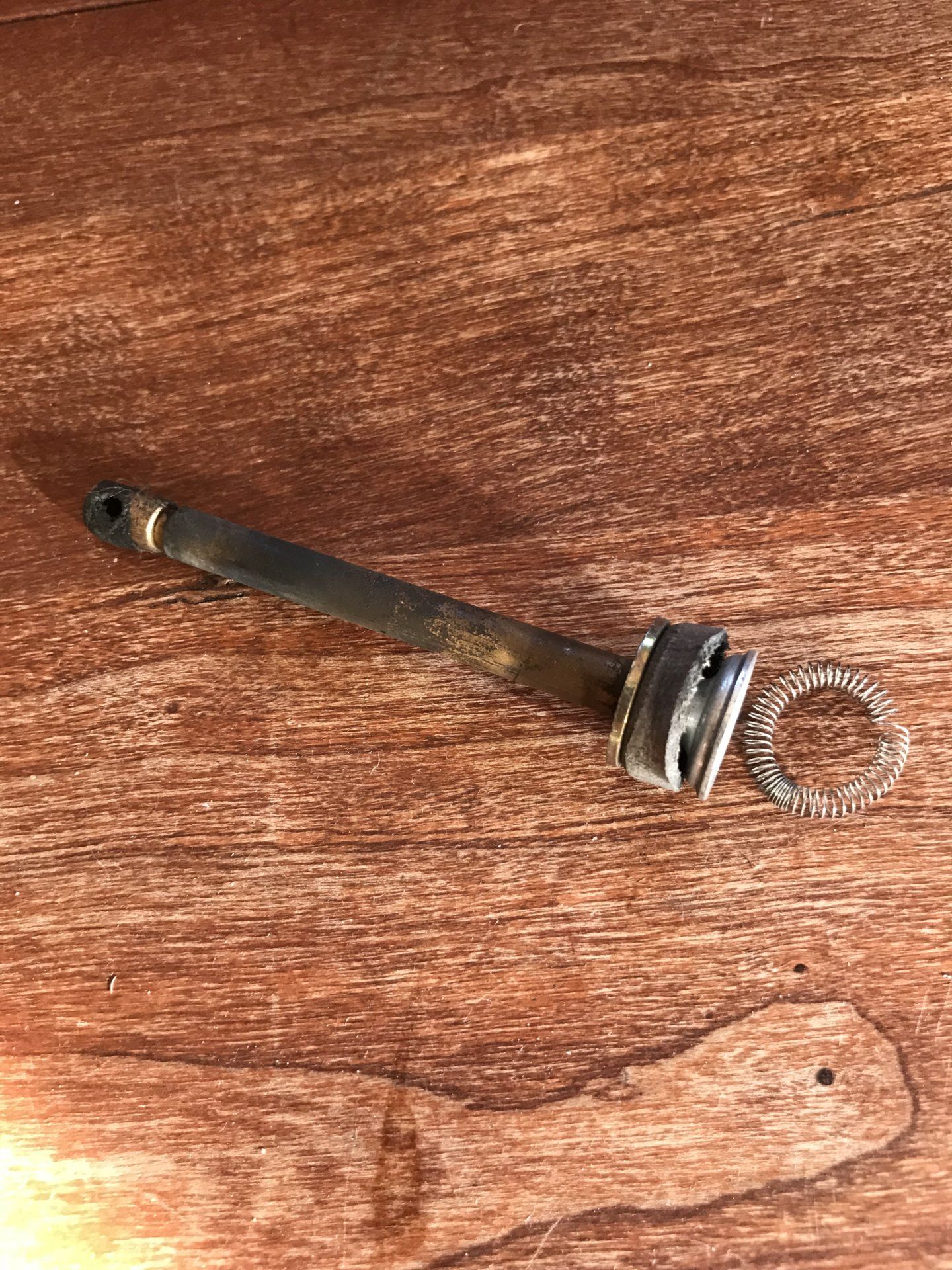

I could never find the right spring from a bic pen, they were all too big and not floppy enough. My guy who rebuilds alternators and starters hooked me up with springs from his millions of leftover brush kit pieces, they were close to the right softness, but too short. I started thinking more about finding a spring from underneath a seal, like the idk, cam cover seal, something small.
Then I was pawing through my old carb junk leftover from my last carb rebuild just because I like to do that sometimes. Sitting there was an old accelerator pump plunger, the kind with the pink leather, that I had ruined when I didn’t properly soak it. So I thought, what’s under the leather piece? sure enough the perfect small, but not too small, and perfectly floppy, springy, spring. It’s just twisted together at the ends to hold it in a circle and then inserted underneath the leather to act as the small force on the circumference of the plunger as it goes up and down in the accelerator bore.
Most people don’t use the plunger if they rebuild, it comes in the kit or they buy the better leather one and the old one can be cannibalized for this missing spring. Just needs trimming to length of about 3/4” long.

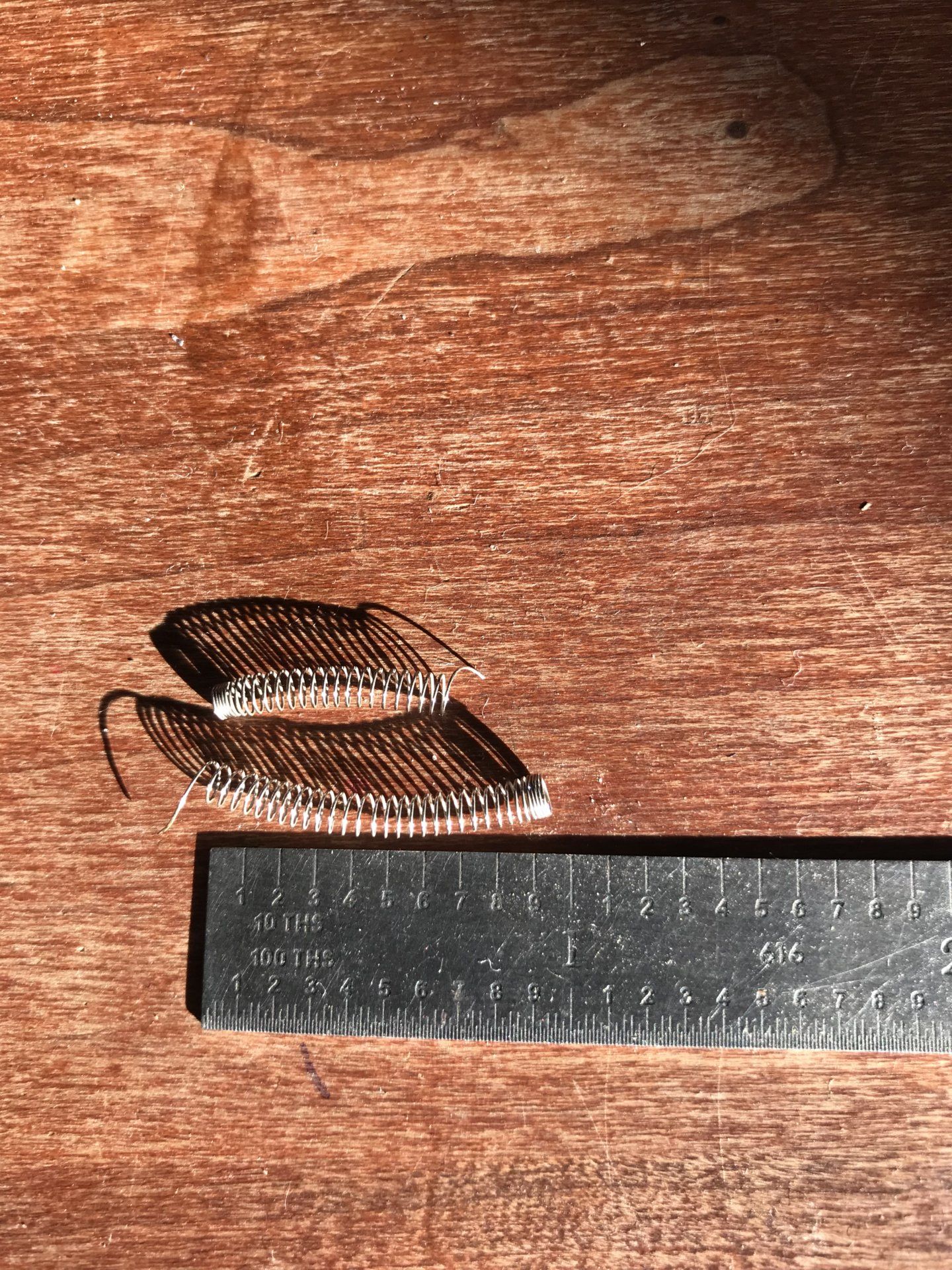

Sheesh, this is long winded, here’s a picture

I pulled that spring out from underneath the leather
Then untwist the ends and trim to length
I’ll give you that that was great quick thinking but it needs to fit around the skinny end of the discharge weight.... does it? Send me your address @evilorgoodtwin and I’ll send you my extra.
Fits perfect. This is before trimming.

Personally, I’d worry that spring is too narrow and long. It’s gonna wobble back and forth and your not gonna get an adequate squirt of fuel. My offer still stands. The extra you see in the picture is a duplicate of the one in my existing carb now and it works.
