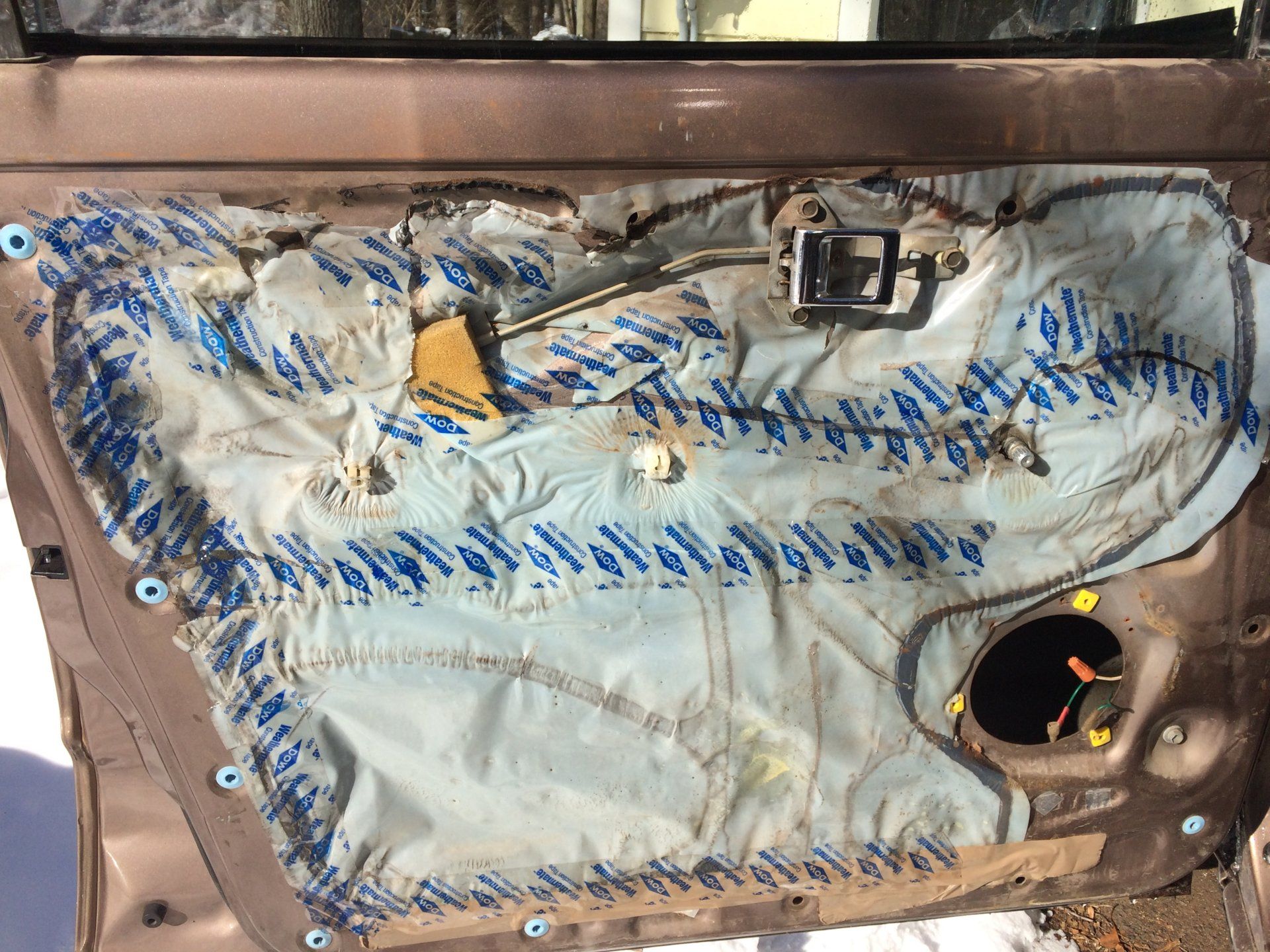

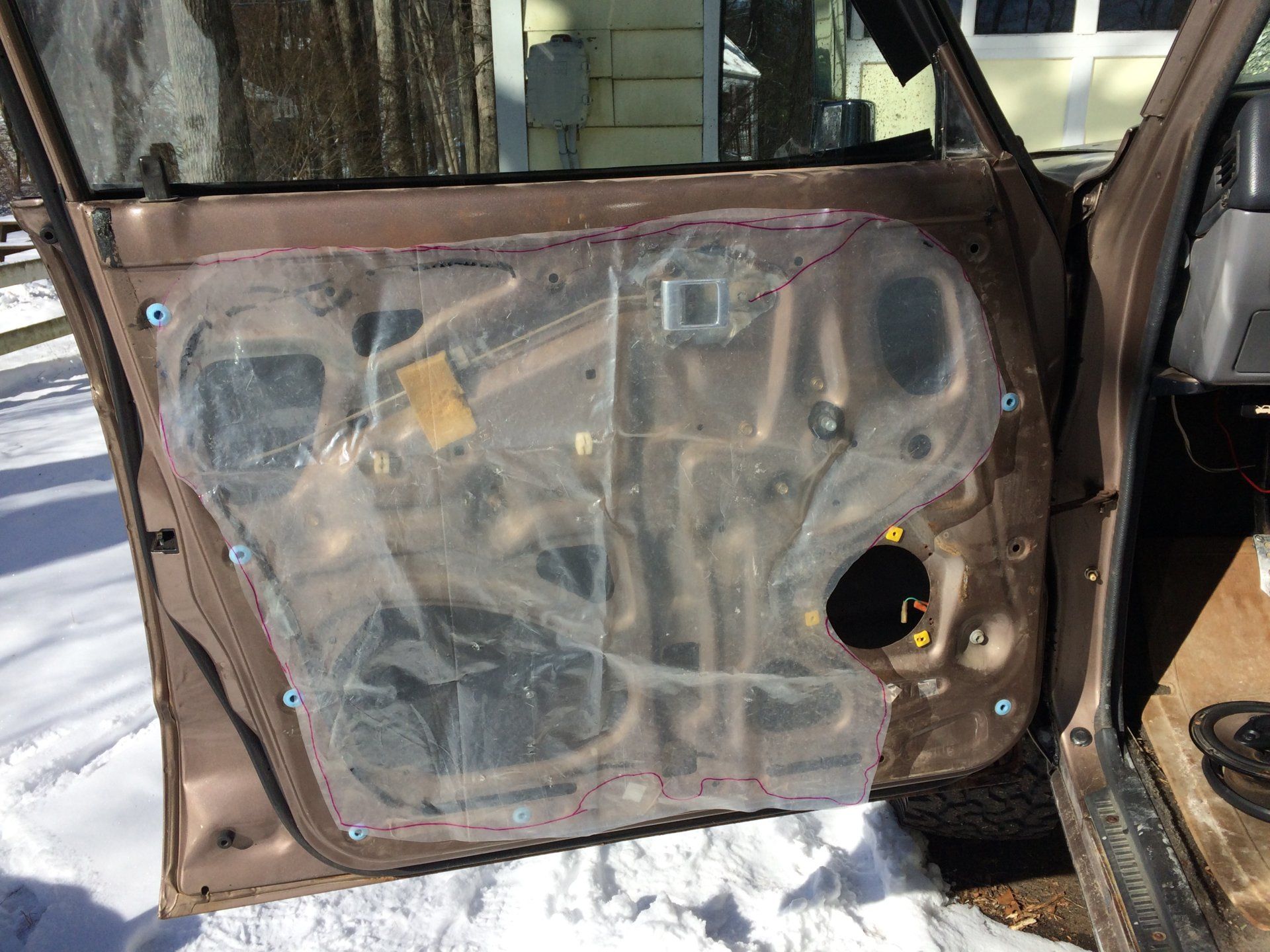

Was able to open up the driver door today to replace the regulator. Clearly someone’s been in there previously.
The rubber felt rain guard at the inner top is in ugly shape. I may either Macgyver it or swap it w/ a rear.

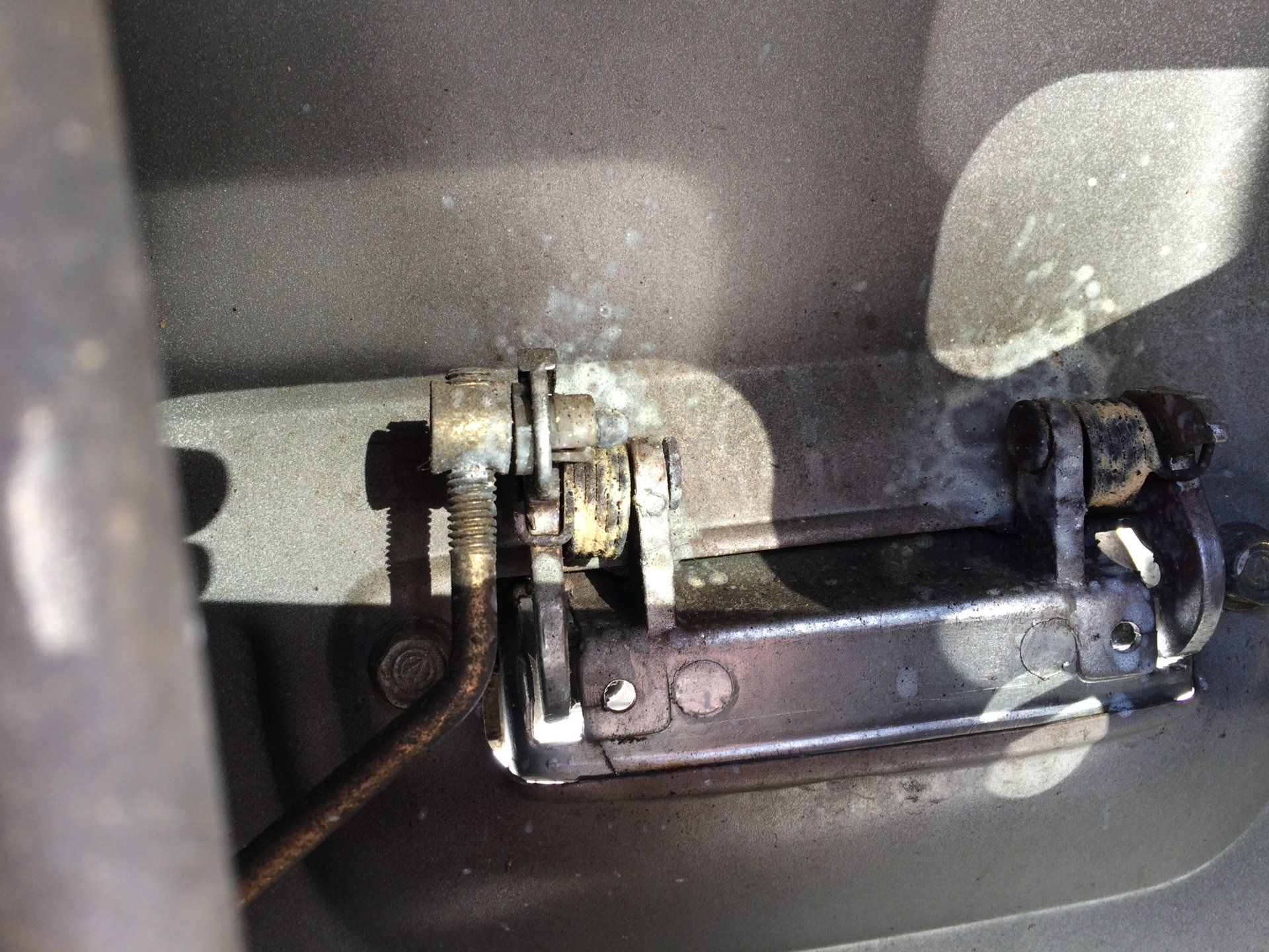

And had to rip out that plastic so I’ll replace it w/ a piece of clear plastic I had in the garage. I pondered using a feed bag for fun but I do prefer being able to see through if I need to get back in. I know this would be a wise time to add some sort of sound barrier but I didn’t think to pick any up. My outer handle springs or whatever their called are coated in something gross too...
Once kiddo naps I’ll get back out there to clean and do the swap.

That's ancient white lithium grease out of a spray can on the handle pivots/springs. Doubt it was factory just someone's attempt to get it working smooth at some point. For me the jury is out on that stuff based on how it gets crusty over time. I don't have a better solution other than taking such things apart, fully cleaning and using a light oil on them. Really no biggie if you only have to do it every 10 or 15 years.

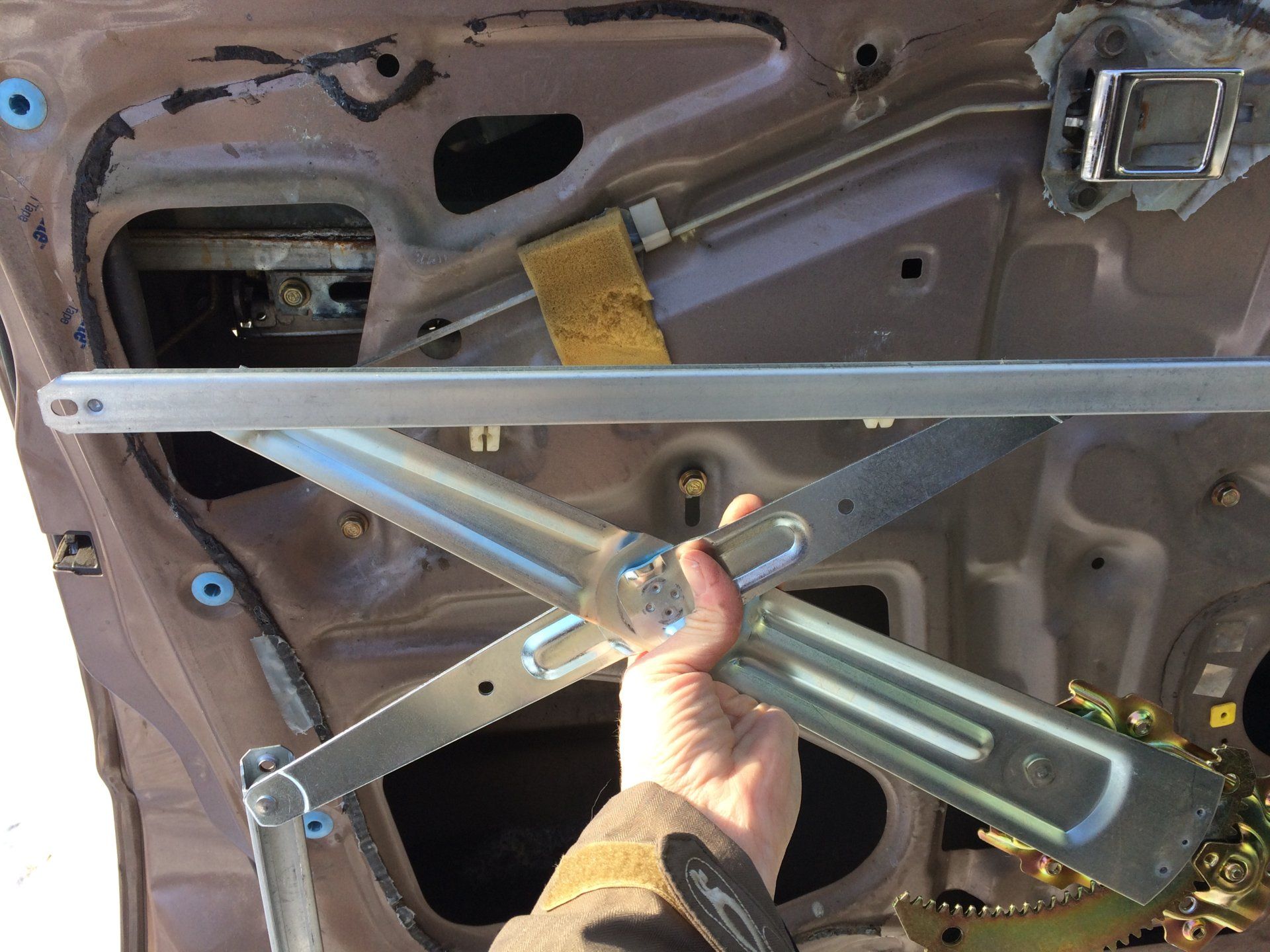

They sent me the wrong regulator.
Piss.
Ignore, I’m having a bad day. It is correct.
Getting a new regulator in 2 of my doors was one of the single best things I’ve done and makes me so happy every time I use them. Too expensive to do all four though. Is Dorian cheaper than the one Onur sells? What’s the right part number?

FYI, 749-820 is drivers side. I’m having a flake day I guess.

One thing noticed when I replaced my driverside regulator, is that the plastic sheeting is slotted back into the door near the bottom, this allows condensation to run out the (hopefully) unclogged drains...
Huh, I’ll examine it more and see about that.

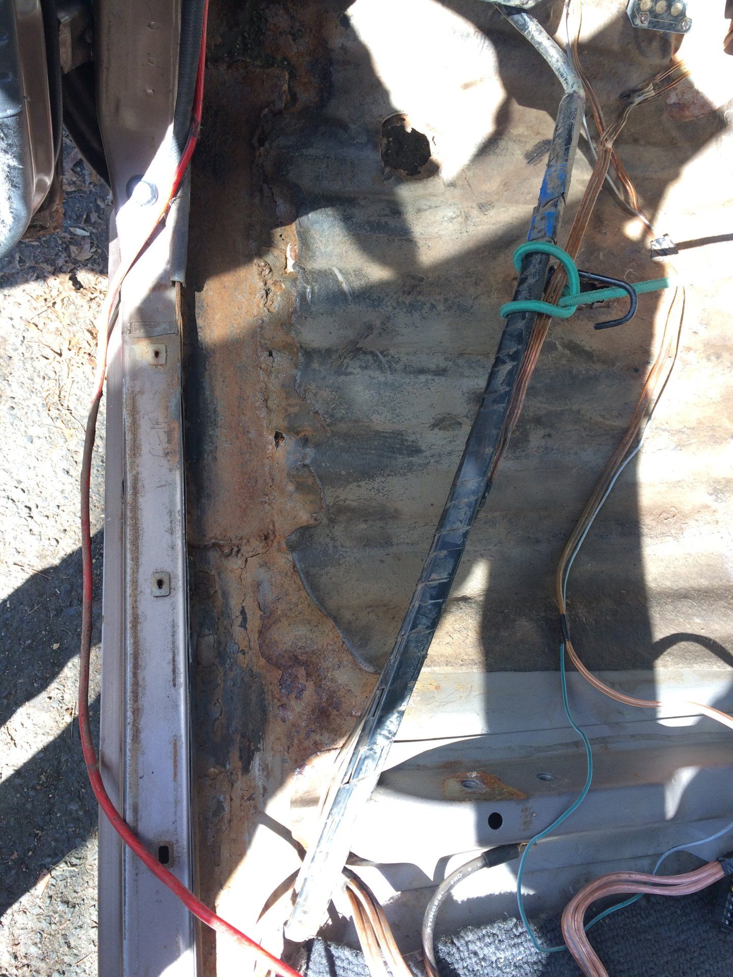

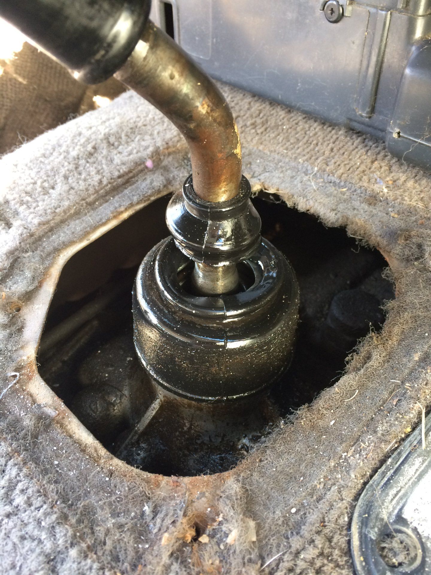

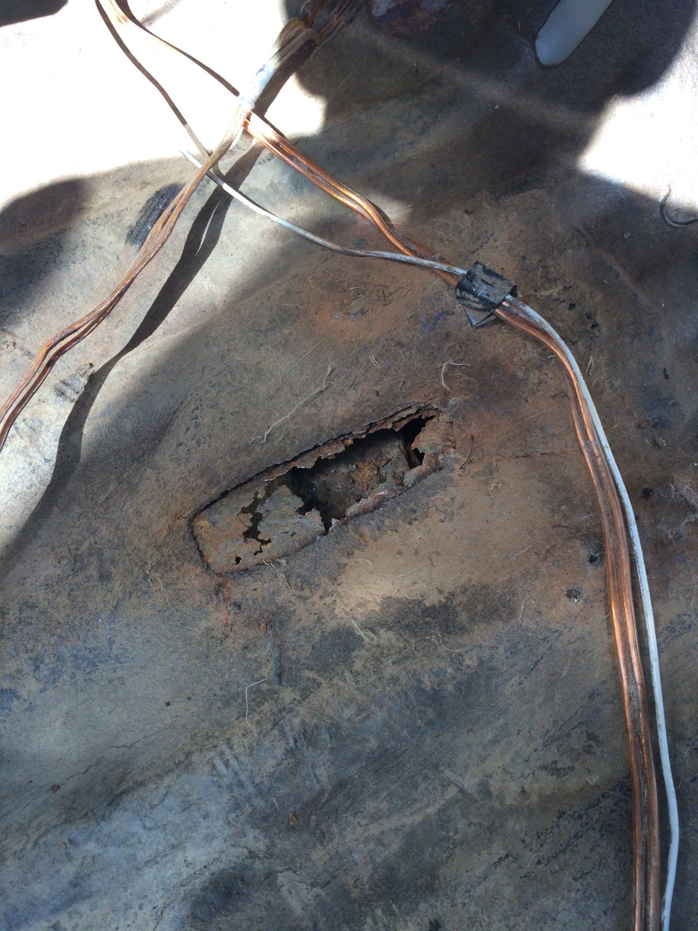

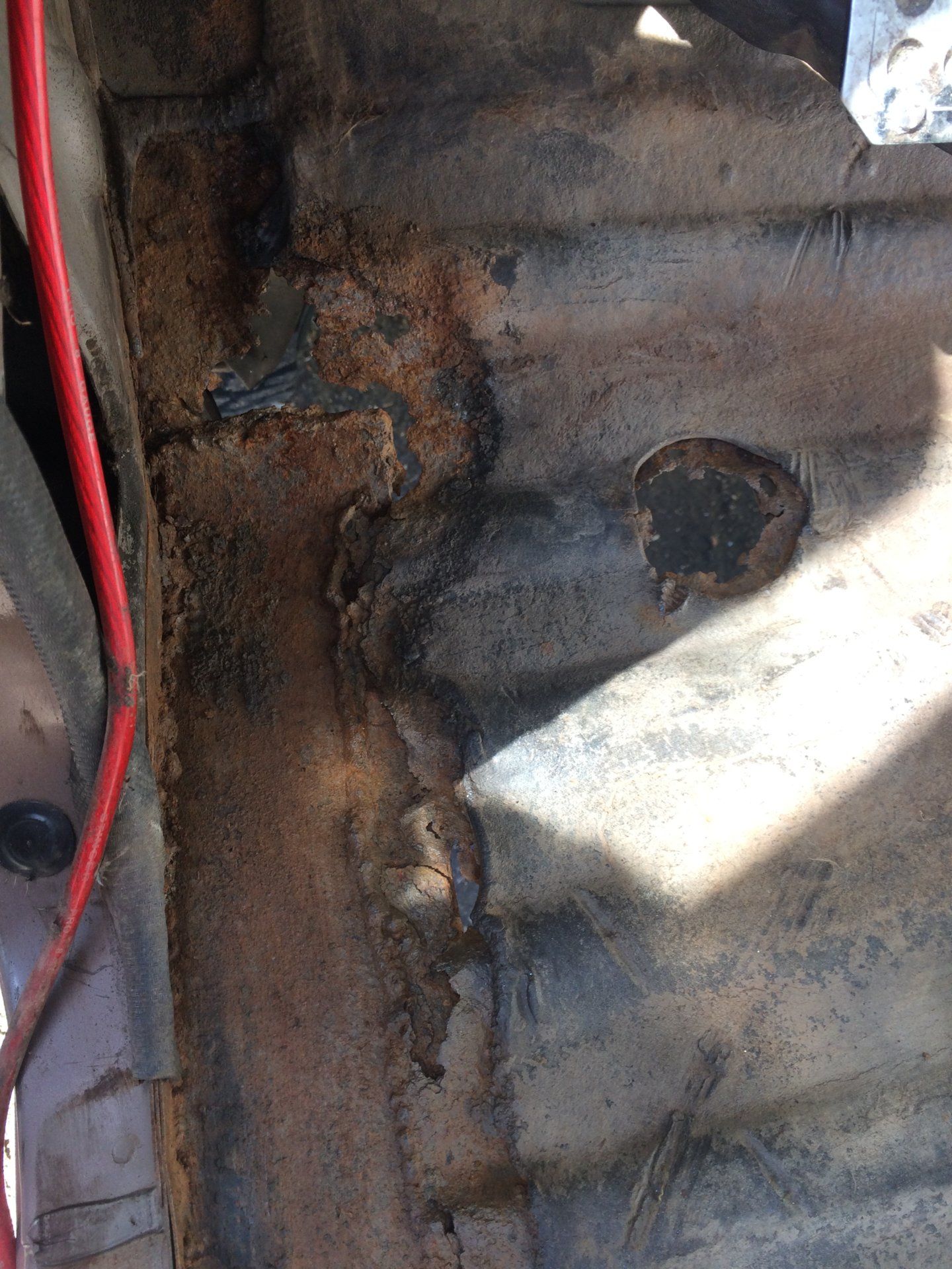

Front carpet is out. Tcase is leaking upward to stick. Stinks nasty. Holes in driver side floor.
One good thing... looks like there’s nothing wrong w/ the rear heater other than it was unplugged.
Yup project oh s*** can of worms has begun.
