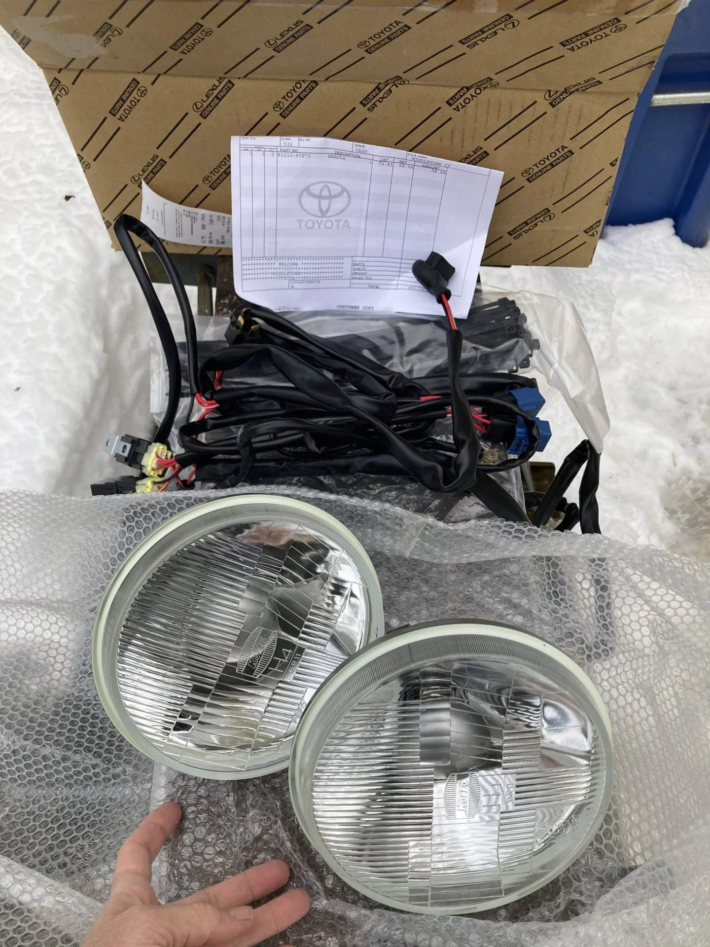

Picked up the H4 kit yesterday. Not sure how fast I’ll get this in… weather pretty nasty the next handful of days. And jumped into an alternator replacement on the taco so hoping to finish that today.
Here’s a photo tho of the kit.
I still have the kit that I bought a few months ago in the basement, also waiting on the weather to improve. It's 3 degrees outside this morning and we got about 8 inches of snow yesterday, with a high today of 20 degrees.

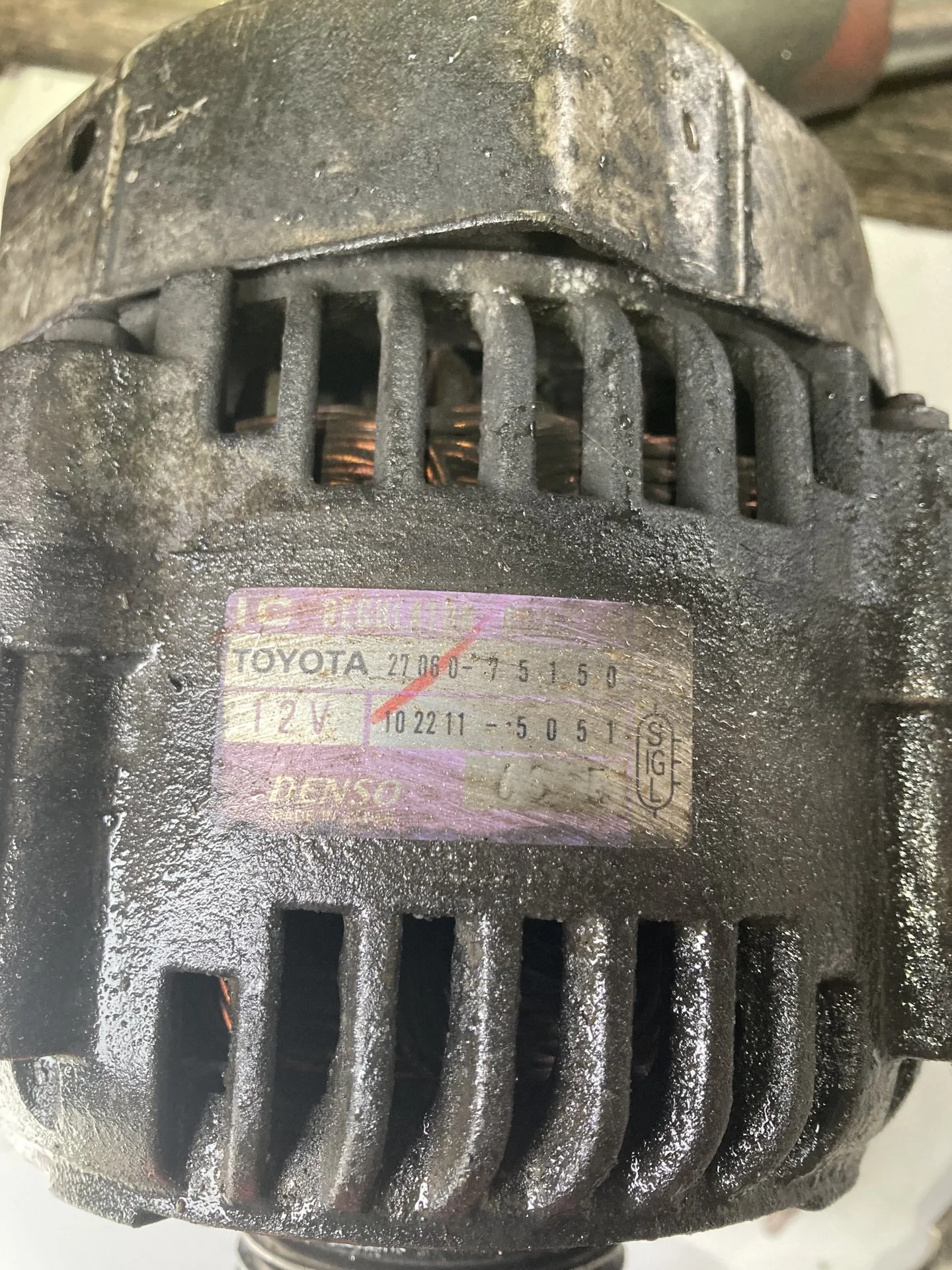

Alt done on taco. Kinda a pain in the ass but impressive to see at 250k this was probably the original in it.

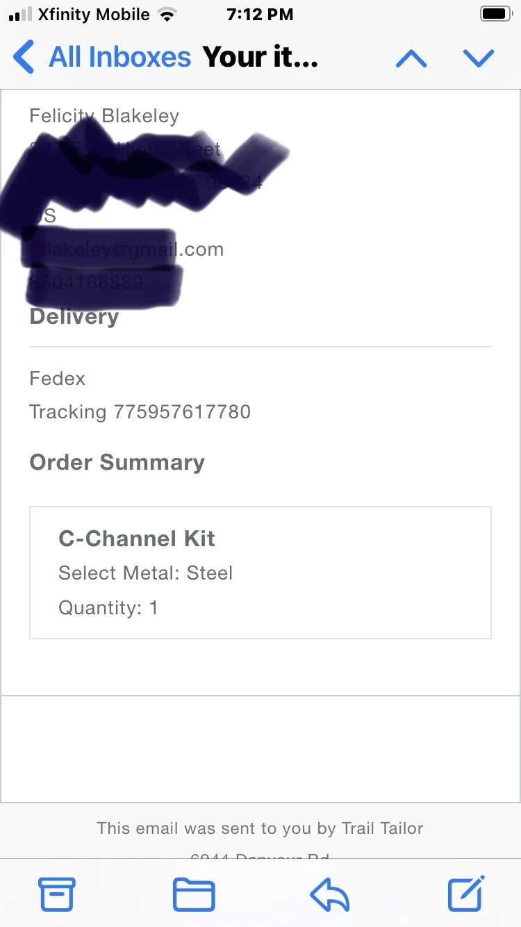

I had a moment of insanity and ordered this last night. It’s already on its way.
Saw Trail Taylor had a kit, is this a different one? How bad were/are yours? Cutting old ones out yourself?
PS, the Koitos are like jewelry, such a nice upgrade.
The c-channels? Yes I do all my own work… are mine bad? Hahahaha! Truck has been in New England since I think about ‘02.
I’m going to order an air chisel. Should be a blast.
I plan to drop the fuel tank at the time seeing as I need to put a new used fuel pickup in I’ve had sitting around from @cruisermatt. Mine leaks if the tank is full. That will make it a bit less awful.

Get a good air chisel, the rivets are a beast
Yeah I’m aware. I pulled two body mounts and rebuilt them when I patched my frame. I got into a good rhythm w/ my angle grinder and dremel but since these will be IN the channel I get I’ll need better access.

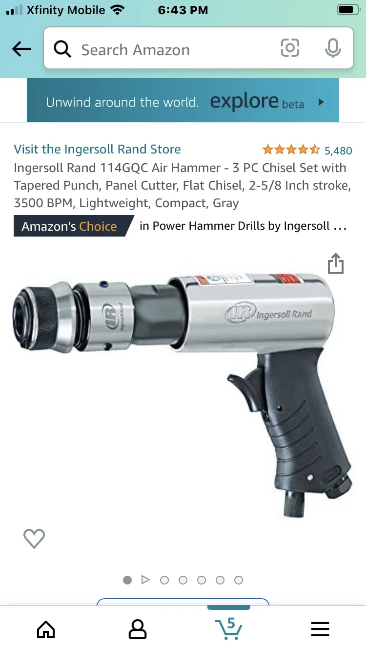

Yeah if there was better access a grinder would do well. The air chisel I bought didn’t have enough ass and just kinda pecked at them, I ended up stepping up to an IR. But still a beating because of the confined work space. But from what I’ve read in your build thread…..you will knock it out, I have zero doubts!! 👍
Any chance this was the one you stepped up to? Me and @POTATO LAUNCHER were discussing it last night.
