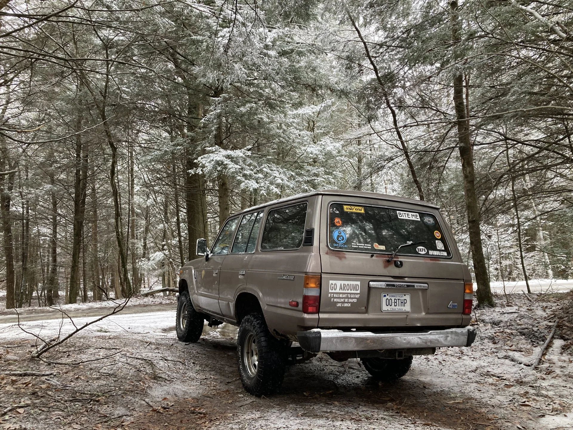

Took the kid out a few days ago on some fresh snow and got into 4L. Kid tried his best to tell me how to drive until I had to tell him to shut-it! Had a guy coming toward me at the top of a narrow dirt road, I braked first which made me loose momentum even tho he’d pulled over… I chose to reverse back down about 30’ letting the engine

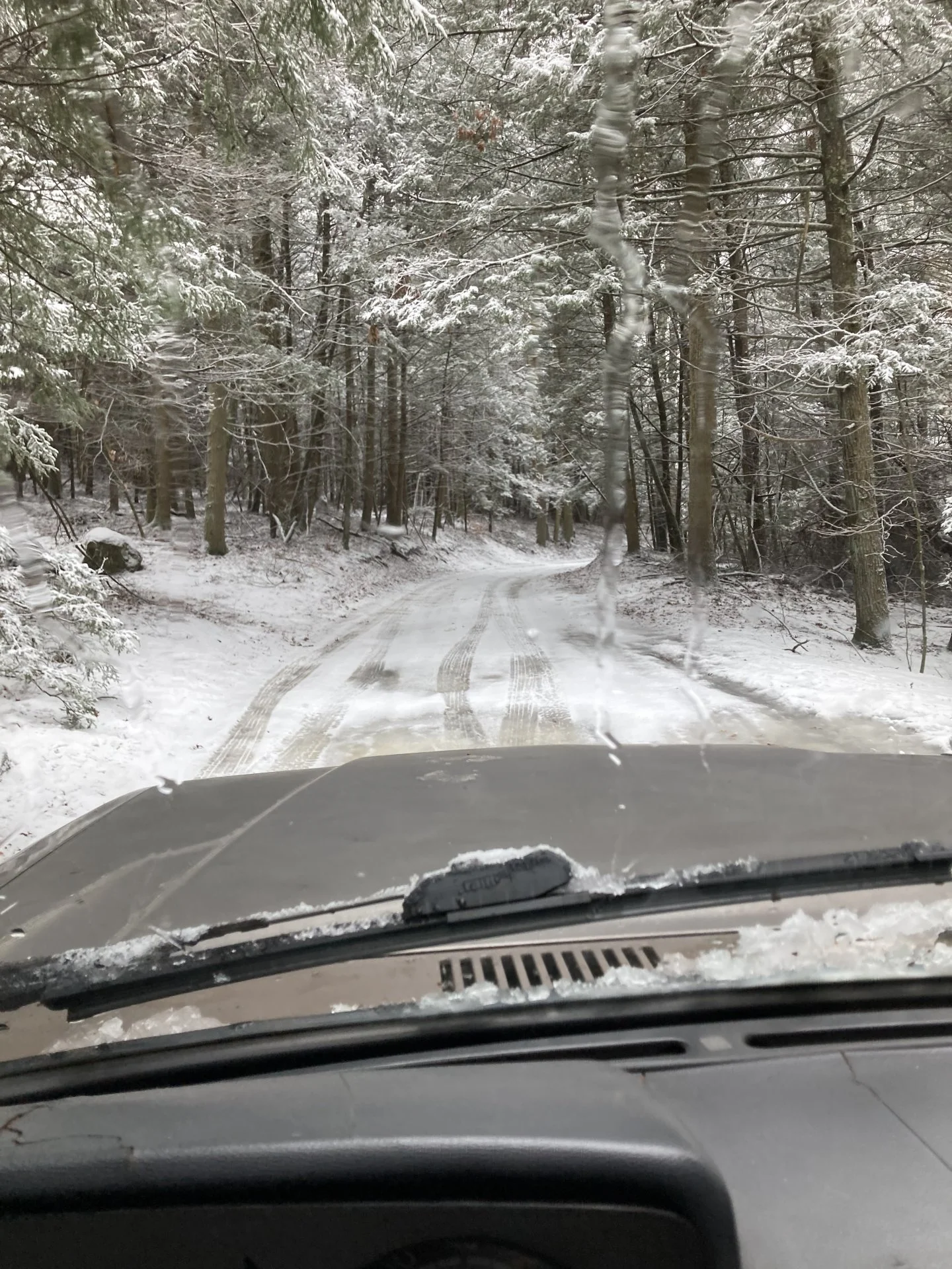

Fun drive into work today. Leaving might be more fun. Verbal correction, when I say 2L I mean H4… dumb girl.

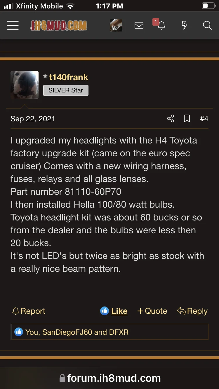

Get the upgraded Koito H4 from the dealership. Comes with a harness cheap and easy. You can put LEDs in later.
If you don't have one of those infrared thermometers yet and you want one, you now have an excuse. That would be the laziest way to diagnose the heater.
Yup just found that too.
