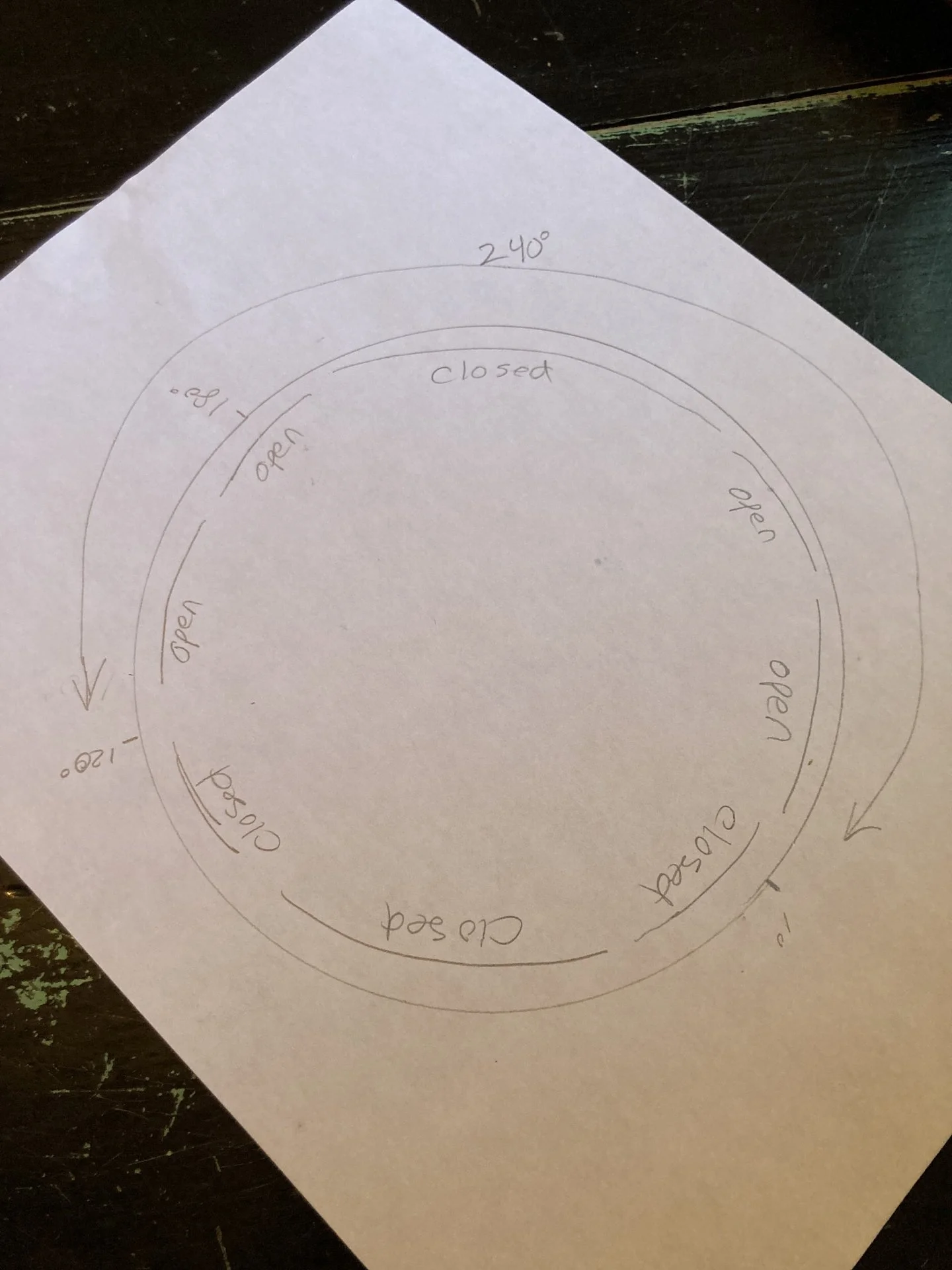

100* driving an non-ac 60 sucks the life right out of you. At least all the windows roll down now.
240 ac isn’t so bad.
I’m super dufus literal… are you saying the 60 is just a big bubble? I did this diagram in front of my kid. 🤣🤣🤣

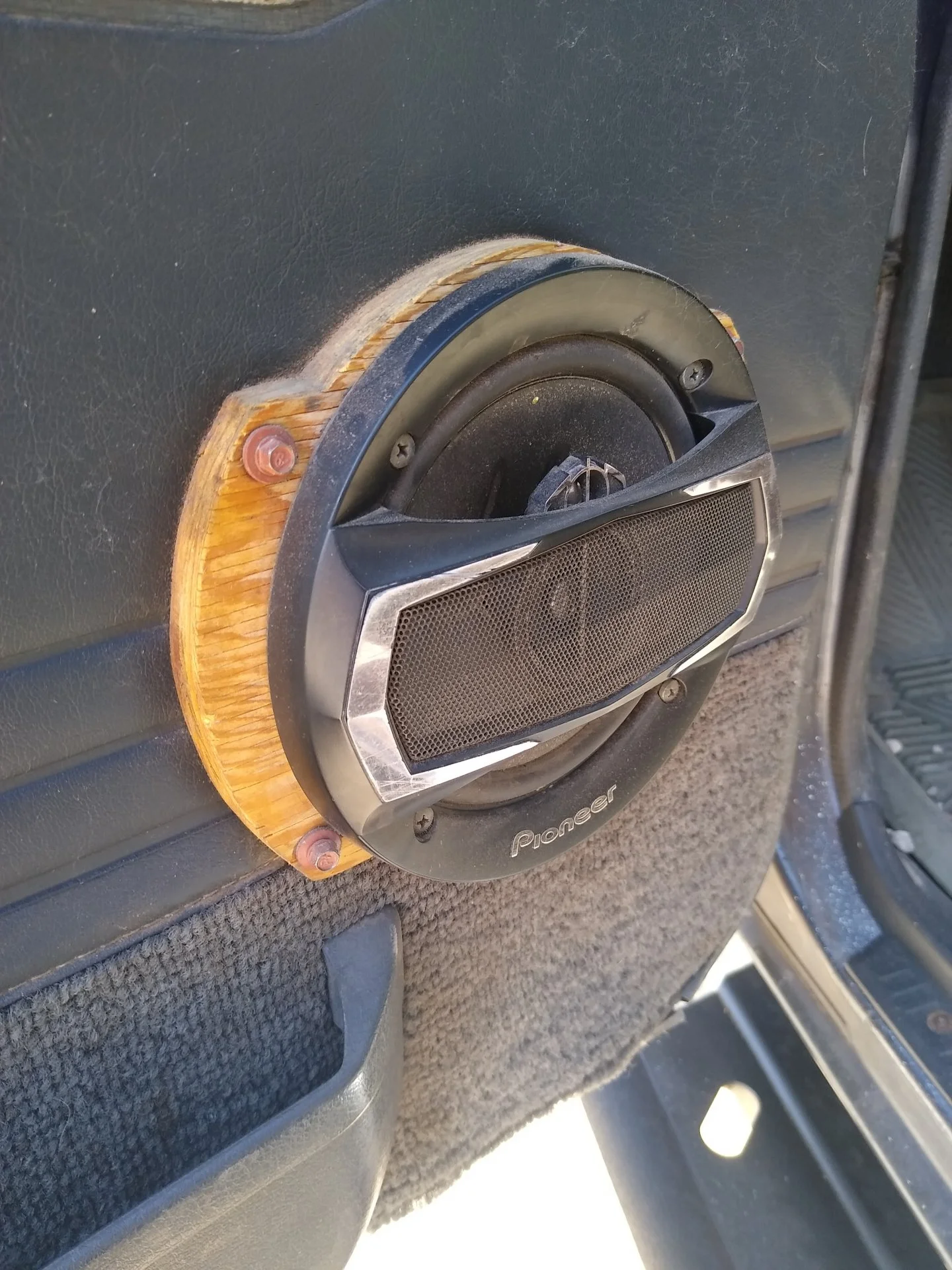

Stock FJ60 front door speaker depth is only 1-1/8".
So you just measure what’s already there or is it the depth accounting in the window when rolled down?
I may have a few used speaker pairs - some Clarions and some stock FJ60. Or are you looking for something newer/better?
I bought these new for my '86 FJ60, not expensive at all - $34.49 a pair:
Amazon product ASIN B00SAY8370
I believe I have these same speakers in mine. Using the 3D printed adapters from @TheNeek which spaces them out a bit to help clear the window regulator and whatnot in there. Works great for me and everything clears. HTH
I used some shallow depth JBLs from Crutchfield with The Neek's adapters and they just clear in the front. Had to bend the speaker terminal tabs to get the wiring to clear the window path. The ones I got were about $50 as I recall but you could get cheaper ones.
