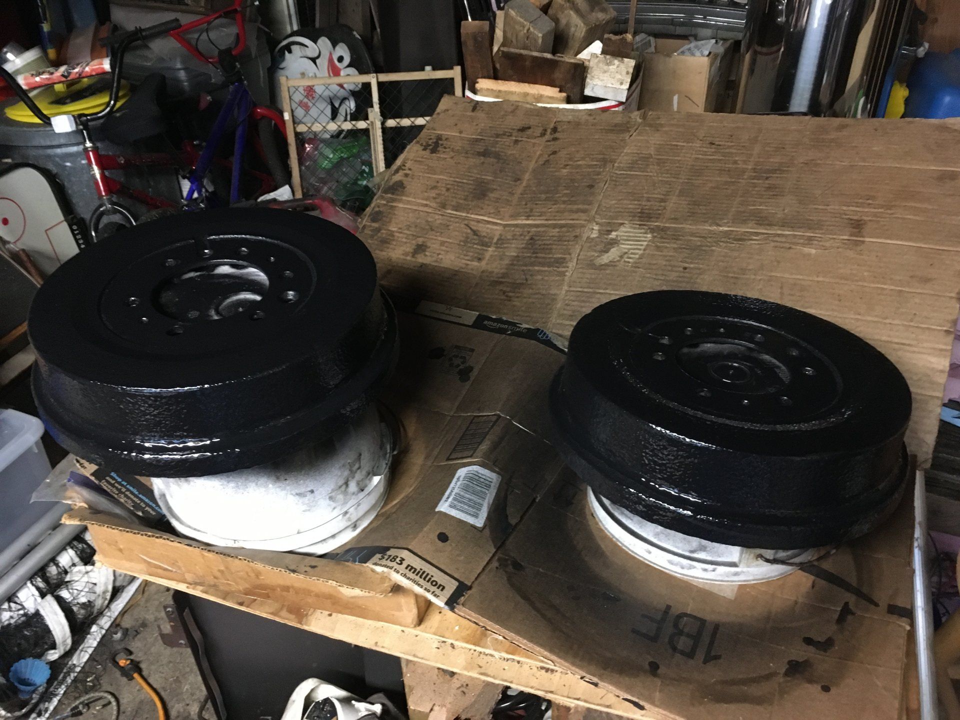

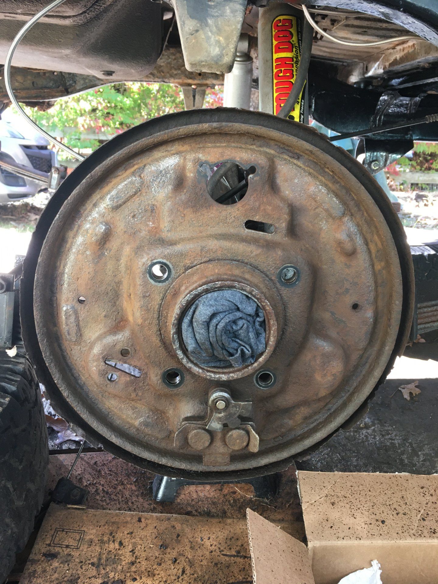

Nice to come home to the axle rebuild kit. I’ve really come to prefer my hobbies over my fairly well paid profession even w/o hazard pay.

That's my GO-TO as well (KC)! Thanks for all you do on the front lines......The rear rebuild is a walk in the park compared to all that you have done so far! Enjoy it. I did mine a few months ago and Cruiser Outfitters is the BEST!

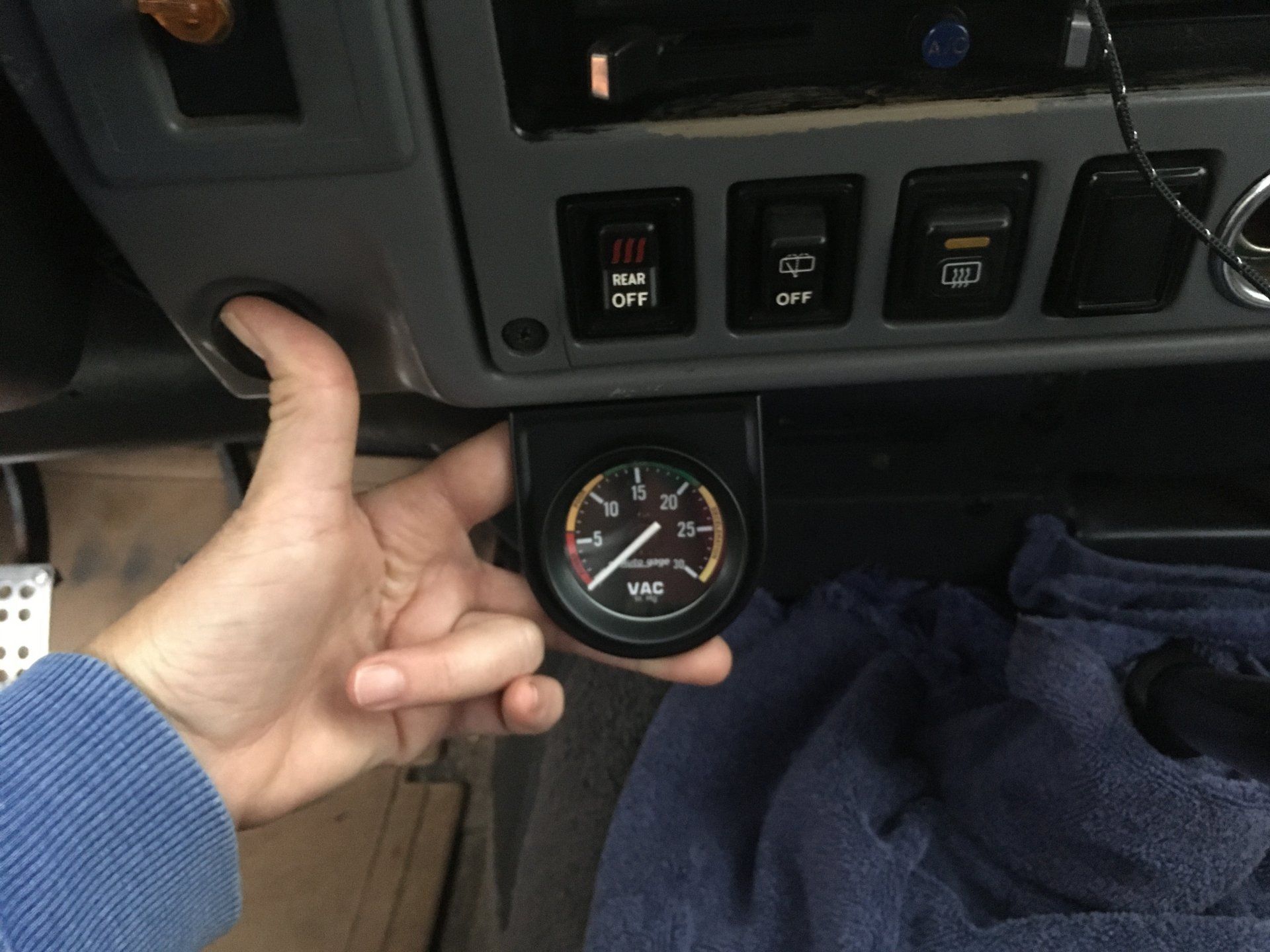

Okay... Tech help needed, I ordered the Steiger in-line upper rad hose sensor adapter... Its 3/8npt and I am thinking our coolant sensor must be 1/8npt as it jiggles in the housing. No big deal I can get, have to anyhow, the right size sensor for the adapter. But when it comes to the gauge, I'd like it to match the vac one I plan to install as well. Pic shown. Autometer, very basic, black round face with white writing. I found this one, which is the same brand and matches nicely, will it work? Has the sensor and even lists the npt I need. Can't quite tell if its saying it includes the inline metal hose adapter like what I already have in hand? Forgive my girly confusion. Also, just to stop any suggestions, I don't like digital face gauges.
That will work fine.
On website:
  • Gauge kit includes 1/8” NPT temperature sender, 3/8” and 1/2" NPT adapters, bulb and socket assembly, mounting hardware, and detailed instructions for installation
Perfect, all set and ordered. Thank you! Back to the rear end!
