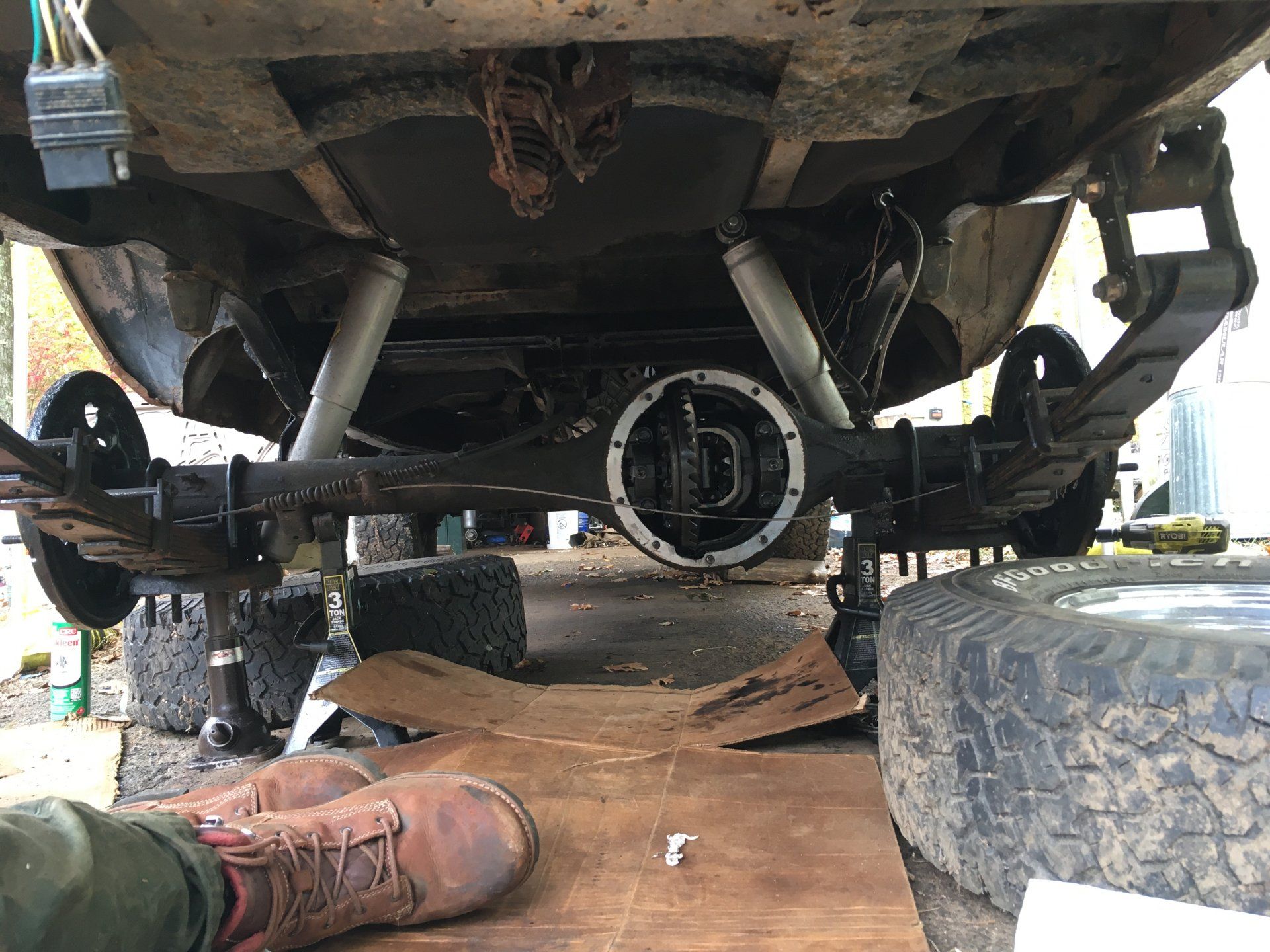

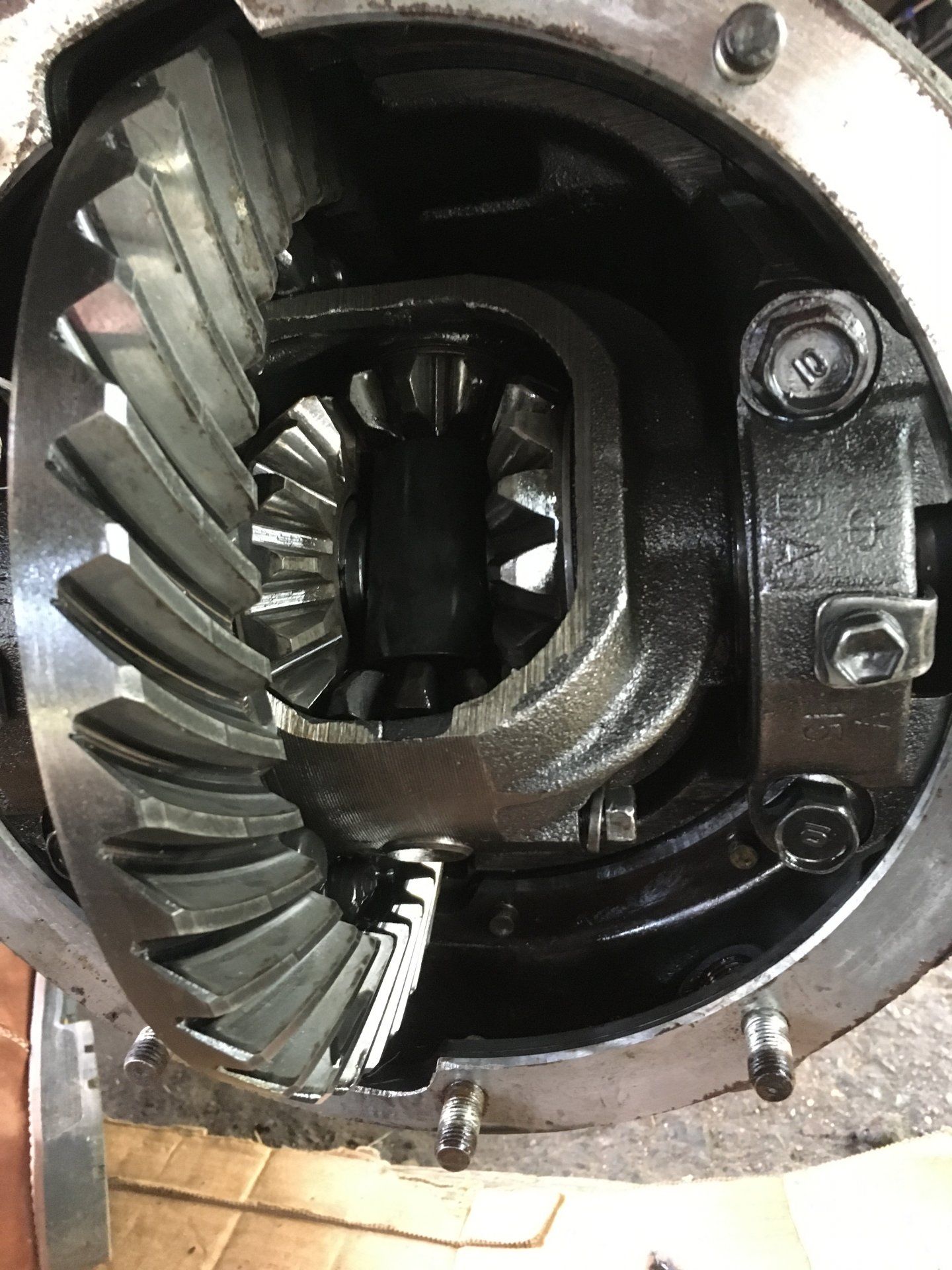

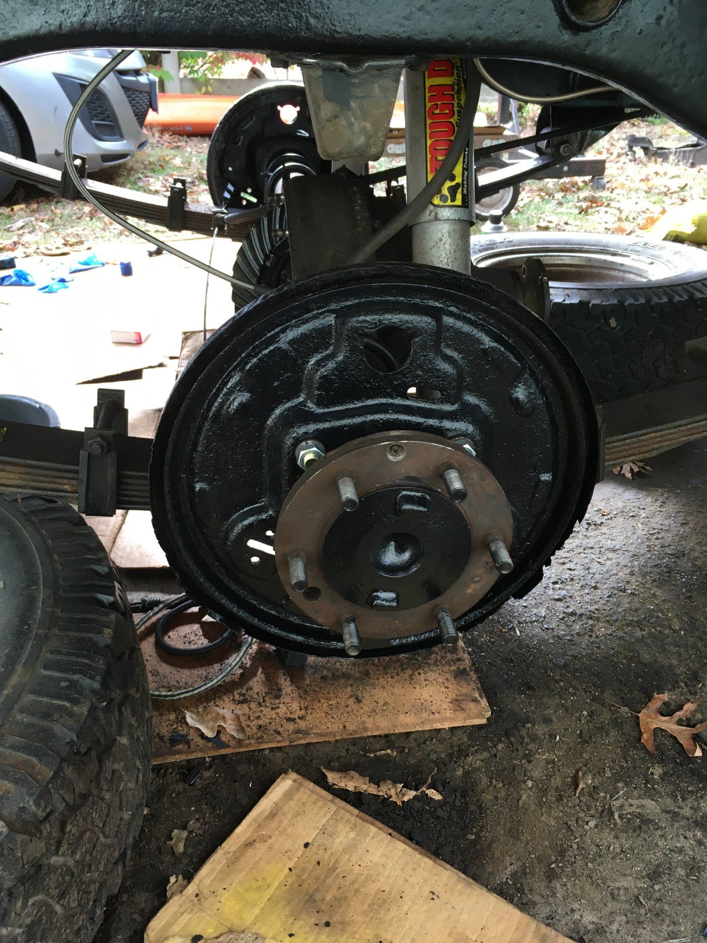

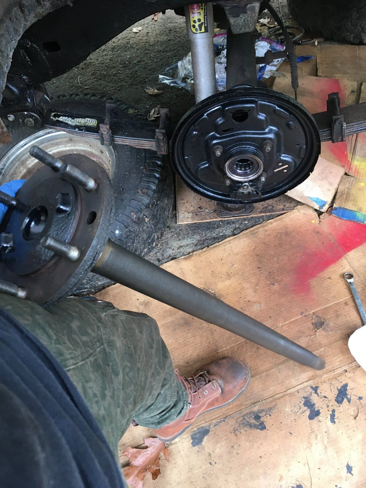

Axles back in. Kid helped on the long side. Then he had fun checking out the diff and it’s gears. Short side was easy to wrap my arm around and seat it on my own. Spinning the spider gears in was “fun” but I got them.

Honestly tho, I realized I had too. It was a matter of leaning them up then the tipping the ring gear down and then there was room to feed in the smaller ones plus the shims. It was fun and I’m glad I can now officially say I’ve done it.
