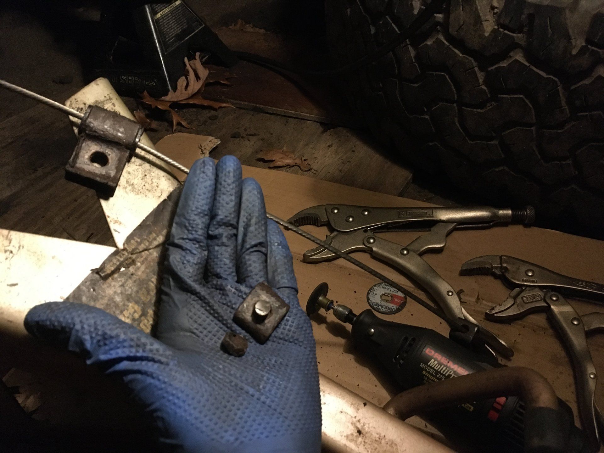

New bracket arrived and got it welded on the cover. Cut the head off the bolt fully corroded to the remaining e brake cable bracket and was able to knock it out. Dremel cutting disc and grinding discs still a favorite go. Working under truck so I used the jack stand hold the bracket w/ a pair of vice grips. Bracket will wire brush up nicely.
Gave in and ordered one new bellcrank pivot thingy, pin and clip for driver side. Spent too much time trying to heat, drill and extract the remaining shaft than I want to care to admit.

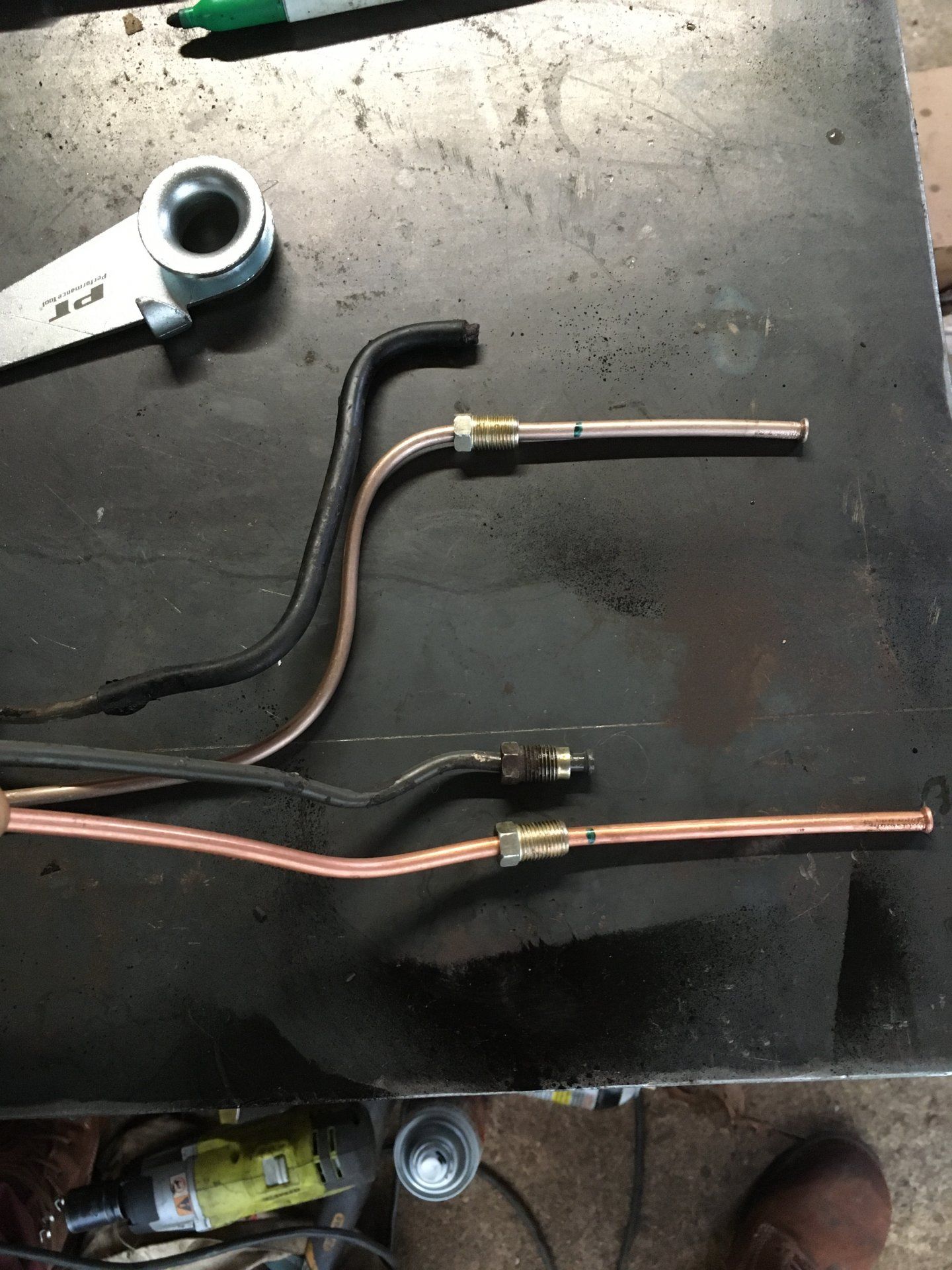

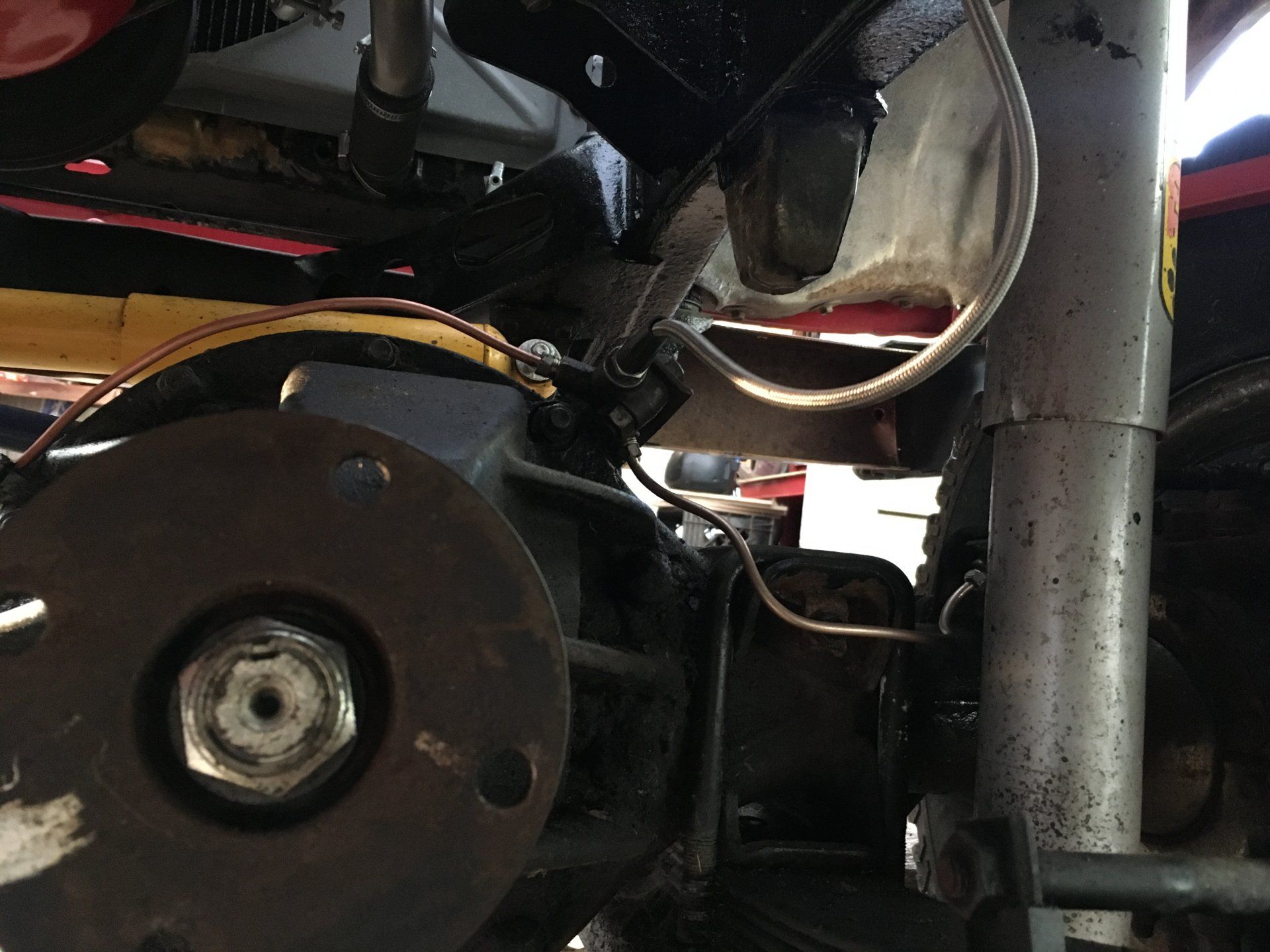

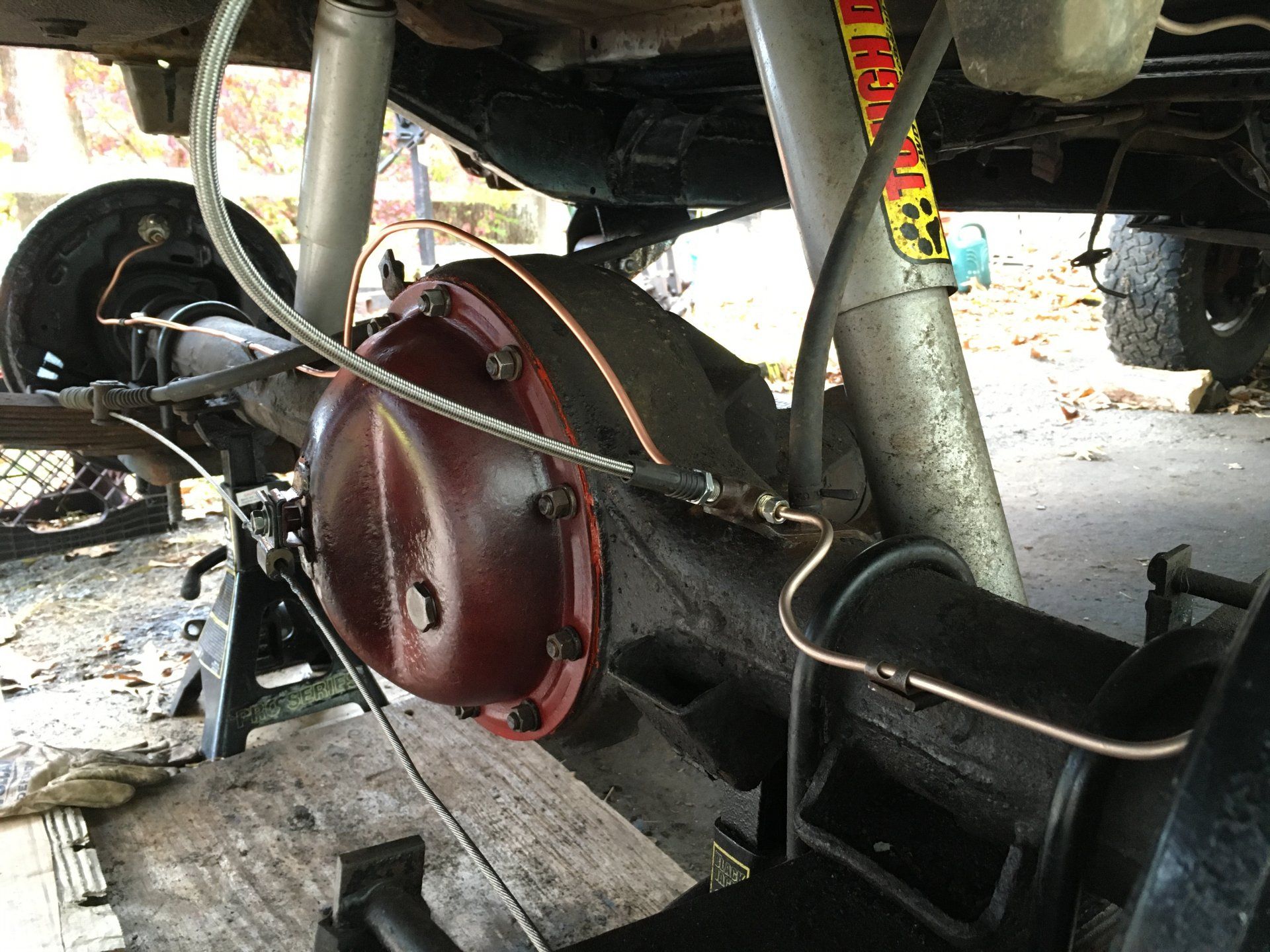

Okay so bracket sides off e-brake cable, cleaned and painted diff cover fresh paint. Brake lines a few inches longer than I meant. My string measuring method works and allows me room to improve.
I wouldn’t cut And re-flare those ni-cop lines for the sake of taking 2-3 inches off. Just add a few more bends and use the length up.
Oh well, already done.
Why not? It comes in a roll and you have to flare the ends. It's very easy to work with and makes excellent brake lines.
I sacrificed two captured nuts on the axle brake line brackets. Two bolts had sheared and neither were on my happy list for extraction. Will use bolts, lock washer and nuts to hold the line to them. I’m done w/ being fussy.
Oy... front axle section of brake line. I have come to decided some copper/nickel line is harder than others. And even your tool is cheap, it’s all in the prep. Mine does tend to lean to the right. I’ve watched it enough now and better able to compensate for it.
