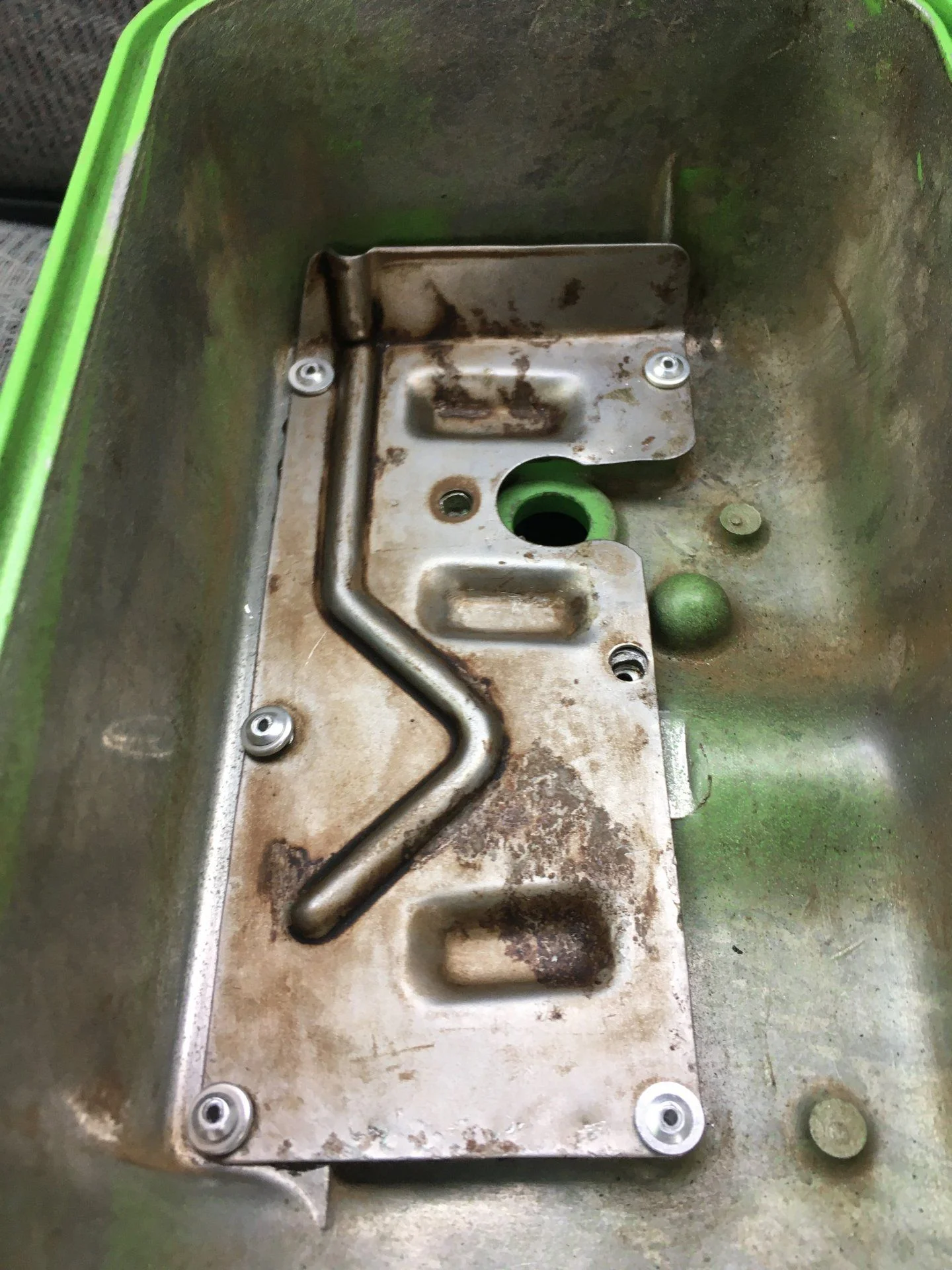

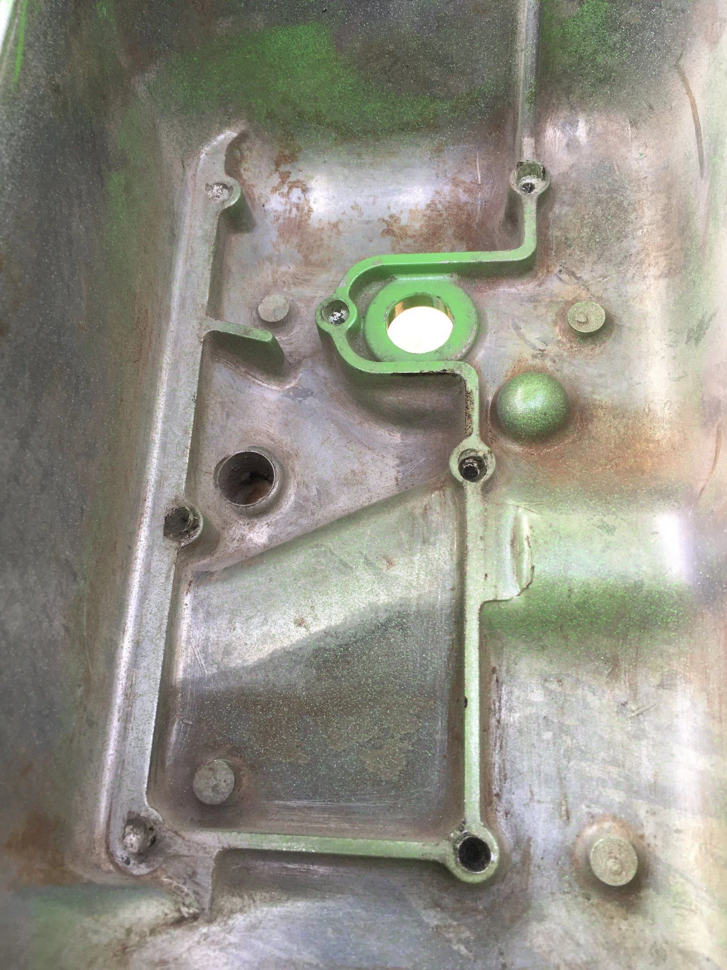

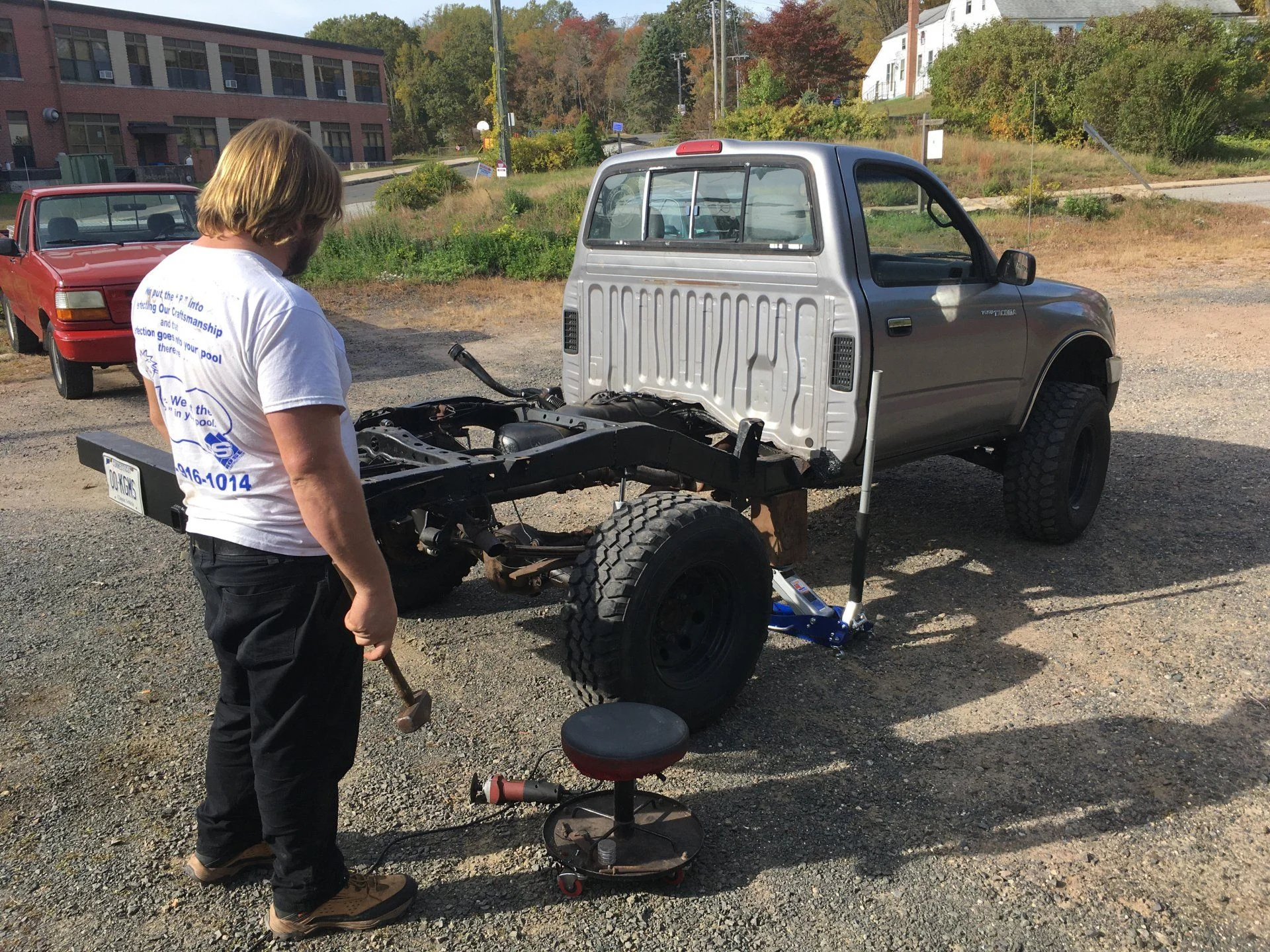

Valve cover baffle back at home. Riveting tool thanks to my powder coater Rob (and kayak buddy). Robs rat rod he’s building behind me. His sons friend Tim fussing over his crooked Taco bumper to frame rail job they did ages ago.
And my valve cover baffle back in place after some drilling by me and riveting assisted by Rob. Fun tool. The gasket that was in there I omitted and simply added a bead of non hardening sealer in its place.

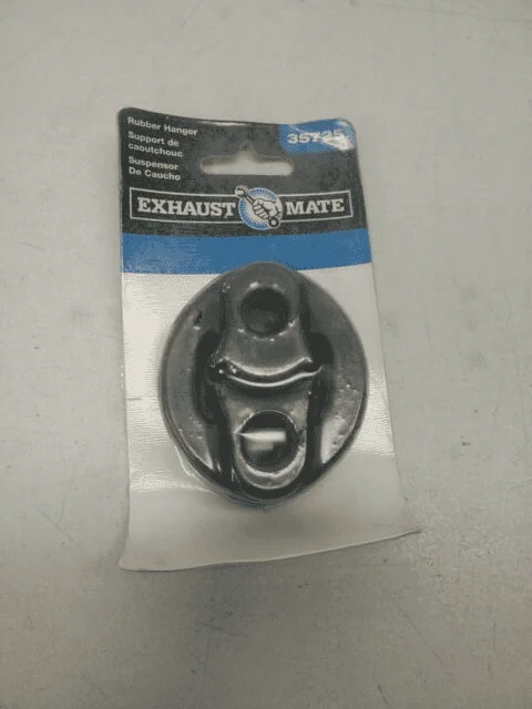

Hey so I need to either buy or fab some new exhaust hangers. First and second bracket still there. Third is gone. Actual hangers that held my pipe were the cheap aftermarket stuff. Go w/ cheap for now? I do have some of those on hahd
I may have something laying around got a picture of what you need.
Dark and cold out there now and in pjs w/ TV on... typical multitasking evening. I can find the pics of the stock ones online.
