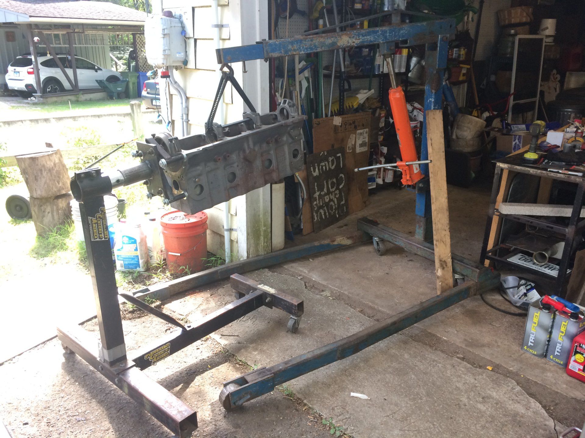

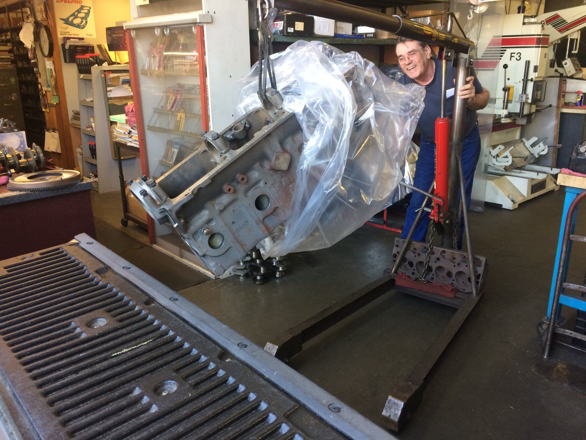

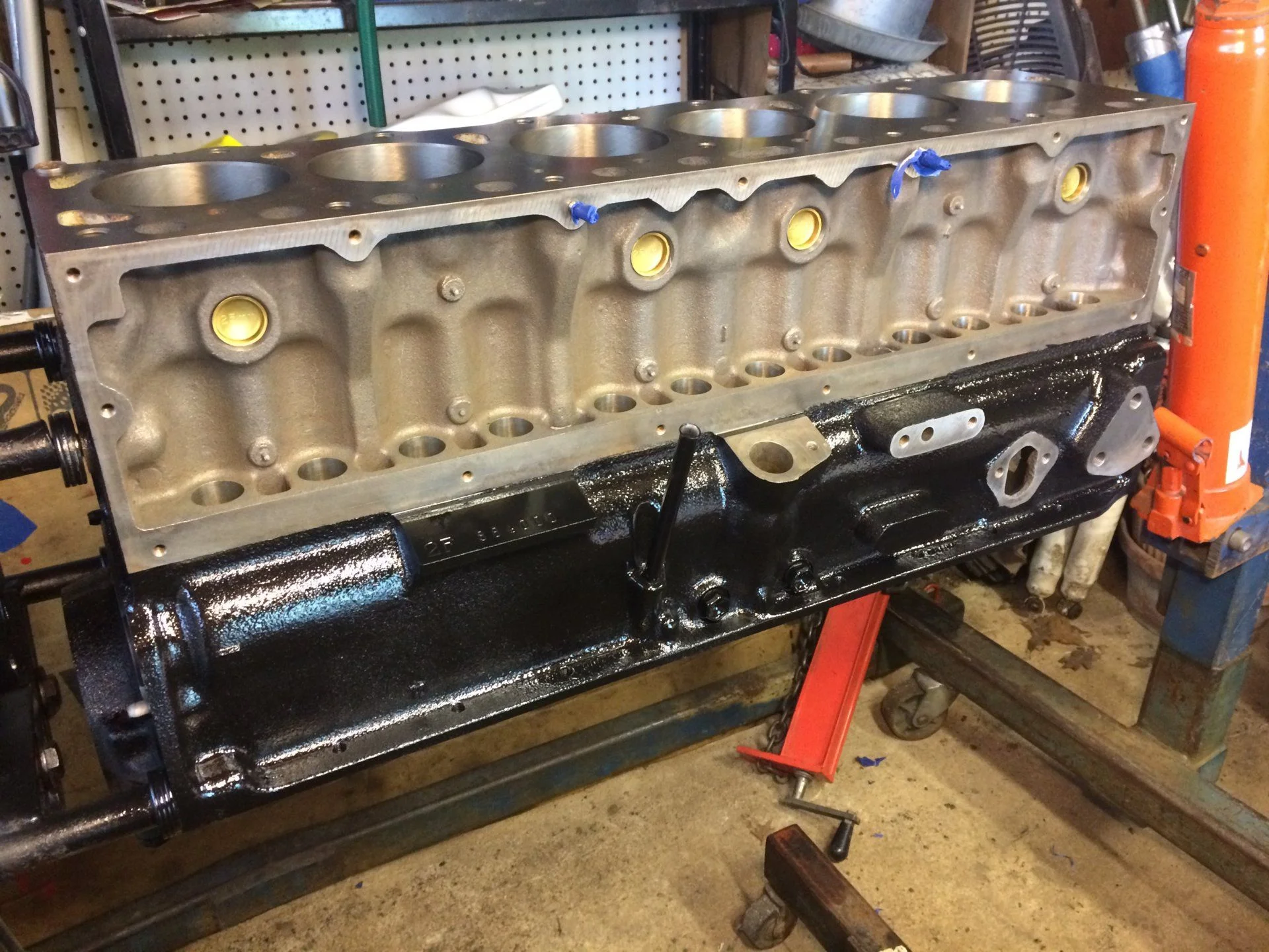

Zee block, crank, etc are home. 15’ or so me alone moved it on the hoist to the stand into the garage. Lots of going slow, shifting sections of plywood and using a 2x4 as a lever to pull backward over my lumpy driveway pavement. It only took me from about 1:40 to 3:07... ha! not bad for a skinny CT chick.

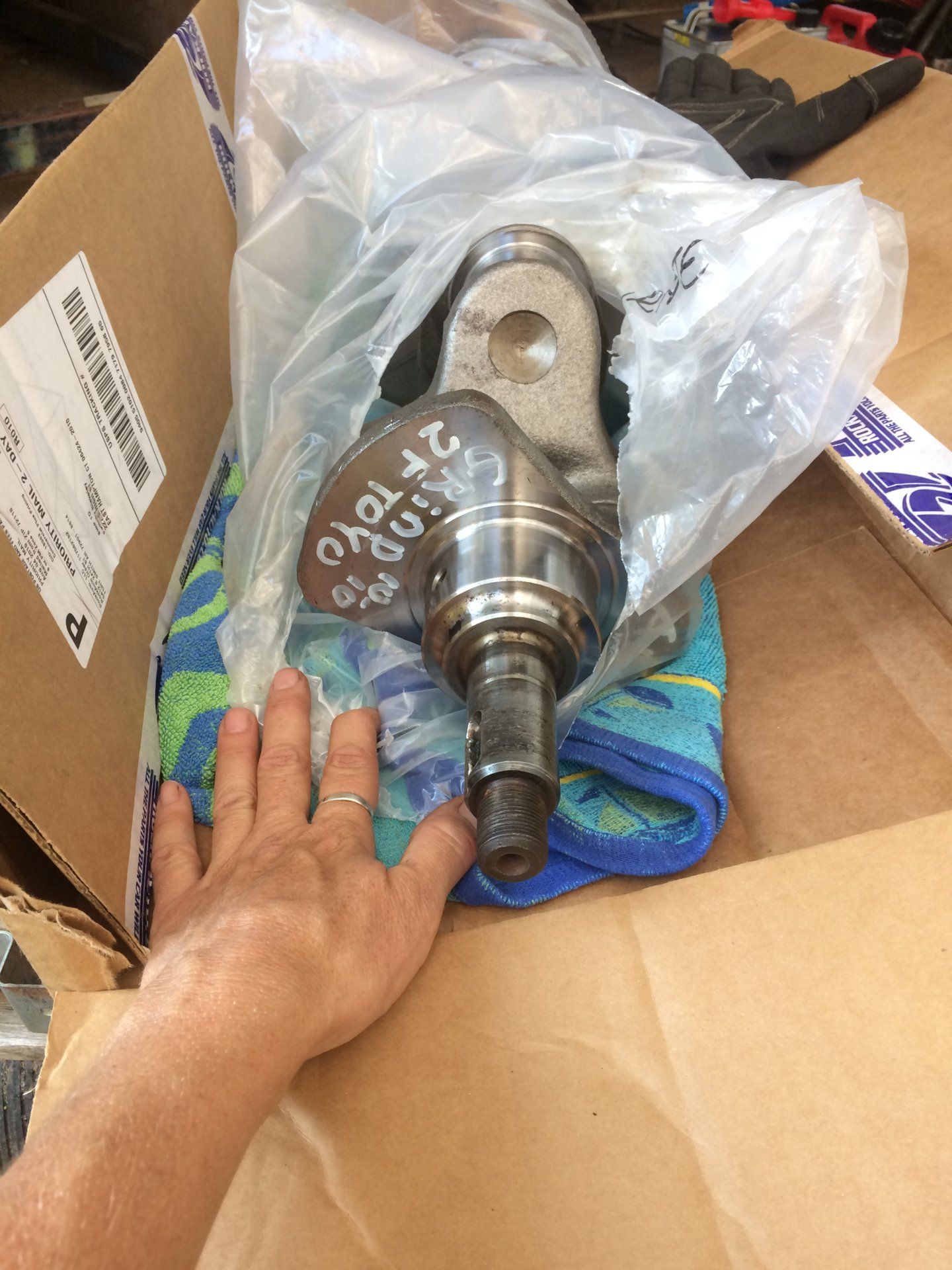

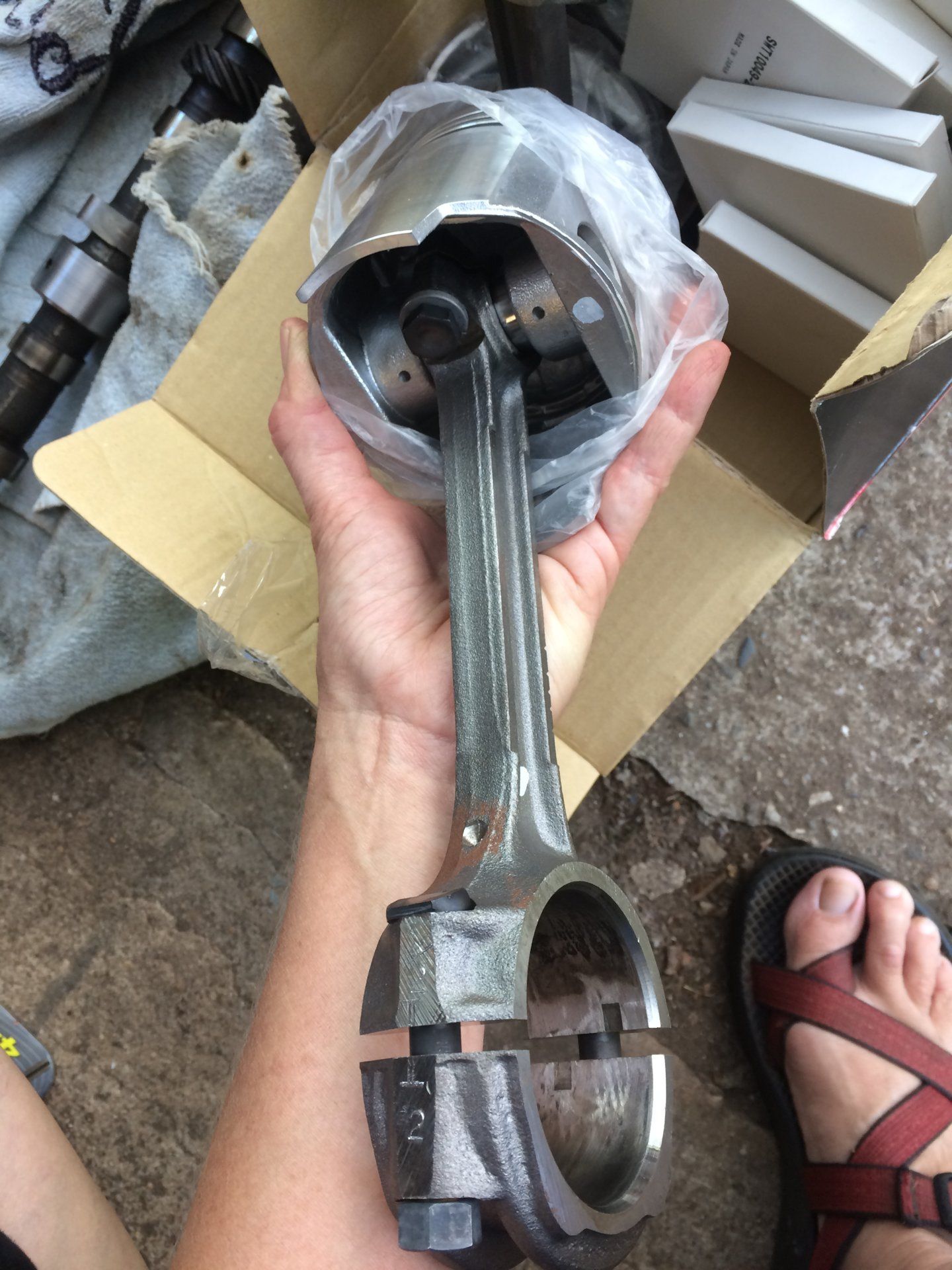

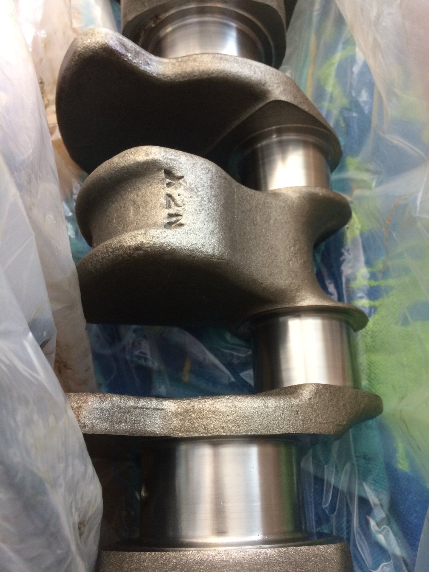

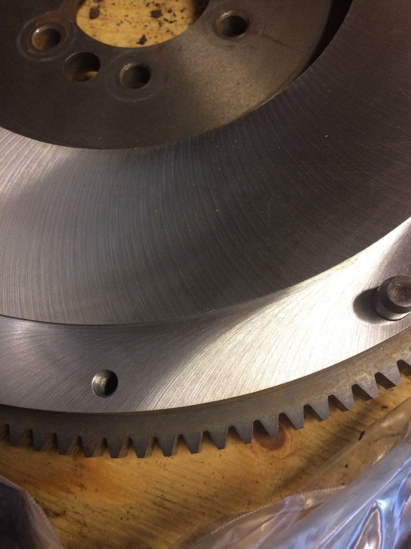

Stock rods, new wrist pins, oversized ITM piston and ring set, resurfaced flywheel, ground and polished crank undersized .25mm.

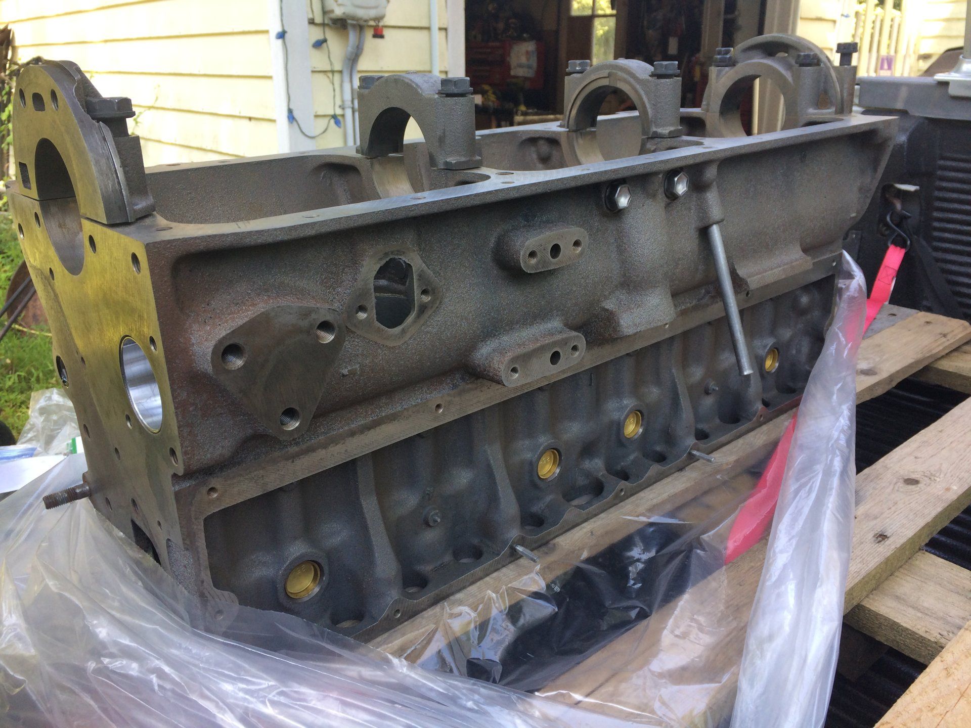

Regarding oiling the block, would a spray can of WD40 be good enough? I’d prefer spraying to wiping. Does it really matter?

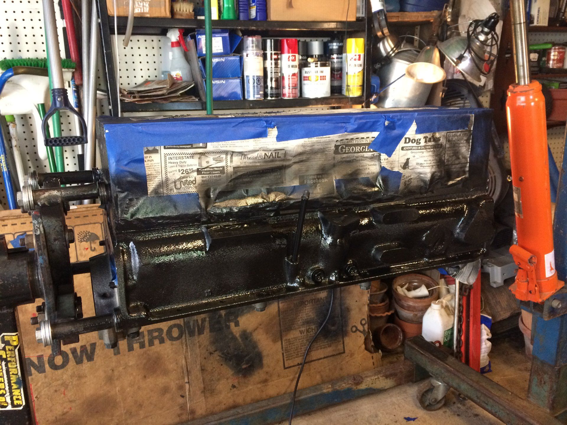

Personally I would mask off and paint the block like right now. Then just wipe motor oil on the bores, cam bearings and bearing journals. Oil the piston assembles and crank. You don't want to oil before painting IMHO.

I’ll get it done before the weekend is done but going into my ‘work week’ right now. Thank you for the advice, I figured as much to not oil then paint. For now it’s greasy and bagged in plastic in the garage. Thank you!

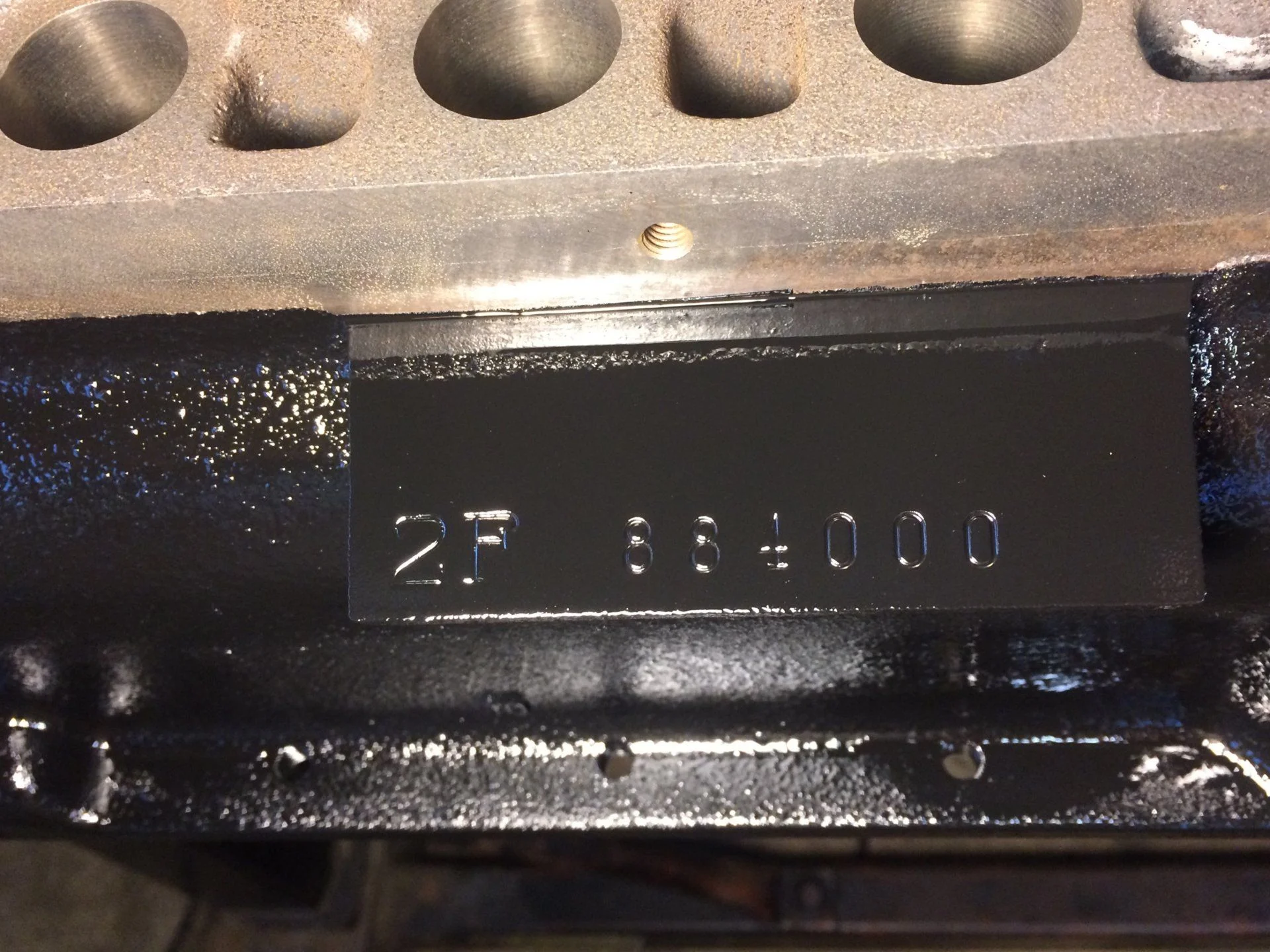

Taped and painted earlier. Came home to it dry and added another coat over the 3/4 light ones. Pulled the tape, paper and cloth I’d added in the 50mm freeze plug holes. Looks awesome. Added the plastic bag and getting dinner ready.

2F 884000

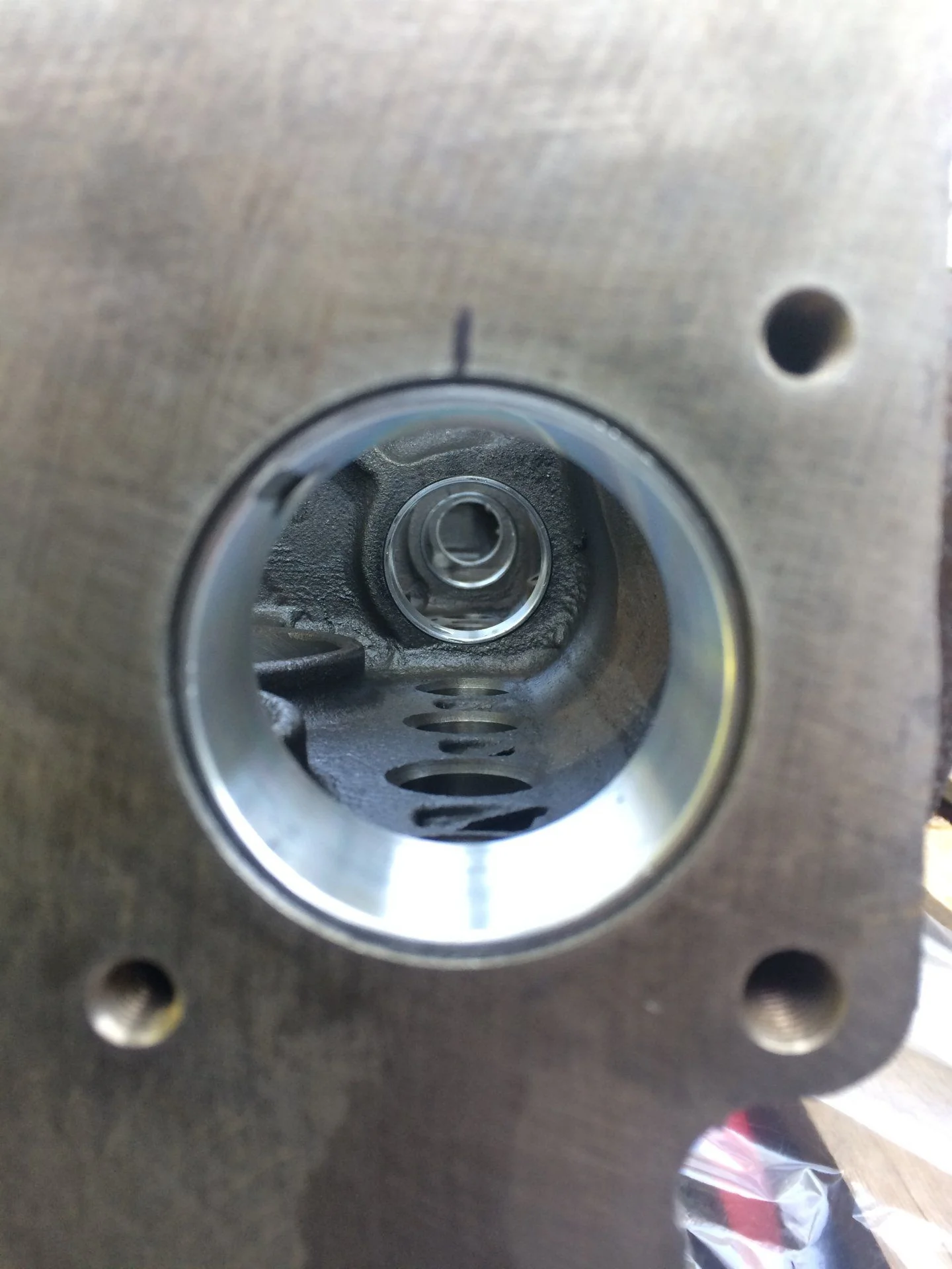

@Onur anychance you can tell me, the freeze plug for the rear of the cam? Off assembly 8/86, ‘87 FJ60. Seems the shop might have inadvertently tossed mine. I did find it listed as 90331-48010, and available still. Can you tell me if that’s correct? Please and thank you!
