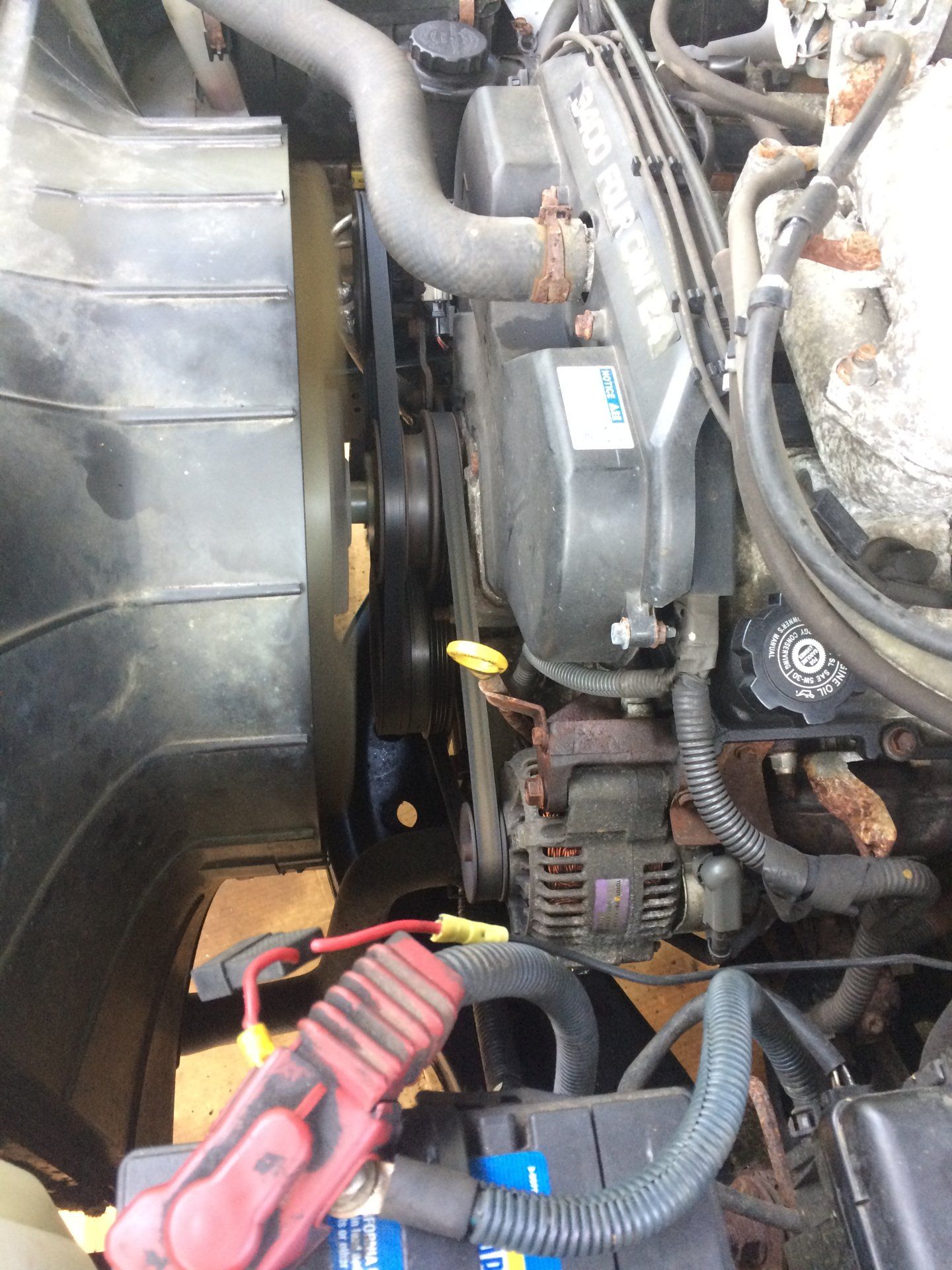

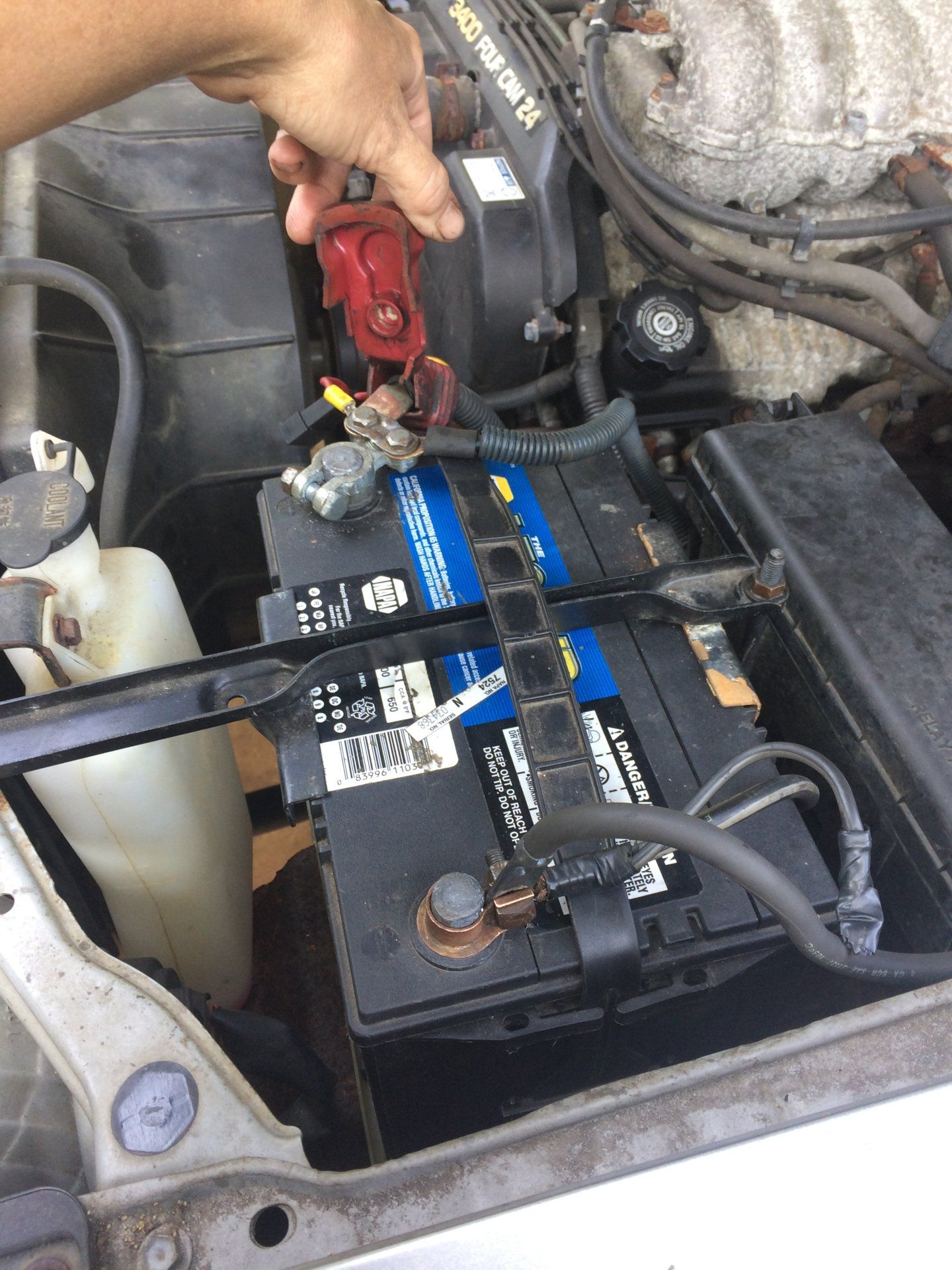

Got a ride from a friend w/ his 88 Cabriolet Convertible to grab my uncles ‘02 Tundra to use while I figure out some rust on the Nissan that’s pretty darn bad. Truck had an battery light right at start up but ass me mistakes it thinking engine. My Nissan has an engine light frequently enough that I just ignore it (evap stuff). Truck felt funky so I pulled over to talk to my friend who was following me. It sat idling but again ass me didn't pop the hood. Managed home but definitely had intermittent loss of power then it would resolve relatively quickly. Got it to my Napa near my house to pop the hood and find crazy corrosion and then discover the alt belt was shredded and broken and simply laying over the pulley.

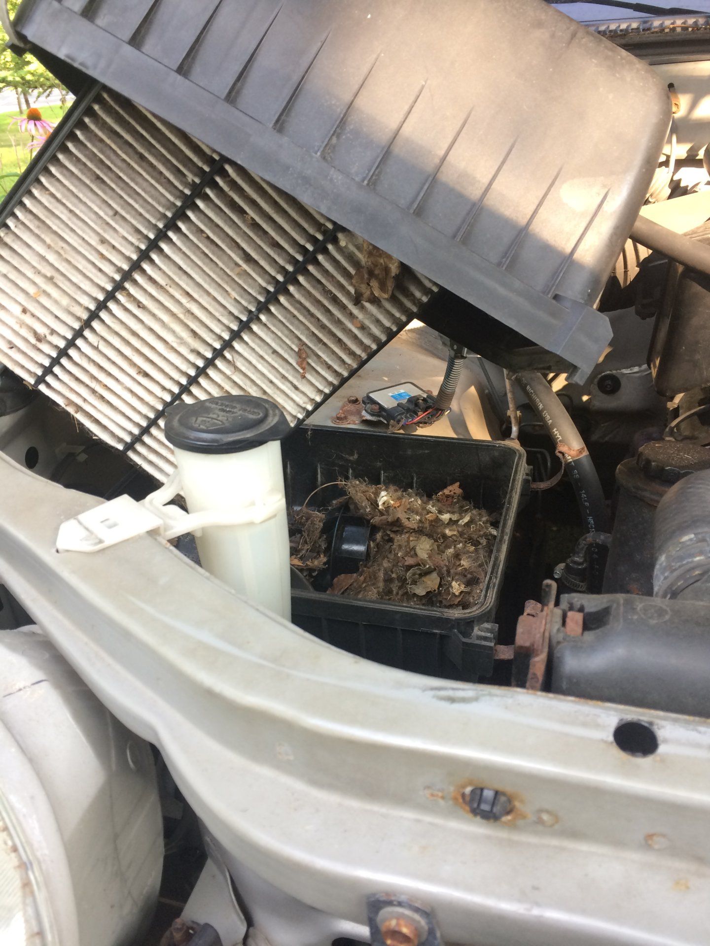

So here I am, wrenching on yet another vehicle. Oh yeah and check out the air cleaner box!

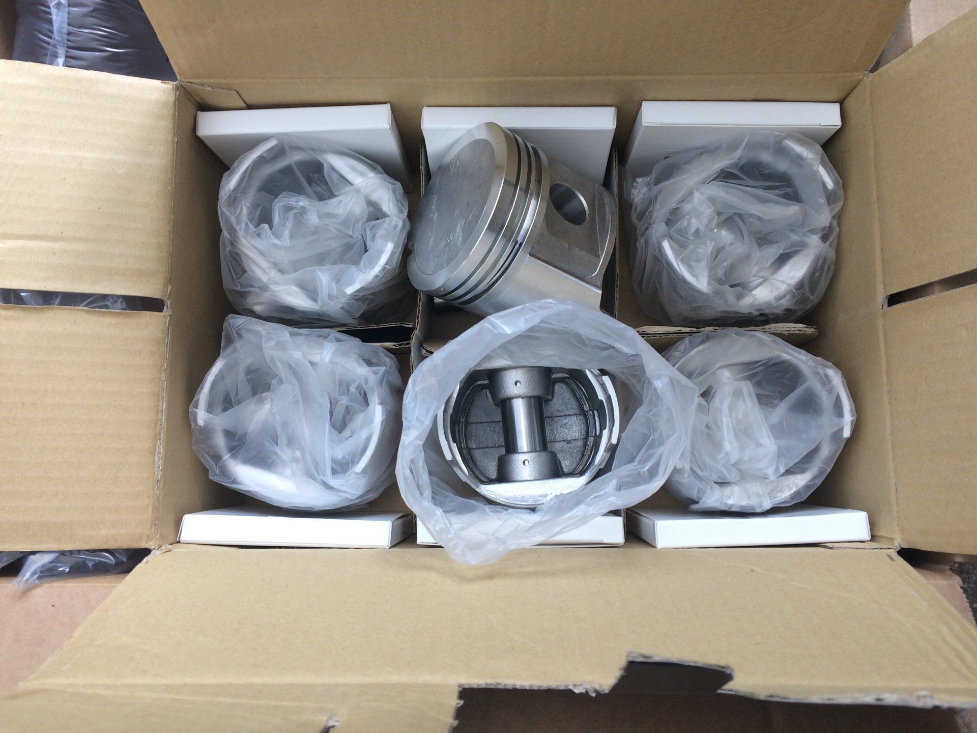

I did get these in the mail which is a perk to the day.

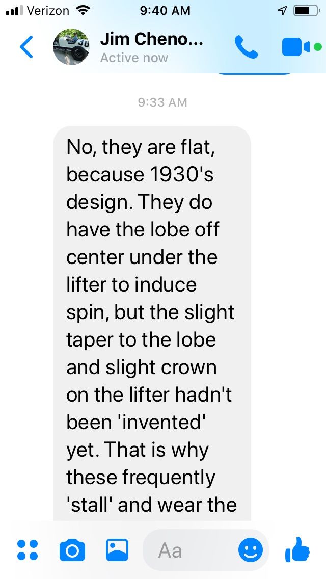

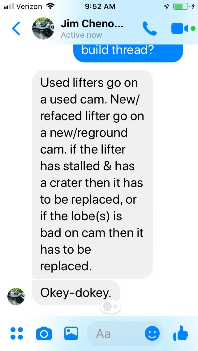

And I had this back and forth w/ @FJ40Jim regarding the lifters and cam.
Lifters are NOT domed. The cam lobes are tapered just as I had noticed when I had my cam in hand last year and measured it compared to the one Drew sent me. Mine was w/in spec, his was way out. I noted the taper then because of how the calipers could only touch the very center point of the lobes.

Speedo working, battery amps way up to a normal level, no squeals from the belts. I had to replace the alt tensioner bolt after finding it bent. I had to clamp it, cut close to the adjusting nut and backed it out. Then I put my truck battery in (he said he’d had the truck 5 yrs and never replaced. It charged but took a good 6 hours to go from 8 to full) and upgraded his battery ground w/ my heavy duty one and new used positive connector I had kicking around.

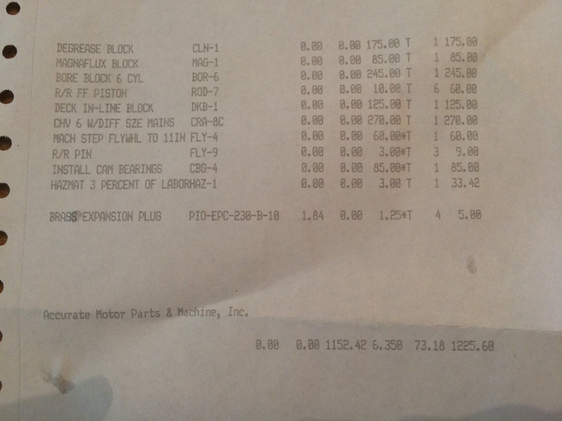

Quote from shop. I robbed Paul to pay Richie $500 down.

Doing well. Waiting on cam bearings which I’m having them install since they’ll taper the block holes so they don’t get shaved as they’re pressed in (I saw that happening when I added mine so figure it makes most sense for them to do it).
