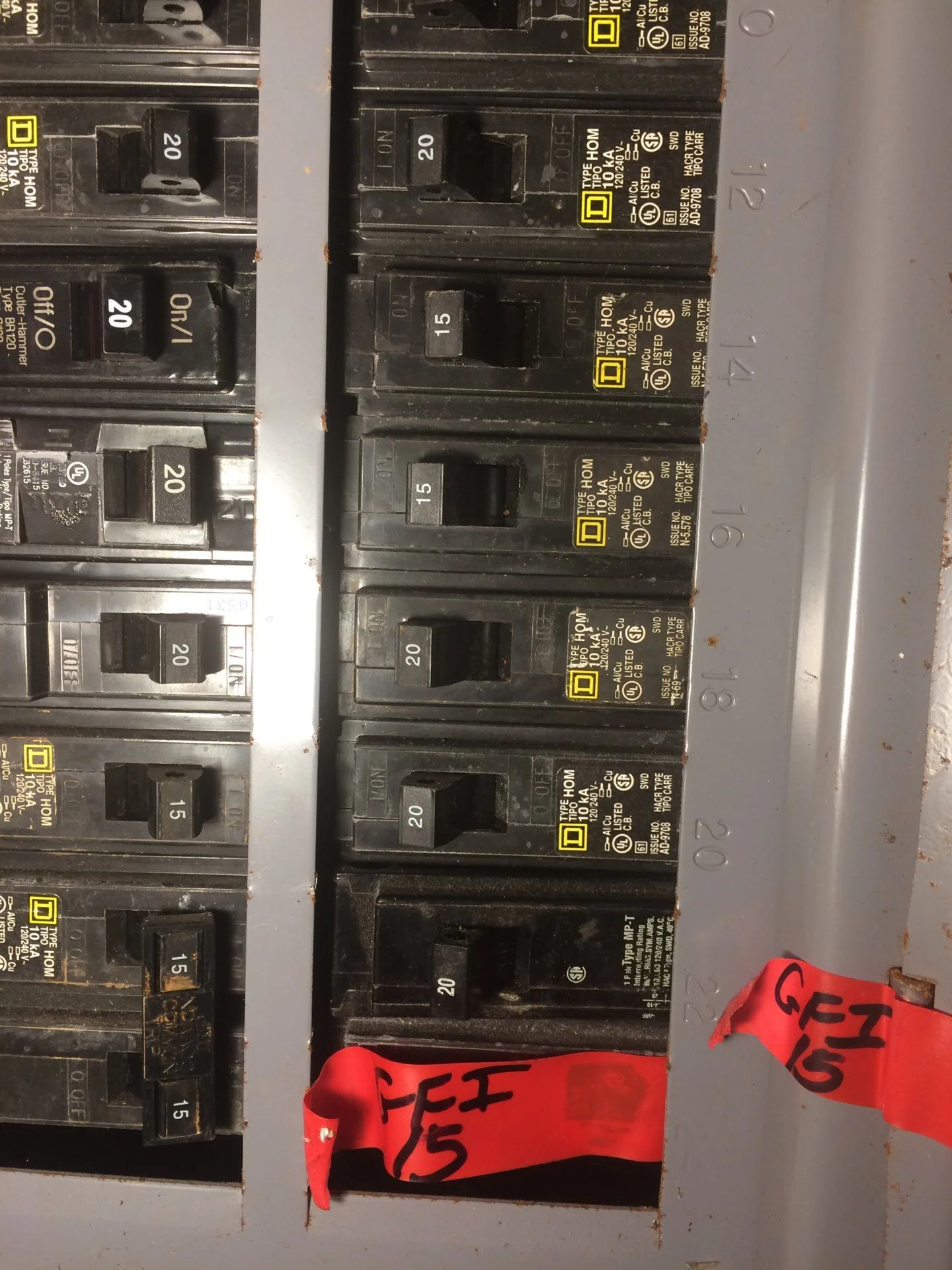

Waiting for my guy who did the wiring to text back. Panel in basement he redid, #20 is garage. White wiring has no rating on it.
HAHA! I answered half that question myself @Prairie Swamp, 20 IS the breaker size! hehe, this girl is learning so much today!

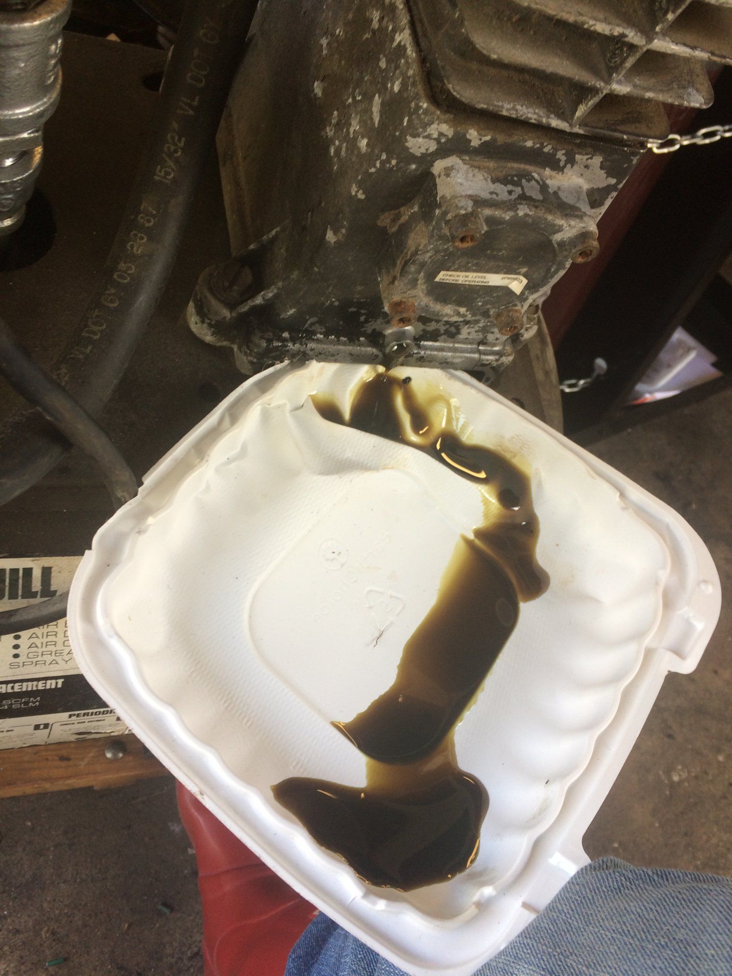

And on the oil end, I bought a quart of ‘compressor oil’ from Ace. It has no viscosity listed and it’s clear and much thinner than what was in there which was very dark in color.

My friend who did the wiring says the wiring is 14/2 and its a 15A. He is saying the melty plug WAS a 15A plug so replace it with what I have.

I guess he f-d up cuz he texted that he'd typically put 20 in a garage but is able to verify the breaker is 15a and the wiring is 14/2. That was well over 10 years ago...

I agree about the compressor oil. THe old stuff looks nasty and it's time for a change.
It’s run w/ 14/2 and a 15A breaker. Friend thinks he just replaced what was already in the garage instead of updating w/ 20.
Good in a way. It's perfectly safe but I'm not sure you should plug your compressor into it. It will drive you crazy if it keeps popping the breaker.
You have a bunch of 20 amp breakers in your panel You might be able to just get a heavy duty extension cord and plug into one of those circuits.
Or, you could get your electrical friend to actually measure the current draw of your compressor when it's running. He probably has a clamp on meter. It may be less than 20 amps.
He’s just a home brew diyer whose done his own work and others for cheap because he thinks the prices most contractors charge is absurd. He runs everything to code but maybe 10 years ago flaked our on mine.

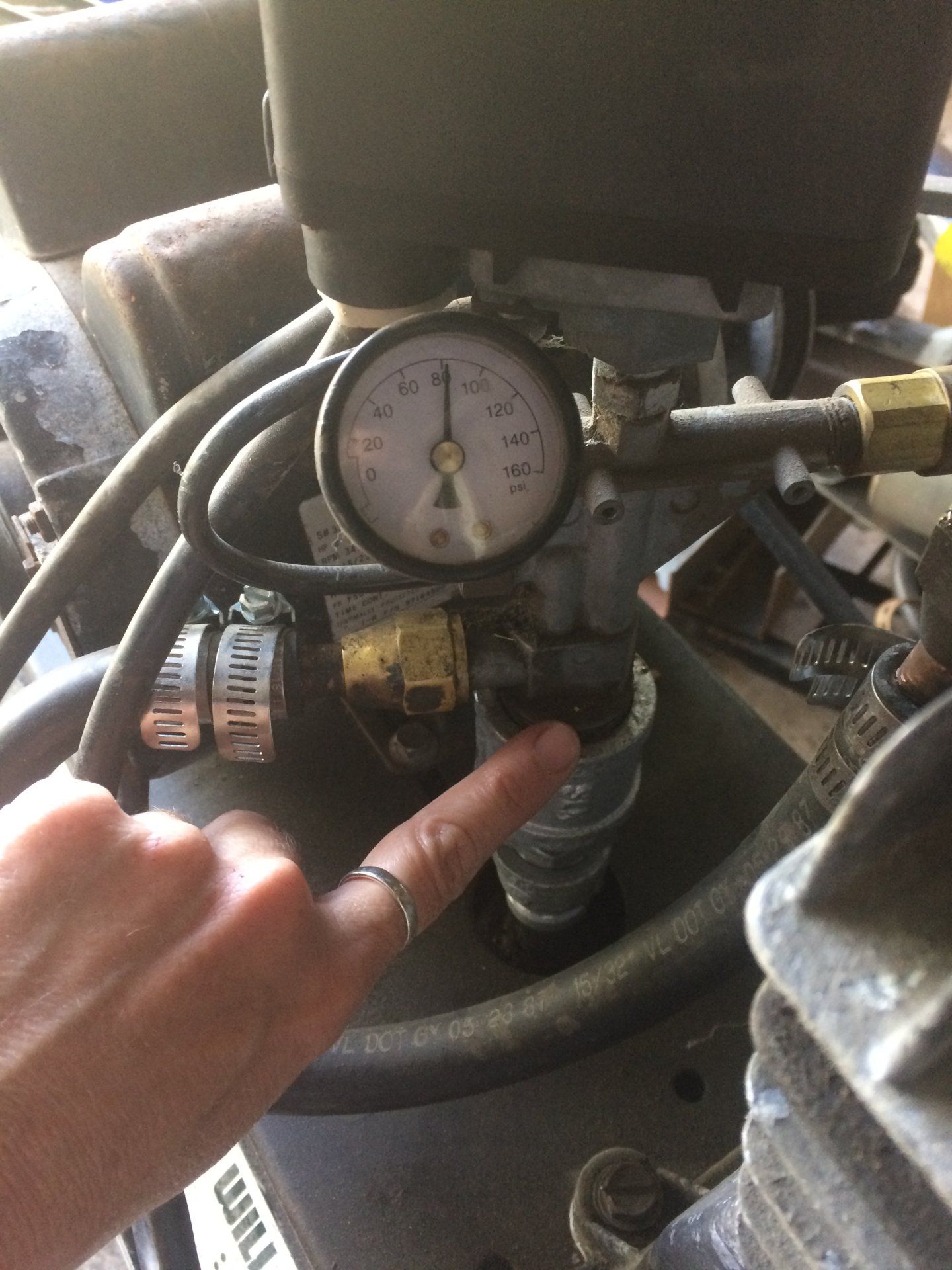

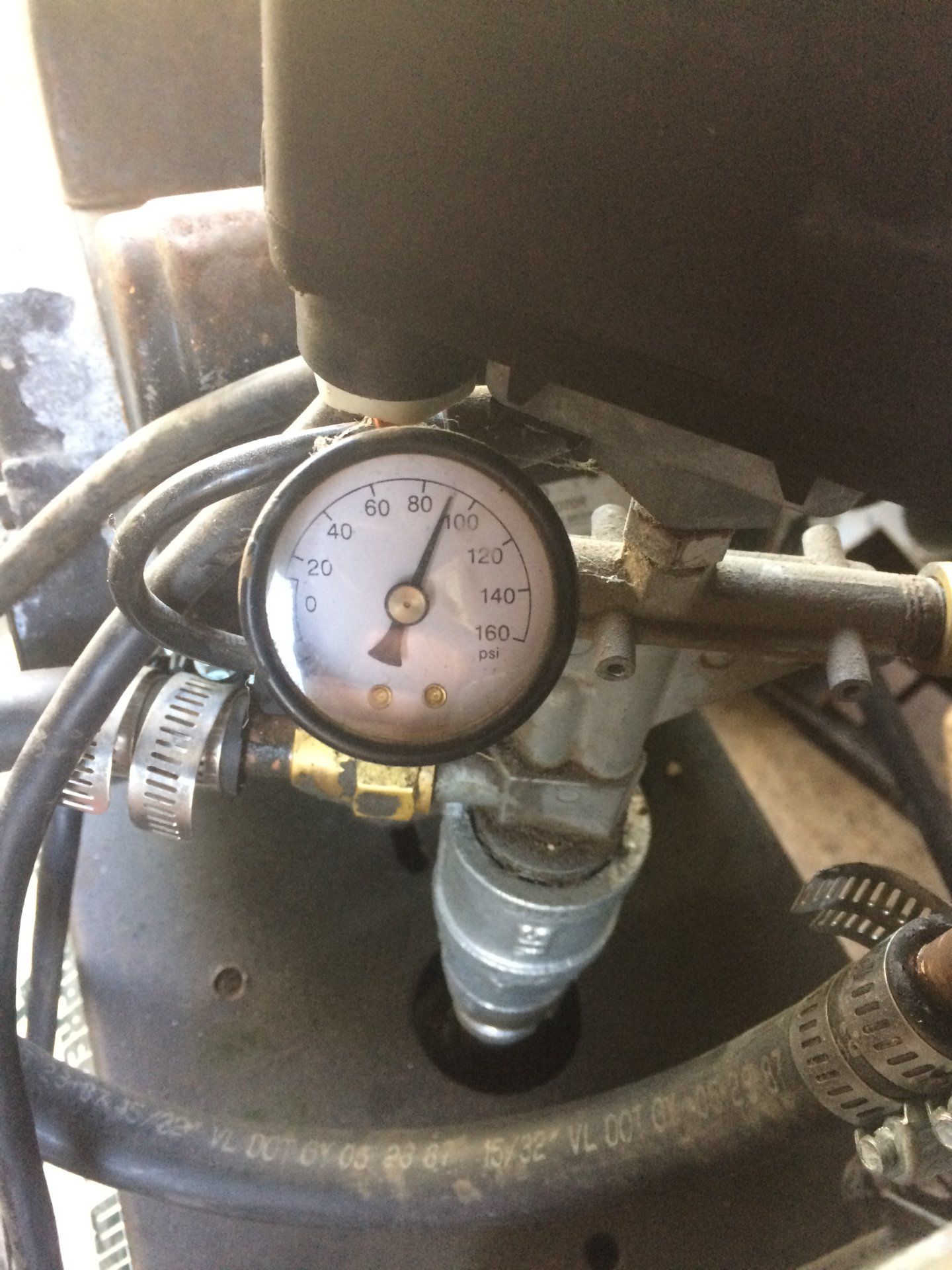

It runs. Took about 8 mins total to get up to 90 then it shut down. Leak is pretty significant where I’m pointing and when it reaches about 70 it kicks back on.
