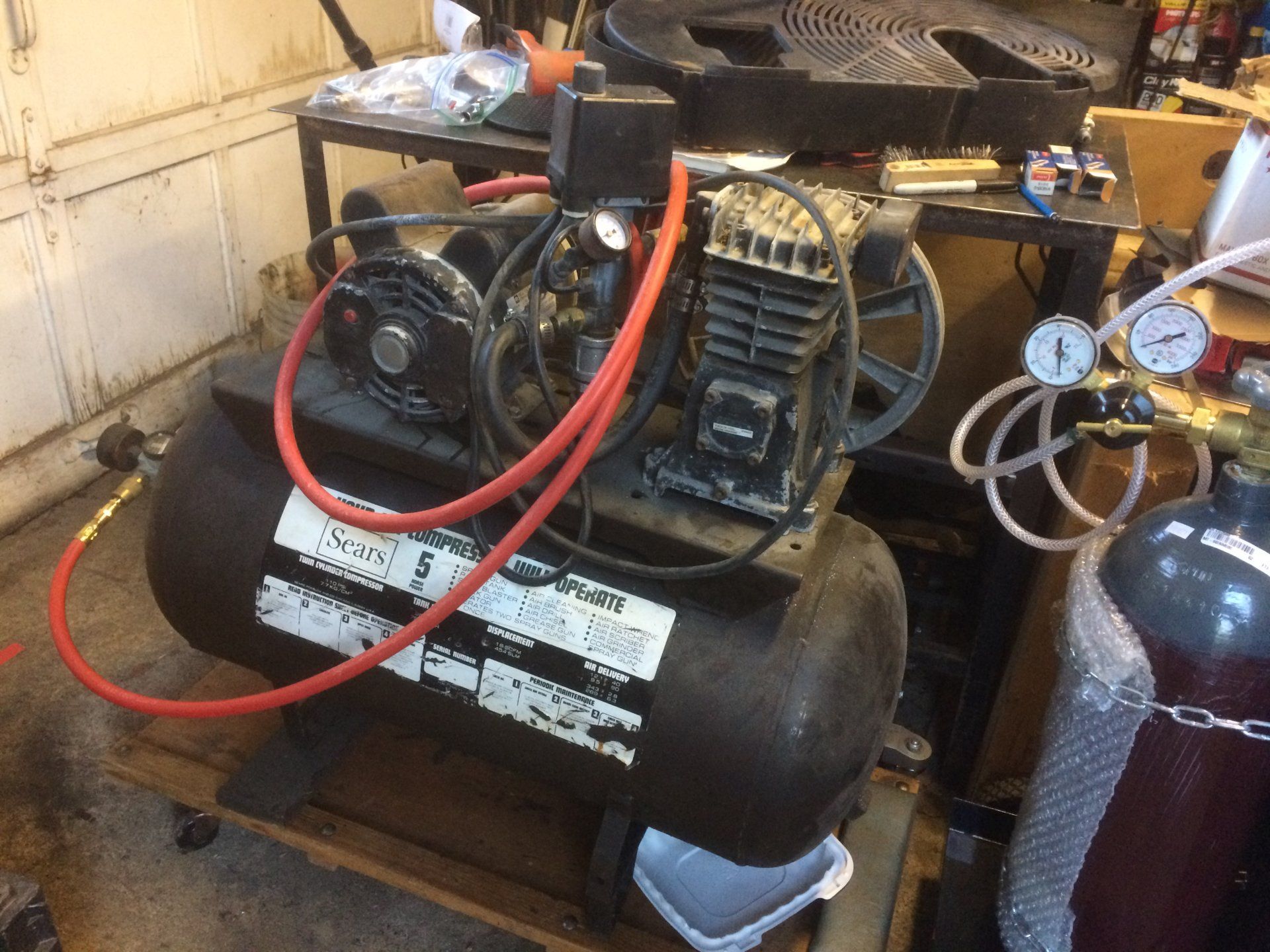

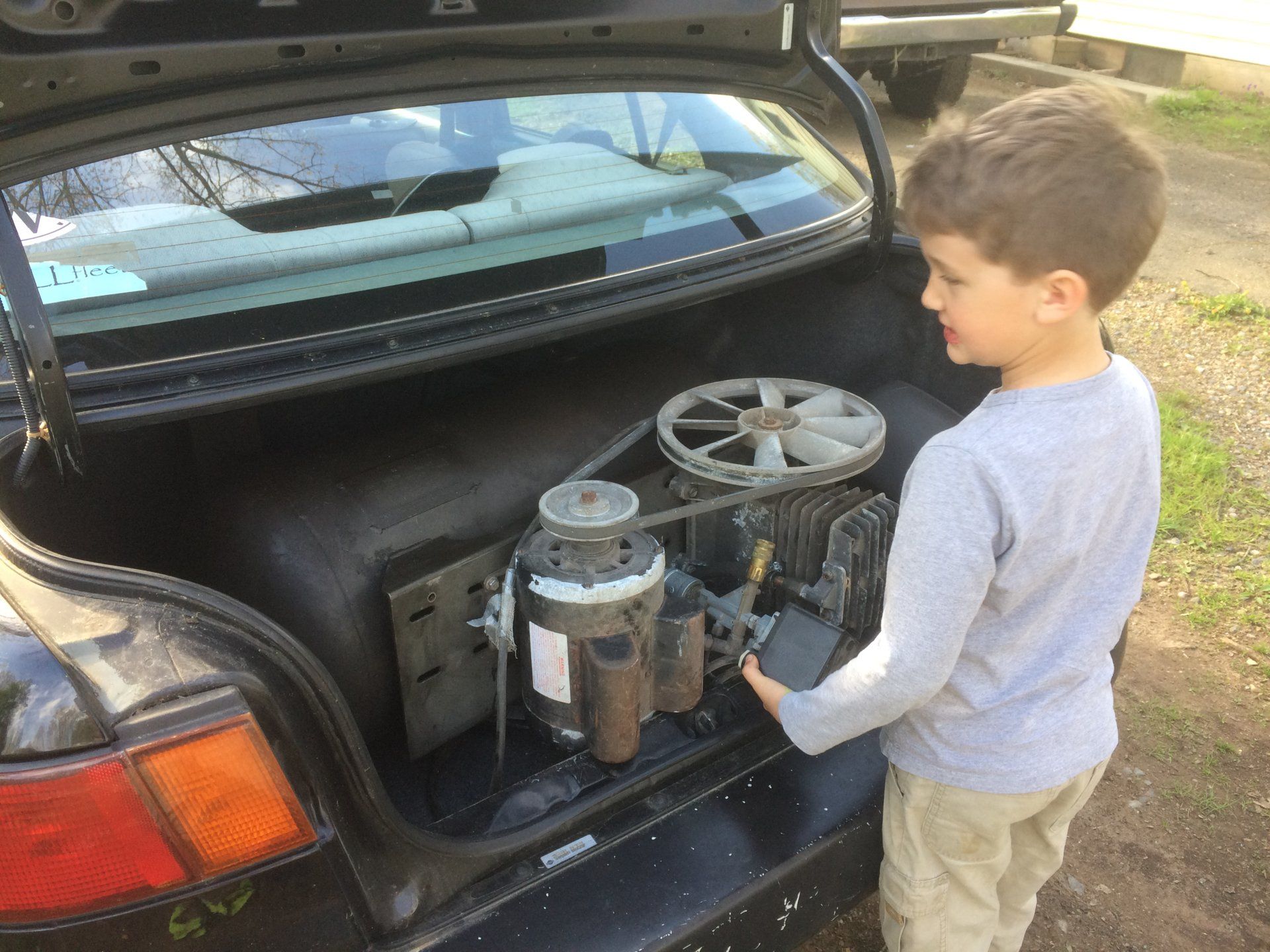

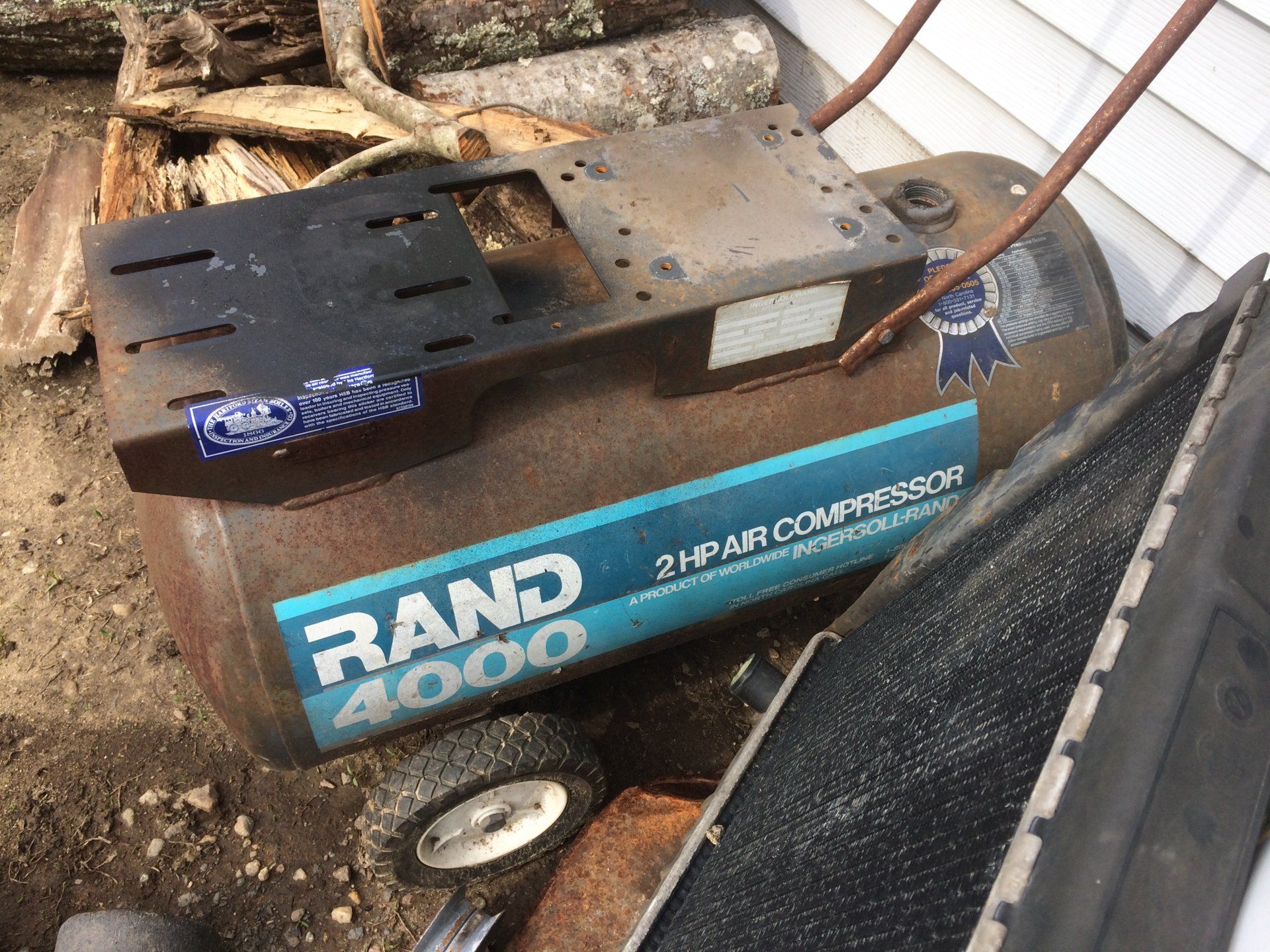

Picked up this old beast today. It’s a hybrid half Sears 20g and half Rand 5hp. Needs a bit of attention to a leak at one connection, a new three prong plug wired on, casters possibly, a cleaning and I’ll be good to go. Watched it run and come up to pressure even w/ that crappy plug!
Did you drain the oil from the pump before you carried it sideways? If not, leave it upright for at least 24hr before you try to run it. And turn the pump by hand a few revolutions before you hit it with power.
And even tho you saw it run - i’d still probably check the oil level and cleanliness. Change it if needed. It’s less than a quart...

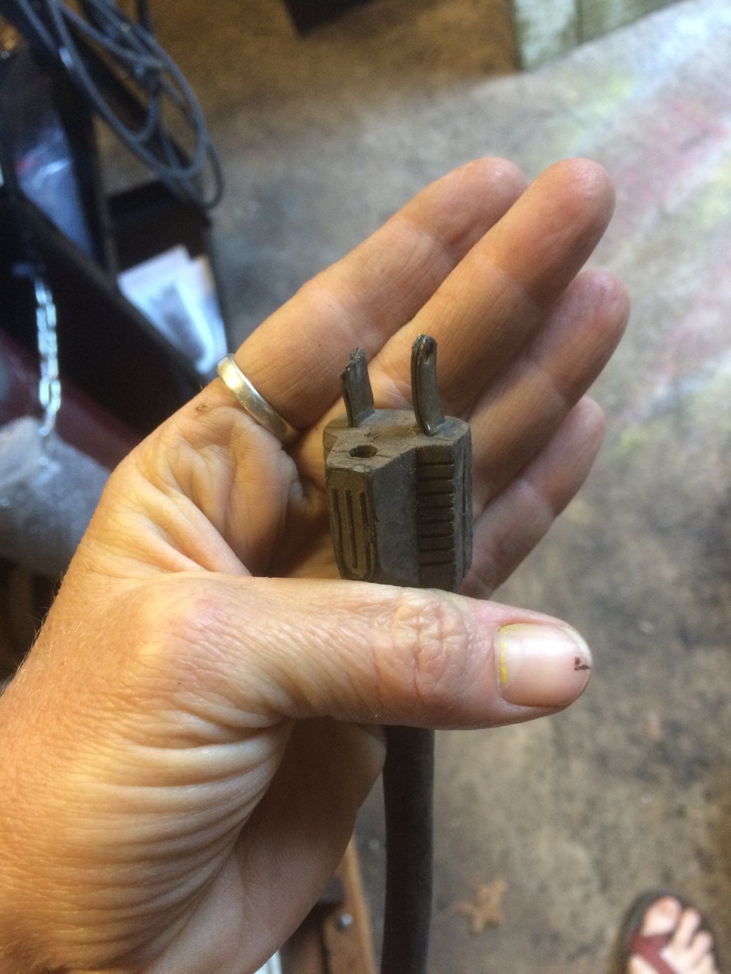

No he didn’t say anything about draining it before we put it in the trunk. He did say to open the drain after running it each time. I pulled it out and set it on the creeper and put it in the garage. I’ve not run it here. Plug is too darn ugly for me to stick in my outlet. I’ll heed your suggestion of spin it before powering up. Thank you!
Open the drain on the air tank before each use to let the water out.
It has an oil sump just like an engine. Should be a dipstick or sight glass. If the oil is dark change it. Get compressor oil at Napa or wherever.
That looks like a beast of a motor for that little tank.
As long as it spins over freely by hand you’re good. Carrying it sideways might have allowed some of the oil in the bottom to migrate into the cylinder - ideally you’d want that to drain back out. Sitting upright overnight should be sufficient.
Looks like a good unit. It’s appears to be a compressor duty motor too.
Multitask you mean? I looked that term up you used. I see the difference. I could text the guy too for more info. This was the original tank but it rusted out so he swapped the sears tank on it but made it abundantly clear that it’s a 5hp motor as well.
