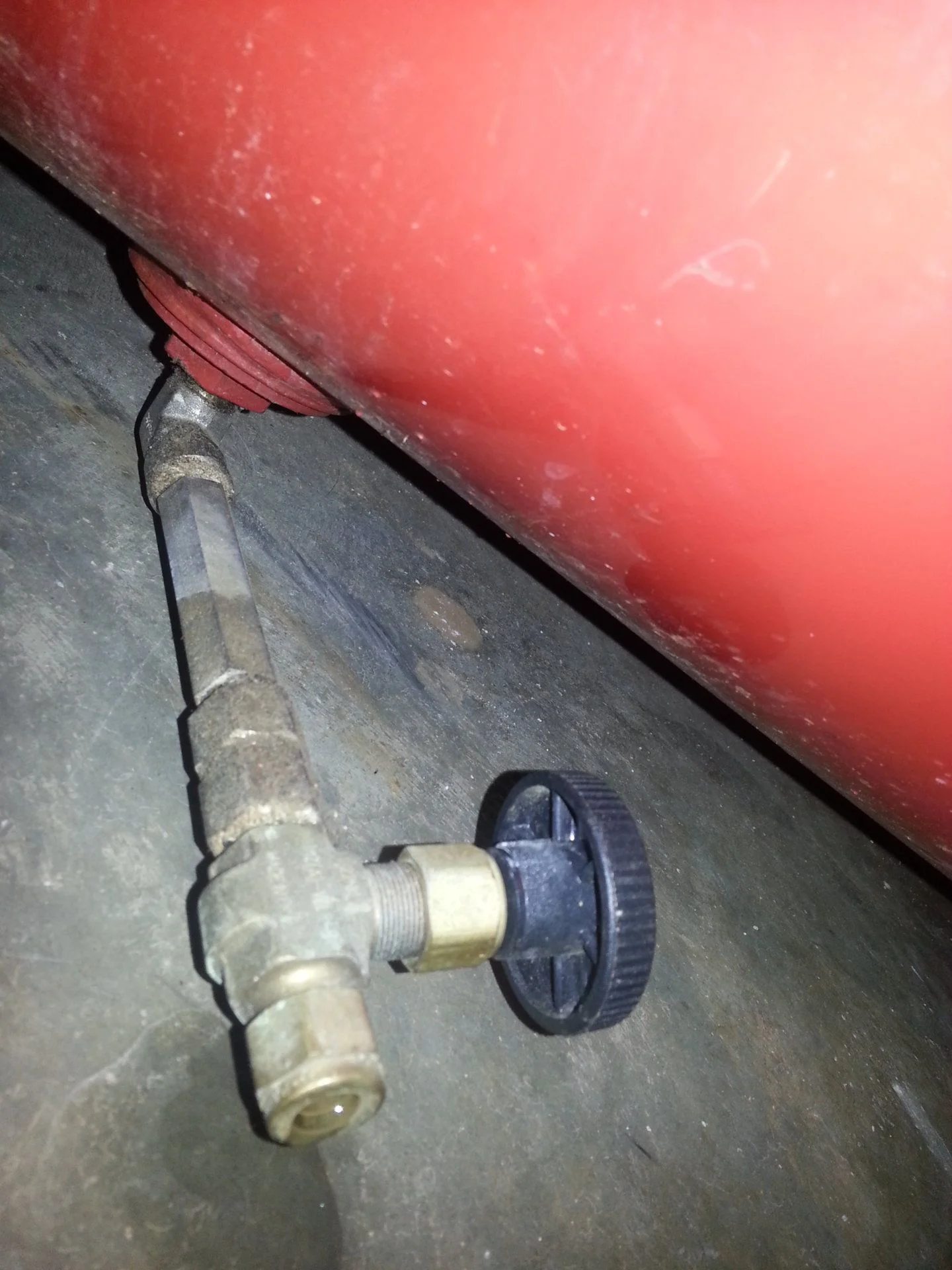

There's no plumbed drain on the bottom of the tank? Usually they have one with a valve you turn to drain the tank.
It does. I checked a bit ago after I’d opened it and it drained out a bunch more, not too dirty.

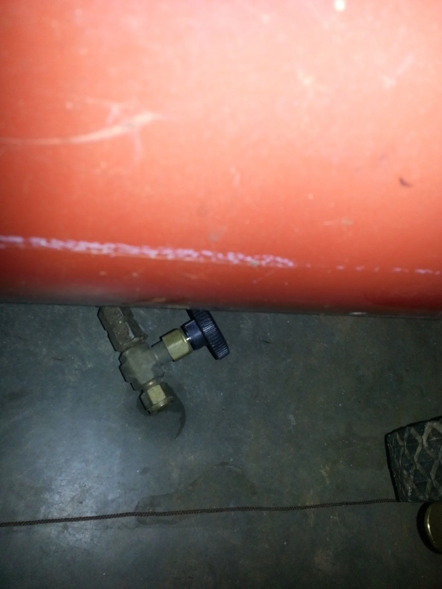

plumbing section in the hardware store will have a valve, elbow and pipes. Here' mine. notice how the valve is sticking out a little so you don't have to reach under the tank. Use this to bleed the water off and to drain the tank. Wear hearing protection if you pull that relief valve but really no reason unless you just want to exercise it or make sure it works.

Damn @g-man that is almost the same as mine... I need to put a small drain in like that.
Looks like what I did.
If you look at the bottom of his compressor on the pic, you see there is a huge pipe fitting cap.
After draining out all of the air, I removed this to drain any extra crap out of the bottom of the compressor (let it sit overnight). then installed the cap back in and then the pipe and ball valve.
Gives you time to do the compressor oil change and fix the plug.

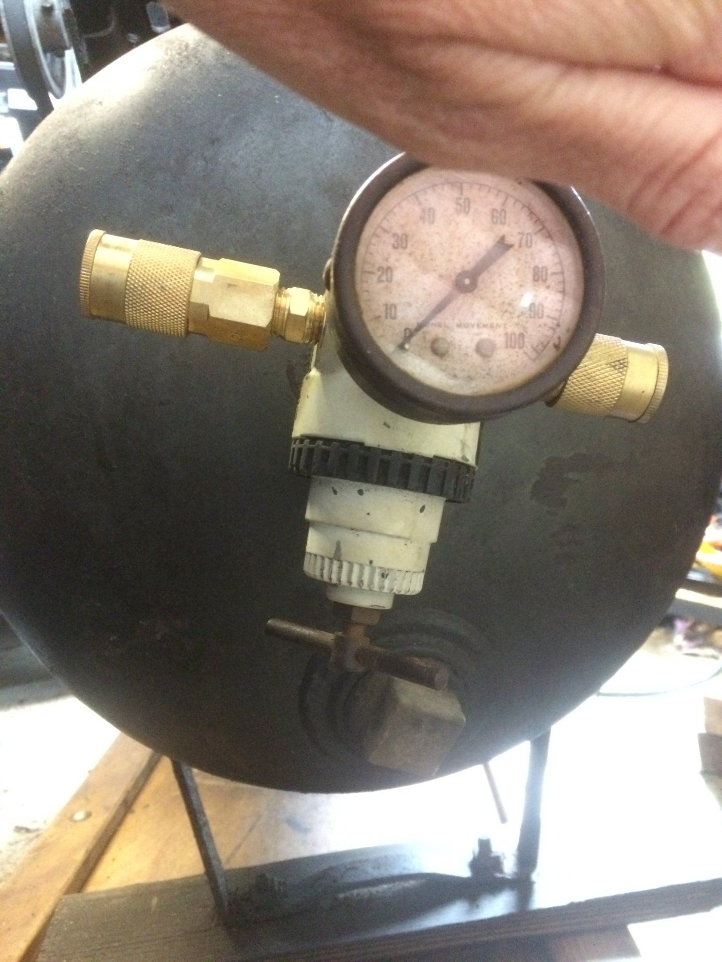

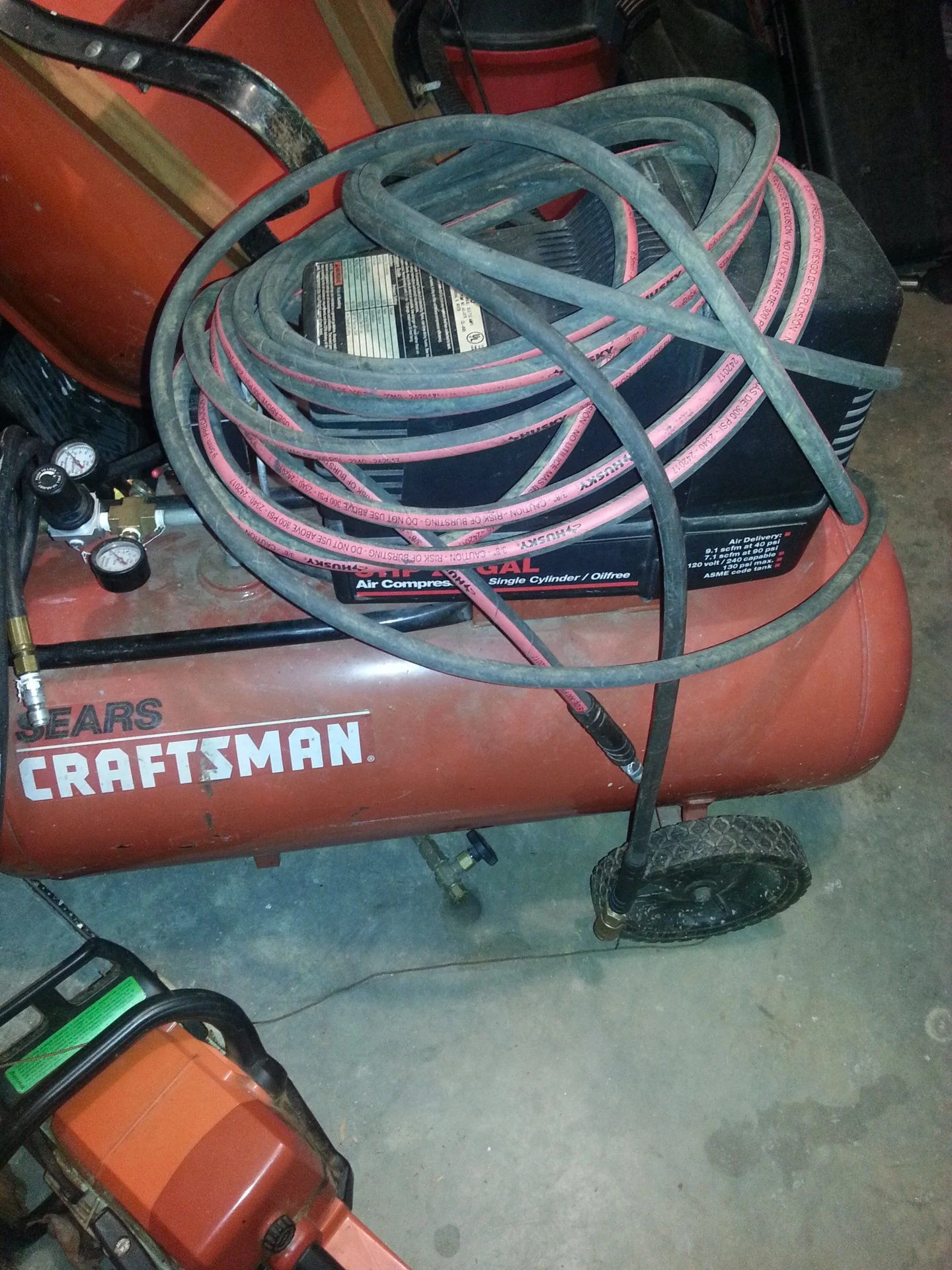

Do you know Dave? I tried pulling the depressurise valve to empty all the air, left the water drain open too. Pulling the valve I get no hissing at all. Does that mean it’s empty? The seller added a second hookup on the end as well w/ a regulator and a T below. Would I open the T?
That T handle is a pressure regulator. I’d have to see a bit more of how it’s set up to understand which connection, if not both, it regulates the flow to.
Ok, yeah that what me and @evilorgoodtwin might have figured out. Also guessingbthat since both valves are showing zero that the tank is already depressurised. I’m in now relaxing. Will check it out more tomorrow. Thank you!
