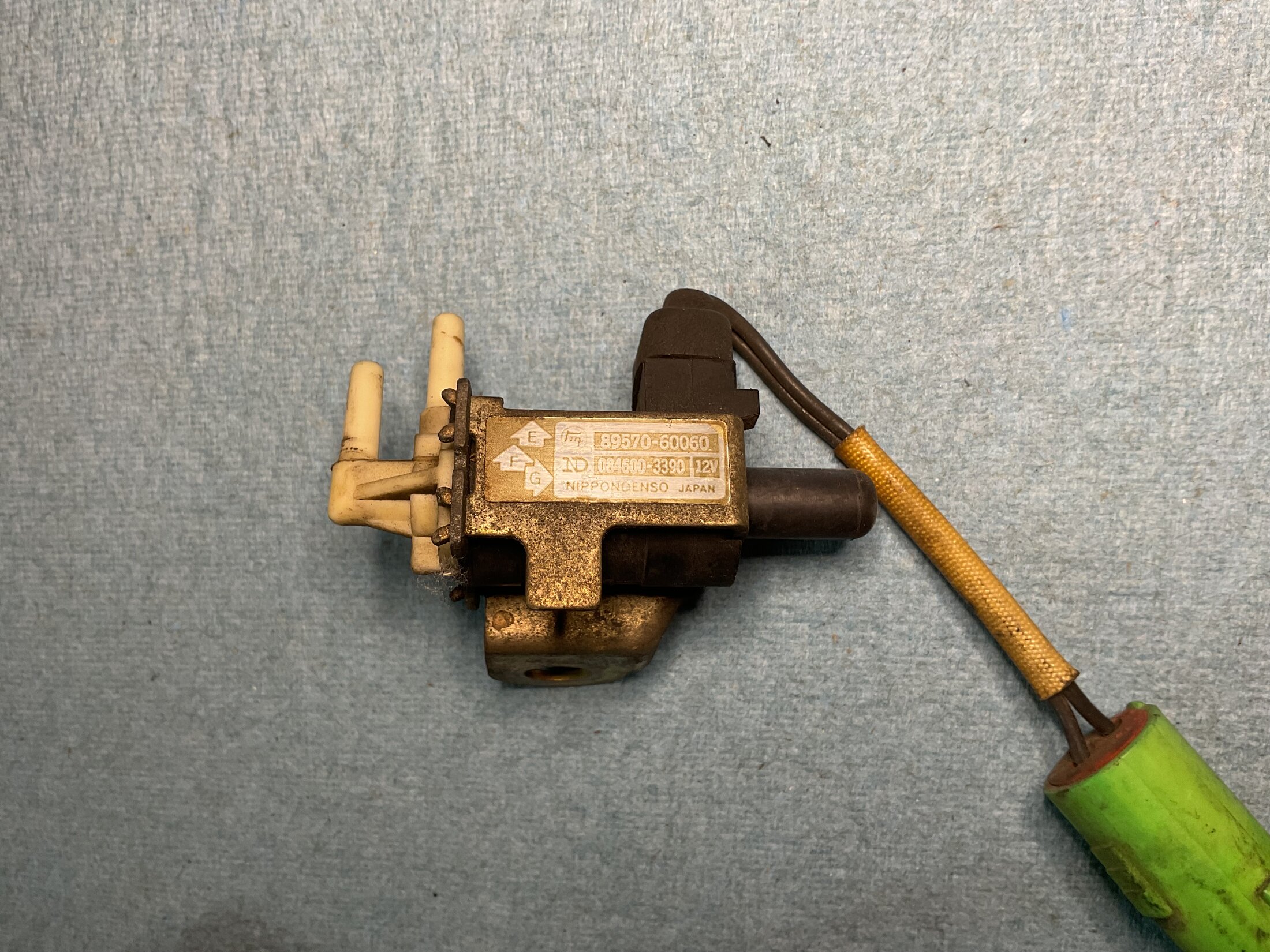

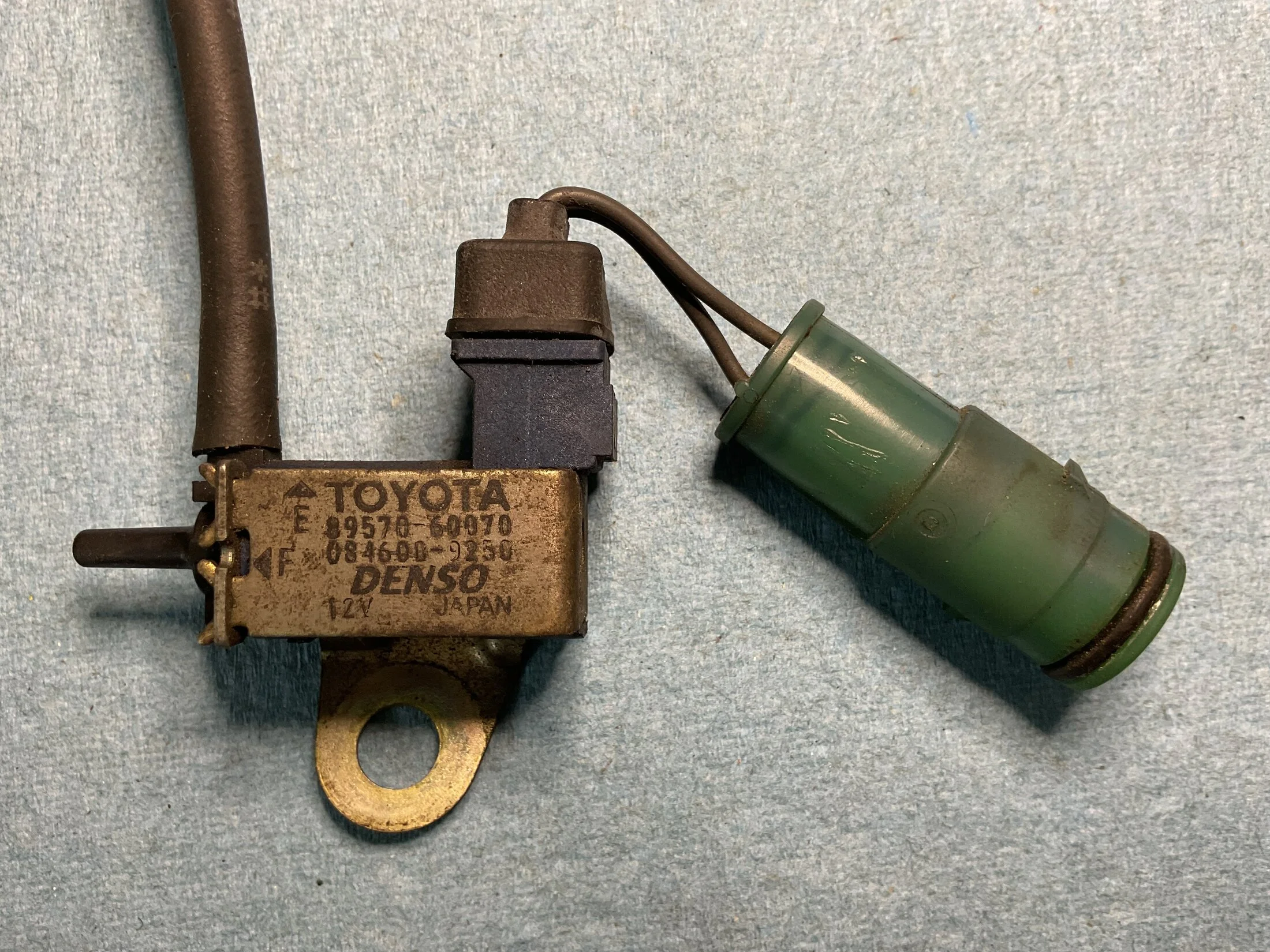

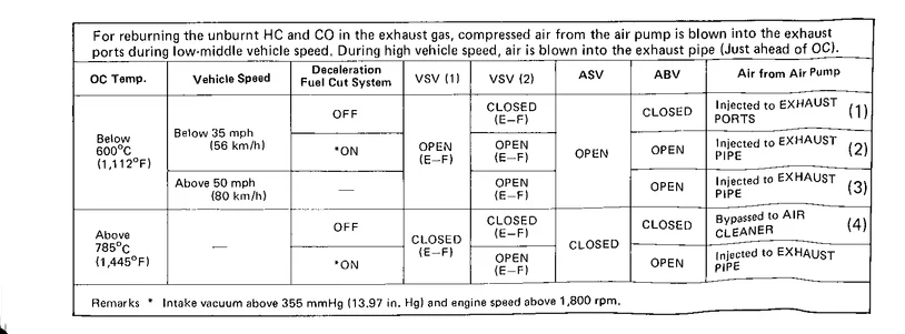

It's the one with the green label (I think it's actually a VSV) 89570-60070. Mine is very dead and one of the wires broke right off at the solenoid body.

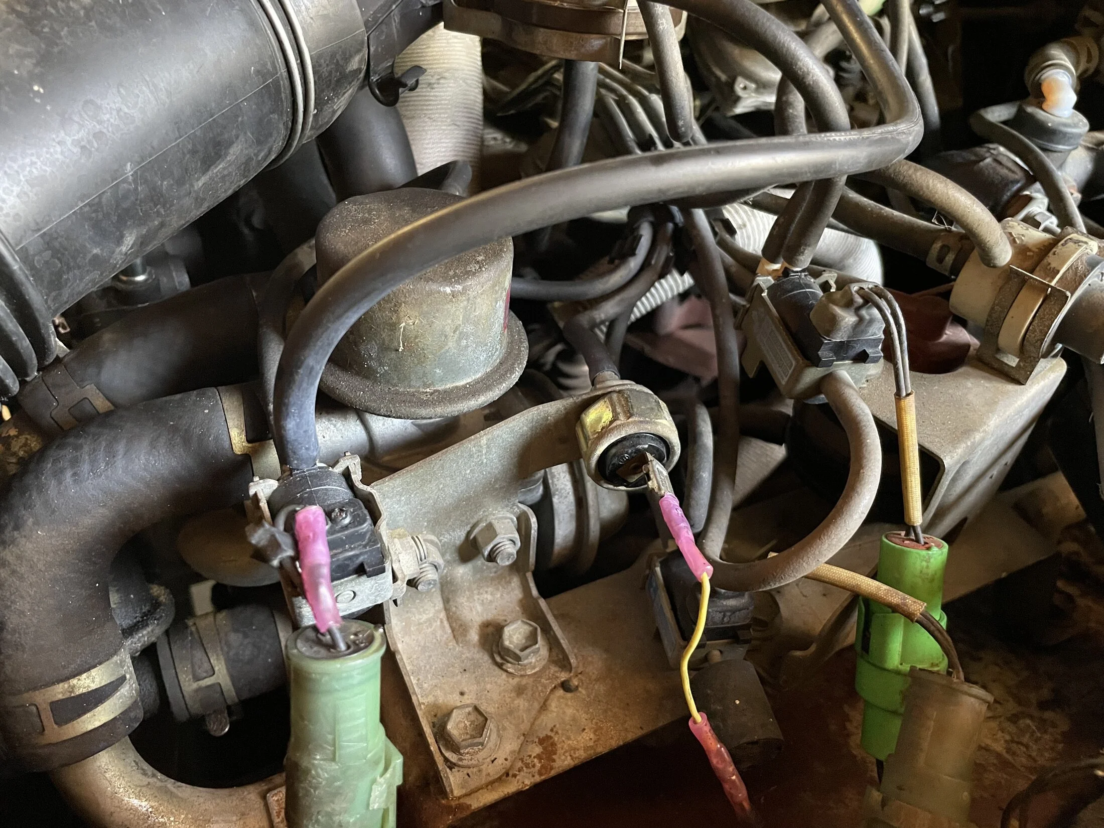

It's on the driver's side fender, near all the big air hoses and such. Here's a photo of it on my rig, it's the one on the left with the failed repair on the wire. Also if you have that thermosensor that goes into the cat converter, with the green plug on the end. Not critical for smog but would be good to have!

@Spike Strip Do you know if it is absolutely necessary to have that to run smog? I have time this afternoon and can throw the other one back on for visual if it's only marginal to the results...
IIRC, both those VSVs are necessary for Air Injection to work properly. So yes, I'd make sure you have a functional one.

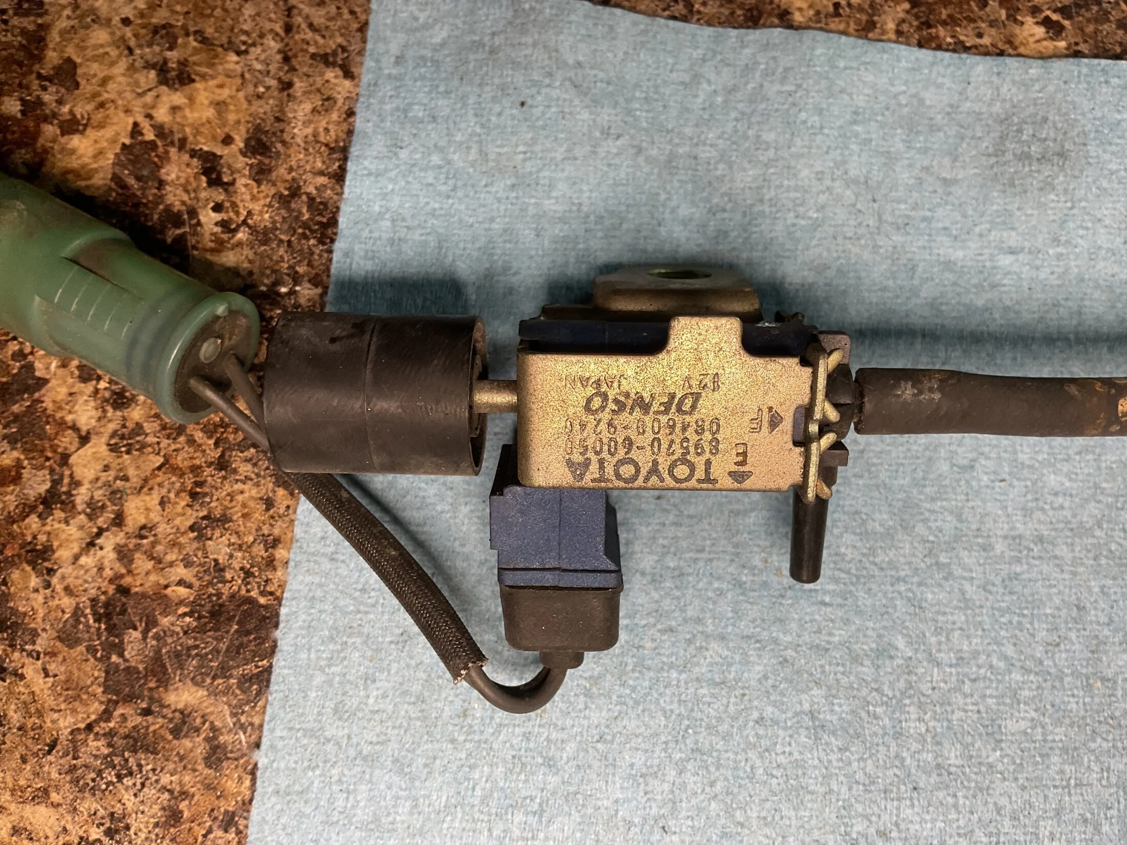

Yeah thought so. Was just looking at the emissions FSM and the table is pretty detailed on when that one is on and off (labeled VSV 2 here). Will hold off until it's in place. The one that Mark @65swb45 had in stock (VSV 1) works great.

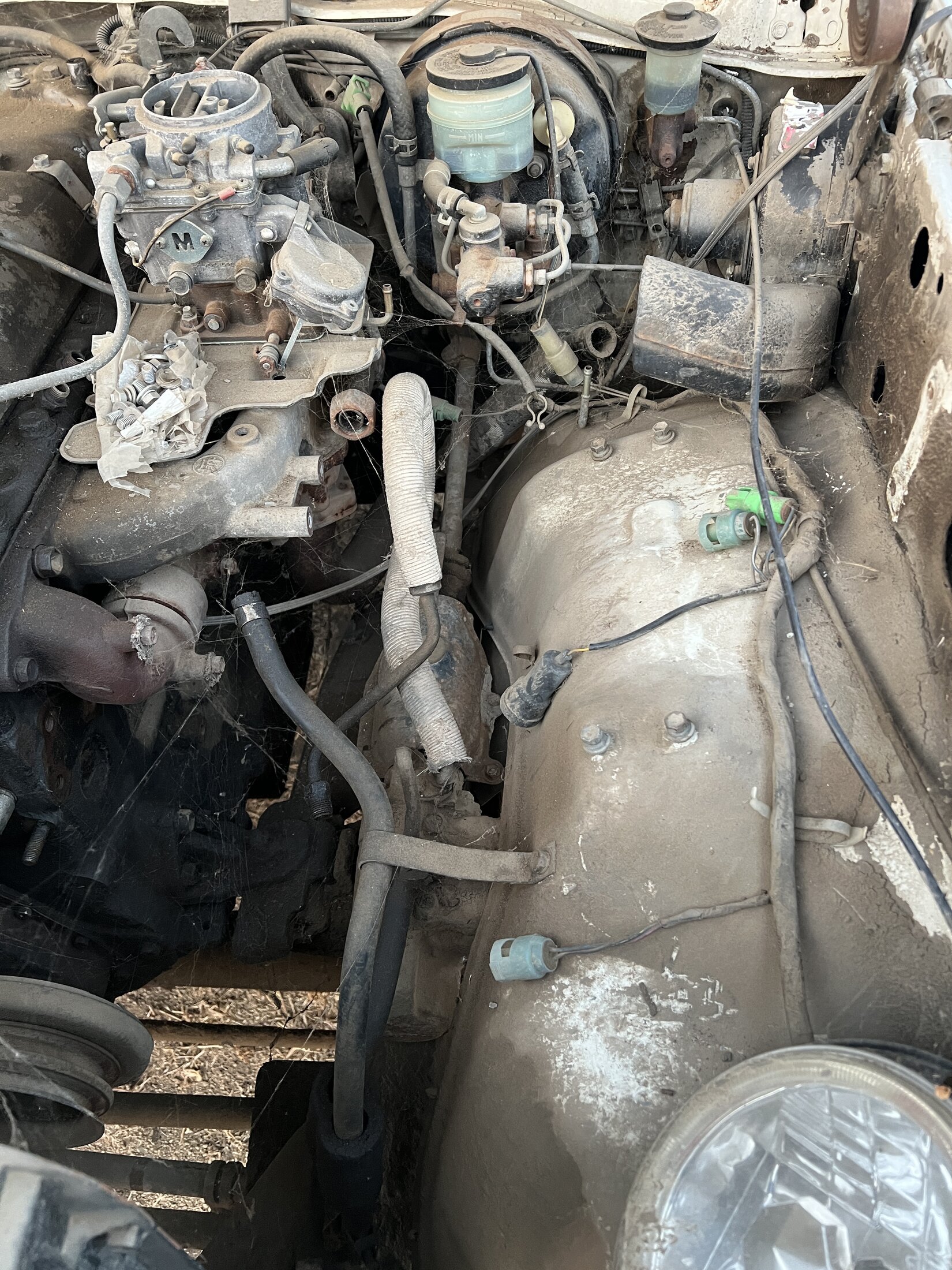

I have an 83 FJ 60 that I fully desmogged 2 years ago, just went and pulled the box down that I put some items in, is this what you need?
If so you can have it. Not sure of condition but I believed it work when I removed it. Just PM me your address and I will mail it out. Only thing is Iam going out of town this weekend so can’t get to post office till Monday.
Also I have two others not sure if you could use or want spares but will also send with it if you want them.

Those are them! I'll PM you the address. Send 'em all for spares. Thank you!!

No problem, thank you! How much would you want for that pigtail though? Mine is all chewed up, it's the green one towards the bottom of the photo (closest to the front of the rig), unless you are keeping the harness together?
Tell me how long you want the wires and you can have for the cost of a small flat rate box. I also have a non mouse poop infested rear heater :p
