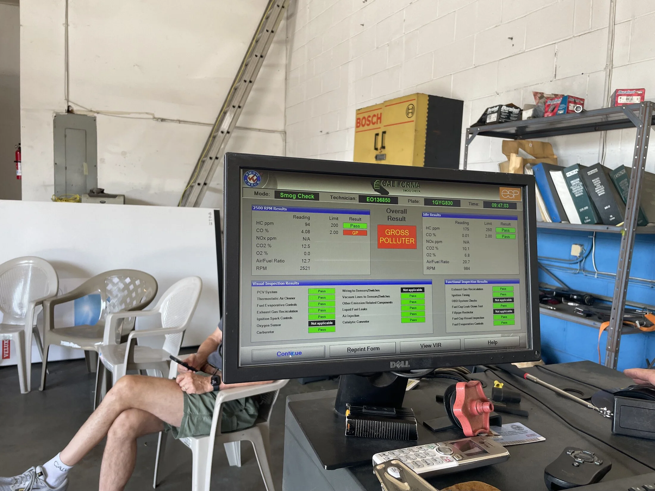

Got up really early to meet @RodrigzCrzr to pick up some of the smog parts that he is donating to the cause - amazing and thank you!! Put them on the rig, drove down to my local smog guy, and here's the (somewhat expected) result:
Hard to read but it is 2x on the CO% at 2500 RPM, with 0% O2. So - ran through the AI tests all over again and everything checks out, including the ABV and ASV with the new VSVs. (Too many acronyms.)
Only two things I can think of - either the check valve at the exhaust pipe is bad, which is preventing air from getting into the mix downstream and not allowing the extra HCs to burn off in the cat (even though HCs are elevated but passing), or the carb is dumping too much gas into the system from the secondary, assuming the secondary is open at that RPM (pretty sure it is). It passed great at idle, where the system directs air to the exhaust ports, so that part is working fine. Maybe the secondary jet is too big? But the carb was fairly untouched when I got it, so...
Anyway - at minimum I'm replacing that second check valve given the 0% O2 at highway speed, and looking for other ideas on the high CO. Guessing the cat is ok given these results, but @Spike Strip may know better.
Also - the smog tech didn't put it on the dyno for the test. I thought that was odd but didn't question it.
Running rich. Incomplete combustion. My guess is you need a CAT and maybe a carb rebuild. Secondary stock Jet is 2.00, unless somebody changed it out along the way, but unlikely. JimC once posted these are supposed to run a little fat for the CAT to work, but that's the old giant brick when they are fresh and full of functioning Platinum, Palladium and Rhodium.
For the Air Injection, could be a frozen downstream check valve. The ACV apparatus may need to come apart to clear out the crap. You wouldn't believe the debris that accumulates in those valves blocking function.
A MUD member has a Magnaflow CARB CAT direct fit on ebay - it's been there a while. Maybe you might be able to work something out....? @ace10
EBAY
I personally would now source a FED version.
If you weren’t on the dyno, how can you even be sure that the secondary was involved? It seems totally feasible to me that you could reach 2500 rpm on the primary with no load on the engine.
They didn't put mine on the Dyno either, a few months ago... Something may have changed in their procedures. I know CARB and BAR have doubled-down on the stupidity as a middle finger to POTUS
EBAY
Yep. If I have to go there it's going to be a Fed version. The ASV seems to work ok, but I can pull it apart just to check. Jorge gave me one in case it's needed. I did find an ACDelco 214867 check valve on Rockauto, but if you have another one (sheepish) I'd rather do that.
Can't. And I wonder if that would mean lower HC and CO rather than higher, so results may get worse if it's on the dyno? It was weird tbh, but I went to a different smog tech than my usual guy because his machine wouldn't calibrate. The guy I went to will do a precheck once I make any changes, but it's still a do.
Also didn't mention that it failed the idle / high RPM check on the first go, requiring a "precondition" before running it again to heat up the system. Never saw that before either.
I have more Air Injection check valves, but the Rockauto ones will work fine and the price is right. Just stick a spacer on the nipple, like the dorman nipple caps and cut the end off. LINK
Lemme know.
Lemme know.
I think the threads on the Rockauto ones are wrong - they would need re-threading unless there is one with the right thread pitch?
I pulled the check valve off the exhaust pipe and its blocked up something terrible, like needs to go on a high fiber diet bad. Nightmare to get at too. I can't say that's 100% it but sure af didn't help. Swapping out the one on the 62 for now.
Standard AV8 is the correct threads w/ 18mm nipple. (and anything that crosses to the AV8)
Jump on it:
LINK
Ordered - will go on the 62 when it gets here. Thanks! The one you sold me is on the 60 now. Total pain but done.
EDIT - ASV is sooty but no big chunks or anything. One less thing to worry about.

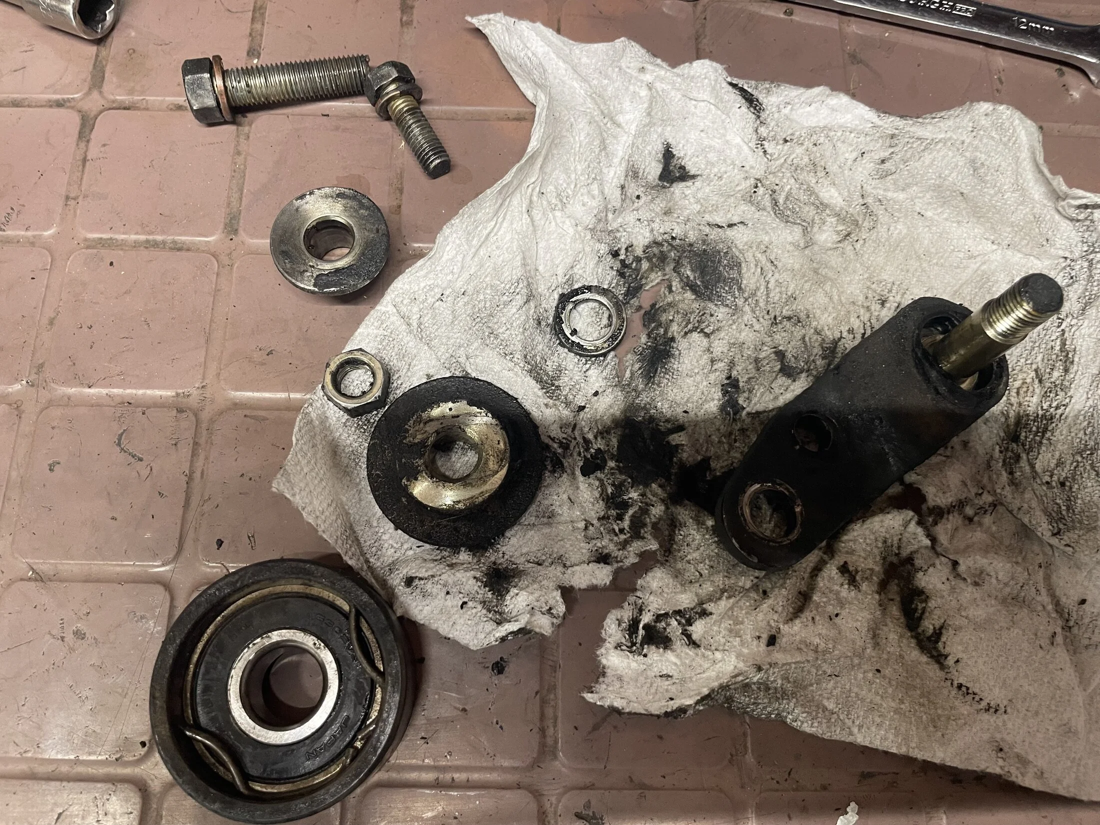

Carb is off the rig and down at Mark's for a spa treatment. Finished a couple minor projects today, first up is the AC compressor idler bearing. This thing was rattling and chattering like the smoke monster from Lost every time I drove it. When I came off the freeway on Saturday night, the thing howled in protest the whole way home. No wonder, it is jammed up bad and feels super gritty and trashed.
Pulled everything apart, cleaned off all the gunk and just as I drove out the old bearing, the Amazon guy rolled up with these:
It came in a set of two, so I have an extra kicking around to forget about later. I want to do some research to make sure I put it back with the right amount of tension / contact with the belt with the compressor switched off.

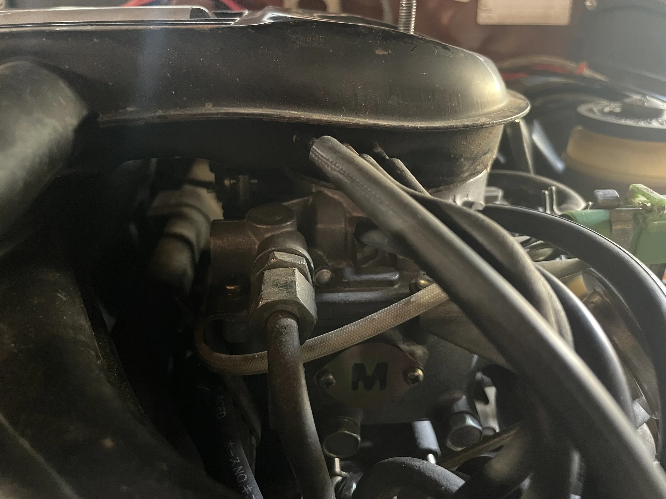

Couple quick hit updates - had Mark @65swb45 rebuild the carburetor and got that back yesterday, put it on the rig today after a busy morning of erranding around. Only needed a couple small adjustments to idle speed and mixture, and it was good to go. Came back nice and clean with a new secondary diaphragm, looking good sporting an M on the sight glass :) Smog re-test on Monday.

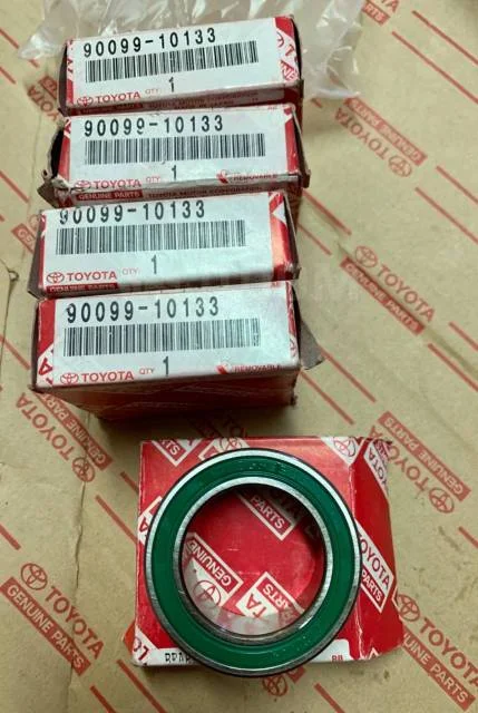

Smoke Monster noise is still there on the ac compressor. I have the following bearing in my cart but wanted to see if @Spike Strip or anyone else knows if this is the right one? This matches the 62x40x24 dimensions of the National junk that Rockauto lists for the application, but can't cross reference to the Toyota part because it's NLA.
Nachi bearing
Thanks Alf - I'm assuming the 40 and 62 refer to the bore and outer diameters respectively, what I can't tell is if the width is correct at 24mm. "F" is not a helpful dimension from Toyota. Looks like it but I may just order and send it.

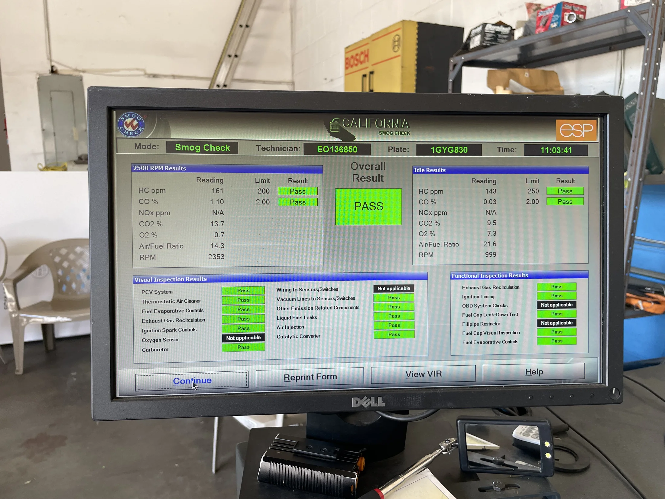

Off to smog recheck.
I read that F stands for front. If you look on Toyota parts deal it has all the superseded part numbers, maybe you can get some information from those.
LFG!!!!
Still low O2 at high RPM, hmm.
Pretest showed CO slow to drop into range but we got that figured out. Did not run E85 - was just whatever was in the tank. Also set timing at the usual 7* BTDC.
Big thanks to @65swb45 Mark at Mark's Off Road for the carb rebuild and @Spike Strip Alf for advice and guidance.
At AAA for registration now. Excited!
