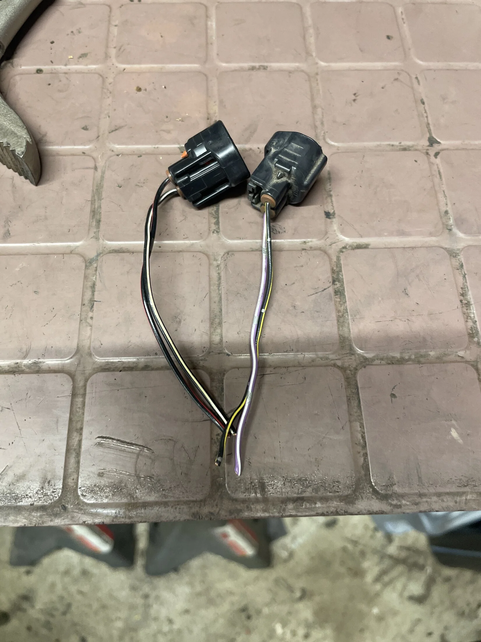

Pigtails from the junkyard. :)
These were from the wrong VSVs, as the ones that you linked to from Rockauto are buried between the firewall and the block on a late 90s Camry, and I wasn't about to get under a junkyard car to pull it. These pigtails came off the vapor recirc solenoids on the Camry, which is right at the top of the engine. Had the time, it was $3 entry day at LKQ Sun Valley, and I scored a Mexican Coke from the carrito at the entrance.
I think the Toyota Part # is 90980-11162, but if you buy from Mr. T, you only get the housing. ebay search that Part # and you'll get aftermarket pigtails.
But with the pigtails, there all diff part #s that will work since they're all now with the newer style connectors.

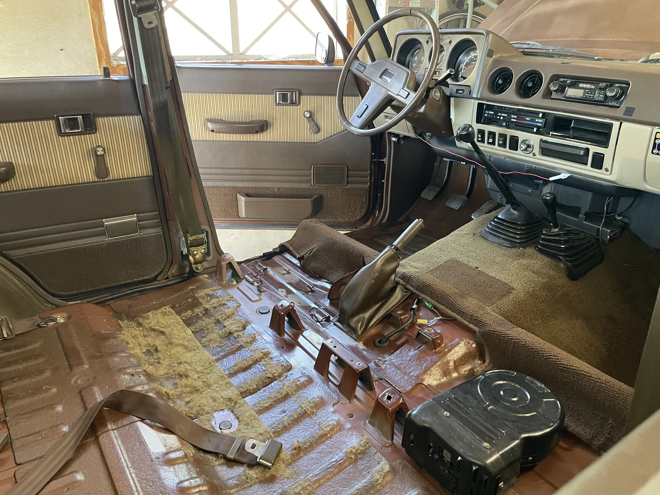

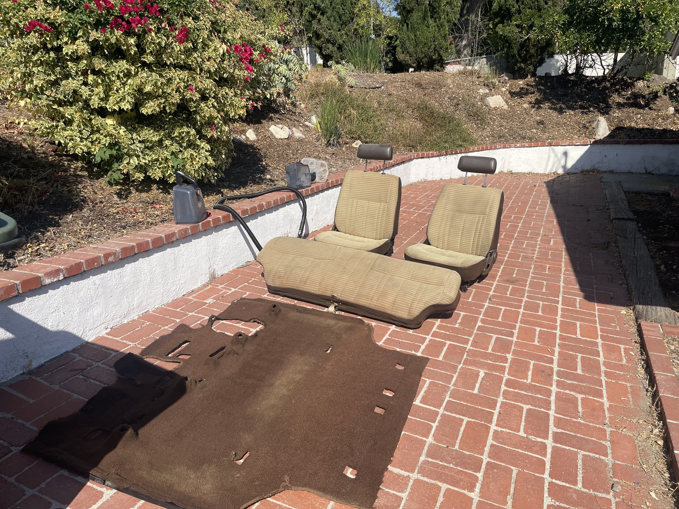

Shampooed EVERYTHING today and pulled the carpets, got more turds out. This carpet is fairly shot but it's low on the list for now.
Smells about 30% less rank but stuff is still a little damp, it'll dry out by tomorrow. All the turds were stuck in the little nooks of the seat supports and under the rear heater. I took out the mounting bolts and lifted it just a little to get under there. A 7:1 water to bleach solution wiped on with a paper towel really helped.
