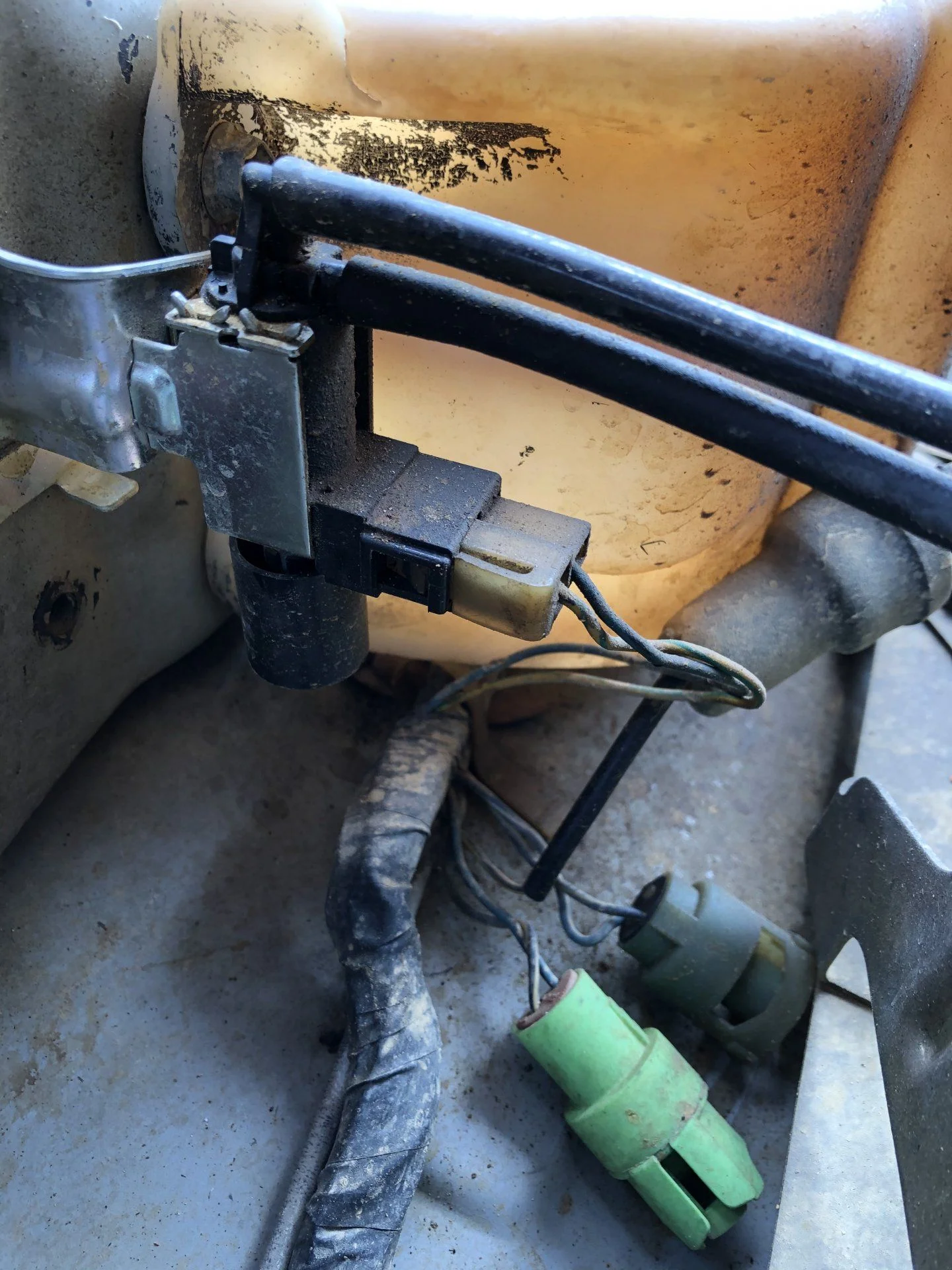

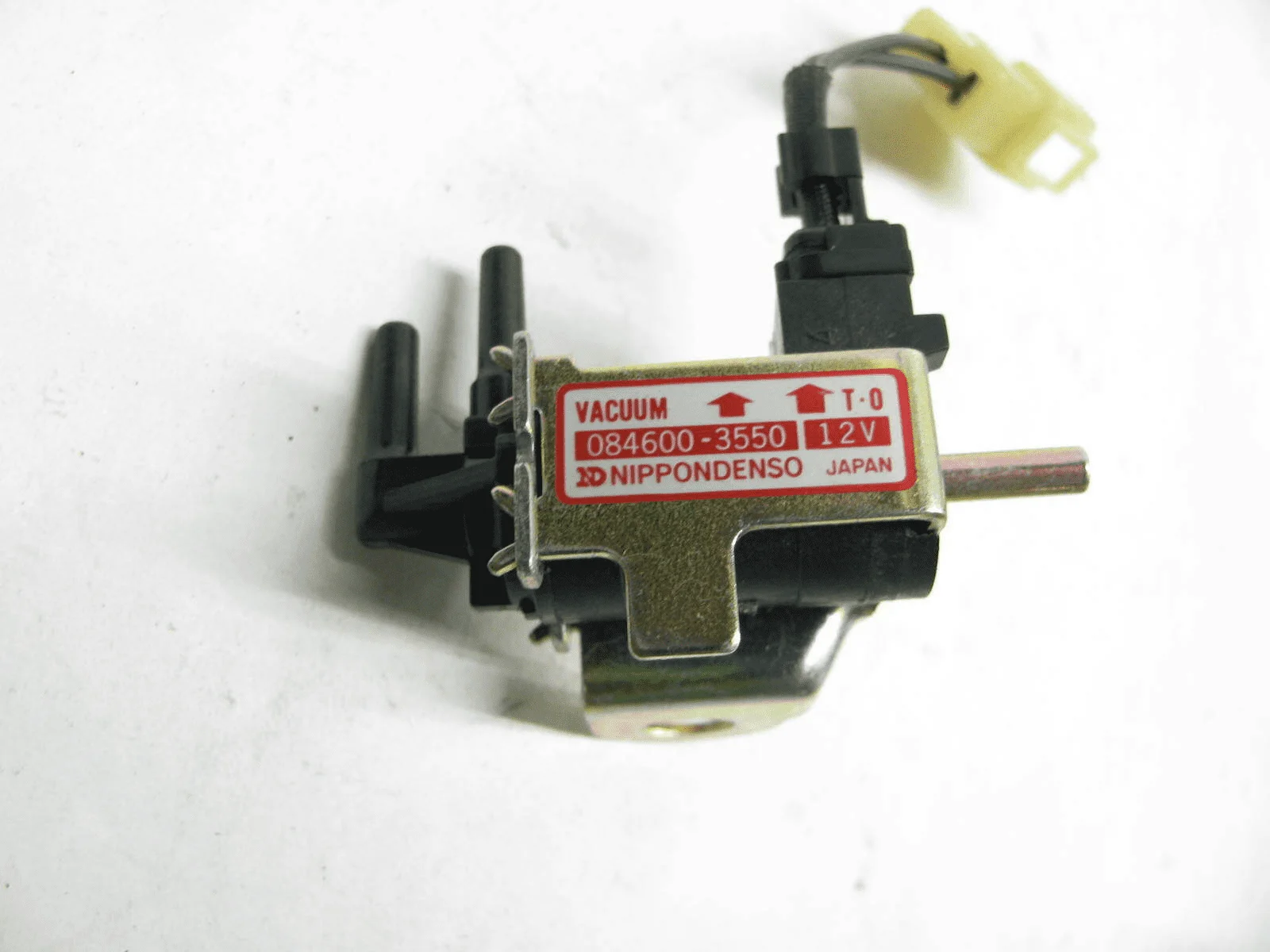

It has the wire lead connector or on the body, like this substitute:

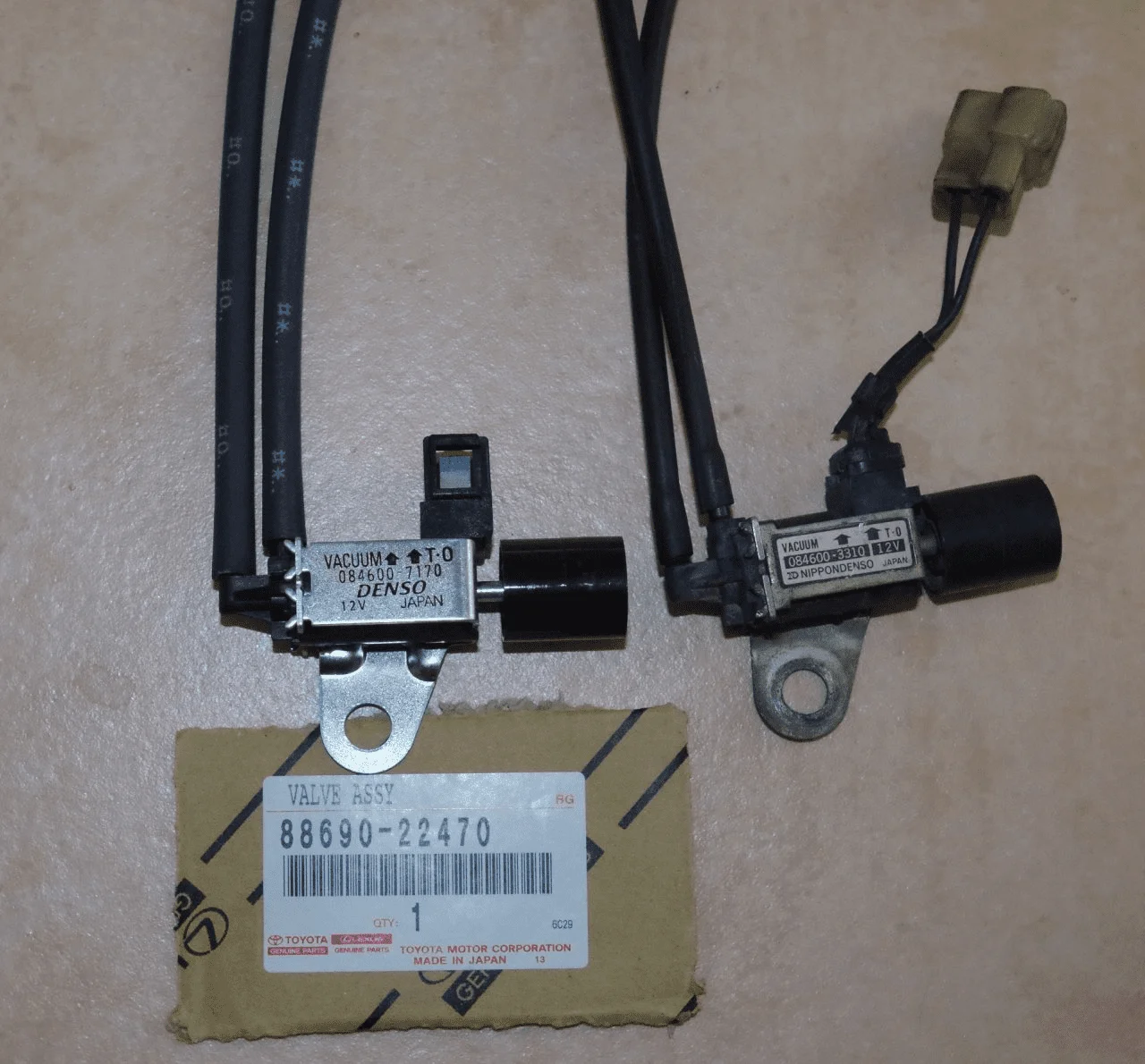

@chbrow10 would you be able to post a pic of -32280, or is it identical to that in the picture (-22470)?
Thanks
EO
Thanks for that. I have a very rare BJ60 (Asian version with the 3Bii) and quite a few parts are specific to my model, including this idle-up VSV. I only had the diagram in the EPC to go off and, based on that, I ordered 88690-22470. The part is actually discontinued but I managed to pick one up for $40 from a 22R-E supplier. Now I have to figure out where it was mounted (I think on the inner wing (fender)). Also how to tap into the vacuum line as the junction piece is also specific to my exact model (with AC but no clutch booster) and NLA!

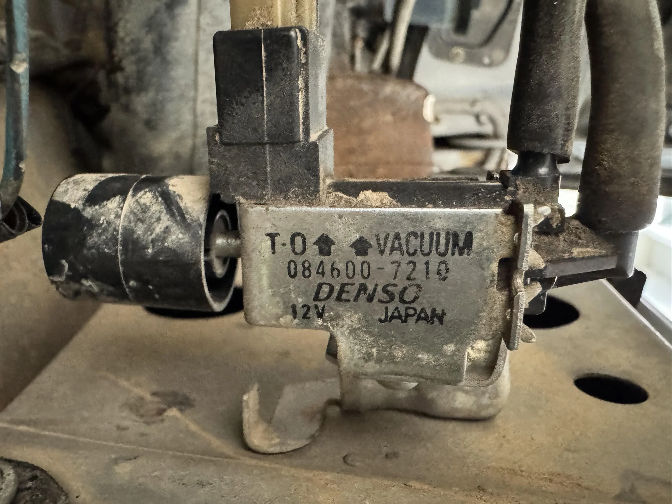

Reviving this old thread because my VSV is clicking on and off and worried it may be on it's way out. (And I also now own the Cruiser that started this thread ;))
Is this part still available or is there an alternative? Below is what I have now.
Reviving this old thread because my VSV is clicking on and off and worried it may be on it's way out. (And I also now own the Cruiser that started this thread ;)) Is this part still available or is there an alternative? Below is what I have now. View attachment 3905461
Kody, is that the part I replaced or something different?
That valve is easy to test: just apply 12v and should click and 'open' to allow vacuum/air and when 12v removed it's closed. You can try cleaning it, including pulling off that black cylinder thing, which is a filter, and blowing it out. A drop or two of WD40 in the nipple and in the tube where the filter is sometimes frees up the solenoid.
Otherwise, many of those valves are still available, and only about $30ish
